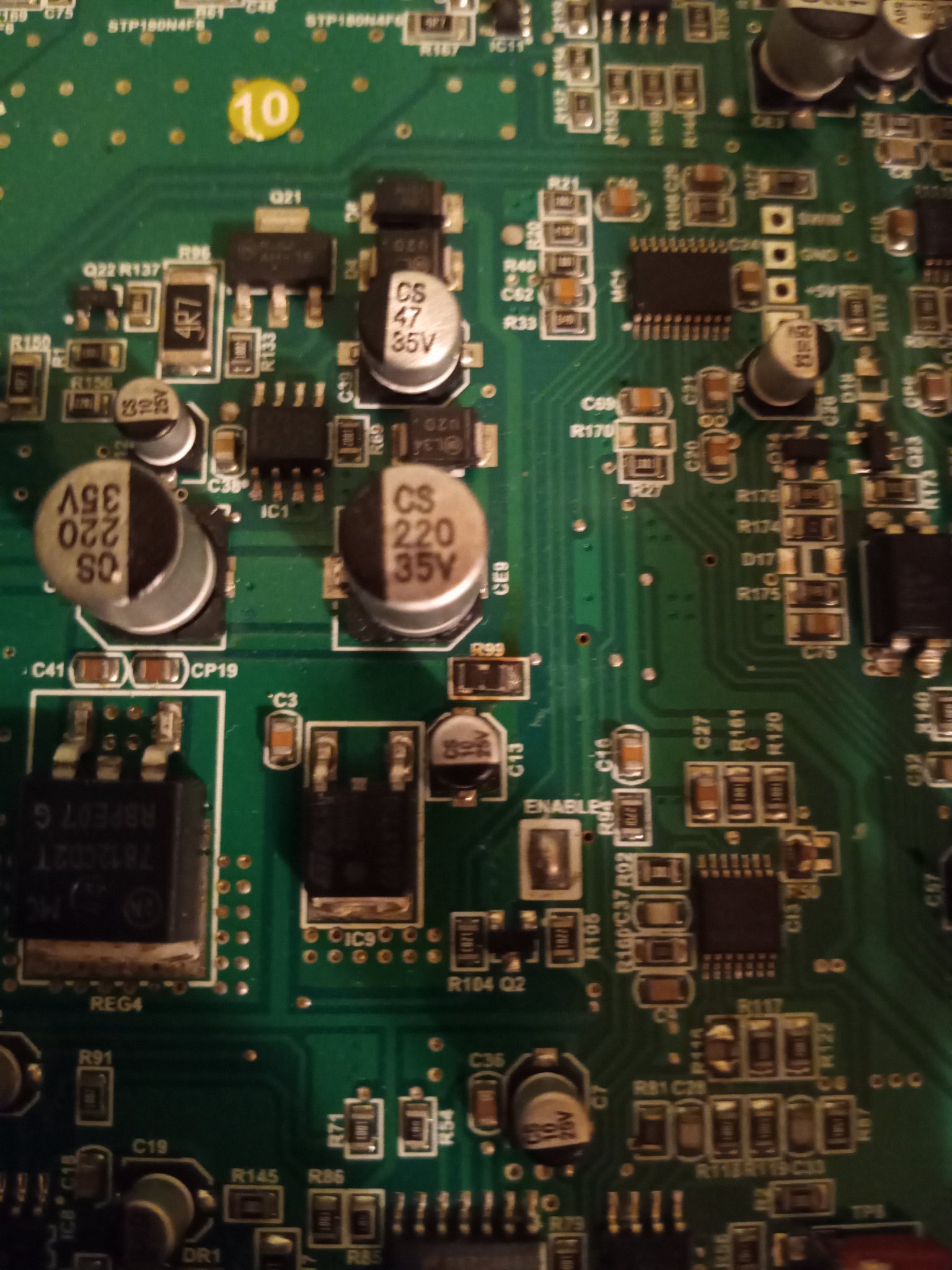

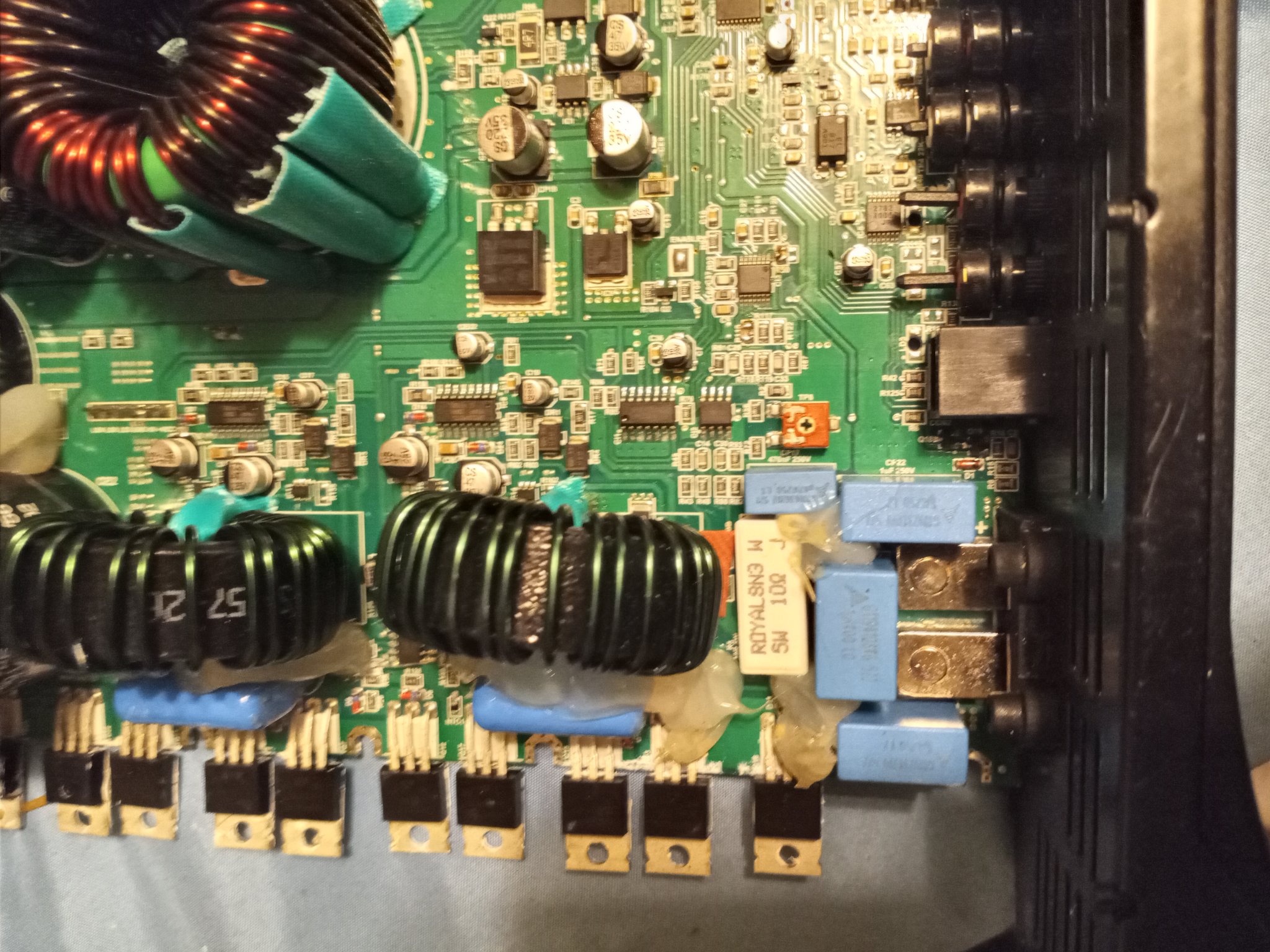

Does anyone have a diagram of remote turn on circuit (5v) or know which ic (part #)converts 12v to 5v .... I'm only getting 2.5v on my 5v circuit. All my power supply transistors test good output also tests good.. amp looks brand new inside.Any help would be greatly appreciated. Taramps smart 3k..
If you know what the 5v line is, follow it back away from the controller IC.
Exactly 2.5v?

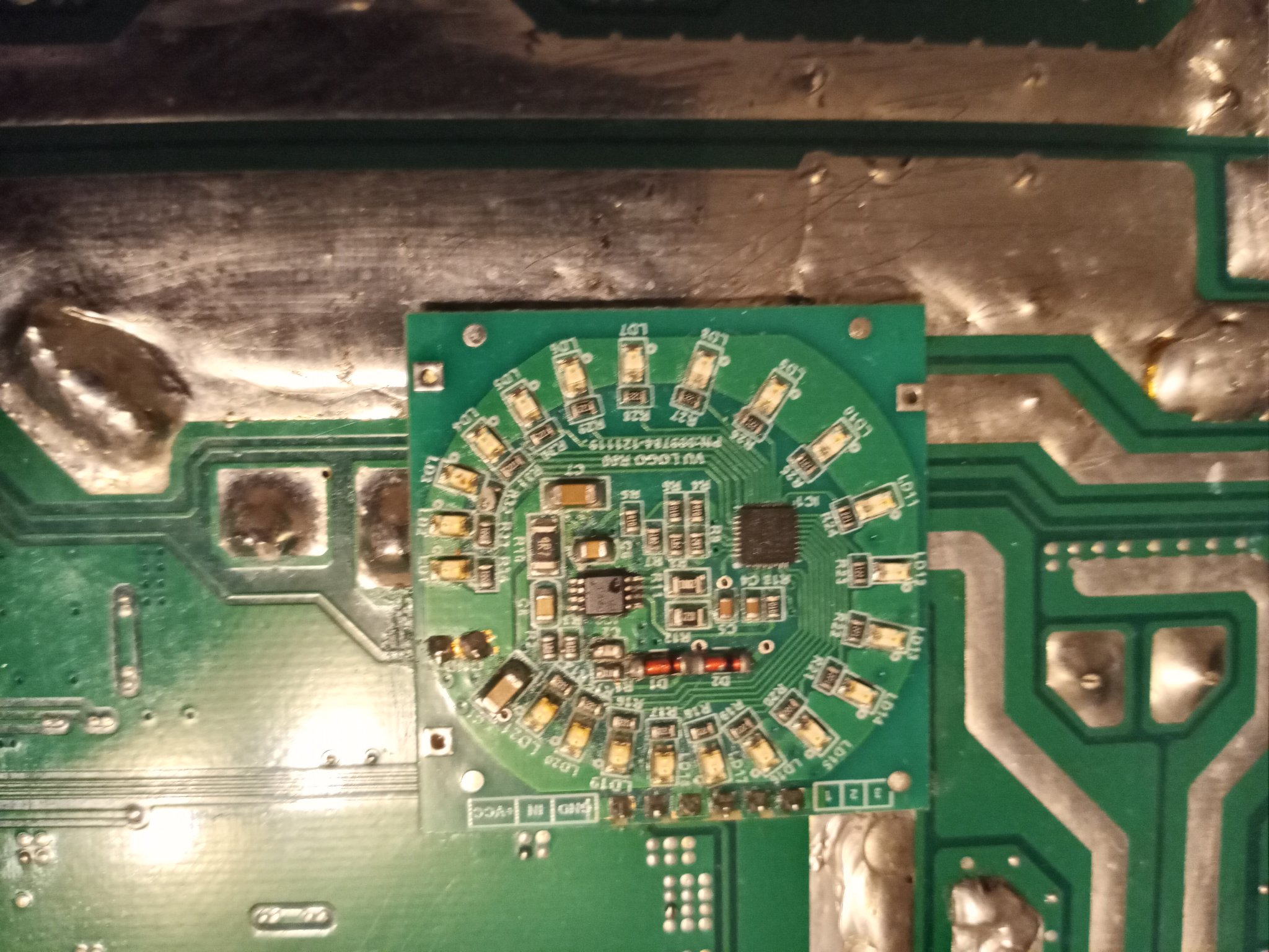

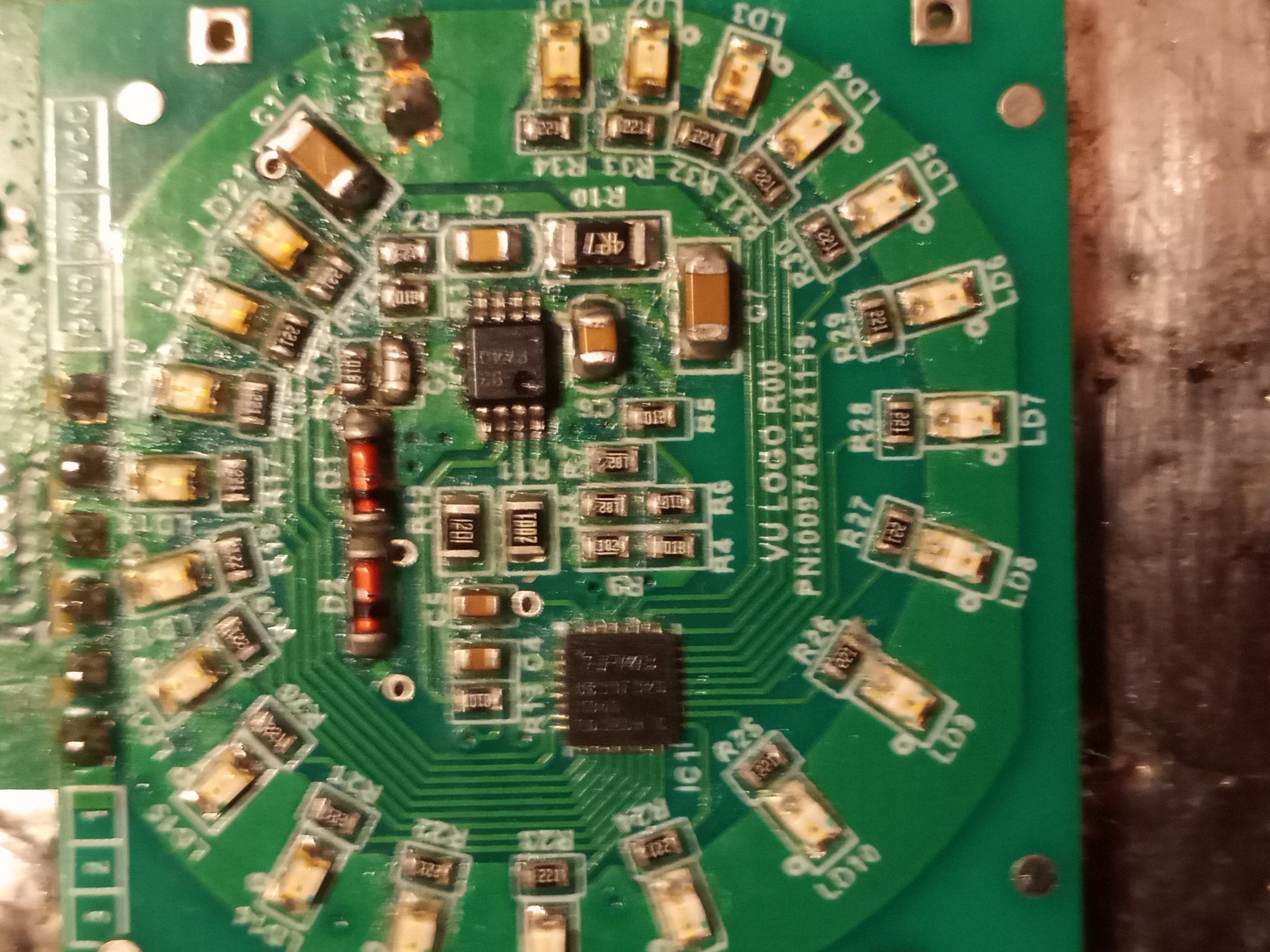

On the in terminal of the led smart control I have exactly 2.53vdc ....at +vcc 1.42vdc ....on my power supply transistors I have 12.31vdc center pins ...on output transistors I have 2.49vdc on outer pins........ic1 on my smart led looks to have a hole in it ill attach picture....

When I apply power only thing that happens is fans turn on they are receiving 6.29vdc
I apologize video was mispost on my part...

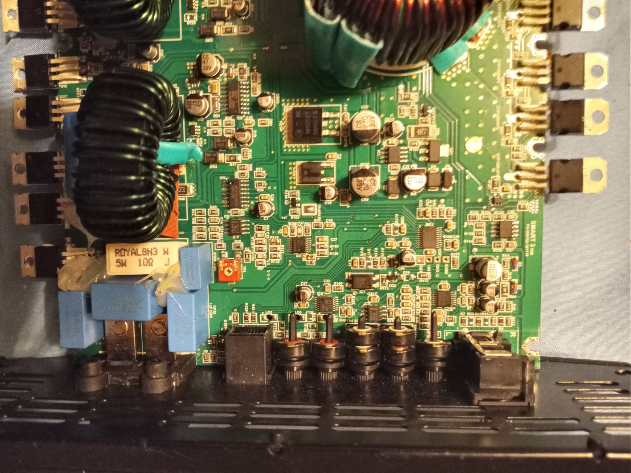

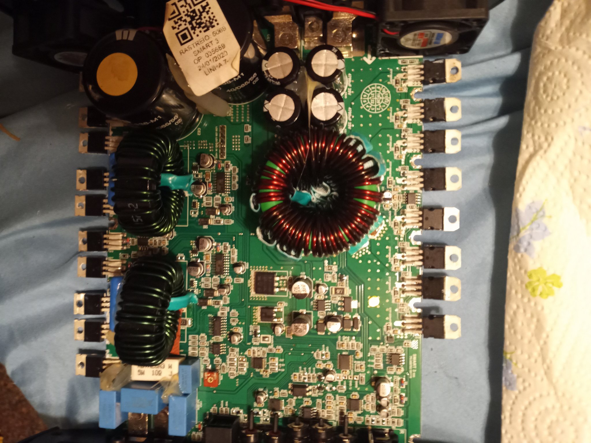

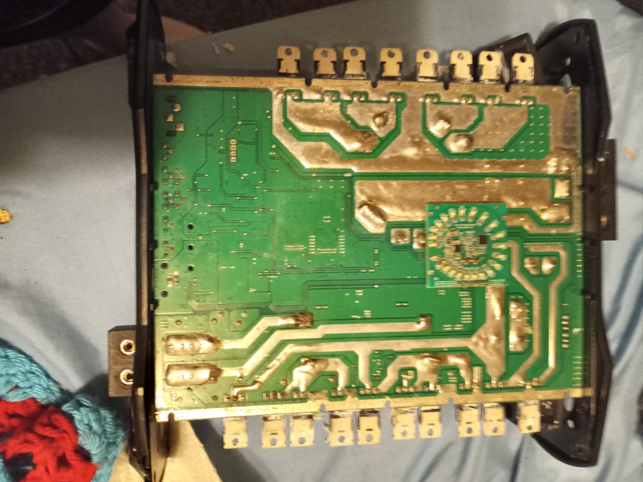

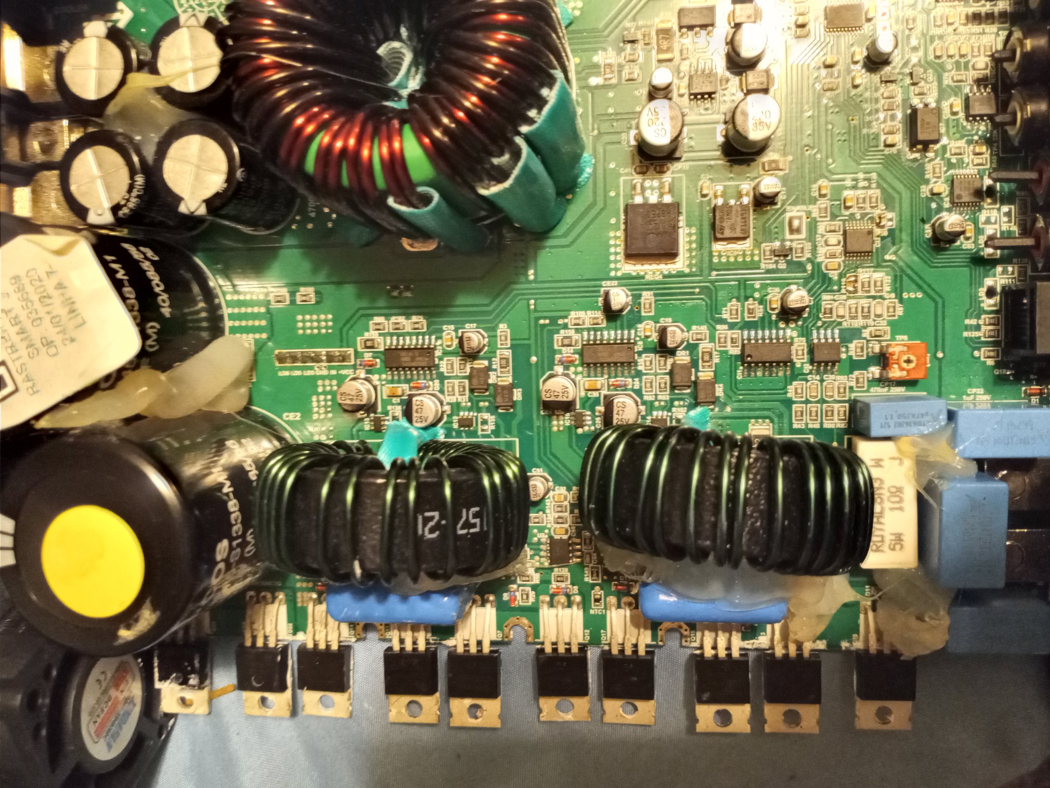

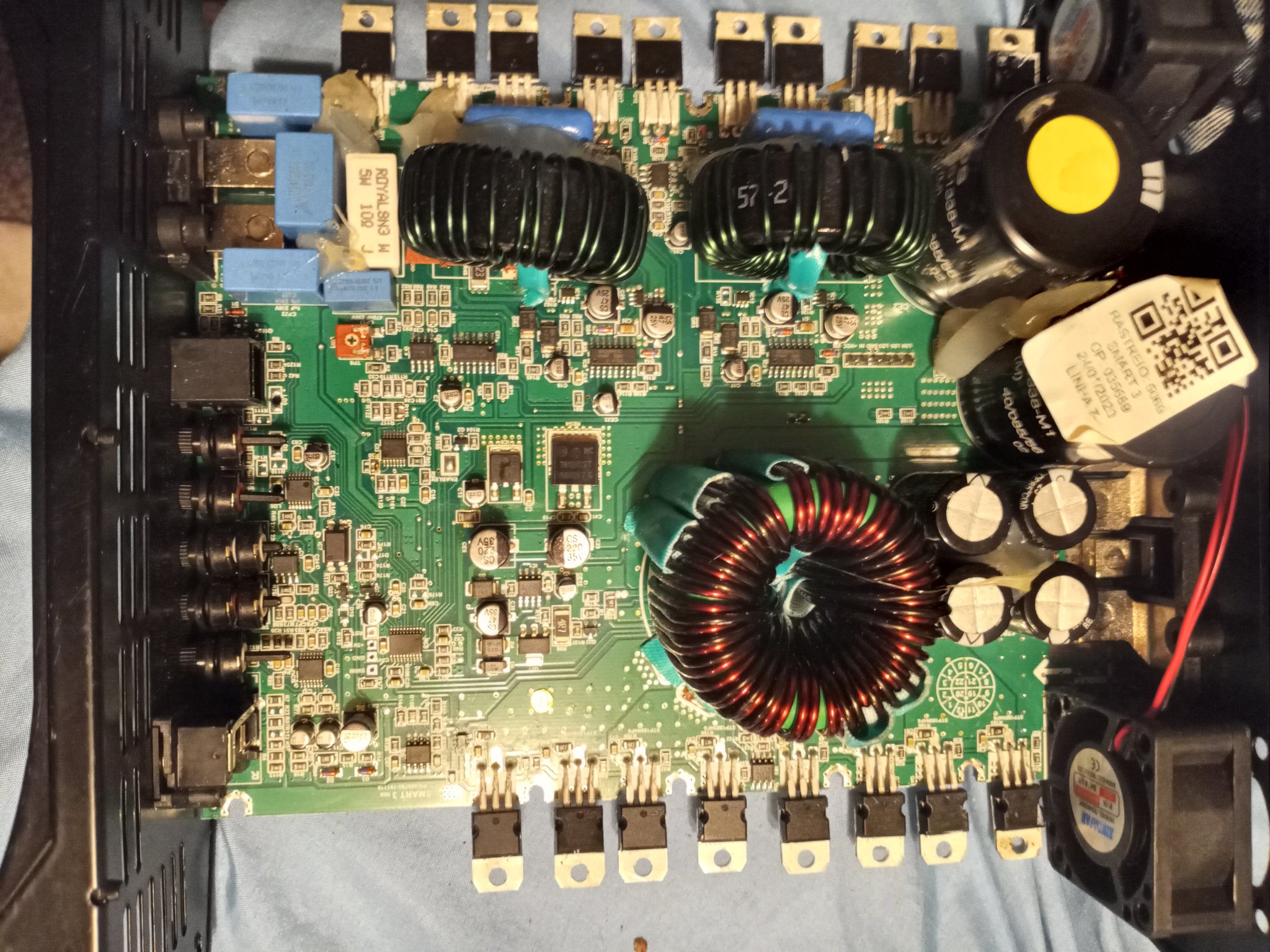

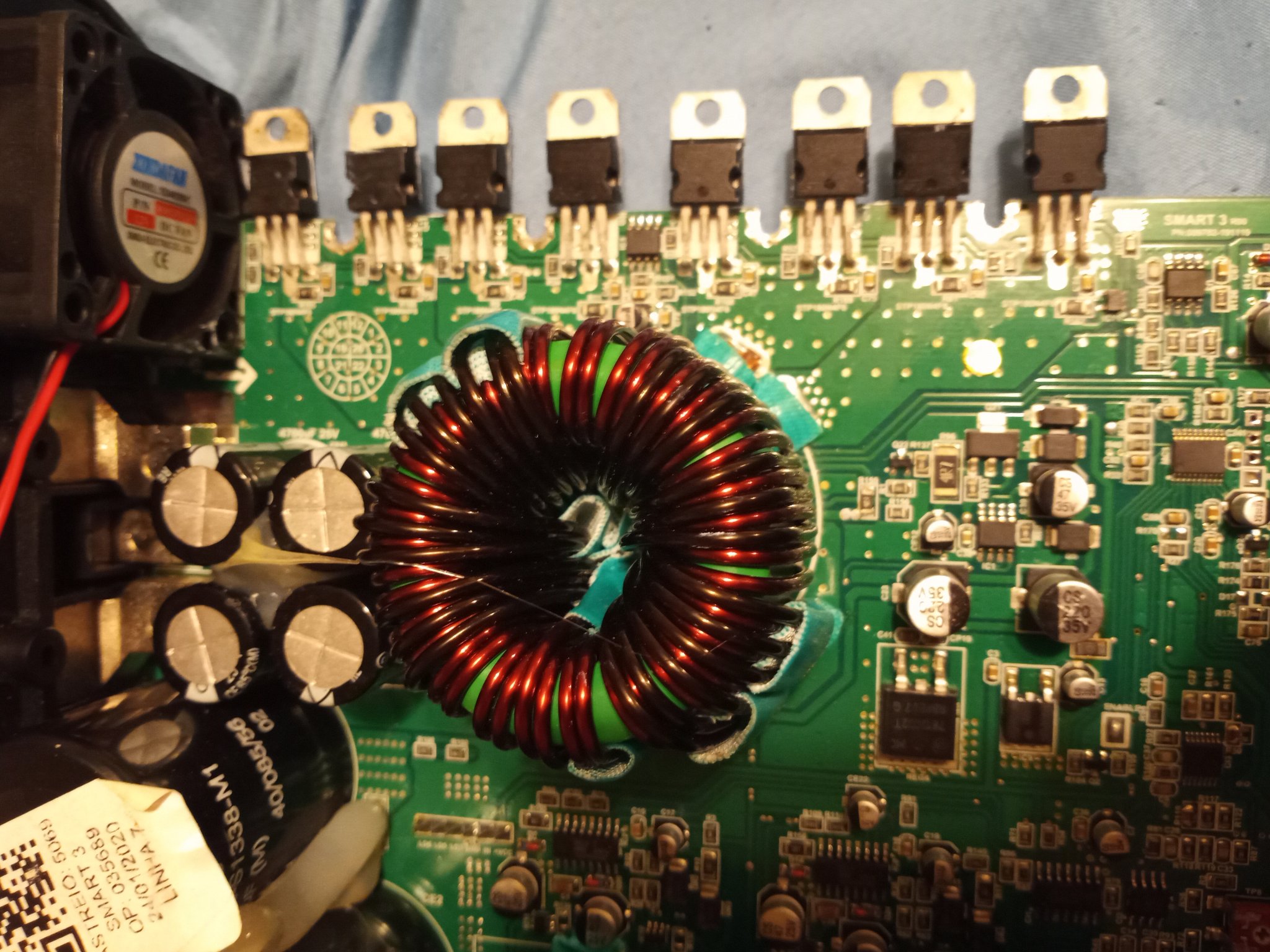

If you're going to post an image, do so with a still image with the components in focus and no flare from the lighting. You may have to take several photos from various angles to get what you need.
Post an image of the components side of the main board.

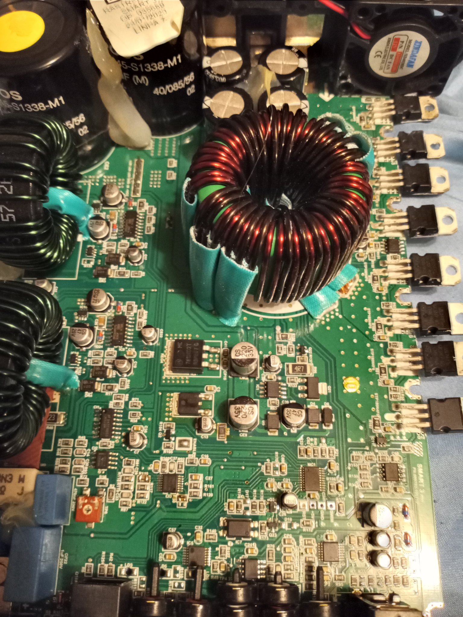

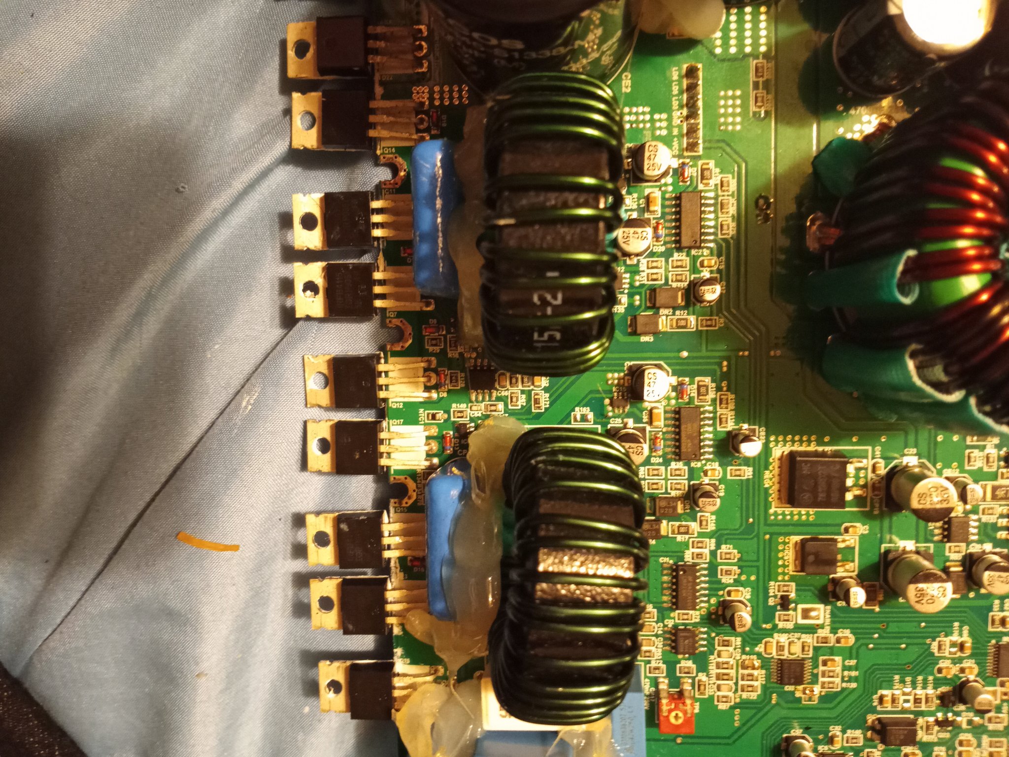

Yes sorry I'm having awful time reading it can read all others ...the voltage is 1.34vdc ....might have to remove to read ....83003?3??........crn935??
Yes sorry I'm having awful time reading it can read all others ...the voltage is 1.34vdc ....might have to remove to read ....83003?3??........crn935???
CRN935RRY or can935rry....83003f3p6...gonna try and look em up see if either correct its e tremely faded all others are readable I apologize
