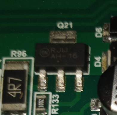

Q21 correct readings
Base 0.000
Emitter 0.000
Collector 12.43
Still learning sorry for wrong values but these are correct .... i read datasheet and realized I'd used wrong pin out first readings my mistake

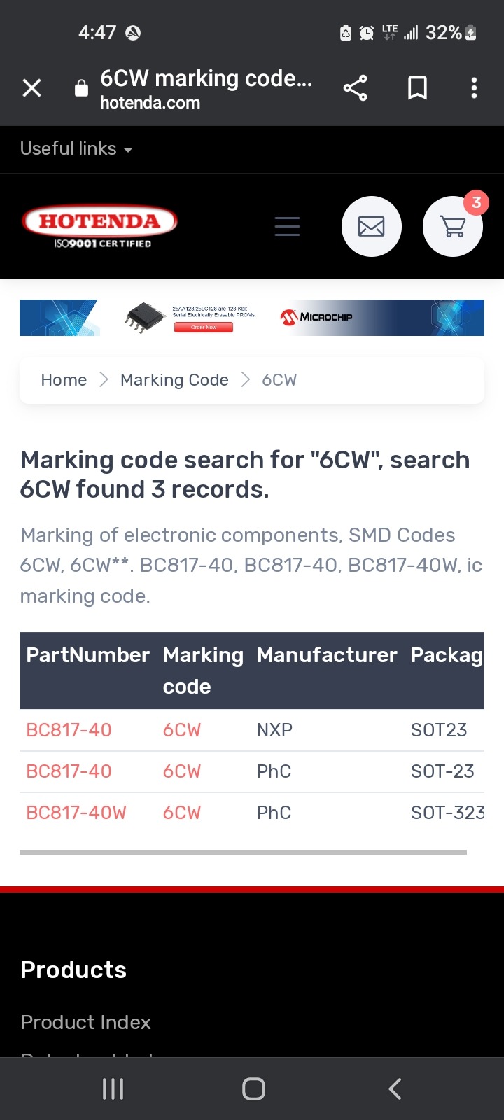

"Q21 voltage regulator 6cw bc81740" <<< What do you mean by 'voltage regulator'?
Are you sure that Q21 is that part number?
I know q21 has 6cw written on it. ..... bc81740 came up but it was listed as voltage regulator and it obsolete it says I probably found wrong part # I'm struggling matching component markings to correct datasheet I've downloaded 20 datasheets tonite trying to find q21
So sot-223 is smaller than Sot-23 ?
So when I'm looking for datasheets I should type the smd code printed on transistor followed by sot-223 or sot-23 depending on which size I need?
For example
Q21
6cw sot-223 transistor
Is what I should type to find q21's datasheet and part number?

Q21 is RJJ
Q22 is 6CK

Did you look at the datasheet I posted? The marking is AH-16. It's shown in the DS.
This is for Q22 (attached).
When you list voltages, do so in a vertical list, with the exact voltage that your meter reads, including the terminal names. Use the datasheets to determine the terminal names.
Is Q22 shorted between any 2 of its terminals?

Q22. Bcp53 sot-223
1. Base= 12.08vdc
2. Collector=304.7 MVdc
3. Emitter= 12.43vdc
4. Collector= 337.2 MVdc
1. Base= 12.08vdc
