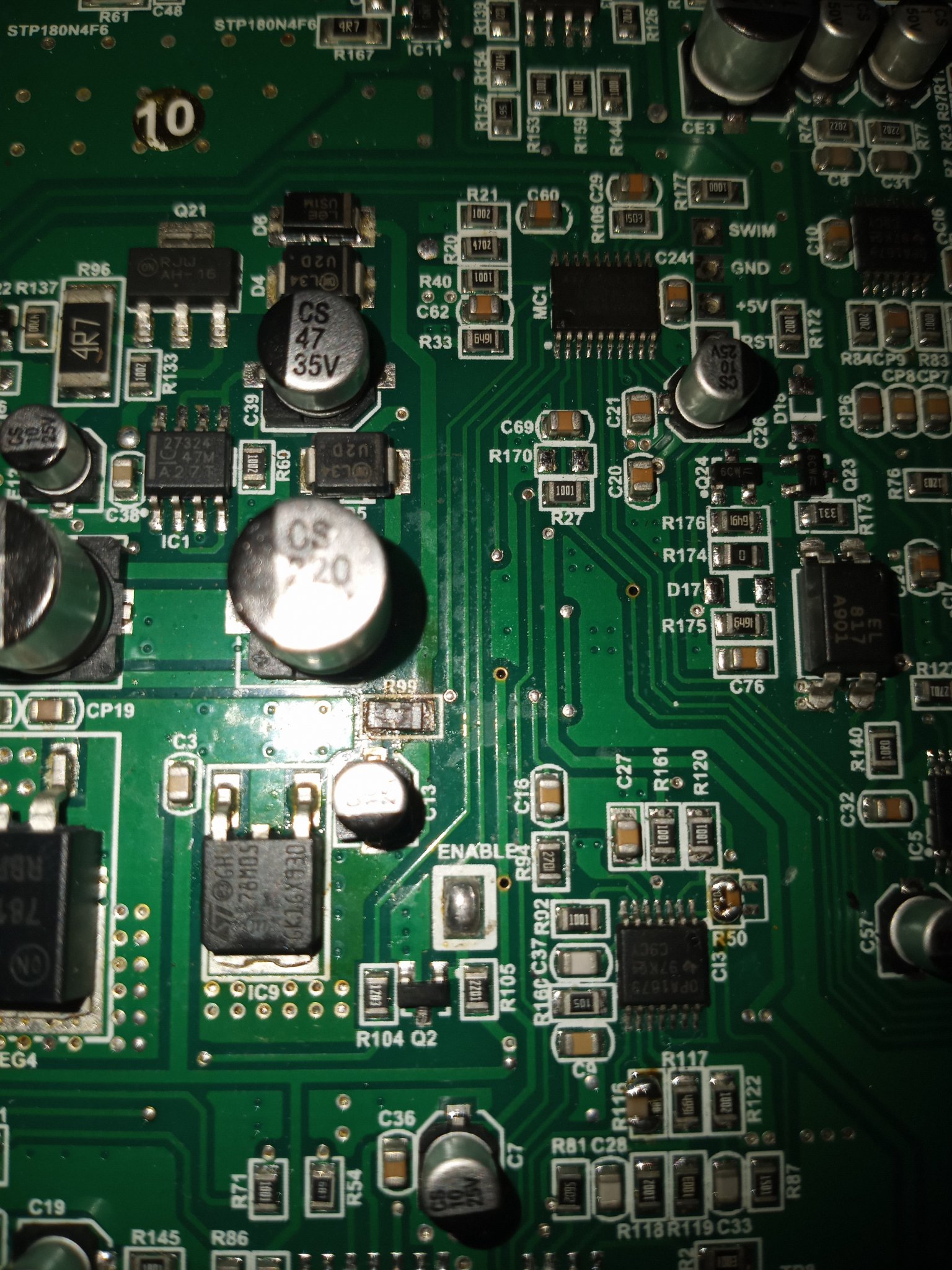

Resistor is testing at 4.7 ohms but what is printed on it is now unreadableNot sure if you can see it but caused yellow discoloration also...noticed heat during testing and found r99
On similar amps, a 4.7 ohm resistor is used to feed a different type of 5v regulator. 4.7 ohms is likely correct.
Is this R99 feeding the input to the 7805 regulator IC9?
Does the output of this 5v regulator connect to pin 9 of MC1? If not, which pin?
It connects to pin 15 .... r99 heads over to d6 a trace comes out the side of d6 to pin 15 on mc1 ....... on the other side of r99 it connects to c13 to ic9 and reg 4
Taramps messaged me back saying they can't give me info on mc1 but will let me order it ... they mentioned it's programmable....but scope arrives tomorrow and I should be able to give u accurate part # at least ....BTW I truly appreciate your knowledge and willingness to help me with this issue Perry

Does the OUTPUT of this 5v regulator (IC9) connect to pin 9 of MC1? If not, which pin?

It does not go to pin 9 it goes to pin 15..I was trying to find a similar amp but I'm not sure what you wrote.

Is it safe for me to apply voltage to board for 30 secs and check the output of regulator? Ic9 might be issue I checked all voltages at mc1 before the heat issue at r99 and no pin was above 1.79v so pin 15 was definitely not receiving 5 volt the 78m05 datasheet says it should be supplying ...sorry I'm newer to this and still learningIt does not go to pin 9 it goes to pin 15..
If the output of the 5v regulator goes to pin 15 of MC1, the information I have is of no use.
The microcontrollers rarely fail but if it did, it could be loading IC9.
If you power it up, check to see if IC9 or MC1 is heating up.

They were both hot yesterday when I had r99 heat up .... I will supply mc1 part # when I receive scope tomorrow ... I will have to repair r99 trace ...this was first time I've powered it up since it heated up I think traces are burnt fans no longer run and voltages are not same yesterday .... how many years do they wait before they release diagrams lol ? Wiring diagram would be amazing

Have you tried applying a small amount of white heatsink compound to the top of MC1 then wiping it off with a dry cloth to see if that made the number easier to read? You may need to clean it off with acetone before applying the heatsink compound.
Lift the output terminal of IC9 to see if the output returns to 5v.

Ok I will do that rite now I will have to fix trace at r99 real quick but i will lift output of ic9 and check voltage will let you know shortly ..

I have no voltage at all at ic9 .... when r99 overheated and desolder itself ic9 has had no voltage I assumed it was burnt trace where it discolored I repaired trace but still 0 volts at ic9 .... ill message I'm looking for other issues now

All voltages are 0 since r99 heat up I'm slowly checking every section .... so far I have 12.45 at all power supply transistors Q21 has12.45 power supply induct 12.45 ic3 feeding ps transistors 12.45 ......rest of board dead so far .....Do you have voltage on REG4?
What is the DC voltage on all 3 terminals of Q21?

Nothing at all reg4 ......... q21 right pin 12.45,,middle pin is doing pull down ,, left pin 12.43Do you have voltage on REG4?
