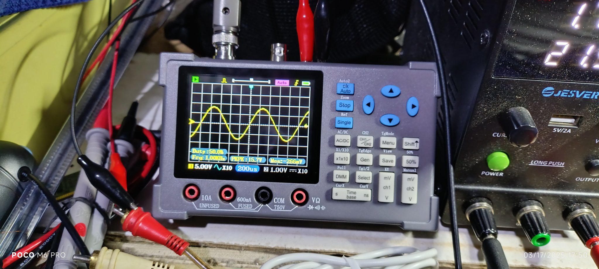

Oh I see, I have no idea how to turn that off, I'm going to go back through the manual again.
Only been using a scope since year, I will do better.
I'm not using extension leads this time, yes I now know they do.
The replacements reads normal, and the THT caps have the lowest ESR.

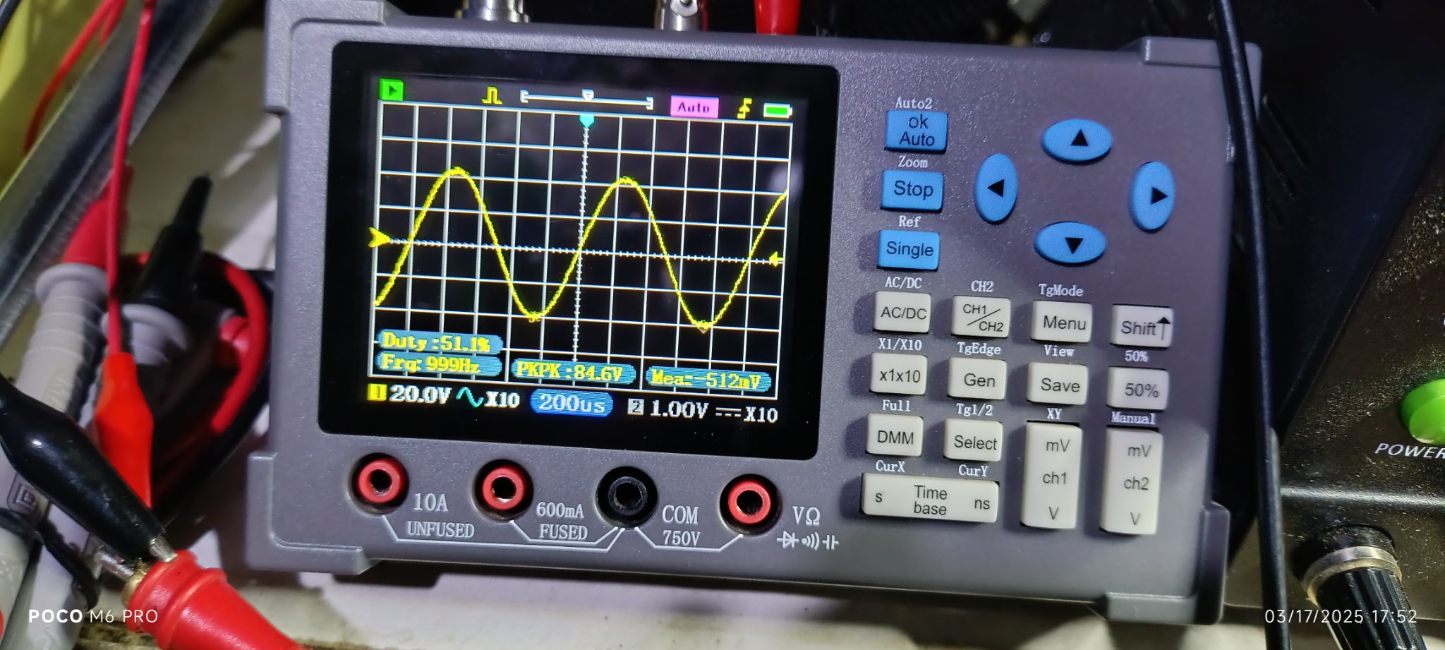

Yes sir. Well I have gone through the manual and it seems like I need to use the single trigger in manual mode.
Okay Mr Babin, this is 1 Khz sine wave going into the amp. I use the signal generator of the scope. It's a stronger signal than my phone, plus I can freely take a pic.
It starts to distort around 90 volts pkpk.
