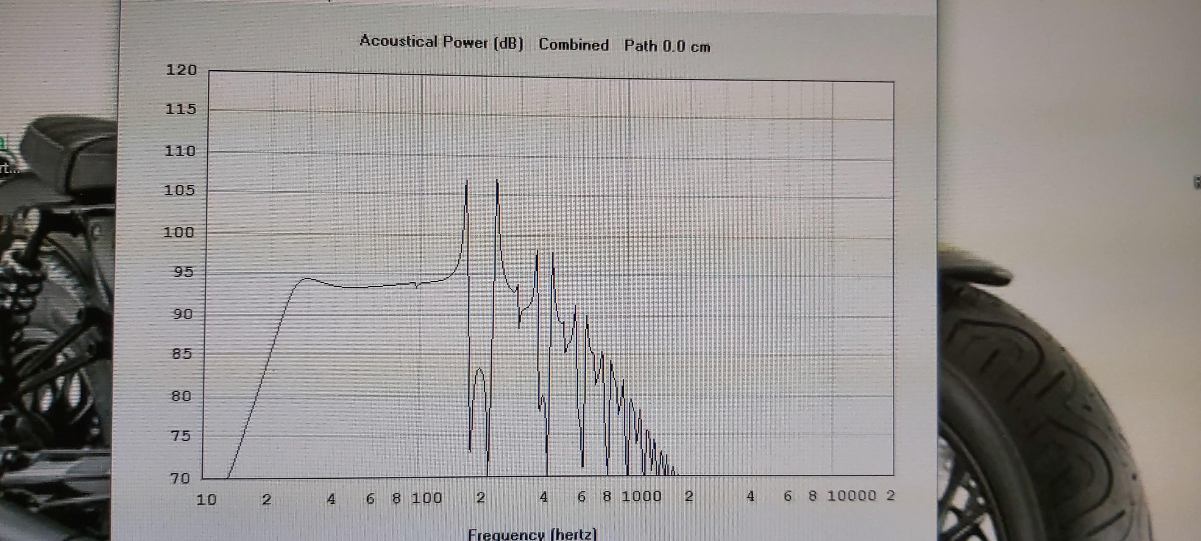

Thanks for that GM; that's a nice flat response; I'm new to HR but cannot seem to get rid of the small bump around 30Hz and a slight droop thereafter.
Still, from this point I have a tapered TL design which seems okay to me for the RSS390, and want to put it into wood. HR says box volume is 141.6L so I can design a box with this internal volume. Does that take into account the driver too, or do I need to add extra for driver volume?

Hmmm. Played around again with horn resp and changing where the driver sits really screws with outcome, seemingly. At the s1-s2 junction 85cm gives a nice response but at 60cm where I want the driver to be it is horrid so back to the driver at the end of a tall box I guess. Unless.there is a way around this I’m not seeing?

HR doesn't account for any basic losses due to friction/whatever, hence little 'bumps', high Q spikes, etc., in sims that will go away if you enable 'MASKED' in Tools/Options.
Right, all box programs calculate NET volume [Vb], so driver, bracing, venting 'losses' must be added to it, though obviously the larger a [ML]TL's [Vb] the smaller the percentage of its loss/'shrinkage', so unless you're trying to 'squeeze' every extra cm^3 [in^3] out of the [Vb], either ignore it or just add the time honored ~10 % to it as stuffing density will compensate any reasonable excess [Vb].
