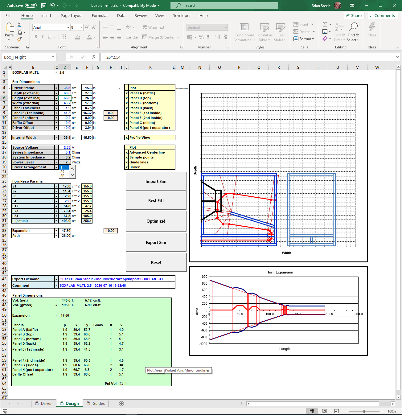

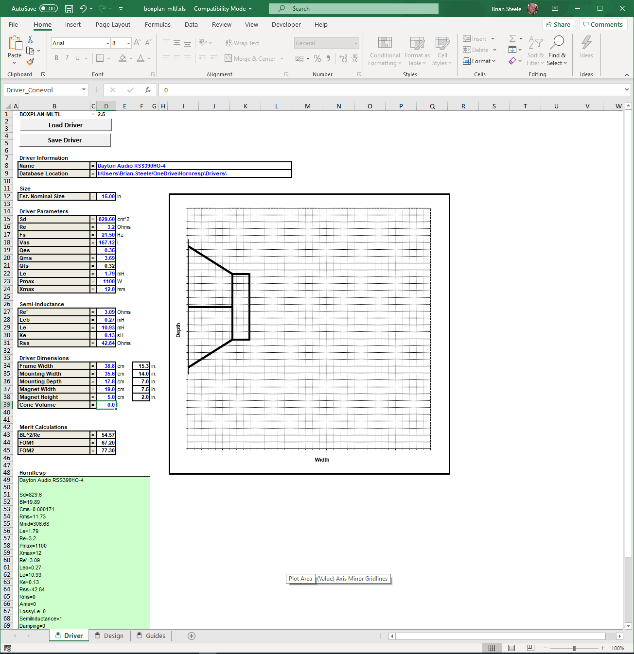

Try, and another epic fail using the RSS390 in the MLTL BOX Plan. I tried to follow your 11 steps but I think I must be missing out inputting something because I don't what may be a critical value? Im just using what numbers I can glean from the PE website.
When I input the box dimensions in the design area, the driver is part sitting in the box, part out. It is sited way too low.
I tried messing around with different box dimensions but I never got the driver to fit inside the box so never got to optimise the box. The piece of wood that is meant to define the transmission line is tiny and smashed up against the back of the driver!
So it's a mess.

Hi GM
I managed to import the file and open it on HR and the power response looks broad enough for my purposes, and it seems to dig pretty low too.
Is the design itself (I note that it is 144L) similar to that of the Boombox?
For my purposes the only real design issue I have is that the box has to be no more than 17in wide. Height and depth not really an issue, though if I could keep the enclosure from not looking like a coffin that would be an advantage aesthetically (says she).

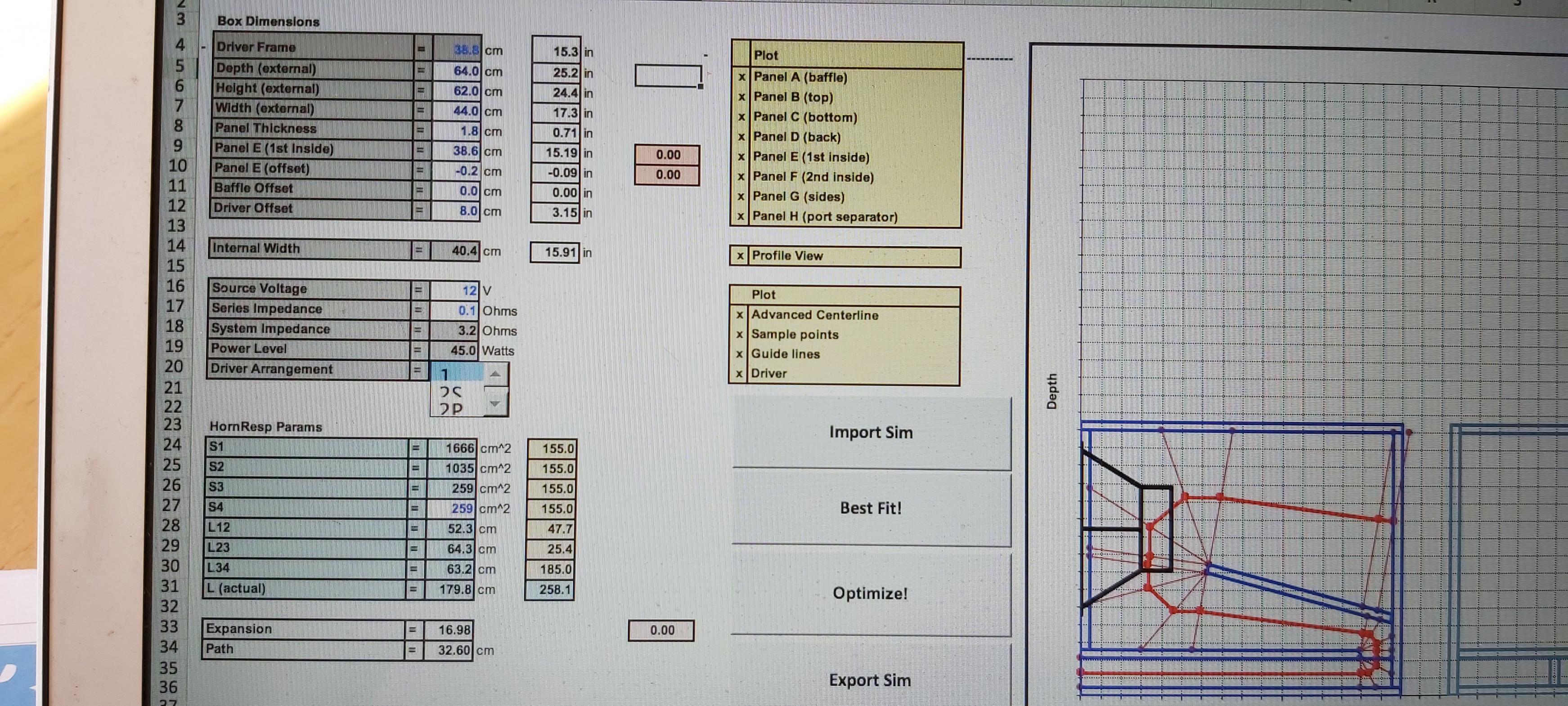

Thanks Brian. Appreciate it.
Where did you get that 250cm3 figure from? And what would you advise re vent size?
Also, the 195L gross vs 145L net volume enclosure figures. What do they signify or mean exactly?
Finally, 38.8cm is the frame width, and 39.4cm is the baffle width. Is that cutting it a bit fine or is that essentially plenty enough for the driver to fit?

Brian, I have one other minor query regarding the MLTL build for the RSS390HO.
How exactly do I determine where the driver and panel E are positioned in the box?
I take it I just refer to the grids on the image. So panel E starts one quarter of the way up and extends to one half the way up the box, while the driver starts one sixteenth of the way down from the inside of the top panel (and six sixtheenths up from the bottom), correct?

Check the "Guides" sheet in the workbook. Basically you mark off the guidelines as indicated on a side panel, and use those guidelines to position the other panels.
Note that what I gave you should be considered a starting point. You should experiment with adding stuffing to the sim, resizing the box, etc. until you end up with something that best fits your needs.

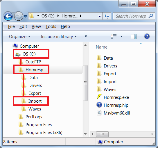

You need to use the workbook's "Export" feature to export the Hornresp sim that corresponds to what you've designed using the workbook. Make sure that the export directory is the same as Hornresp's import directory (usually c:\hornresp\import). Once you've done that, use Hornresp's import feature to import the sim. You can look at the results using Hornresp's "Loudspeaker Wizard" feature. You can also make adjustments in the workbook, export the results, and press "F6" in Hornresp to update Loudspeaker Wizard with the adjusted sim.

Would you mind precisely telling me what it should read?
As Brian says, the file exported from the BOXPLAN workbook needs to be saved into the Hornresp Import folder, which is located directly beneath the Hornresp folder. If Hornresp has been installed as recommended in the Readme file, then Export Filename = C:\Hornresp\Import\YOURFILENAME.TXT. If Hornresp has been installed somewhere else, then that path must be used instead.
