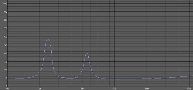

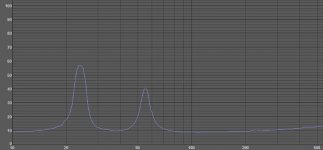

OK, here's the new and improved bandpass sub. Basically it's the same sub as before, but the tuning frequency has been moved up. This increases efficiency at 50hz by 3db(!) and maximum SPL also. I intentionally 'tipped' up the response a bit because room gain will reinforce the low end.
The only change required is to use a port that's 14" long instead of 22". This also means you don't have to use two 90 degree elbows, which are quite expensive.
Here's the measured impedance with a 14" port, and it correlates well to the horn response model.
Also, this sub should be placed *face* down, at least 1.5" from the floor. The floor itself lowers the tuning frequency. (this is measurable.)
