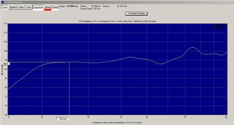

Attached is a half space measurement of a Spud woofer prototype, taken at one meter in a large parking lot, driven at 2.8Volts RMS into an 8 Ohm speaker load (two, four ohm drivers in series).
The cursor shows the 2.8Volt / 1W sensitivity is 94 dB at 25.4Hz and the measured –3dB point from that is 19Hz.
This is about 10dB greater than one of the drivers used as a direct radiator or 7 dB greater than the two. Using two enclosures as I intended raises it a bit over 4 dB higher at 1 W 1M..
Now, making or modeling a band pass speaker “that did the same thing”*, with a driver of your choice, what would that speaker look like?
*had a 94dB 1W 1M half space sensitivity like the Spud curve and was –3dB at 19Hz and had a wide enough bandwidth so it also could be used with a 70 to 100Hz low pass crossover as in home theater or hifi.
Could a band pass that did this fit in the same cubic volume of one Spud?

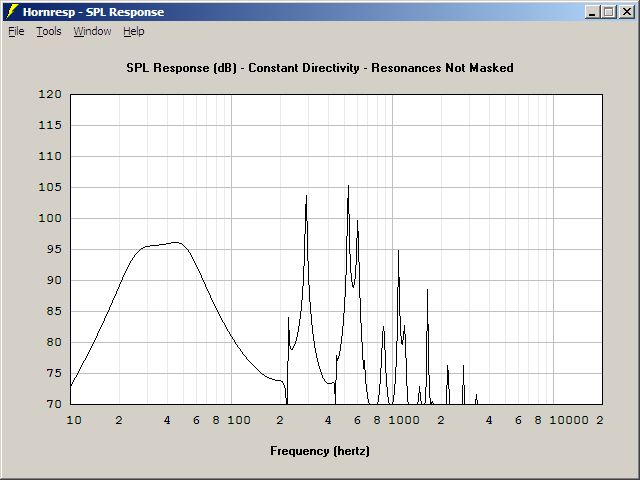

To remedy that, I've modeled the sonotube bandpass sub described in the post above using horn response.
There's one little problem tho...
You guys are going to hate me for this, but I lost the measurements of the modified woofers 😛
If you recall from page three of the thread, the MCM woofers don't play very low, because the QTS is too low. To get them to dig deep, you need to get the QTS up. You can do that by adding mass to raise the QMS, adding resistance to raise the QES, or both.
I did both. When I was finished, the FS was 27hz. I know that for a fact. Using horn response I was able to predict that the "new" T/S parameters are as follows:
FS = 27hz
QMS = 14.08
QES = 0.27
VAS = 23.88
QTS = 0.27
Note that the QTS gets higher still when you add the five ohm resistor.
Without further ado, here's the predicted model of this bandpass sub.

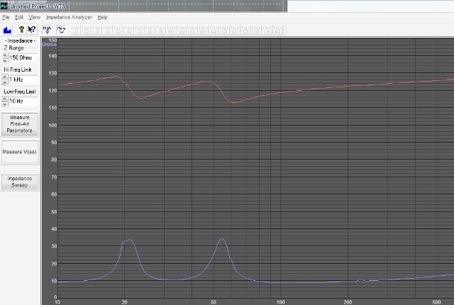

This is the most important graph of all. The impedance graph. You really need to measure the impedance curve because it's often necessary to adjust port lengths "in the real world." The impedance curve can show you if you have leaks or loose panels too.

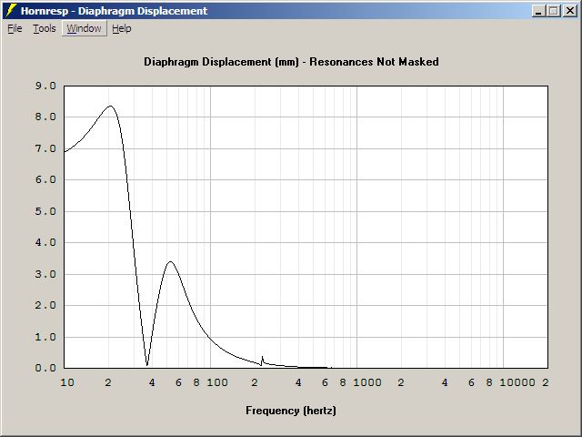

Here's the excursion at twenty watts. YES it actually runs out of excursion with 20 watts. What do you expect from an eight inch woofer making 20hz
Keep in mind that I started with three subs, and I'm in the processing of installing five more. The whole idea of this project is to create a VERY VERY small sub that can make 20hz, that's inexpensive.
Here's a quick measurement of the bandpass sub's impedance.
Note the tuning frequency has drifted lower, by about 3hz.
I think this is due to a small leak that I detected around the seal of the port. It was only noticeable when the sub was really going at it, and I fixed it a few weeks ago. (I adjusted the port length before discovering the leak - the port length specified on page 3 is based on impedance sweeps done with a slightly leaky port.)
Due to this anomaly, I should reduce the length of the port to raise the tuning frequency back up a few hz. According to horn response, this extra-low tuning reduces efficiency by almost three decibels at 40hz! That's like halving the power 😛
So this is an excellent example of what I've been harping about. Something as minor as a tiny leak can change the efficiency of these boxes dramatically!

Also, there's a significant reduction in excursion because I've raised the QMS and the QES. This lowers the F3, but at the expense of maximum SPL and efficiency.
Though the woofer will bottom with just twenty watts, the idea is to use a BUNCH of 'em. I started with three and I'm adding five more.
