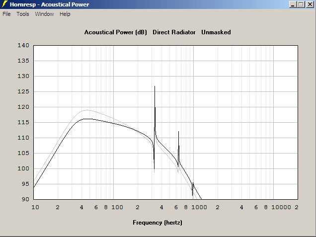

It's a still a fudge, as you're basically adding a source/cable impedance that does not actually exist to the sim. This is as bad as say adding imaginary path-length to a horn's simulation to make its sim'd Fb the same as its measured Fb.... 🙂
You are correct in that my method is not as scientifically rigorous as Leach's model but it's also not as speculative as guessing at imaginary path length in a design that has still never been simulated accurately. And my method has been shown to work 100 percent of the time with this type of driver in any type of enclosure. So use it or don't, it's up to you, but it's not an unproven hit or miss random shot in the dark. Or better yet you could develop your own better method. Since you (and most people) don't usually use the type of drivers that need this tweak you can comfortably ignore it if you like, but if you would like to criticize or question it, please refer to the results I've posted and find fault there first before attacking the method. The results are what matters.
What is (or should be) clear is that some drivers don't sim as expected even if you have accurate t/s. Data-bass shows this clearly as he measures t/s and FR of all the drivers. I've identified which drivers have the problem and how to fix the sim so you can continue to use published specs (or measured) and continue to use your favorite simulator.
The alternative is to ignore the issue and accept inaccurate sims or to spend the money for programs that will measure the complex inductance parameters and a simulator that will accept them. This also means you have to buy EVERY driver you want to sim and measure complex inductance t/s first.
Mark says there is such a simulator available (that can sim exotic enclosures) if you can afford it and there probably is, but I wonder if this whole extremely expensive process is going to give results any better than mt method if you take care to get the most accurate curve fit instead of just doubling Re.
Using Leach's method will always put you on stable ground with accurate results but the process of working with complex inductance parameters is very expensive and a lot of work. This might change as a broader cross section of the market starts using this type of drivers but at this point it's mostly just car audio and HT guys with more money than brains, and they still haven't figured out that these drivers don't sim as expected. Even on avs where this type of driver is used almost exclusively only a few guys know they don't sim right and they just ignore it anyway since there was nothing you could do about it. Even now with a working simple method most people don't know and don't care. Since most people don't measure they will never know they didn't hit their sim goals and have badly designed subs.

I've never played with complex inductance parameters because to be honest, for the reasons I've pointed out it's a model without a whole lot of utility. But from reading your recent comments and the linked paper, it seems these complex inductance parameters are even less useful than I previously thought.
You mentioned a couple of times, and the paper mentioned that the simple model breaks down in the higher frequencies but an accurate sim is possible if you use accurate t/s.
This is simply not true, look again at the data I posted, the tapped horn examples are particularly telling.
Accurate specs ARE used, the t/s pecs he measured right before he measured the FR. And clearly the results are massively inaccurate in the simple sim at ALL frequencies right down to Fb and even below, not just at higher frequencies. In fact the higher frequencies aren't even that particularly bad, it's mostly the lower frequencies that have a huge problem (although even the higher frequencies will be off by quite a bit after power correction).
Blow the pictures up and take a close look at the untweaked sim (the lighter trace) in both cases, it's just massively inaccurate at all frequencies. In both cases my simple generic tweak is exponentially more accurate.
This is Othorn tapped horn with Mach 5 UXL and Sundown ZV3.
BUT if you sim the same horn with the driver it was designed for, the B&C driver which does NOT suffer from this issue, the simple sim works exactly as expected with very accurate results. No tweak necessary because it's a pro driver, the type of driver that can be accurately simulated with simple t/s specs.
I'm interested to see if you can get anywhere near an accurate result with complex inductance parameters. It's starting to seem like they won't do the job either, nowhere near as well as my method, if they only correct at higher frequencies when the problem clearly affects the entire bandwidth.
This has nothing to do with impedance plot magnitudes, it's the frequency response that's massively inaccurate. I'm not saying the impedance magnitudes might not be off by a bit (but as you mentioned that's a problem with not calculating internal box losses), but that's hardly where the real problem lies. The real problem is massively inaccurate frequency response across the entire bandwidth even well below Fb.

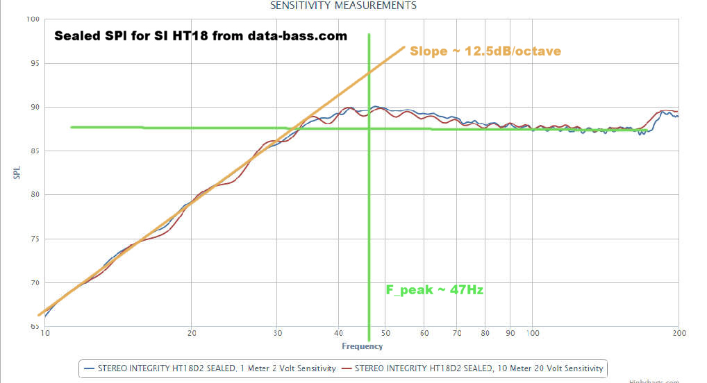

Hi Y'all,
Just pondering:
When I look closer @ the data-bass.com SI HT18 SPL curve, and apply the JAG-Tweak to it, the low end slope of the curve gets a little bit too steep, and the peak of the hump ends up a little too low, as JAG said, he didn't try for accuracy on this example.
When I use 2.5 Ohm added to Rg instead of 3.5 the low end and peak look very similar to the data-bass SPL curve. I cannot see any difference between adding to Rg or to Re.
Also, keeping Re and Rg @ their original values, but using Bl=16 instead of the original 21.34 gives the same slope as the Re-Tweak w/ a slightly higher overall SPL (see: attached).
I didn't change Eg for either method.
With small adjustments this looks like a valid work-around for a nasty problem. On principle I like the Bl method better, but both seem to work.
The real question is when we should use that method, besides suspiciously high woofer inductivity.
And that's a very good question. I don't think OP's other driver (Dayton 385) needs the tweak, as it's a low(ish) power driver with a small 2.5 inch vc and low xmax. Clearly this SI driver does need it, as I showed.
High inductance (over 1:1 Le:Re ratio) almost always indicates the tweak is necessary, but there are other drivers like the Dayton HO (also measured at data-bass) that don't present as ultra high inductance that also need the tweak. The HO is a much larger coil, almost 2x more xmax and power handling.
At this point, without a scientific method to determine which drivers will need the tweak you could measure any driver in question in a sealed box and see if it has what has previously always been referred to as an "inductance hump".
If you don't want to do that, you can guess pretty well just by looking at the xmax and power handling spec, if it's higher than traditionally normal it's probably going to need it. Even better would be to know the vc winding info - gauge of wire, height, width, number of layers, etc, but that isn't published info and you can't find out without destroying the driver.
BUT, in most cases I have accurately identified this type of driver just by looking at a picture of it. If it's got a big motor and a big surround it's almost certainly going to need the tweak. Unfortunately, some drivers like the Dayton HO don't indicate for sure in the appearance that they need the tweak. Unscientific to be sure, but a lot of the time it works fine.
Hi Y'all,
Just pondering:
Doubling Re by literally doubling Re will affect the impedance curve, it will double Re.
Doubling Re by adding Rg = Re will not affect the impedance curve at all.
Decreasing Bl will affect the impedance curve by slightly changing the magnitude of the peaks.
Also, using Bl instead of Re or Rg will provide slightly different FR curve.
Also, using Re or Rg will make some other graphs less accurate (or useless) because of the sensitivity issue, the Bl tweak preserves the integrity of the other graphs the simulator can generate.
That's the difference.
But as you found out, you can get more accuracy pretty quickly by doing the curve fit match more accurately. Unfortunately, as Brian pointed out, this requires a LOT of confidence in the accuracy of the FR measurement you are fitting the sim to, or you are just adding measurement errors into the sim, and that will be bad.
This is why I only used highly reputable measurements to test the method.
And all this only makes sense, some drivers will have more of a problem than others, they will need more adjustment if you want highest accuracy sims. But as I showed, the generic simple tweak is already pretty good, it's the only one I've shown so far, I didn't strive for extra accuracy in any of the shown sims to show that even at it's purest simple level the tweak is already very good for all drivers in all enclosures.
