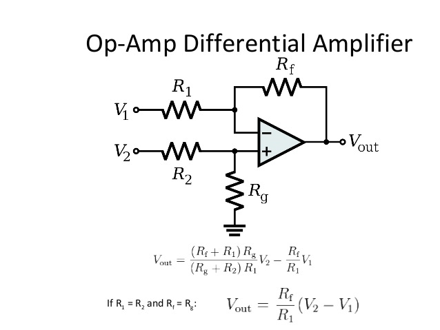

I meant a differential opamp circuit like this
(different image loaded because the one in the site is in the never-to-be-sufficiently-damned webp)

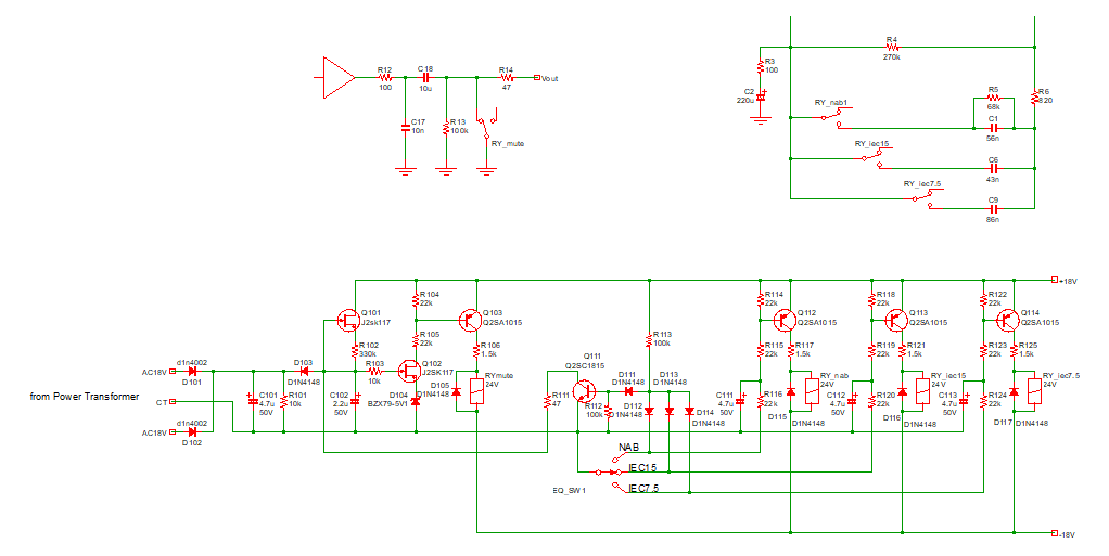

The mute circuit for EQ switching, but it should be noted in advance that this is not a sophisticated or simple circuit, as the method uses the (time-uncertain) open state of the non-shorting switch in the middle of switching.
The power supply of the amplifier is ±18 V after stabilisation using the main transformer, so it is assumed to be the secondary winding of 18-0-18 AC.
The block in the bottom left of the circuit diagram (Ref 10x units) is a delayed mute circuit when the power supply is switched on and off; DIYers often omit such a circuit, but I am not impressed.
Q101 and R102 are constant current circuits that charge C102 when the power supply is switched on. When charged to approx. 5 V, Q102 and Q103 turn ON and the relay for muting unmutes the output (top left circuit).
When the power supply is switched off (or an unexpected power failure), R101 causes C102 to be quickly discharged as well, so the mute relay is quickly switched off and the outputs are muted.
The delay time for un-muting can be varied by the constant current value of Q101; 3 to 4 seconds is reasonable.
The constant current value of the FET is because the current flowing through it is very small, can be calculated using the following formula.
Id ≈ | pinch-off voltage |/R102
Second, the bottom right block (Ref 11x unit).
The moment the rotary switch for EQ switching is opened in the middle of switching, Q111 turns on, discharges C102 and turns off the mute relay, muting the output. The relay for EQ switching is slightly delayed by the C111-113 to ensure that it switches on (or off) after the outputs have been muted.
Resistors R106, 117, 121 and 125 in series with the relay should be adjusted so that the correct voltage is applied to the relay; 36 V relays are not often found in the standard range.
The 2SK117 is discontinued, but an equivalent SMD 2SK209 is available. Alternatively, almost any other variety with a pinch-off voltage of -2 to -0.3 V and a breakdown voltage of 35 V or higher can be used.
Similarly, BJTs can be used for general purposes type as long as Ic = 100mA or more.
The diff-amp circuit of post #31 isn't appropriate for this use because it has conflicts between required input impedance and noise, but there are other ways to make a diff input, still with some (3dB) noise penalty, if really needed.

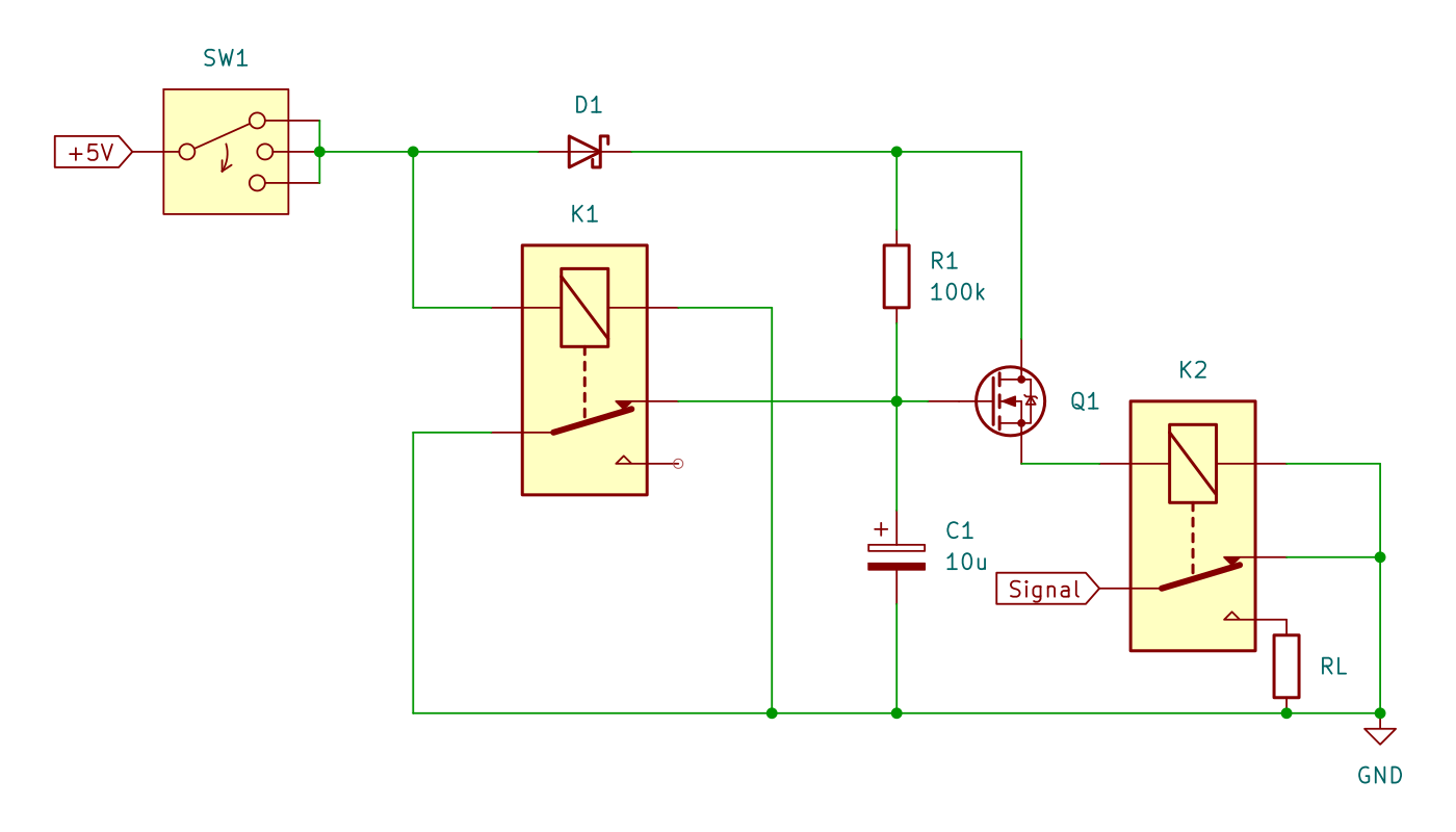

@mason_f8 That's very impressive and bit over my head. I was thinking of doing something quite a bit simpler to avoid switches in the feedback network entirely.
Each EQ board connects to a switch position and all positions connect to mute circuit above. When powered on, C1 slowly charges and eventually reaches Q1 gate threshold voltage which switches on K2 and delivers signal to RL. While SW1 is between positions, K1 switches off, discharging C1 and switching off K2 immediately. D1 prevents energy stored in the coils from keeping the relays on. When the new switch position is reached, C1 has to slowly charge again. Instant off, delayed on.
I could also use the above muting circuit and instead of each switch position controlling power to a board, use reed relays to switch the feedback network in a single board. I'm guessing that relays in feedback path, like your design, wouldn't be nearly as noisy as a regular mechanical switch?
#34 circuit, but the relay takes a little time for the contacts to return after the applied voltage of the solenoid is removed. There is concern that if the changeover switch is turned quickly, the K1 contacts may not switch back.
Also, the energy stored in the relay's solenoid is generated as a back-voltage after the applied voltage is removed, so a diode must be connected directly to the solenoid in parallel.
As Q1 is a source follower, K2 may not have sufficient voltage.
I have not experienced any particular noise concerns with relays. However, the current of the solenoid that turns on and off should not flow directly to the GND of the signal system.
Thanks for pointing that out, I hadn't considered that.
This is true, I could increase the control voltage if it doesn't work on the breadboard.

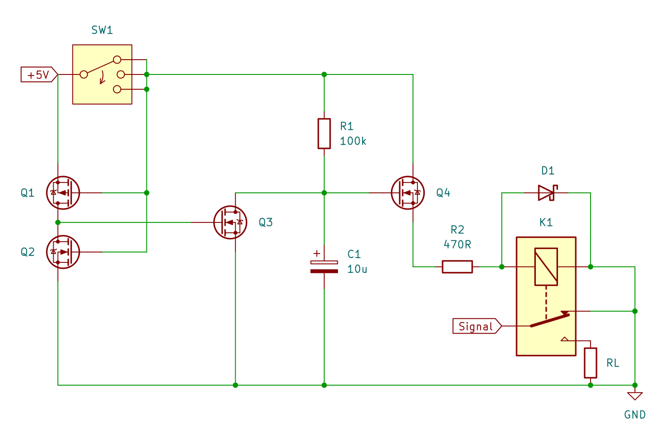

Here's another attempt using complementary mosfets to control the discharge instead of a relay.

The polarity of D1 seems wrong.
If Q1 and Q2 are fairly low on resistance MOSFETs and Q2 has a substantially lower threshold voltage than Q4, you might get a nasty overlap current bump after SW1 opens:
First, Q4, R2 and K1 pull down the gates of Q1 and Q2 well, so everything works as intended and Q3 turns on, gradually discharging C1.
As the voltage across C1 gets close to the threshold voltage of Q4, Q4's on resistance increases. When it becomes >> 100 kohm, the voltage at the gates of Q1 and Q2 starts to track the voltage across C1.
If Q2 has about the same threshold voltage as Q4 or higher, it will hardly conduct, like Q4. Only if Q2's threshold voltage is hundreds of millivolts less than Q4's, it might draw a substantial overlap current.
Possible solutions: the use of a small CMOS inverter for Q1 and Q2, a series resistor somewhere, using a Q2 that has at least as high a threshold voltage as Q4.
Reactions: John Driscoll
@MarcelvdG Thanks for that, I'll try a CMOS inverter.

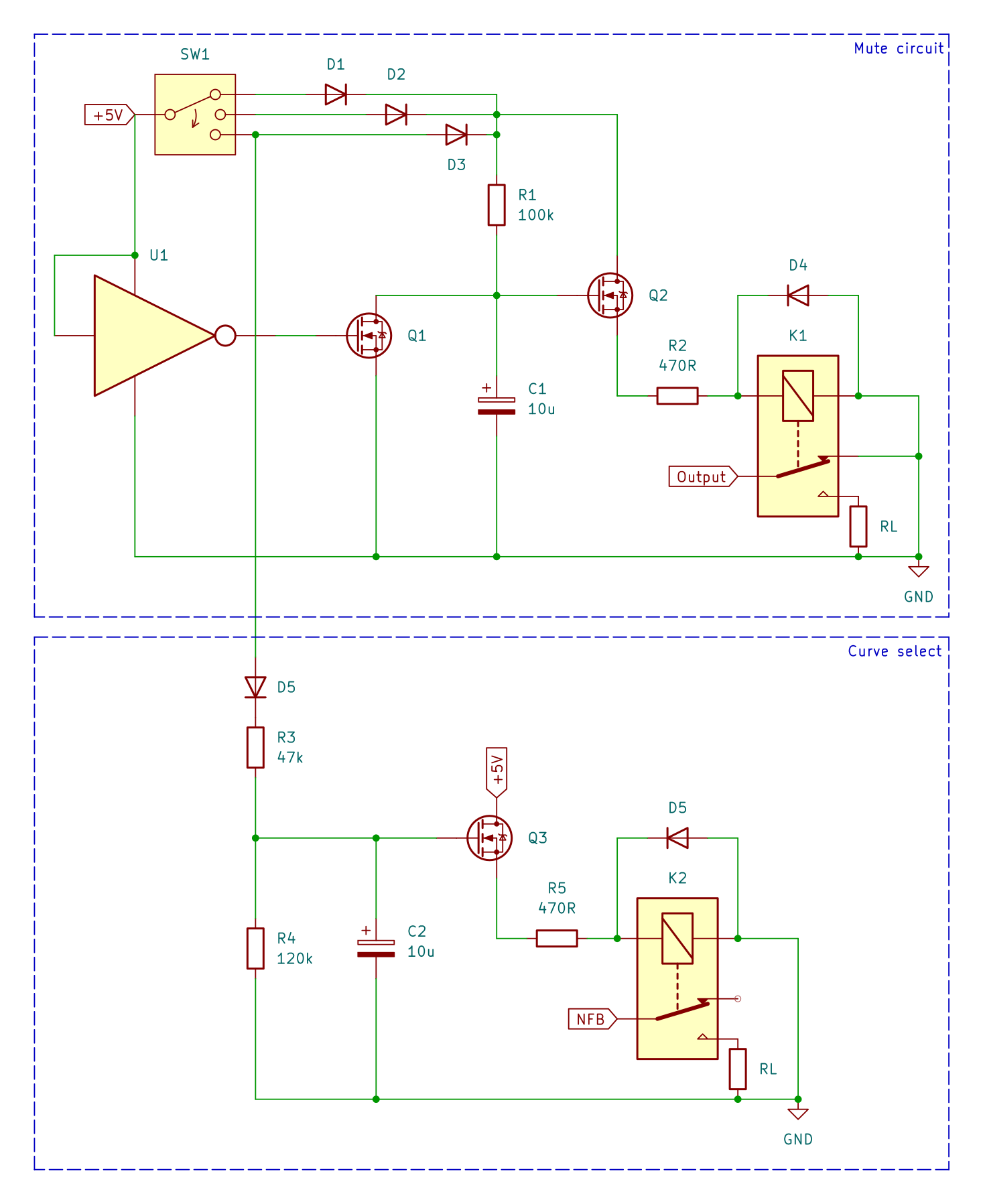

Also spent a little time playing around with a delayed on/off for the feedback network.
Each switch position connects to a curve select circuit. When switched, the mute circuit will disconnect output immediately, and the last position's curve select will disconnect after a short delay. The new curve select will connect after a long delay, and the mute circuit will reconnect output after a longer delay.
