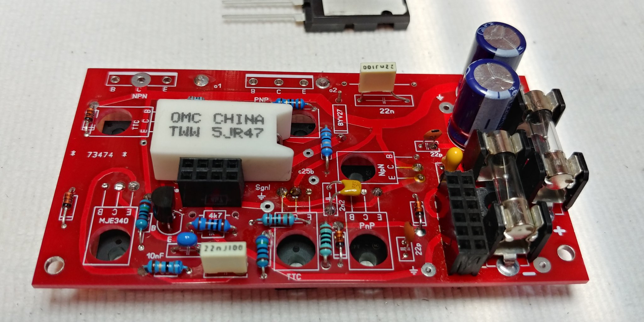

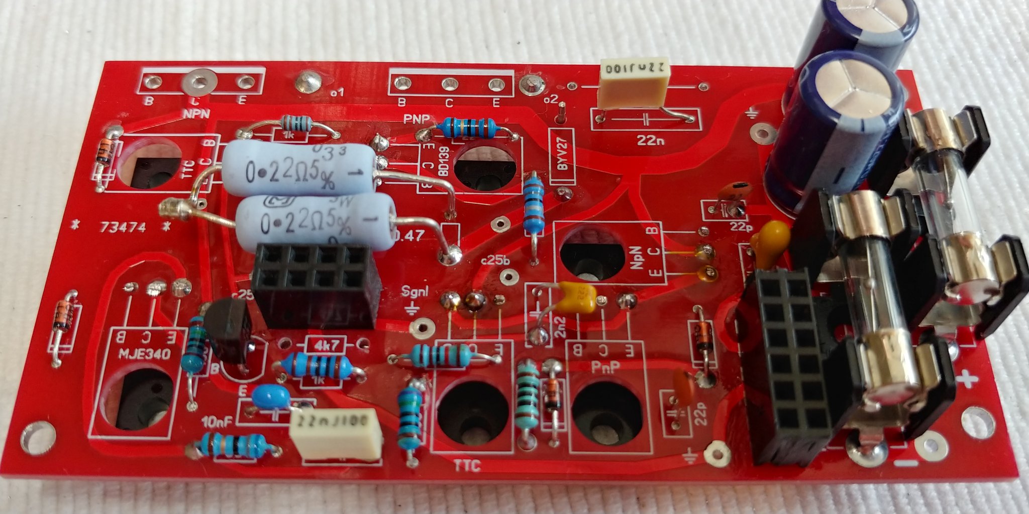

It looks promising, but I don't know how the 0.47 ohm will behave: it is probably inductive, and may have unexpected effects. In my build, I used two power-film 1 ohm paralleled (for compactness, mostly, I didn't consider the parasitic effects), but I had to replace the fast diode with an ultra-fast one, to get rid of inductive-like effects.
We will see how it works out. If you find yourself in trouble, it will always be possible to find a workaround
Reactions: minek123

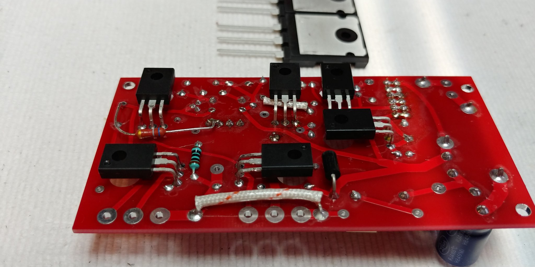

The first attempt to power the board (with plugged input/vas module) ended up with smoke from yet unidentified part.
When testing without input/vas module (bases of Q5/Q9 grounded) everything (including all voltages) looks normal.
Need to try to find out what exactly happened..

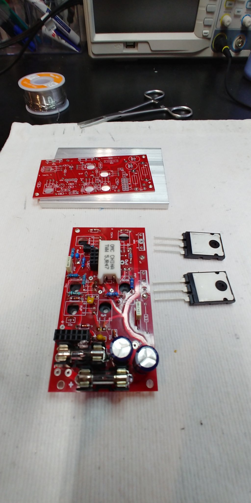

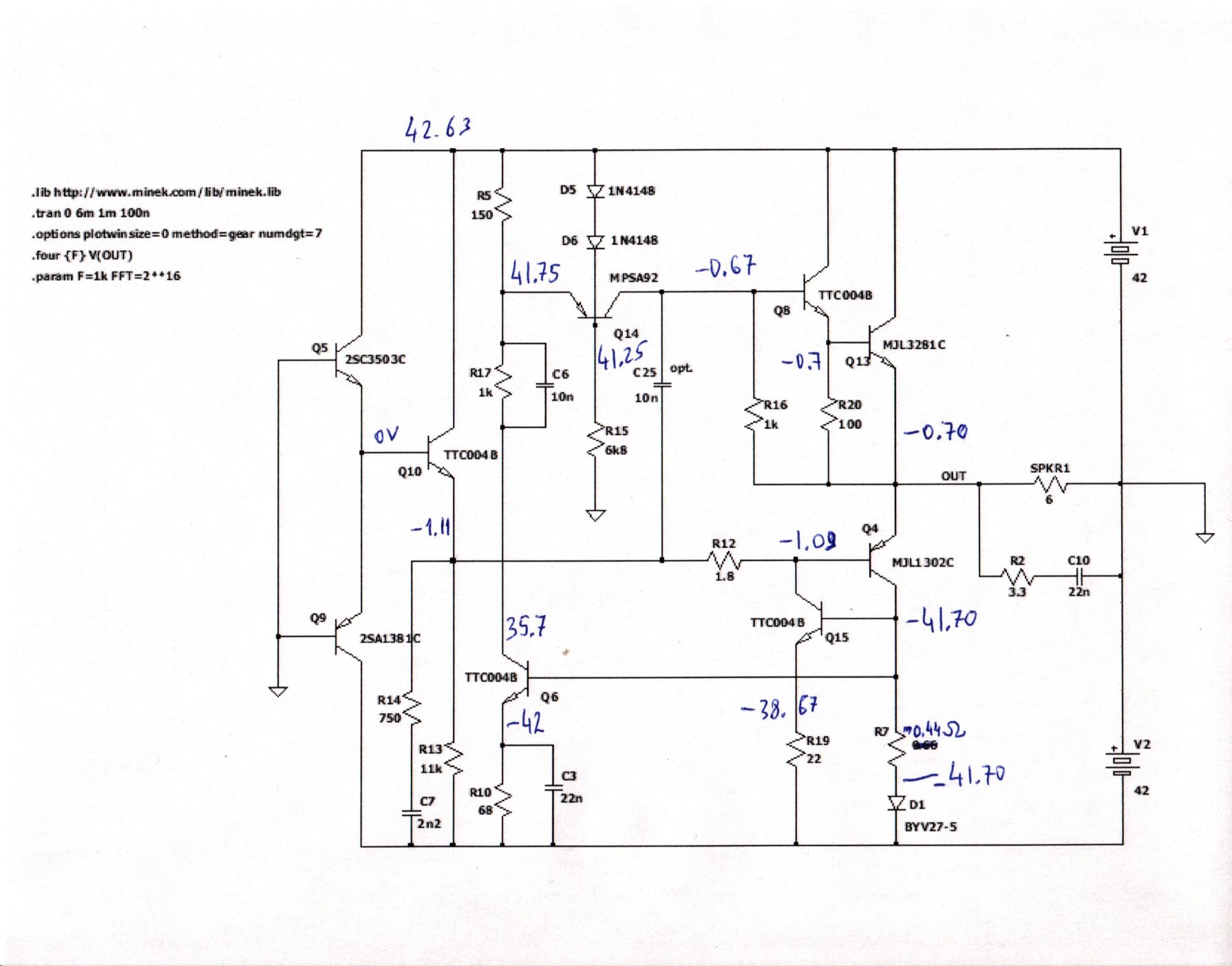

Had some time to try again. Testing amp built from schematic from the post #73.
PSU has current limit set to 10mA.
C25 is omitted on the PCB.
1) with bases of Q5/Q9 grounded, tried to connect sinus wave generator to the base of Q10.
Ranging input Vpp of the input from 0 to 12V, I can see on the output only approx 500mVpp
No oscillations as far as I can tell.
Idle current shown by the PSU (without any signal) is about 1-2mA
That's wrong - according to the sim (with grounded Q5/Q9), idle current of the OS should be over 70mA).
2) tried connecting the input/vas module again. This time the same module used in the sim (like in post #73).
Current limit set to 10mA again.
Oscilloscope shows random oscillations, and R10 gets immediately very hot (but not damaged).
Voltage on Q11 Emitter is about -8V (normally, without VAS it's -41V, just like in the sim).
Voltage on Q11 Collector is about 18V (normally, without VAS it's 37V, just like in the sim).
All these voltages and PSU current strongly fluctuate, and oscilloscope shows chaotic oscillations.
There is something totally wrong somewhere: R15 alone should consume ~10 times more than 1 or 2mA.
Injecting a signal at the base of Q10 with Q5 and 9 grounded will limit the signal to ~1.2Vpp.
Ideally, the signal should be injected from the junction of D7 and D8, from a low impedance source or with the upstream circuit disabled.
The tandem OP must be working in isolation before it is connected to the rest of the amplifier, and this means that the DC conditions have to be right.
The best troubleshooting method is probably to compare the voltages on the nodes of the real and simulated amplifiers.
This has to yield results, because the tandem engine works in sim, and reality: I have built it, and it is possible to infer the operation from mere inspection.
That's valid for DC only; once the loop is closed, instabilities may show up, but that's another story: everything downstream of Q5/Q9 needs to operate as an ideal unity gain buffer, having a rather substantial quiescent current.
Once that aspect is fixed, you may progress further
This I've already done in the 1st round of testing:
All the voltages were matching the simulated voltages in this case.
That was with Q5/Q9 grounded.
I'll try to investigate what's wrong with idle current (without input/VAS).
There is an obvious anomaly:
The voltage on the base of Q15 is -41.7V, but the voltage on its emitter is higher, -38.67V, which normally impossible.
The voltage on the base of Q6 is -41.7V, only 0.3V hiigher than the emitter voltage, which is insufficient, yet looking at the voltages across R17, the collector current is 6mA, enough to steal all the current from R5.
There seems to be a problem in the region of Q6 and Q15, or the associated resistors
