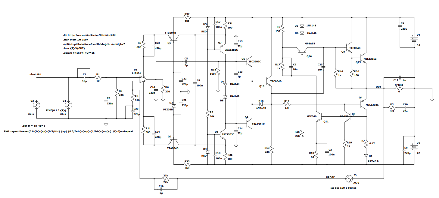

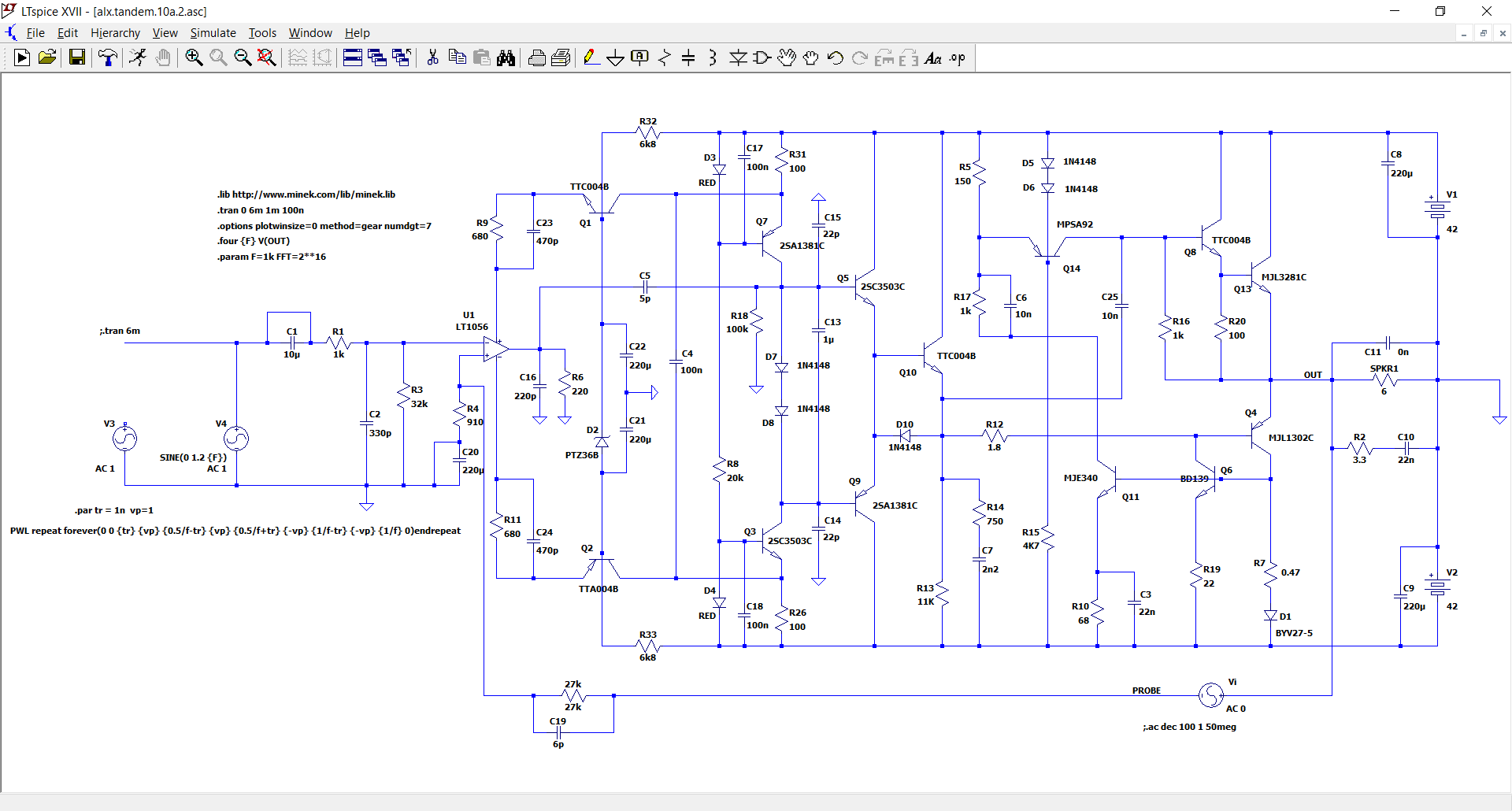

I tried square waves - looks like E of Q10 is better choice to connect C25, than B of Q4.

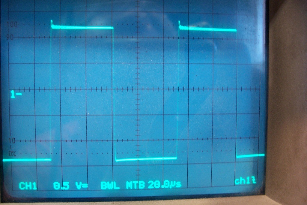

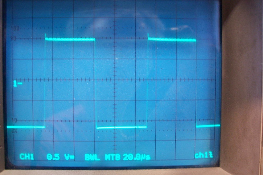

I tried in reality, with and without Zobel, and also at medium and high (but not clipping) levels:
First, without Zobel and high level:

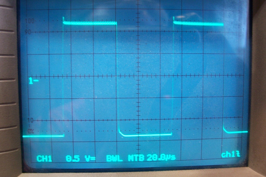

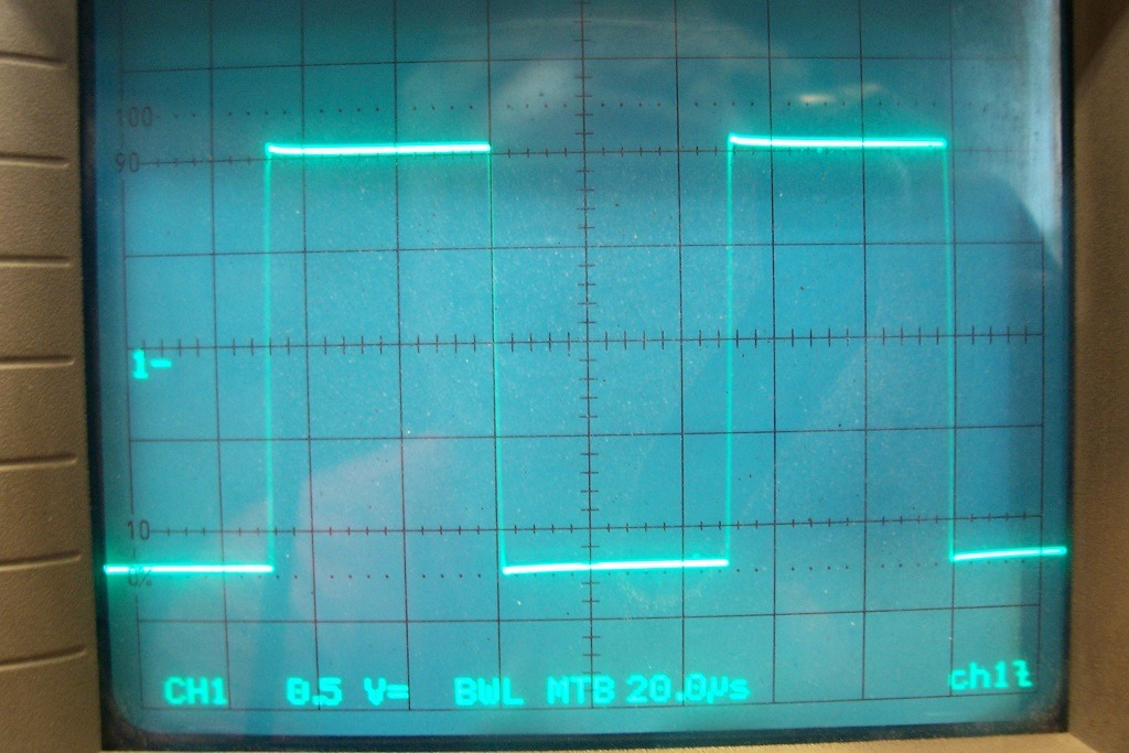

Then medium level:

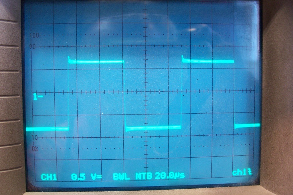

Zobel + high level:
Medium level:
There is always some imperfection present: low-level oscillation, edge chamfered.
Values could be refined to iron out the last wrinkles, but unfortunately simulation is of little help: it would have to be done in reality.
Without the Zobel, the waveforms are almost good: it is just the HF instability that ruins it. Maybe time to reintroduce the ferrite bead
I have tested the relatively minor mods on the OP stage: that's the only part I test, and R18 is out of it. However, before closing the loop, it is essential to have the OP well-behaved (unless you apply some kind of active compensation, but that's not the case here).
The minor mods did change the behaviour though: I am not going to post additional pics for that, because there are different behaviours according to the level.
To summarize: up to 10Vpp, the square is nice, apart from a small positive overshoot, not really a problem.
After that, the positive edge becomes very messy, jagged, then the "chamfer" also appears, and finally just before clipping, instabilities appear on the positive plateau.
Nothing that a ferrite bead could really cure, thus I didn't make the test.
This is the best version, including the latest bias adjustments:
The square response is absolutely perfect; however, when negative clipping begins, a "chamfer" also appears, at the end of the trailing edge, but this not really a problem.
With a triangle, the clipping looks the same as before: not spotlessly clean, but acceptable.
My tests are made at 16V; with 42V, the values of R13 and R12 should be adapted.
I have left D10 in place: it is inactive, but it does no harm.
With R10 increased, C3 can be made smaller
I think it is ready, but C4 makes me uneasy: it links Q7 and Q3 which are each referenced to opposite rails.
Any noise on the supplies will be injected into the signal path.
If you cannot dispense with it, try to find an equivalent effect/configuration that does not degrade the PSRR

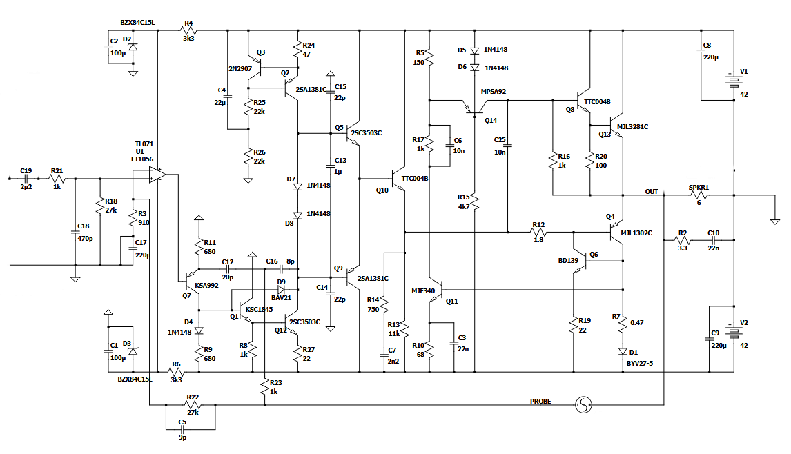

Perhaps R6/C16 should be going to signal ground? On my PCB they go to dirty ground.
Everything except input network and C20 goes to dirty ground.
All waves look great except for these small movements/waving up-and-down....

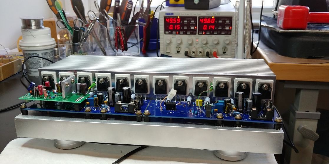

I'm planning to build Tandem amp just like this OS stage platform (on the 2nd picture) that can take doughterboards with vas/input.
I already have several different input/vas modules already built, so I just need to build the Tandem OS part with heatsink, connectors, etc...
OS platform with HexFets outputs:
Yes, I tried (2 zeners referencing ground, just like caps). didn't help.
Also tried shorting R9/R11 and changing compensation slightly so it works with direct connection between op-amp rails and emitters.
It works, just like original schematic, but the movement of waves on the oscilloscope is still there.
