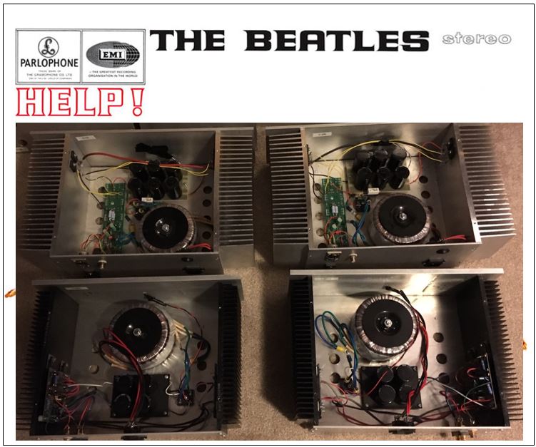

The next conquest - I picked these up from a friend last night to work on them.
2 pairs of Aleph J monoblocs. Mine are Minis, these appear to be the higher power versions.
I'm going from memory on what I saw when I opened them up briefly before loading them into my car.
Each one uses a toroid and single rectifier. So one set of secondaries isn't used. One pair may have CRC power supply. One pair looks like C only. No bleeder resistors. No safety grounds. Trannies look like AnTec with 2x 20V Secondaries. My old amp had 25VCT Hammond, now I'm using 2x 15V. I don't know how the 2x20 will do, looks like I'll be learning more about the voltages, resistors, etc as I go through this journey.
One set of boards look like the non-Mini version of the BrianGT boards in my Mini, with snap-off daughter boards. The other pair's boards are long and thin with MOSFETs mounted to heatsinks and hard wired. These look very similar to the ones in one of my Mini-J, where mine use a pair of MOSFETS, and this uses more.
One pair of monoblocks has XLR and RCA connectors. One has RCA's only.
First things first, document PS and amp schematics, measure PS voltage and bias. Then it will be time to make a plan, buy parts, and get to the bench.
Pix and details to follow when I get time to open them up and document them.

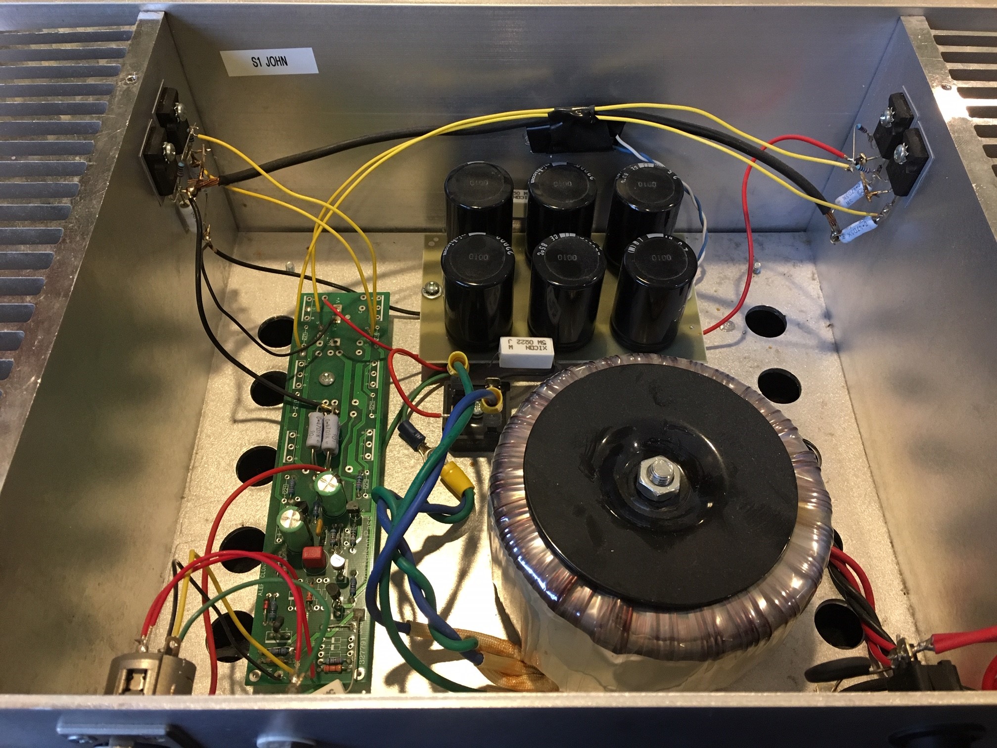

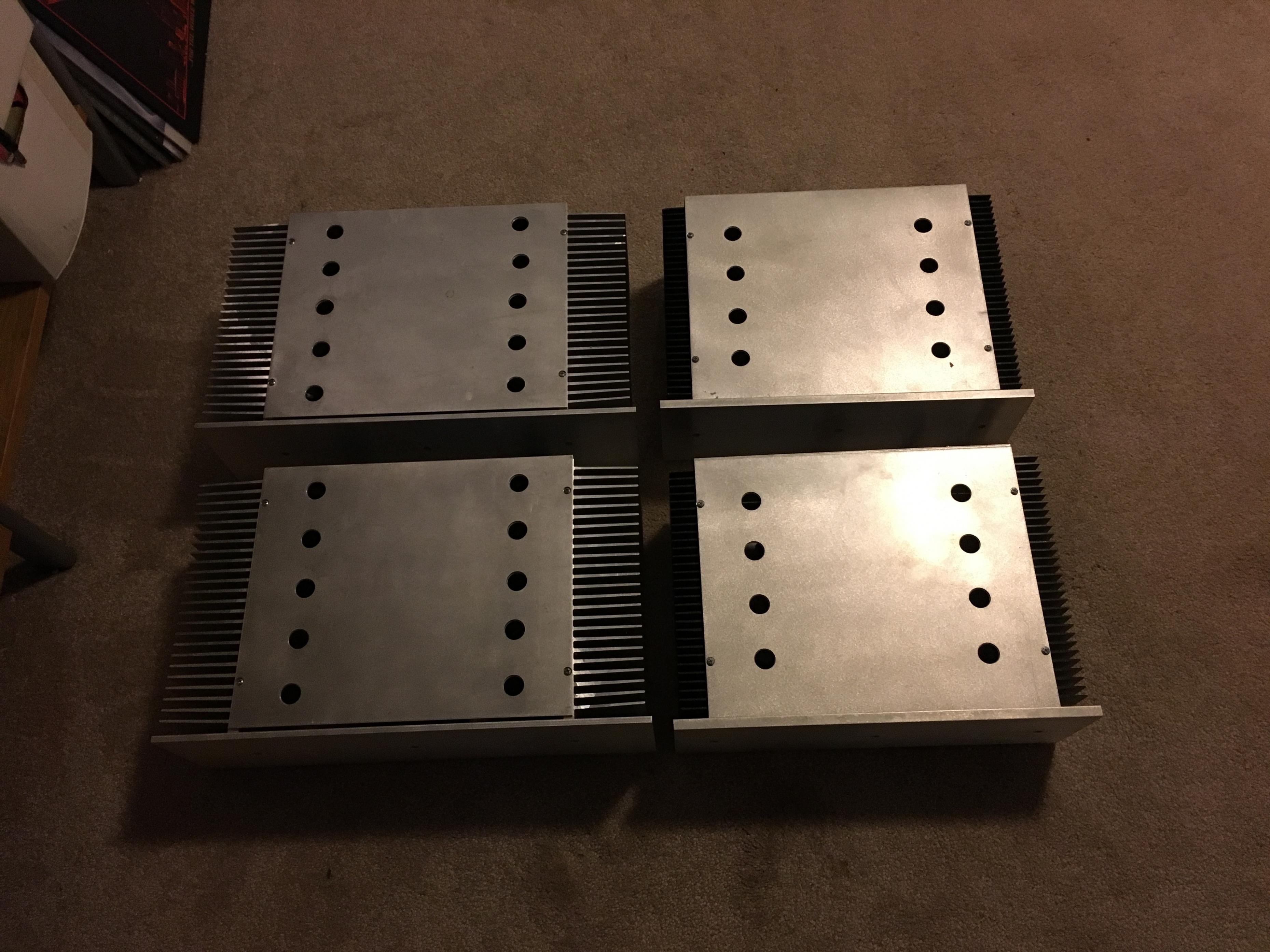

This is the part of the story where we introduce more characters. They are twin cousins to TallBoy and Shorty.
Meet John, Paul, George, and Ringo.
John and Paul have silver heatsinks, and are twin cousins to TallBoy. They have the Silver Heatsinks, and use the same base 327791 PCB’s as TallBoy, with the MOSFETS mounted in a more “freestyle” fashion.
George and Ringo have the black heatsinks, and are twin cousins to Shorty. They have the black heatsinks, and use what appears to be a different generation Aleph board that looks related the BrainGT boards in my “shorty” amp. Except these have the snap off boards for the MOSFETS.

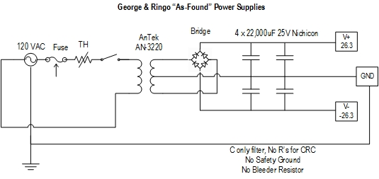

We’ll come back to TallBoy and Shorty in another scene. There’s more work to do there. I’m going to ensure the hot is fused, not neutral. I’ll be twisting toroid wires, playing with rotating the tranny, adding more ground wires between the PSU boards, tweaking how the thermistor is connected to chassis, and putting in fast diodes. If that doesn’t get me where I want to go, I’ll look into a scope, Quasimodo, snubbers. If THAT doesn’t work, I’ll be back for more. Perhaps CRCRC? Perhaps more work on grounding?

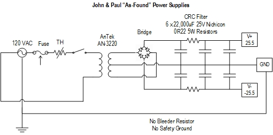

Back to John, Paul, George, and Ringo. You’ll see the wiring needs updating for safety. One pair has CRC PS, so I may work with that as a start. They all will need upgrading diodes and making the wiring safer. I actually need to listen to them, too. That’s one thing I haven’t done yet.

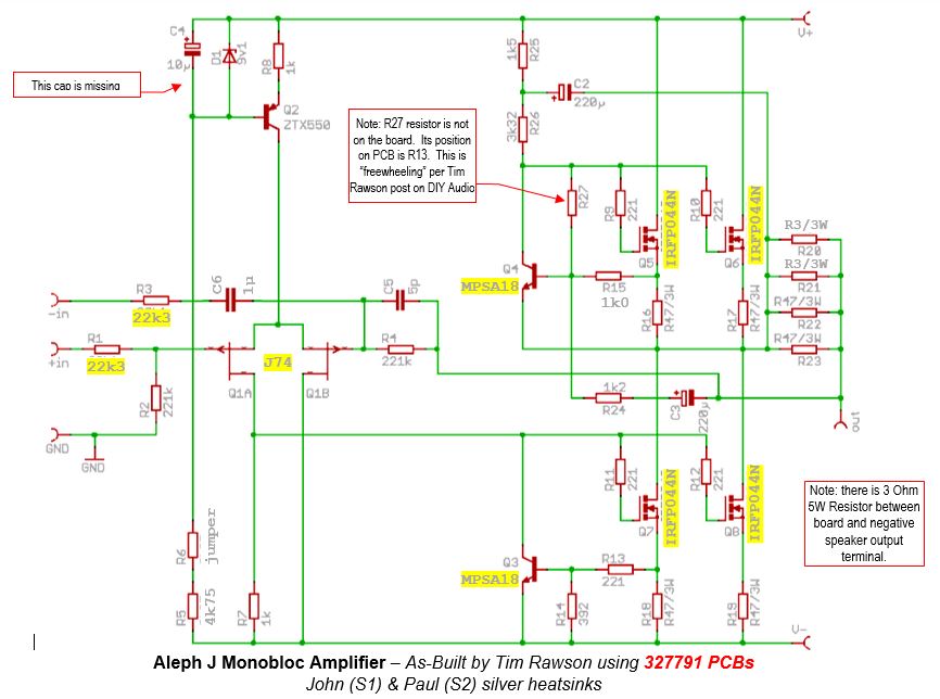

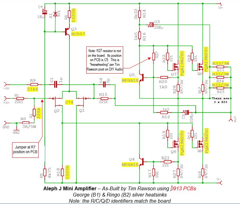

I’m back to one question that bugs me. What is with the 3 Ohm resistors on the negative speaker terminals? Any ideas? Can I remove it?
I documented them with "As-Found" Schematics you can see. Some of the resistors look to be values that were likely in Tim's stash. Close enough, I'd guess. Transistors were probably what was available at the time. They also follow the "freewheeling" philosophy on the missing bias adjustment pot/resistor. I highlighted items in yellow that deviate from the base Aleph J schematic.
Thoughts or suggestions for John, Paul, George, and Ringo?

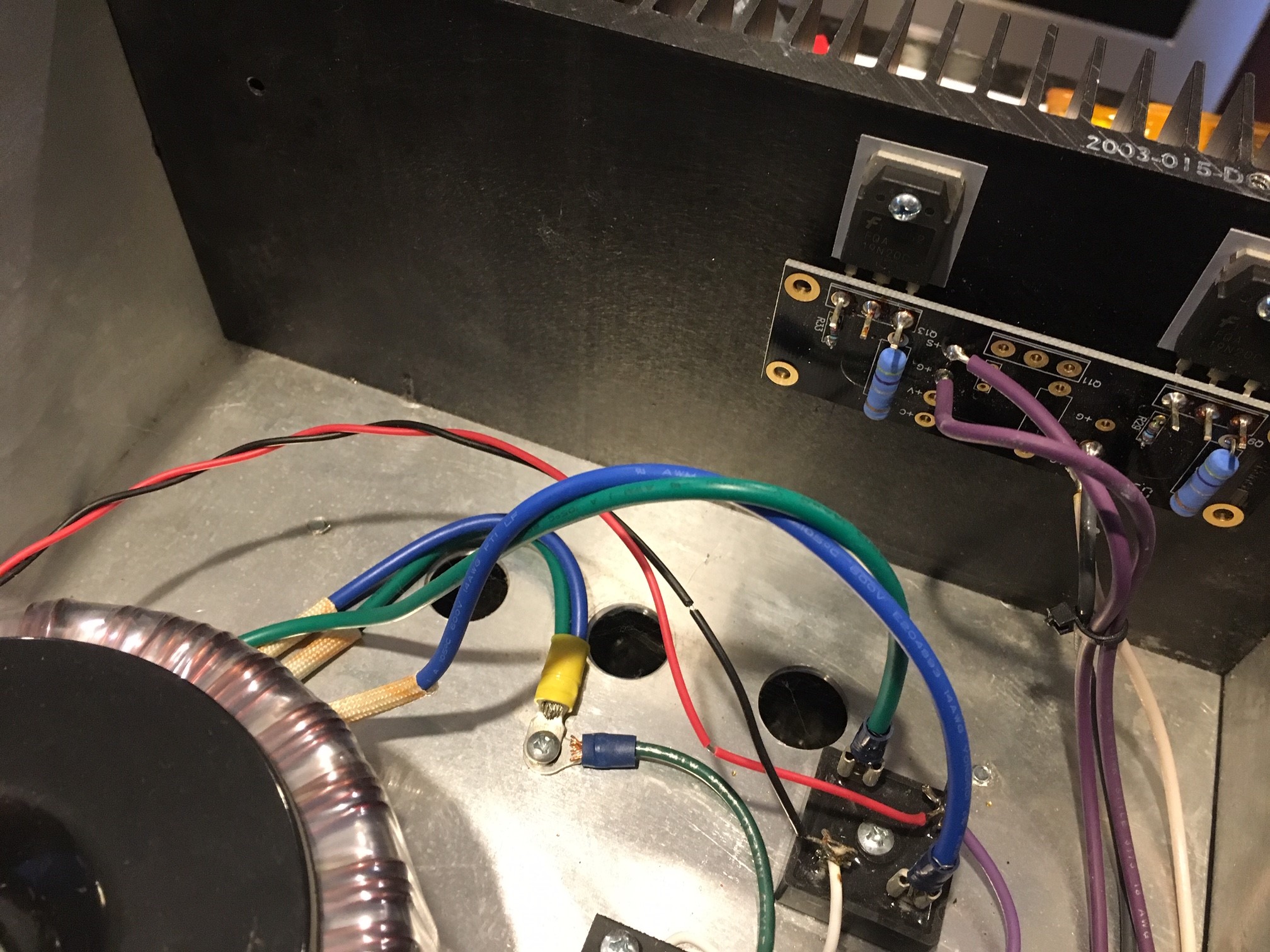

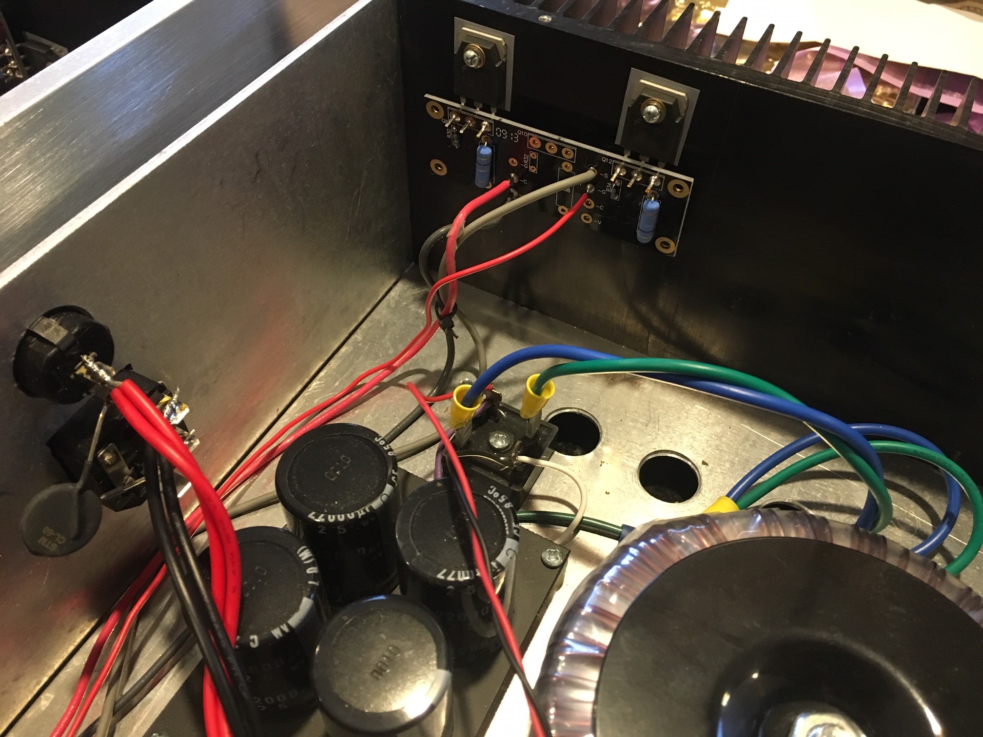

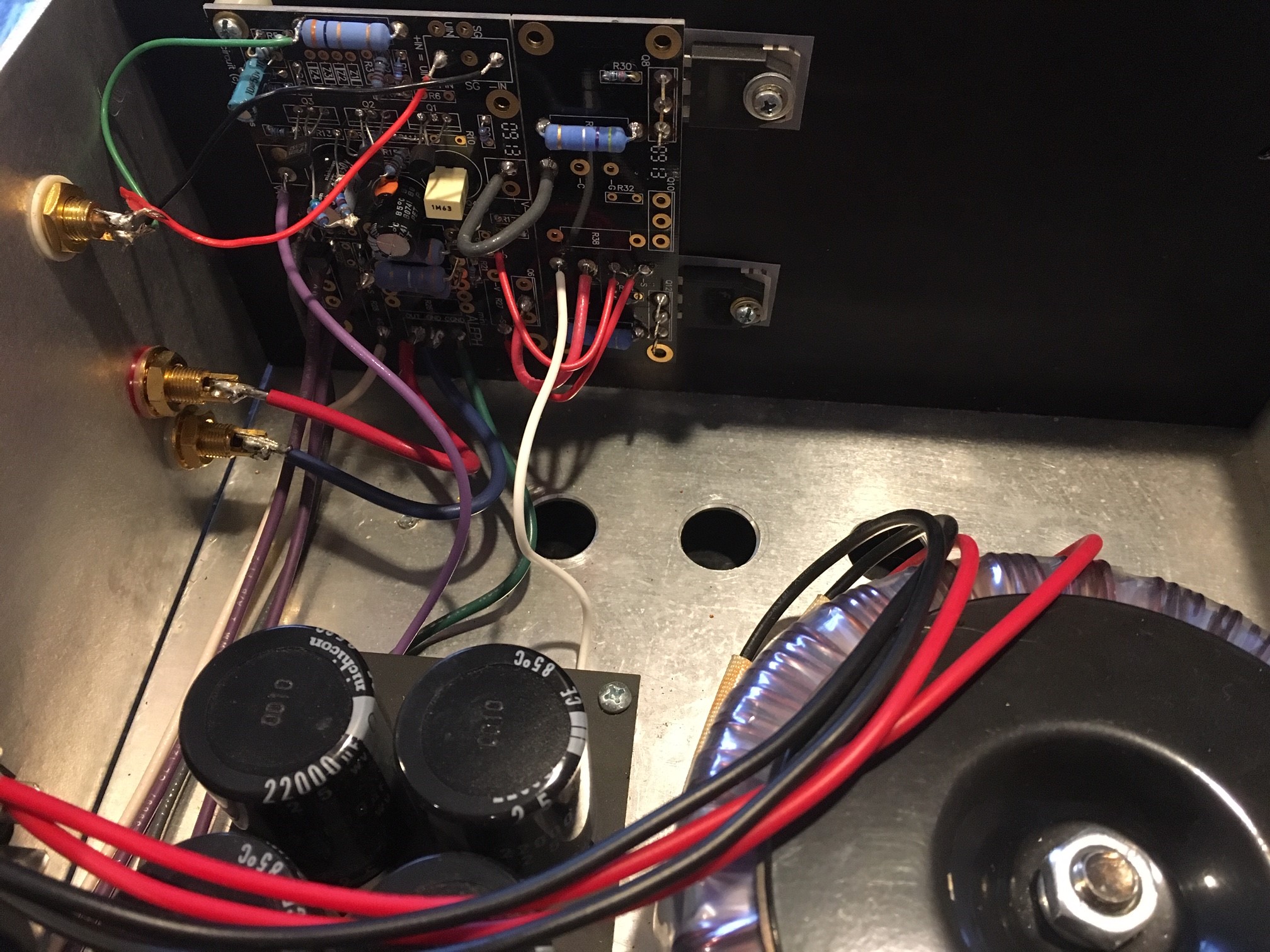

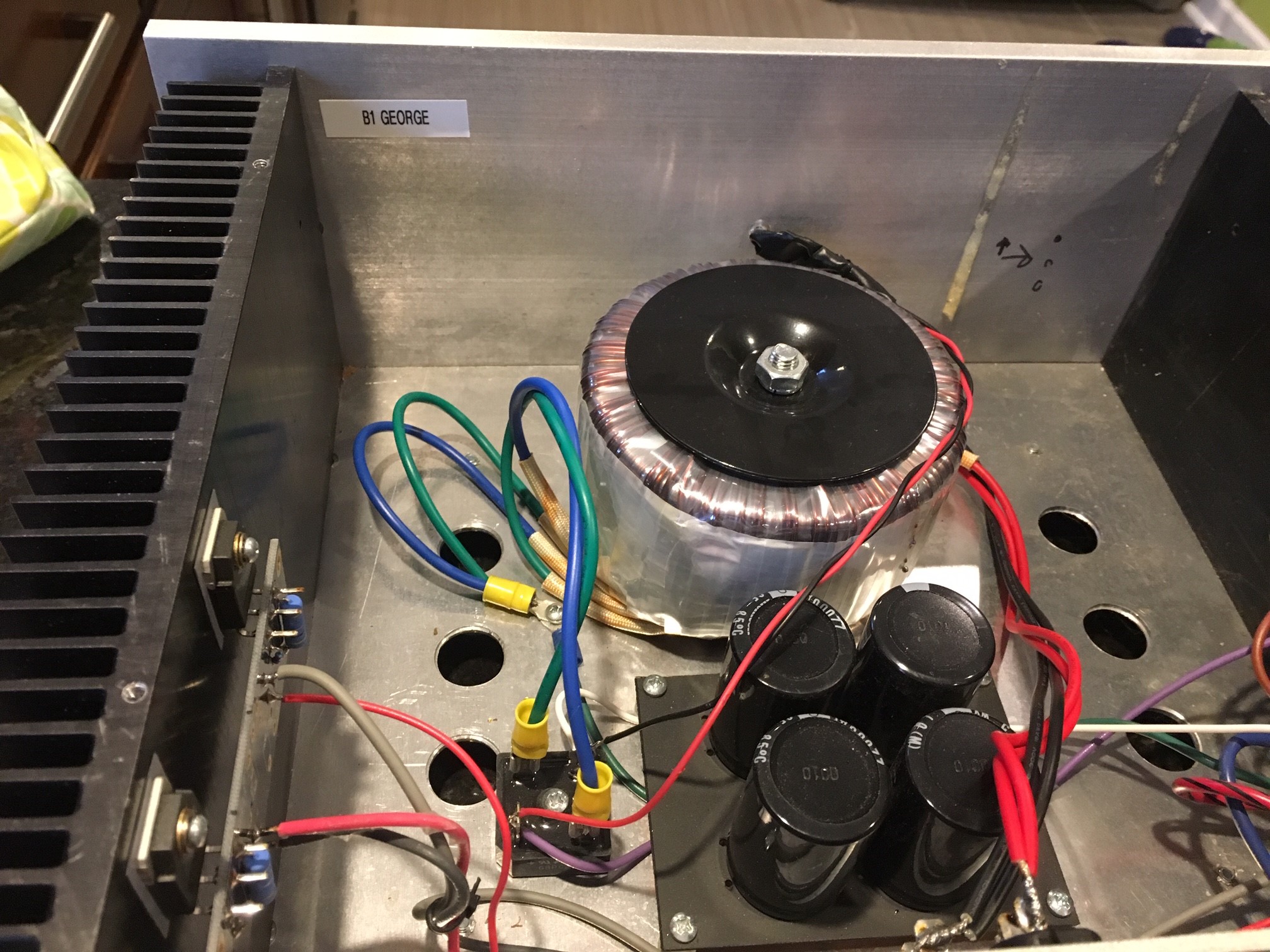

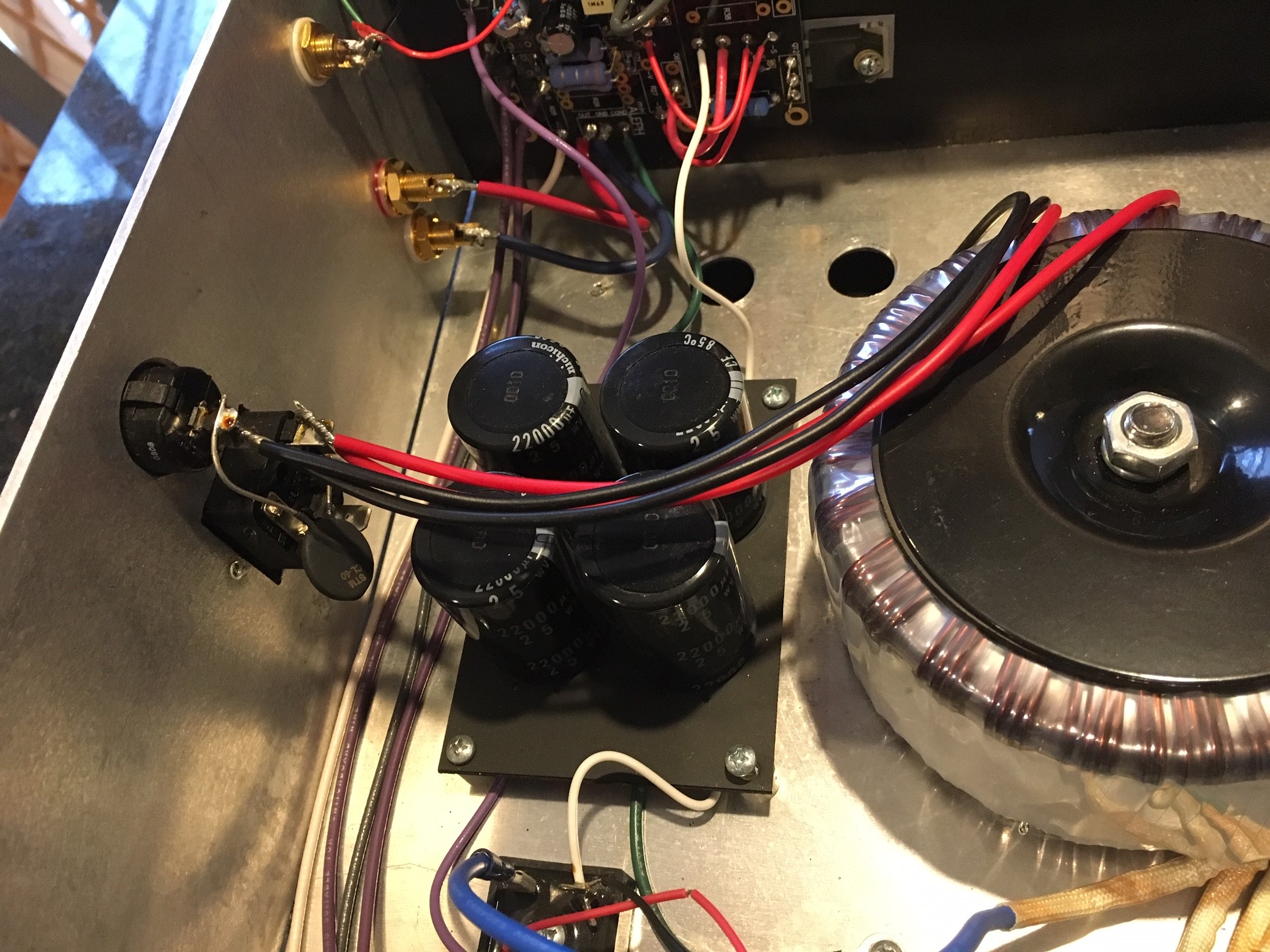

And now some pix of the black heatsink amp "George"

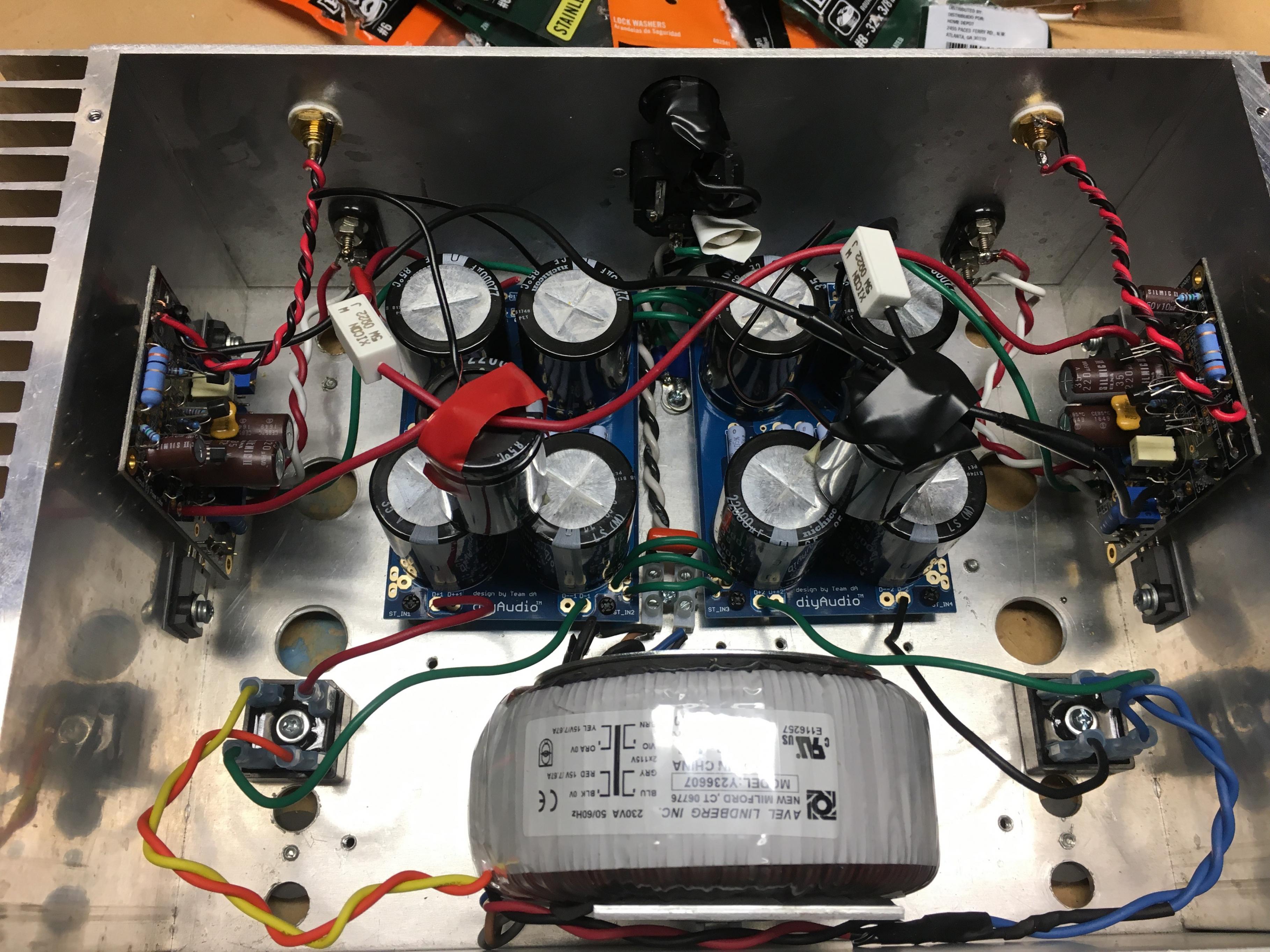

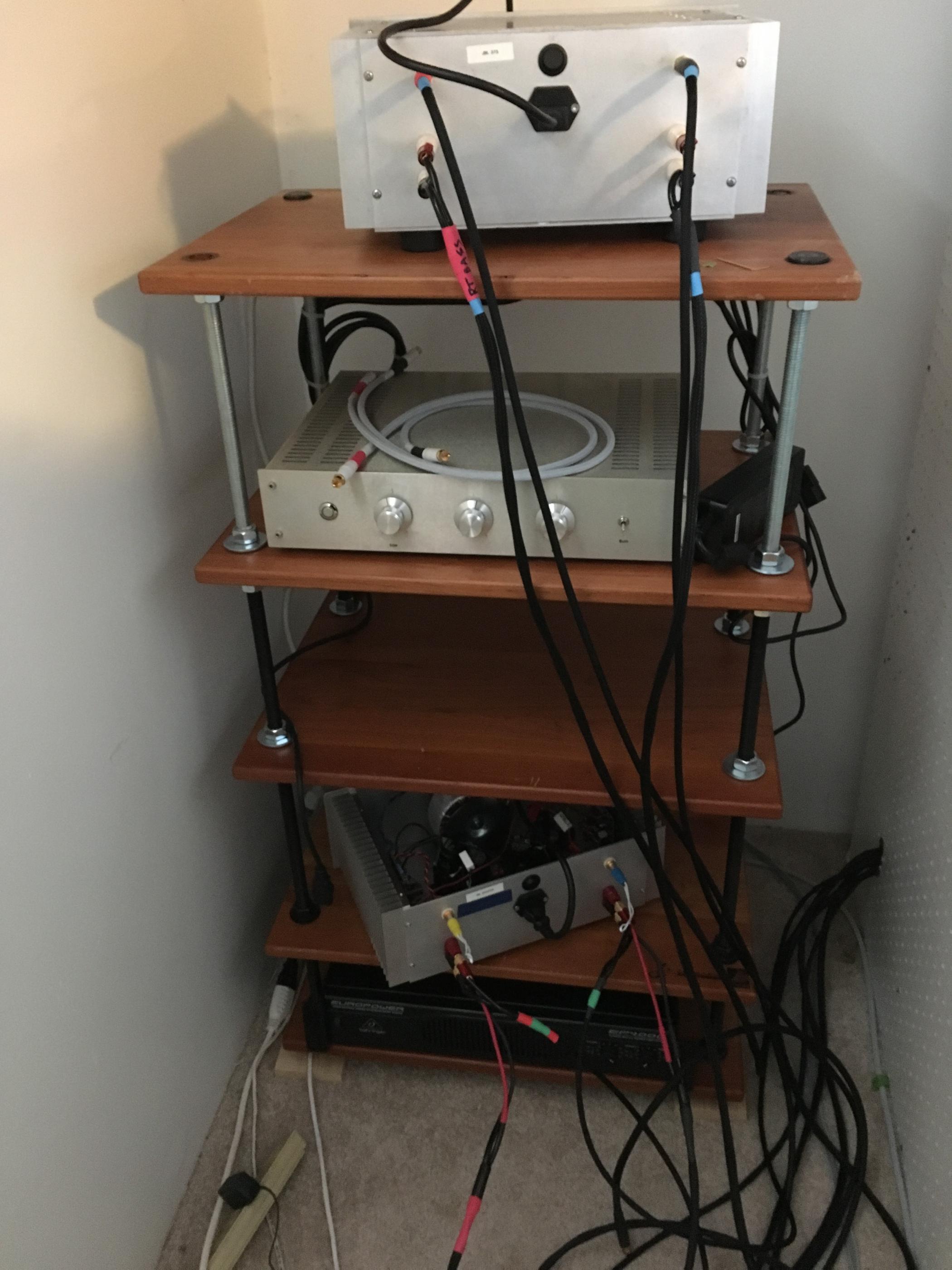

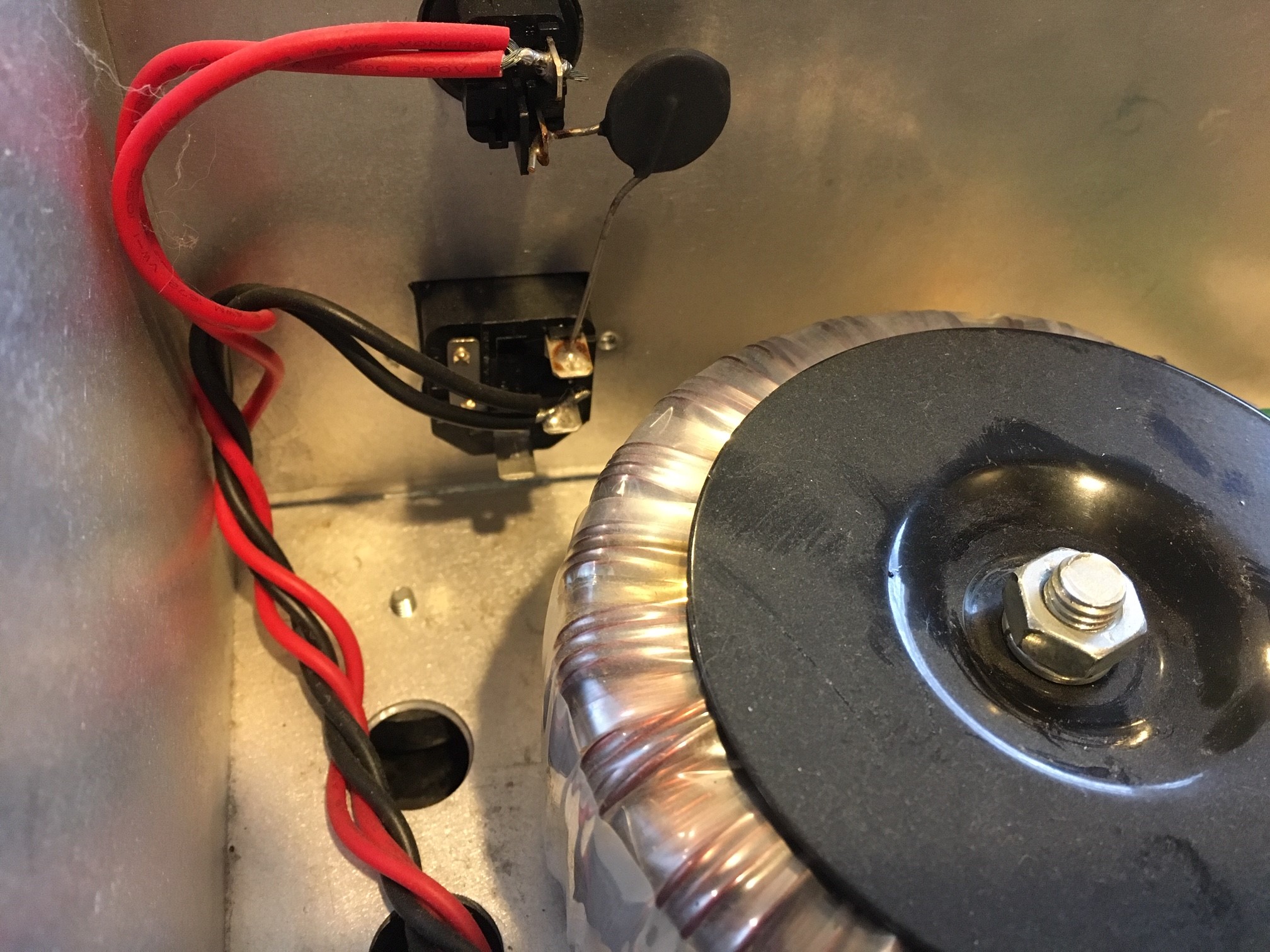

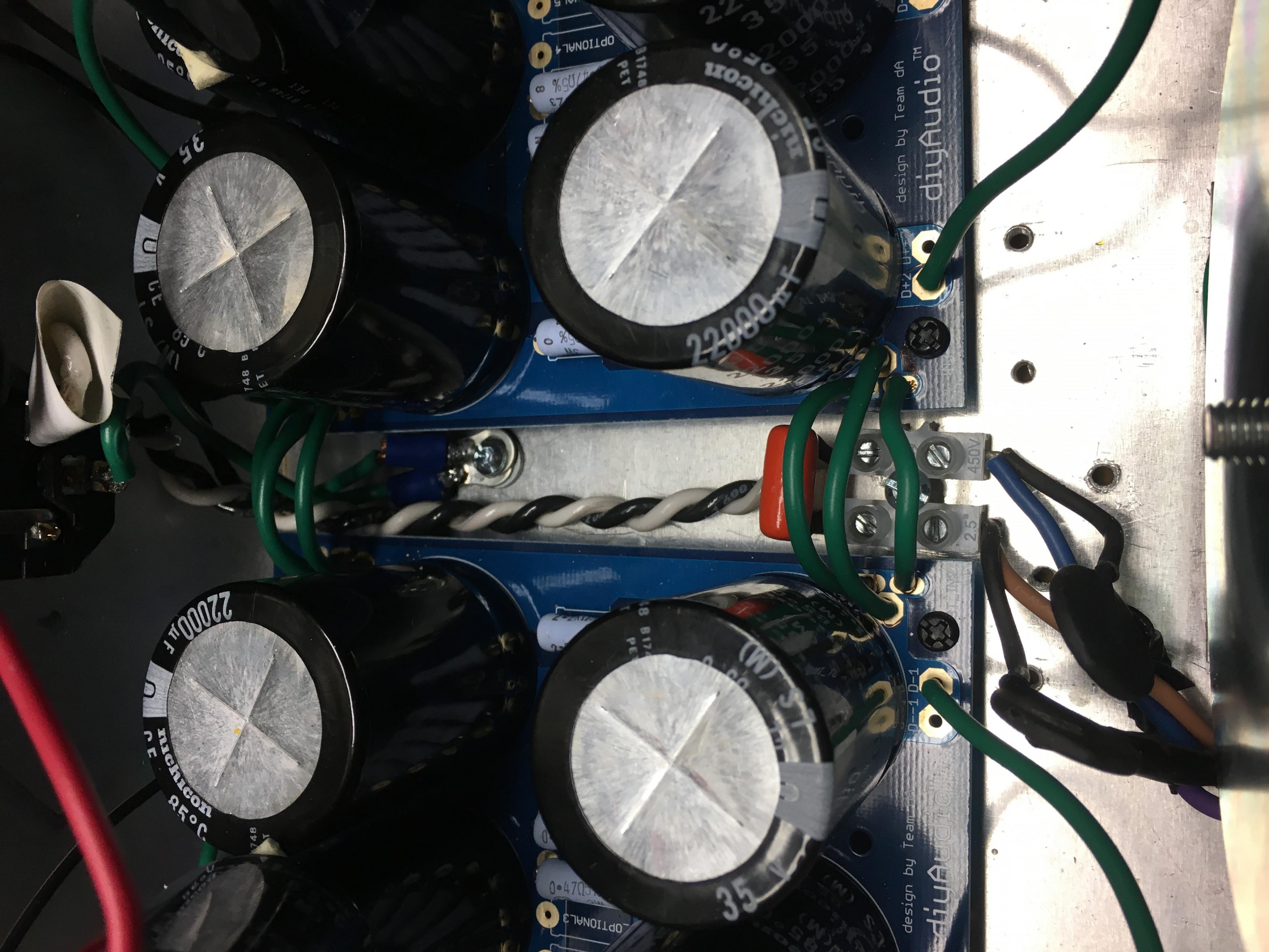

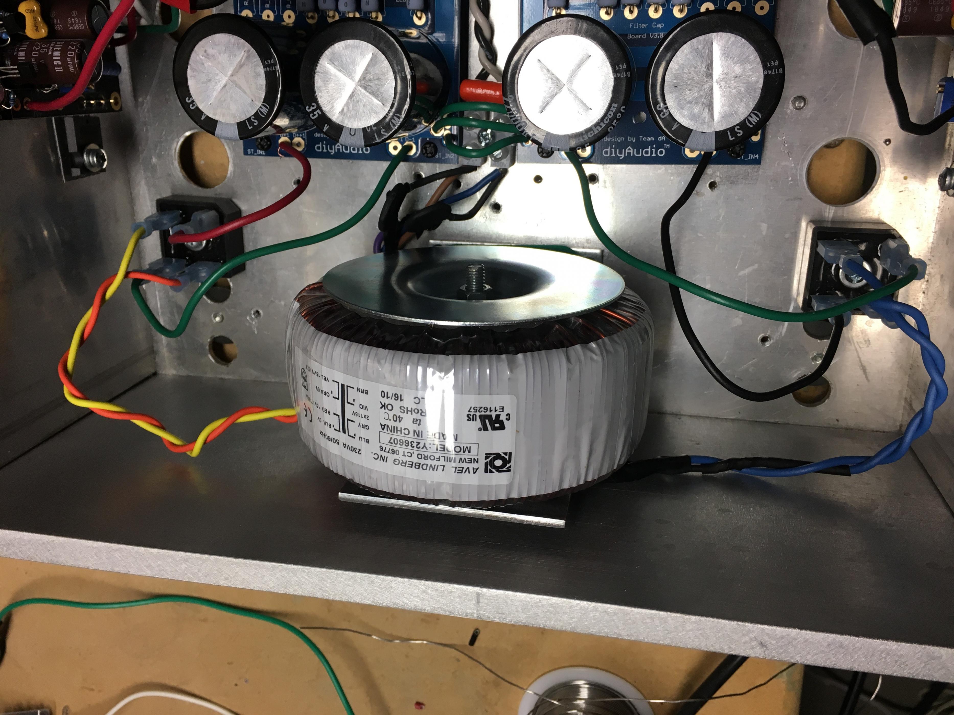

Back to Shorty.
I thought I would try some things from this thread/board and some ideas from some calls with Jim T (6L6) before making a parts order. I’ve been too busy all week to sit down and make a shopping list and look up parts at Digikey. And let's work with what I have first. Maybe the fix will be free? Wishful thinking.
First wave of changes:
  • Flipped the transformer around and twisted secondary wires, played with flip/flopping secondary wires
  • Added more ground wires between PSU boards (now 6 total)
  • Swapped 1k resistor and trim pot between R7/R8 positions
  • Test and turn DC Offset down. ~3mV on one channel, ~2mV on the other when cool
  • Added 2 more ground wires to play with some grounding at RCA’s (left them taped up).
  • Put Thermistor right on the PSU board and down to chassis. Shortended earth ground wire. Both connect at one screw between PSU boards now.
  • Checked the grounding with the CL60 place.
o Power supply ground to chassis = ~13.8 Ohms
o RCA Negative to Chassis = ~13.9 Ohms
o Speaker Negative to Chassis = ~13.9 Ohms
o IEC gnd pin to chassis = 0
Still hums.
Next: remove RCA input ground wire use the pigtails to go to PSU ground directly. No change.
Next – cheap and dirty (and temporary!) CRCRC filter. I used the ground pigtails and cut the V+ and V- wires. I got a couple 22000uF caps from the original amp board and some 0R22 5W sand resistors from another amp and put it together. Double sided foam tape to hold it together. Voltage dropped from +/- 19.9 to +/- 19.37 at the rails. Check DC Offset and Bias. Plays music. All good.
Still Hum.
Crack a(nother) beer and search more threads with “aleph” and “hum” as key words. Wow, I’m not the only one!
Lift one RCA input ground at the connector = louder hum
Tried 14AWG wire between RCA Input Grounds with and without one of the RCA grounds connected. Hum
I read something about shielded interconnects and problems. I make my own interconnects using Belden 1505F (RG-59/U Coaxial Cable 22 AWG Stranded Copper Conductor Dual Shield 75 Ohm), so this got my interest. The ones on my bench are about 1M, and are connected a Sonos Connect direct to the amp. That’s how I’ve been testing. Sonos to amp to some cheap Yamaha surround speakers I pulled out of my living room.
I found a vintage pair of Radio Shack RCA’s a nearby box and decided to try those. When I unplugged an RCA things changed – hum volume was not the same. This got me thinking. Perhaps I have a ground loop related to the inputs?
Take a step back, let’s take a different approach. First I played with this on my bench, then I confirmed it on my horns:
Both RCA inputs shorted – quiet
1 RCA Shorted, one RCA Open (nothing connected at all): Short channel = quiet, open = hum
1 RCA Shorted, one RCA connected to preamp. Both quiet
Both RCA’s to preamp = hum
One RCA to Preamp, one RCA open. 1 quiet, 1 hum.
So – based on that… What should I look at next?
Something in the amp?
Jensen Isomax or some DIY equivalent?
I bought a Quasimodo board from MPAudio today. I put together the parts BOM. And I’ll need a scope.
I was also going to get some Schottky’s to replace my diode bridges and play with the power supply some more.
Before I buy the scope, any ideas based on the inputs?

Wow - you've been busy here! A few thoughts about places to look - I'm making a bit of a stab in the dark here...
Are you using the original bridge rectifiers or have you tried using known/new ones? I've had some issues with a rectifier that was on the edge of failing and it introduced lots of transformer groan that was coming through the speaker outputs.
Are you certain that the output mosfets are properly insulated? Might be worth removing the boards and checking the physical area where they are mounted to make sure they are smooth, no unintentional grounds, no holes/piercings in the silpad?
How about the RCA input jacks? If they are not fully isolated, you could be introducing ground hum.
I'm just trying to extend the generally poor construction techniques that you've highlighted to other areas of the construction...
Joined 2018
Eric,
Bridges are new as of last month.
I measured RCA's to Chassis and Amp ground. All as expected.
Nothing looked wrong when I had the MOSFETs out. Insulators and heatsinks looked fine. That was all torn out and reassembled yesterday. I'll be doing another teardown / rebuild this weekend to take out the extra RC in the CRCRC and fix up the wires I clipped. I'll have another look.
As an aside, maybe place that terminal block on something non-conductive for safety. It looks like a bit of uninsulated wire poking out, if that gets in touch with your chassis the hum is the least of your problems ;)
What happens if you lift the ground connection from one of the channels to the PSU with a resistor (just for testing)?
Thinking way back, my first mini A (the first amp I ever made that didn't have a fire :) ) had hum with similar characteristics. I don't think it was an 'aleph' thing though :)
I recall taking the psu ground to one channel, then bringing the ground from that channel to the other channel. 'series' ground I guess....
it did work .
