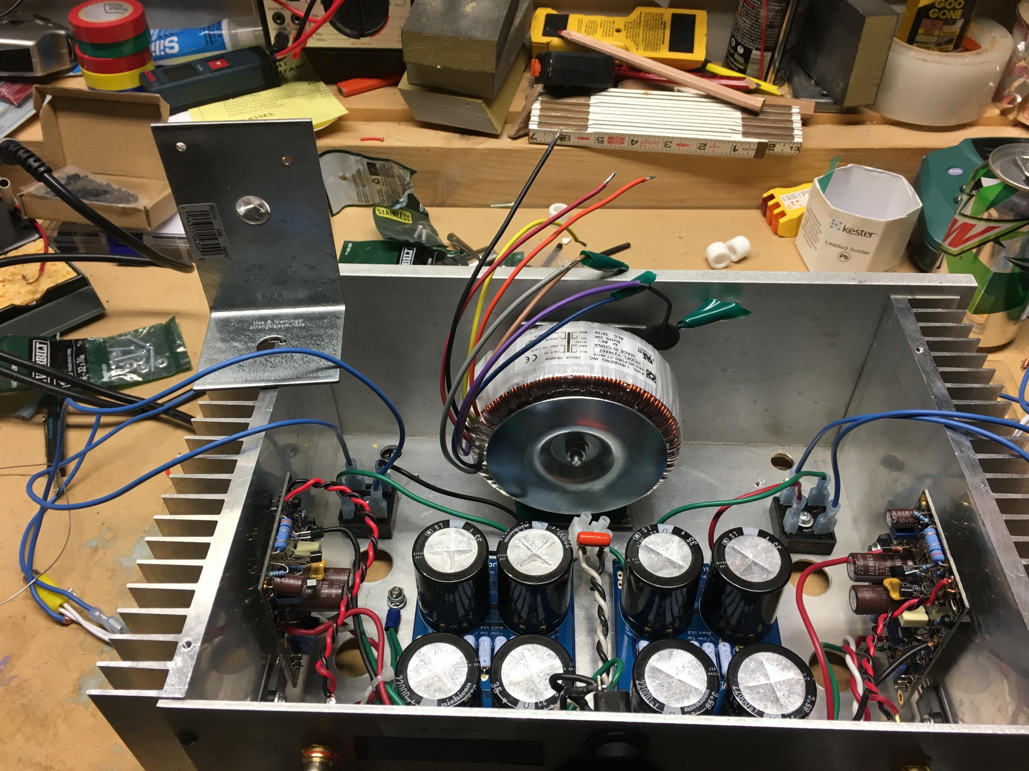

It was a good weekend! My transformers arrived. I got Avel Lindberg 230VA 15+15V (model Y236607) transfomers.

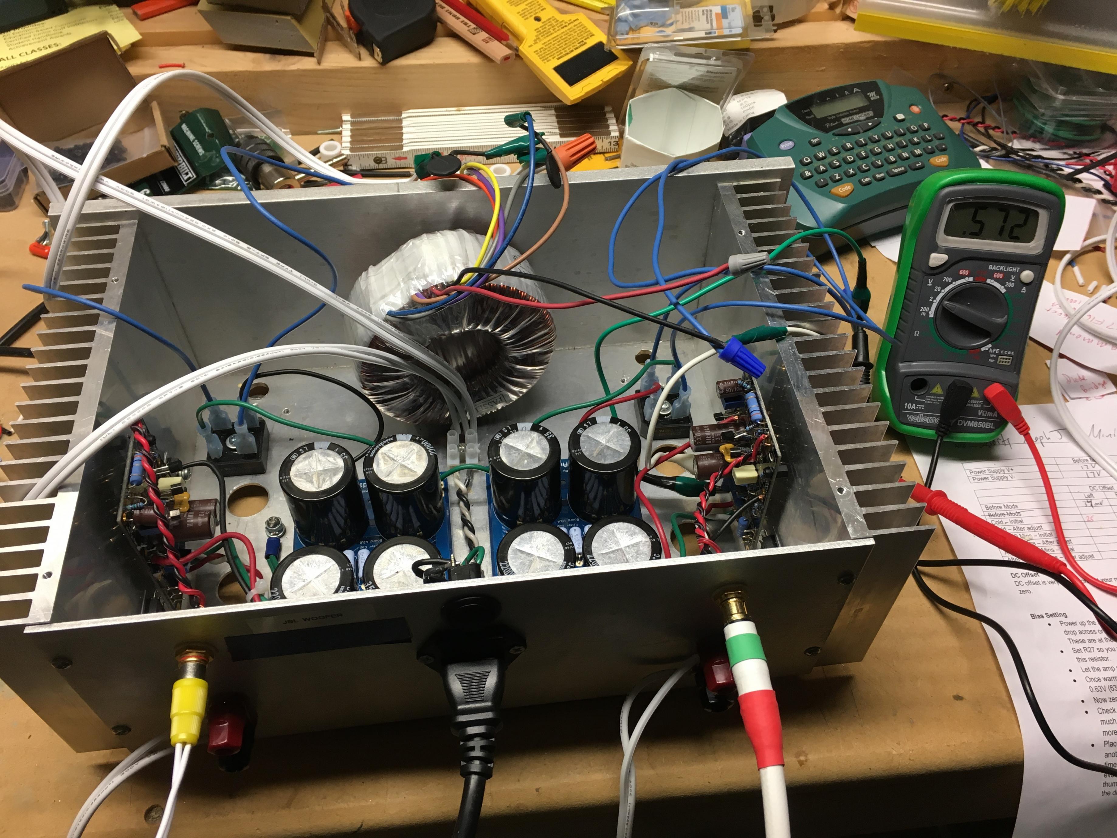

I tested the with a temporary wire-nut hookup on the bench with the transformer out of the chassis. Hum is fixed from speakers, and no transformer buzz! Excellent. I got some L-Brackets at home depot hoping I wouldn't need to put a bolt through the amp's faceplate. With a little drilling on the bracket, and drill/tap on the chassis bottom I got the transformer in. It's a hair off center because there was a preexisting tapped hole next to where I would have drilled. I took advantage. The top will actually fit on the amp and not touch the transformer. Whew!
I'm getting +/- 19.9V rails.
DC offset is 22mV on one channel, 23.3mV on the other.
Help me make sure I get this one right.
Bias voltage = .553V
current = .553/0.47 = 1.176A
Mosfet is burning 1.176A x 19.9V = 23.4W Within papa's range. (22-25W?)
I ran the amp for about a half hour and the bias settled in the .553 range. It was .565 when cold.
Right now pots are in to set DC offset and bias. I'm thinking I leave the bias alone and replace with a fixed resistor.
Any recommendations on how much I should work to fiddle with the DC offset? I know zero is the goal. I think I've read 20mV is acceptable. How much effort should I put into chasing zero?
I've learned a ton on this amp. The "Tallboy" amp should go a lot faster after learning so much on this one!

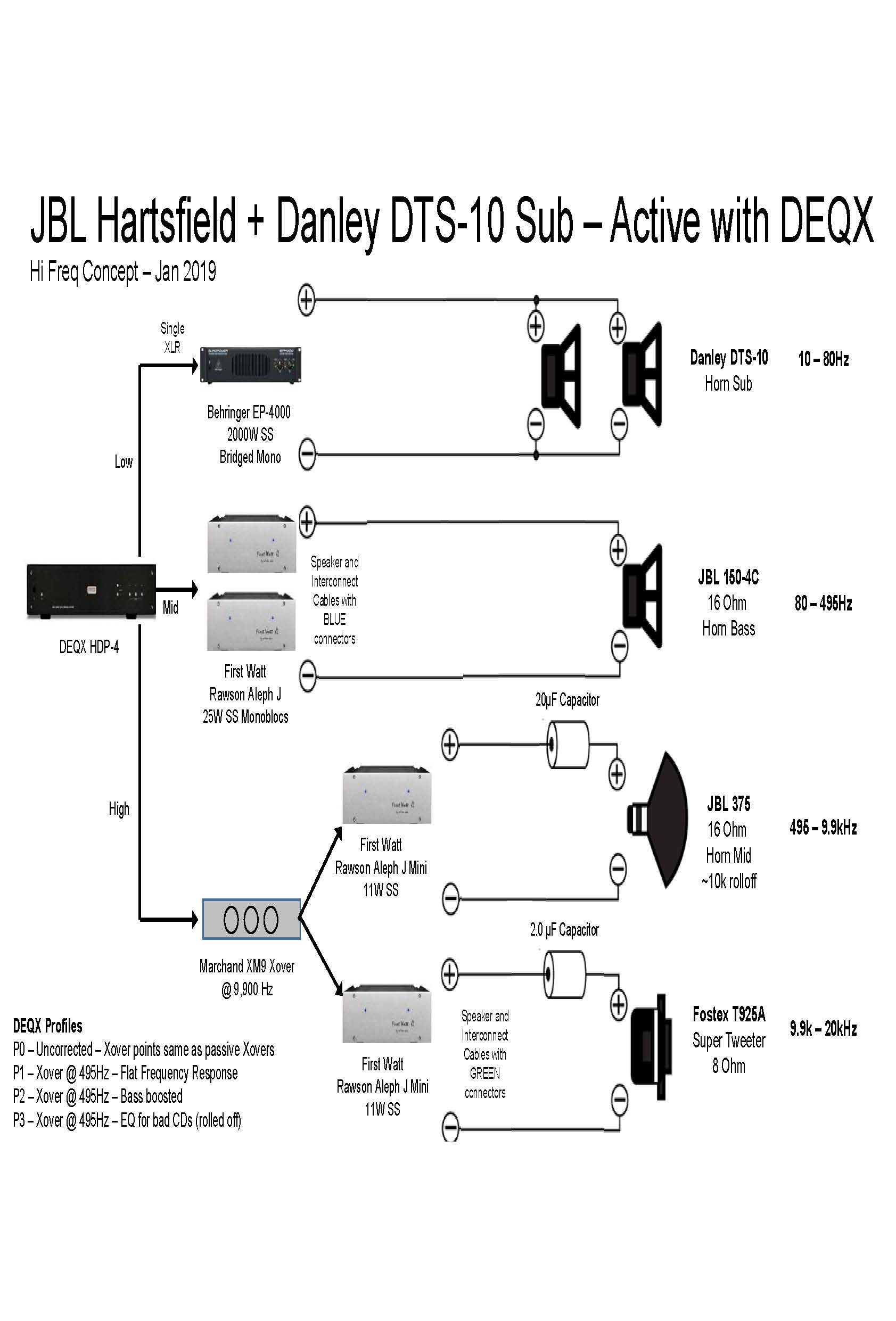

Jim 6L6 - Tallboy is the same as Shorty LxW (I don't have the numbers handy) and it's 1" taller. So I'll simply do another L bracket and put a little more air above and below the transformer.
When that's done, my buddy has 4 monoblocs that will need CRC power supplies and who knows what on the boards. He said there are toroids in already, so that's a good start. I'll be picking up 2 of the monoblocs from him.
Picture attached is the end goal.

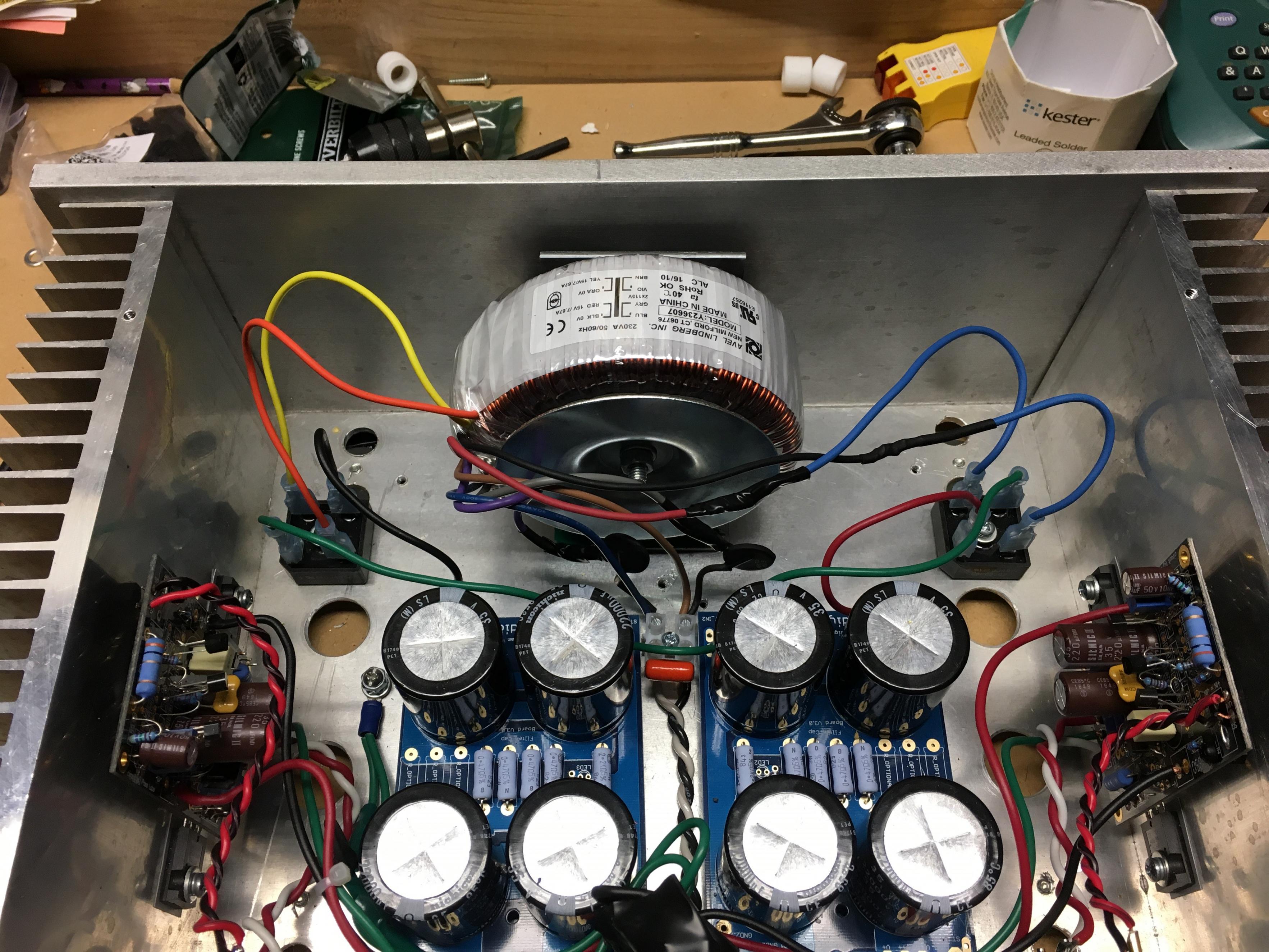

Tallboy is done. 2nd one moved a lot faster since I knew what I was doing!
DC offset is <5mV
Bias is set to get me about 23W per MOSFET.
When I hook it all back up into the horn setup, I can tell this made a nice difference!
However... I can still hear a little bit of noise. I'm hearing it when I get close to my unpadded JBL 375 compression drivers - very efficient speakers.
Would playing with a CRCRC power supply potentially make a difference?
