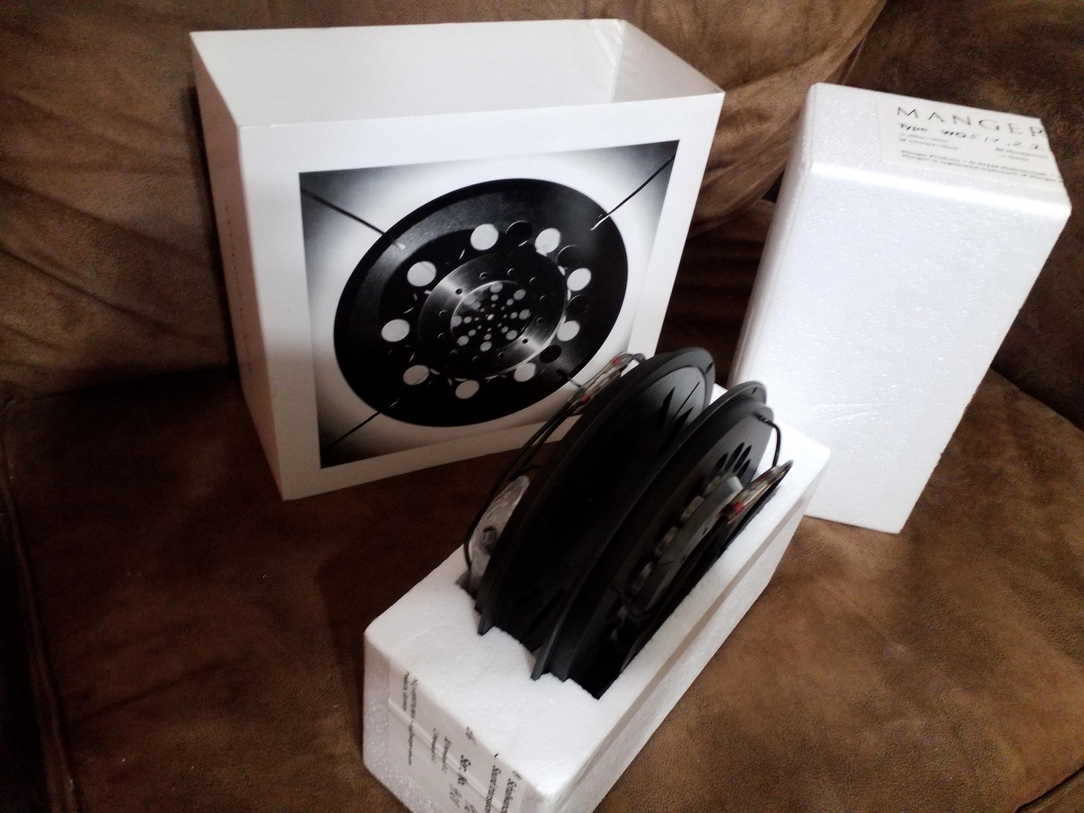

Taking a MANGER MSW apart

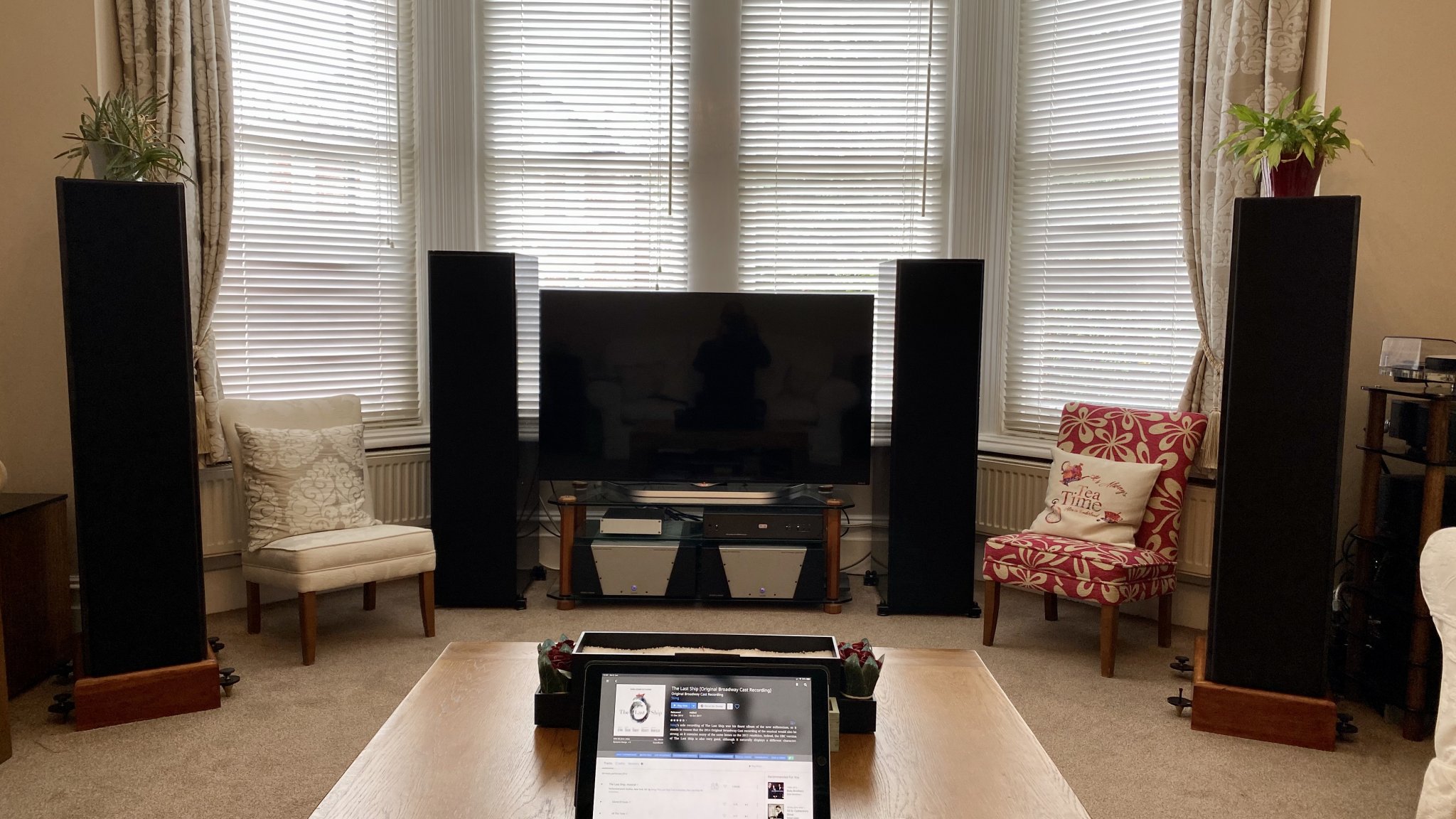

I look forward to the results of your build. I’ve two pairs of home built speakers, using the Manger. The crossover point is 400Hz, using Hypex nCore amplifiers with linear phase 24dB electronic filters with DSP, crossing over to twin 7” Dayton Esoteric (MTM) and twin Dayton Ultimax UM8-22 sub-woofers. I find that the Manger does not spit or ring like a lot of treble units, so initially it can sound uninspired but it doesn’t lack anything and is very fast with great transient attack when it’s actually there. The music and vocals are very natural and unfatigueing, just like real music and vocals! When I listen to other speakers, they might sound bright and clear initially but you soon find you want to stop listening. This doesn’t happen with the Manger. I would point out that they seem to be sensitive to the enclosure they are in. The enclosure needs to be very stiff, so I’ve used 20mm aluminium for the baffle and marine ply in a laminate construction for a very solid and dense enclosure.
