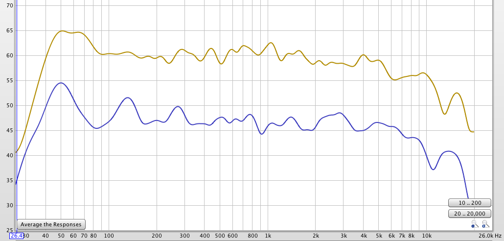

Just received a couple of new local drivers (AHE) and it looked like they would do great in the TABAQs.
Performance is about on par with the W4-1052SD I had in them. And at half the price, it's pretty good.
The AHE exhibit a little more distortion than the TB, and they both run out of steam after 10k (a bit earlier for the AHE), but since these will be for casual background music, I don't mind. They should do fine.
The W4 is in gold, the AHE in blue. Both have 3 or 4 bands of EQ to level things out.
