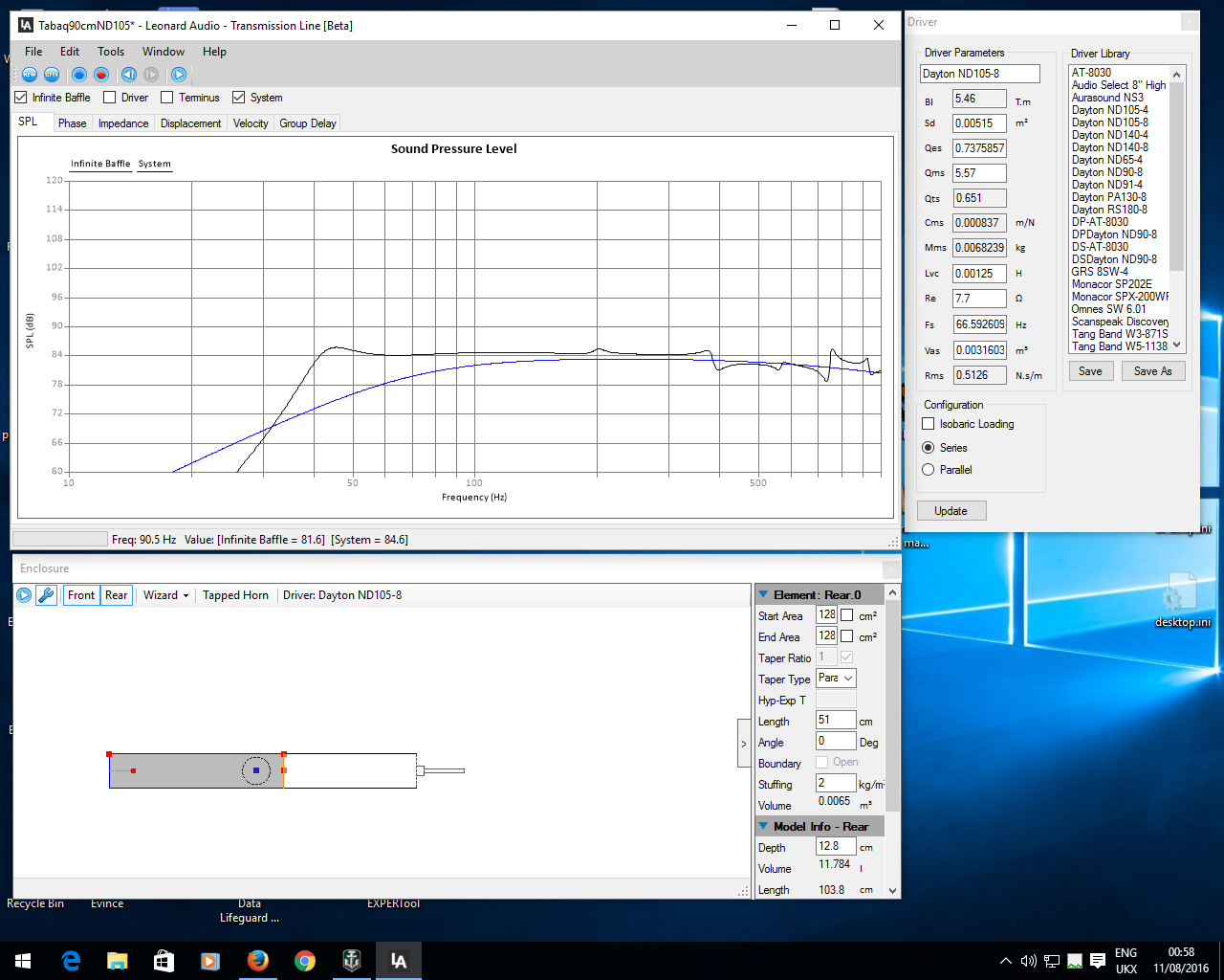

I've played with fitting the ND105 into the Tabaq and running it as a 2way with maybe a Dayton ND series tweeter, 20 or 25 variant of some kind. I also increased the height to 90cm.
In order to obtain a "plateau" that didn't shelve downwards towards the bass, I had to move the driver significantly lower. Or accept that when stuffed I'd have a nice 40-45hz bass with a low scoop response in the 50-80hz range.
This is the current model with (I think) heavy stuffing.
It would be interesting to see if it bears any resemblance to other simulation tools.
