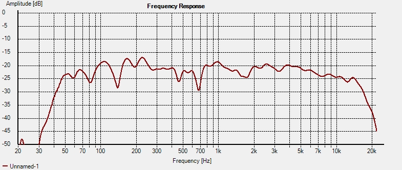

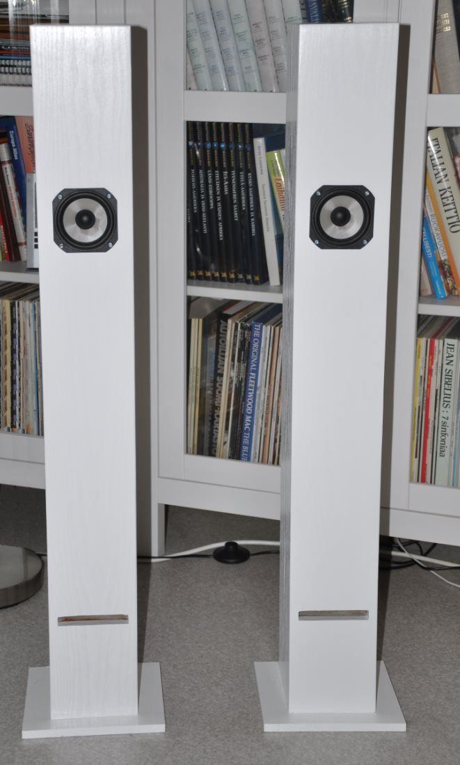

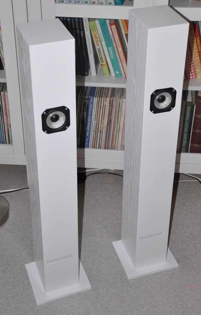

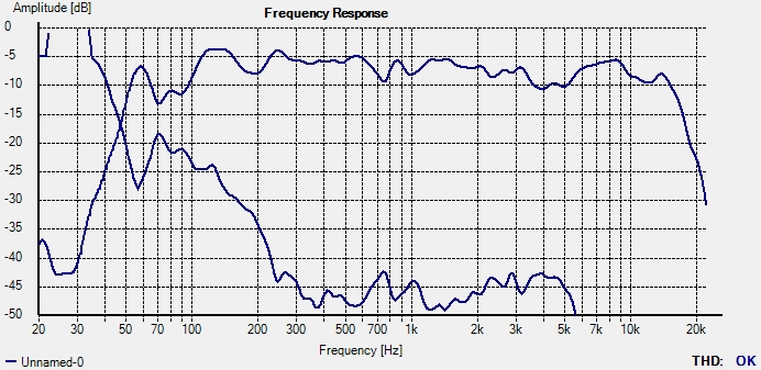

Well, what we can learn here, again: don't mess with good design 😱.
I had covered the box walls behind the driver with some 5mm thick heavy cloth, to dampen higher harmonics, and I thought that it does not affect to bass response. And that was false idea...
Now there is just the 100g as suggested, and FR from 1m looks like this. The placement is same as before, but below 100Hz it looks much better. Thanks all.
That is a very nice response! It does indeed hit 50 Hz and that is not bad for a driver with a 110 Hz fs. Can you show us the harmonic distortion plot that goes with this? It will start to get worse below 200 Hz but I just want to see how much.

I have learned never to glue stuffing as it always needs to be adjusted. Polyfill is great as you can add or remove through driver cutout with a coat hanger hook. Add a couple of thin strips of wood bracing at the lower point where you don't want polyfill to fall below and it will stay.

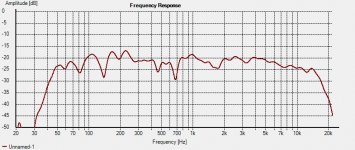

I had to take another measurement, as the level was quite low in the previous measurement. Here the distance is only 40cm and level is litle higher, to prevent background noise messing the results too much.
That is a great looking response for any speaker!
Thanks for taking the data and sharing it. Confirms the typical -45 dB to -50dB THD that the Vifa has above 200 Hz (at least on the TC9FD's that I have measured). You are at -20dB (10%) which is not that bad around 50 to 60 Hz. This looks like it sounds really nice - balanced, smooth, with pretty deep extension given it is only a 3.5 in driver. 🙂

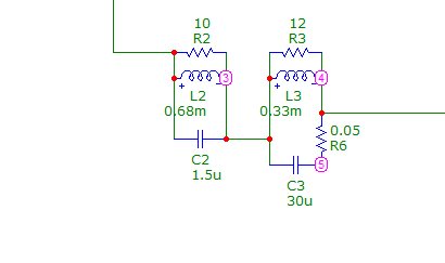

The BSC is modified to give good mid & high response. As I don't have miniDSP, I just used primitive old school components😀 Here is the circuit too.
I am still wondering if the C2 should be 2.2uF instead of 1.5uF. Room damping and own taste makes difference which is better.
This BSC is propably not optimal for placement on the wall, but works better if the speaker is slightly further. I have to put them some 50cm from the wall, that is why it is like this.

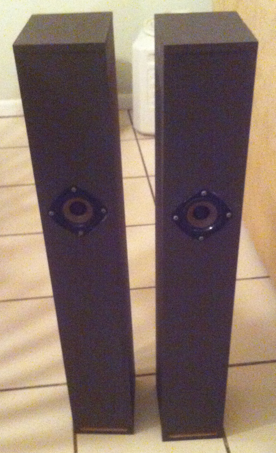

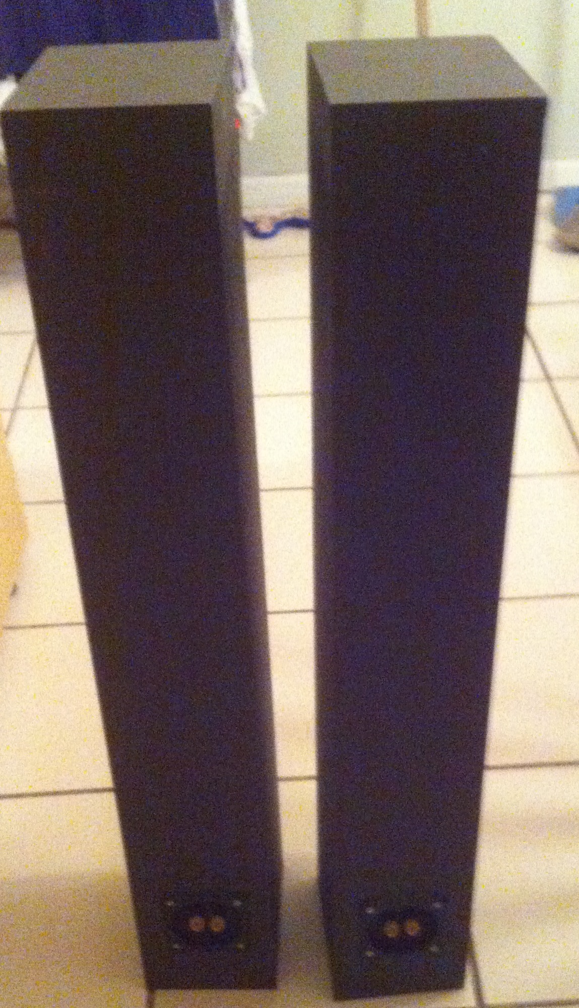

I just finished a pair of TABAQ with TB W3-881SI. I still have to lacquer them, as to give them a glossy finish. Paint is HD Behr Premium Plus Acrylic Latex Dark Cavern (Dark Charcoal Gray). For point to point connections inside the enclosure I used Cat5 pairs. The binding post cups are cheap-o $7.00/pair, but they will have to do until I receive an order from Parts-Express that I'm waiting for, with various items, among them some quality binding post cups. I still have a few details left like painting inside the vents, but I can get to those prior to applying lacquer. Getting ready to test how they sound...😀
Looks very nice. Those look like pretty nice binding posts already - most of the time I use just the $0.80 spring loaded terminal cups and they work fine - not pretty or fancy but they do the job.
How do they sound?
