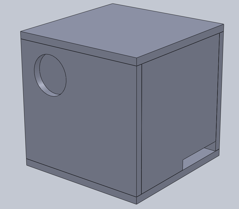

Here is a rendering of the 9.5 in TABAQUBE. There is an L shaped internal baffle and two 4x4 in baffles to make the path snake through for a 32 in long MLTL.

I do not have MJK's model, I am wondering what the effect of all the extra corners would have on the SPL vs frequency? I think corners are treated as area expansions/contractions in the worksheets. So this design would have 6 corners (90 deg turns) with the mean pathlength still the same. Obviously the front baffle is different now so the BSC would have to be modified. I am also considering a way to make the exit port length or width adjustable with a set screw to 'tune' the bass response in real-time. Thanks in advance if anyone is willing to try modeling this before I cut wood.

The simulations with MJK´s models does not take into consideration that the cabinet is foldet, you just follow the line ine the middle of the cabinet all the way round.
To be honest I do not know if the folding reduce the need og stuffing. The original stuffing is to level peaks both in the bass and the rest of the frequency.
Your design would probably need a different BSC, whcih I can simulate.
If you are planning to run stereo, however, you could just merge two cabinets into one.
My foldet TABAQ is doing great with New Indeed Klasse T Amp Tripath TA2021

Hi xrk971
I did a test with MJK example and made the model without the increasing / decreasing line caused by the folds.
There is no difference in acoustic impedance, need of damping or the SPL. In other words, is seems the foldings does not change anything.
About the 64 inch line: I need your actual dimensions of the design. but i would expect the tuning would be lower than 52 Hz. TABAQ has a total line of 33,8 inch.

First. I do TL's, not horns, but still....
Look at the output from HornResp. Do real, made in wood horns really sound that bad? Of course not! The models only reflect a single dimension -- the length of the pipe/horn. Once the sound waves starts bouncing around in three dimensions, things smooth out. I think that you are expecting too much from the models. The models are excellent at predicting the high pass cutoff, pretty good at predicting the first two or three overtones, and beyond that, provide a general indicator of what to expect. For mid-bass horns -- F3 60hz or so or TL's to 40Hz or so, don't expect much guidance above 500Hz.

Hi xrk791
First: I do like that MJK is using Sd to set cross section, it makes it easy to change volume. I normally start with a cross section 3 times Sd and simulate frome there, trying different parameters along the way. This is very fun, by the way, and you get the feeling of quarter wave design.
I have simulated your design, with the last 6 inches with a cross section of 1 sd = 32 cm2.
The enclosure has a tuning frequency of about 38 Hz, which is much too low for this driver. I would suggest the folds to have a total line of 30 inch (plus the last narrow part), as in TABAQ.
