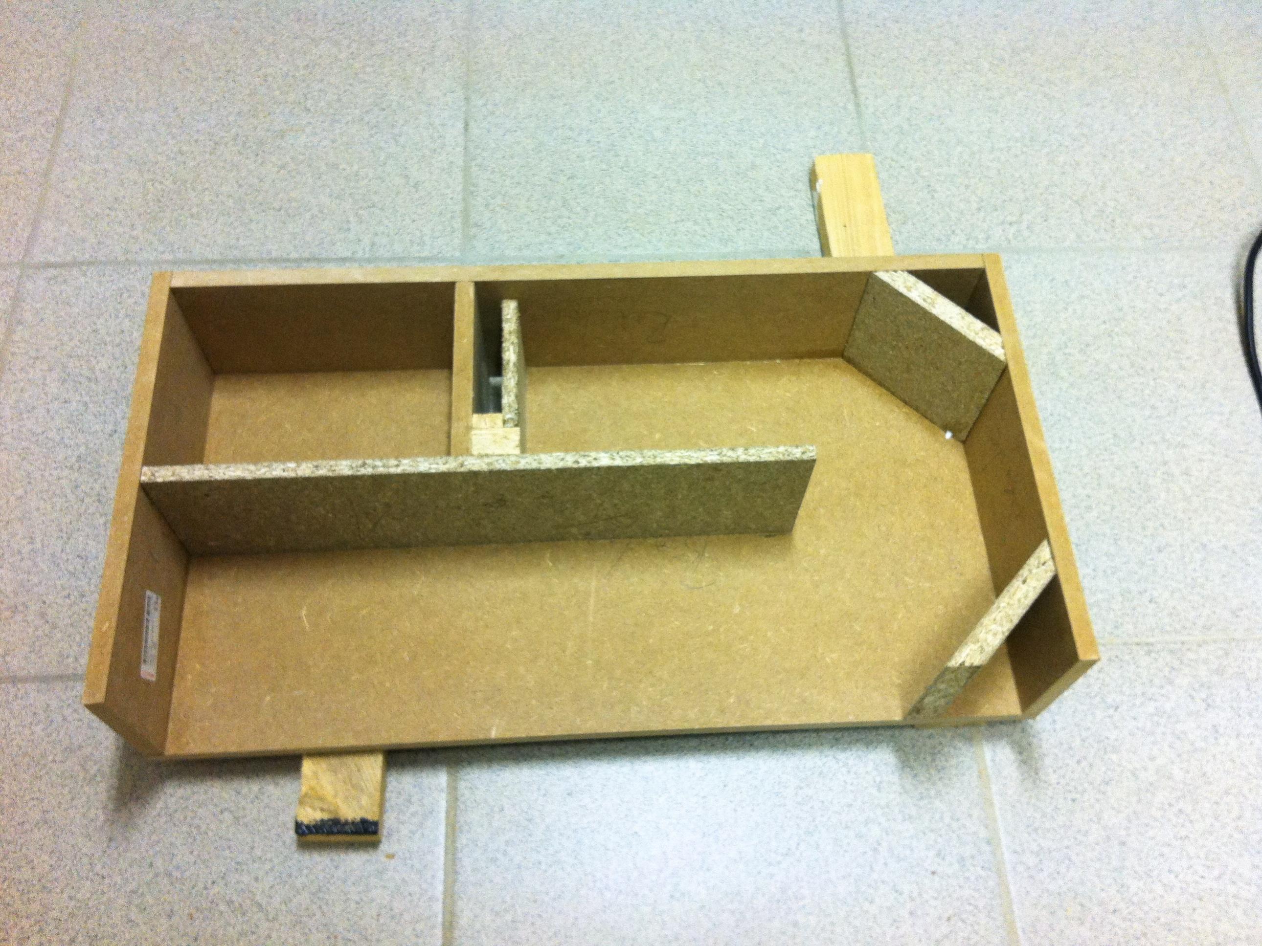

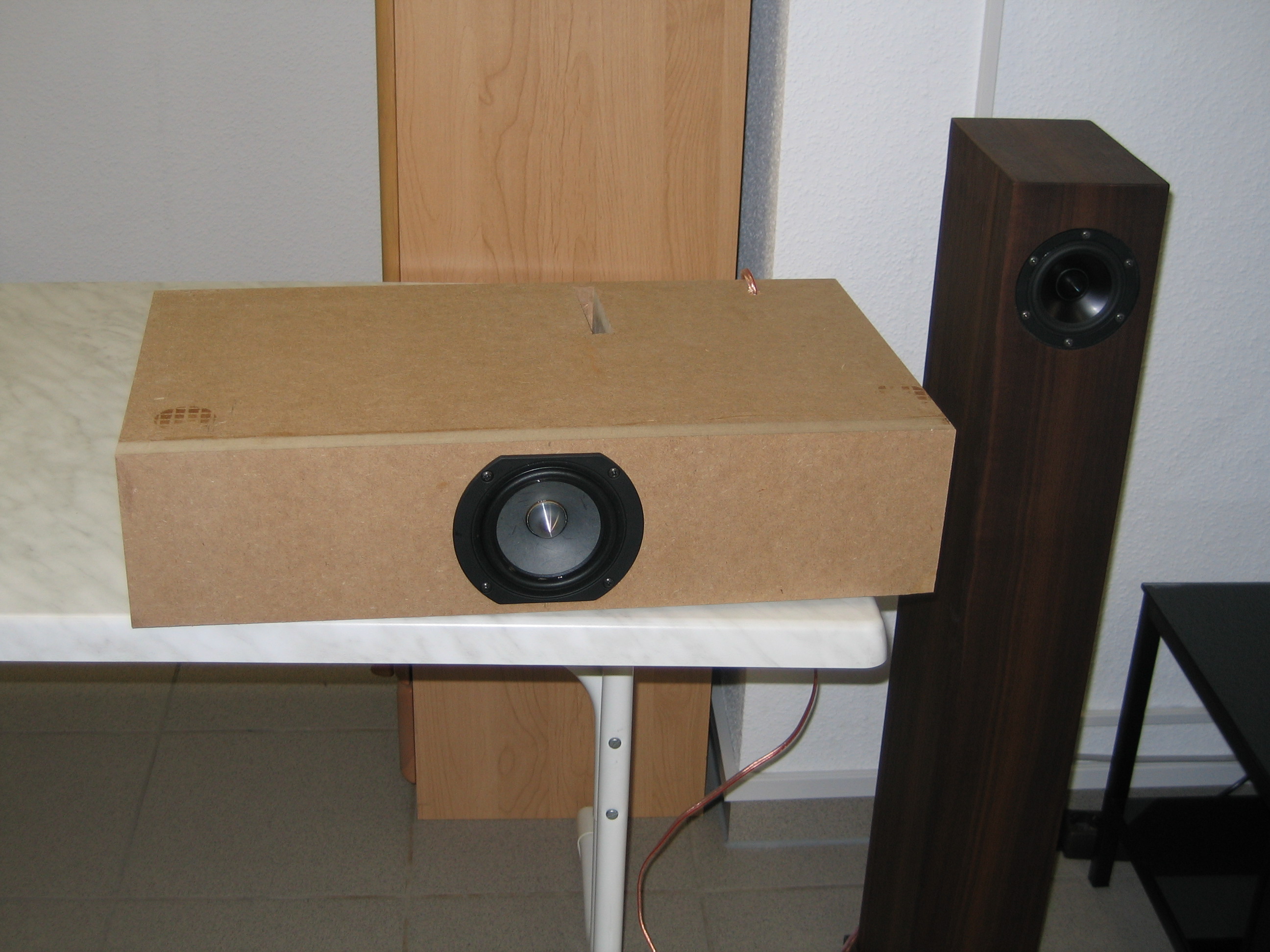

Slowly I continue building the speaker enclosure. I had to do little modifications but nothing important.
I attached a picture for you to see :) . I think it'll be closed on sunday evening.

Just in time :D.

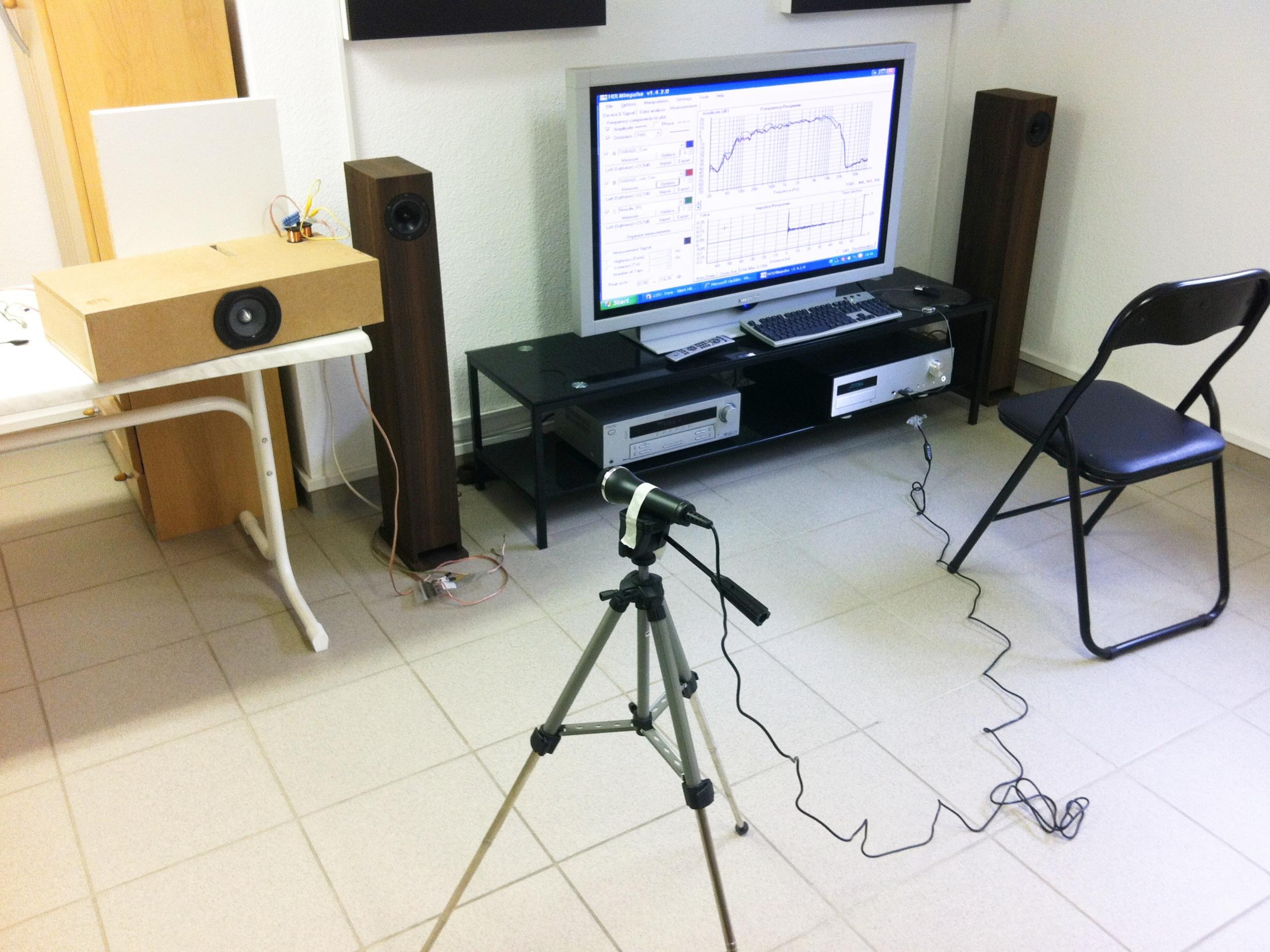

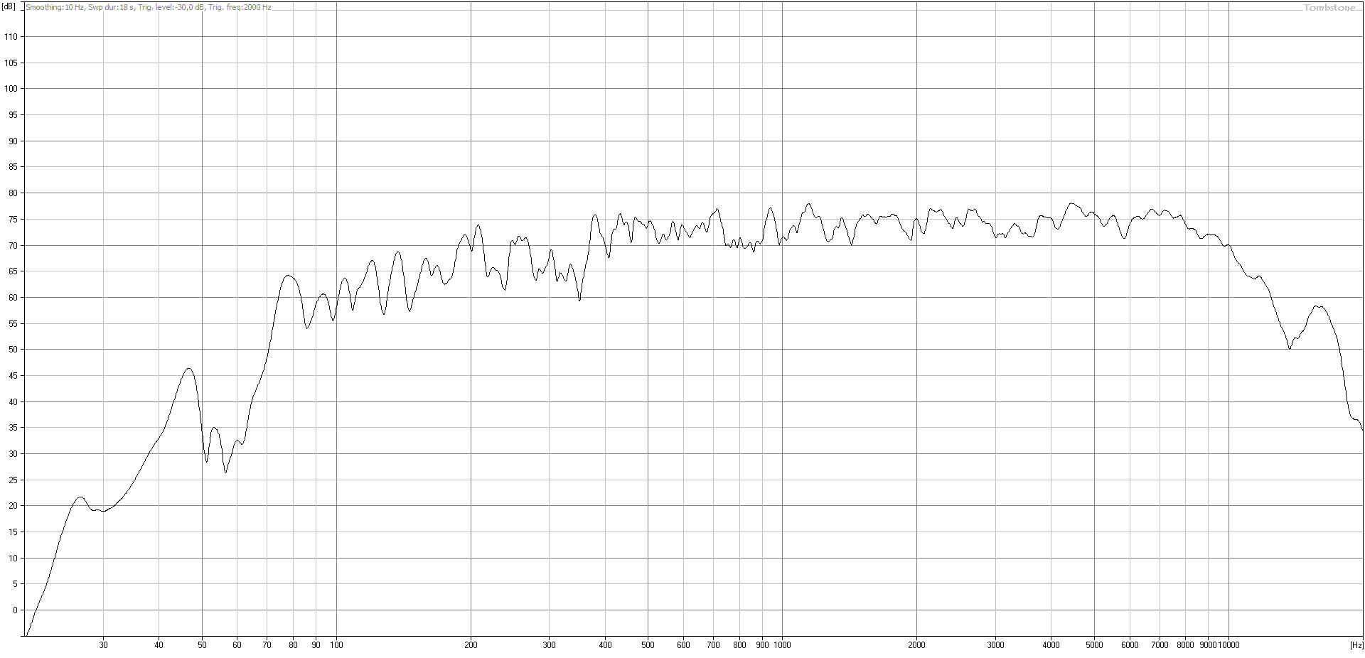

It is finished though it is not painted and veneered yet. It is playing with my needles now and doesn't sound that bad. The port is pointed upwards because of the cable. In the living room it will be directed to the bottom. I attached a picture of the center and a quick frequency response. Because I have no calibrated microphone I will have to measure again compared to the needle. So I can have a result that is relative to a known loudspeaker ;).
I will post a drawing in the next days if someone wants to build this one too. It was very easy and the result is okay.
I should mention that my center doesn't have any correction circuit by now. This will be added as soon as I have the time to make some measurements at a friend of mine.

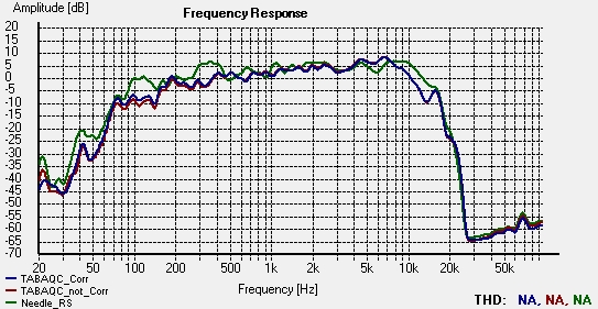

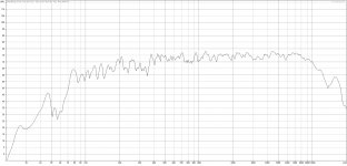

Hello again,
I did some more measures with holmimpulse. I did try a correction circuit with 3.5 Ohm and 1.2 mH but I didn't get a result that's pleasing me. So I still have some work to do :D.
Any way, I attached the frequency response of the TABAQ-Center with and without the correction circuit against the Needle RS. The microphone was on axis in 1m distance. I added a small piece of wood behind the center to get some reflection out of the port.
It isn't so bad compared to the Needle but I think it could be a little better :) . In the vocal frequency range (I think that is most important for a center) it is nearly on point with the needle.

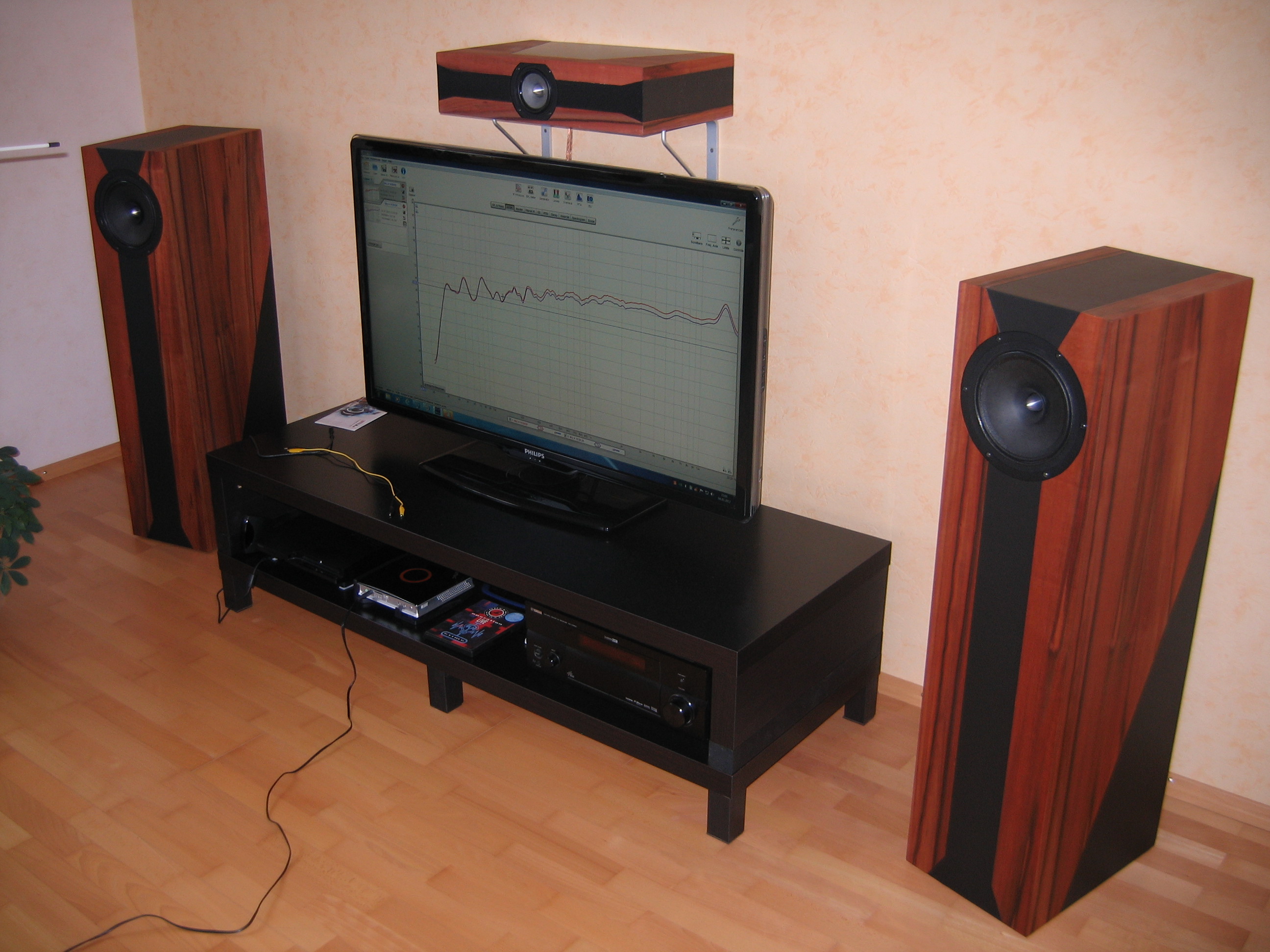

Well, I have another substantial question.
The design is ~85 cm tall, so even with the driver mounted higher than recommended it isn't very practical. A 55Hz wave is around 1,5 meter long but we can reduce it thanks to stuffing and mass loading by a narrower port, right?
The w4-1320 resonances probably aren't as hard as with the smaller driver due to lower Qts, so maybe I could resign from mass loading and just build a higher tower? How high could it be then?

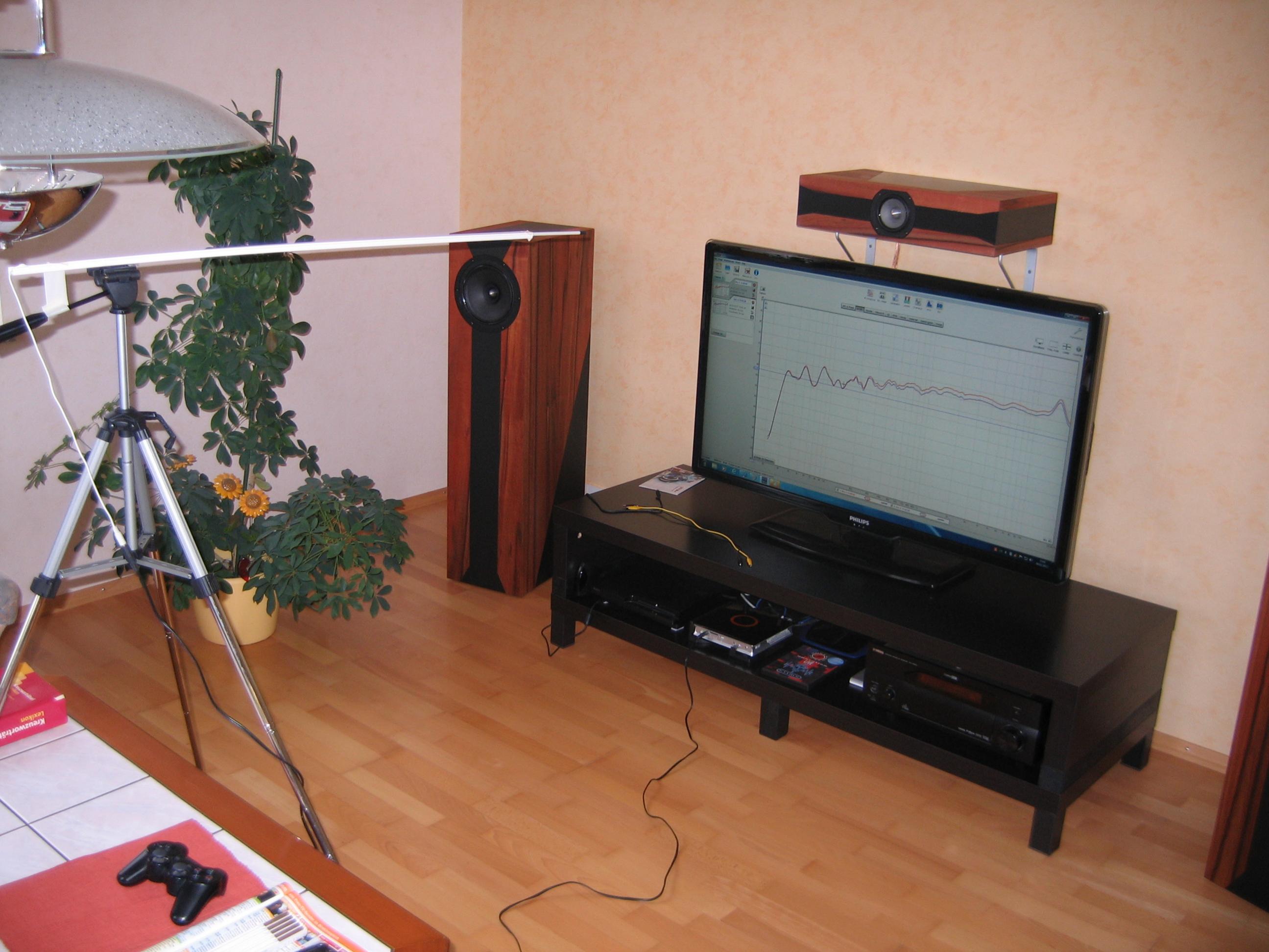

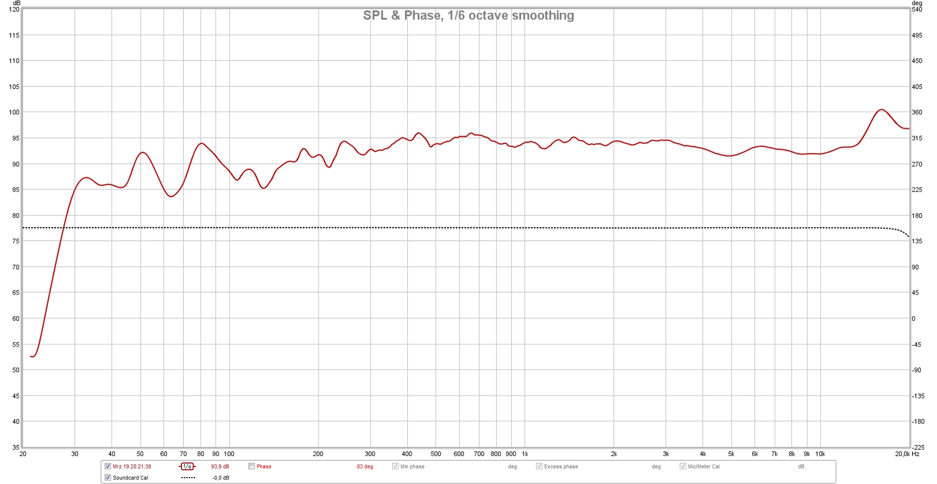

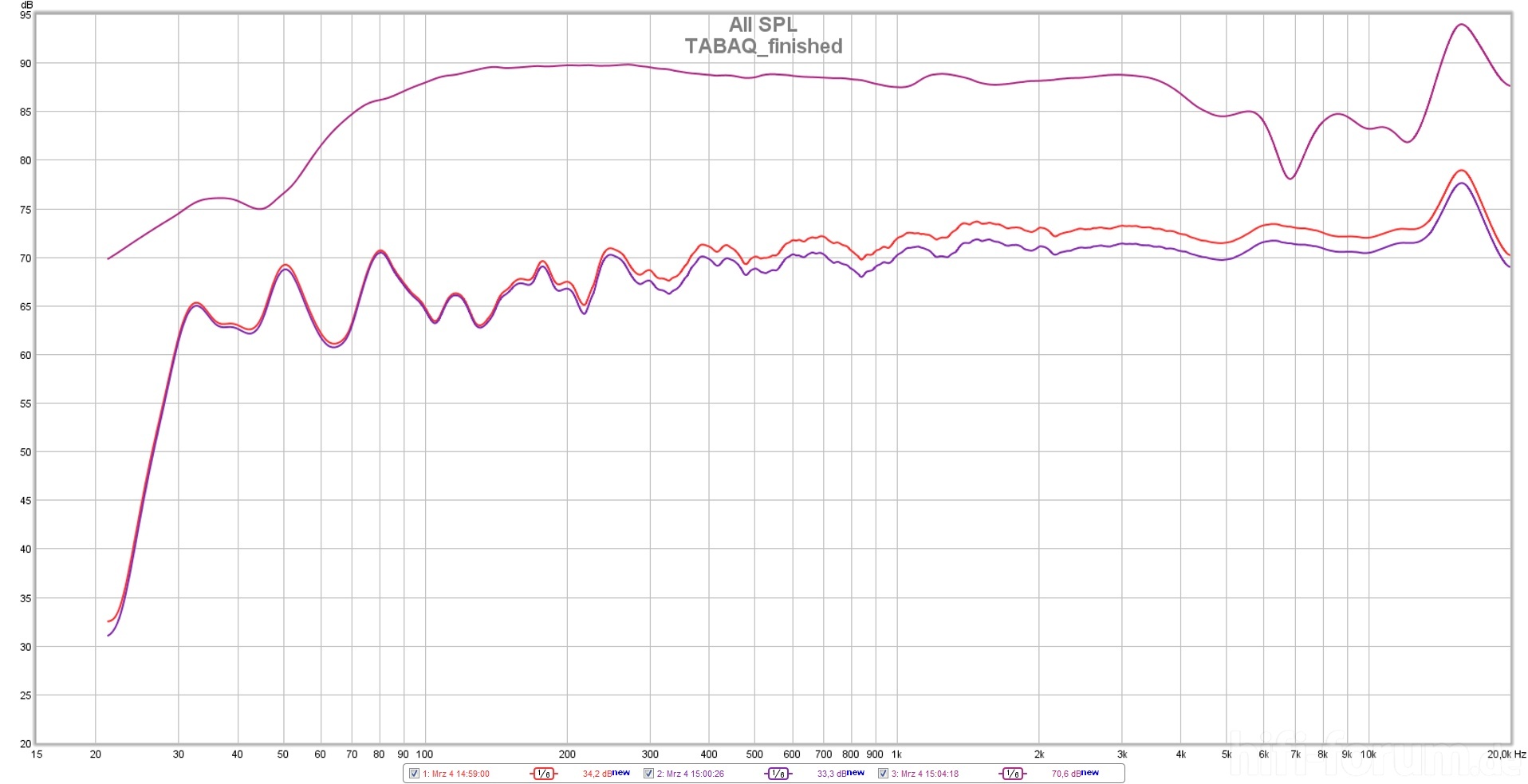

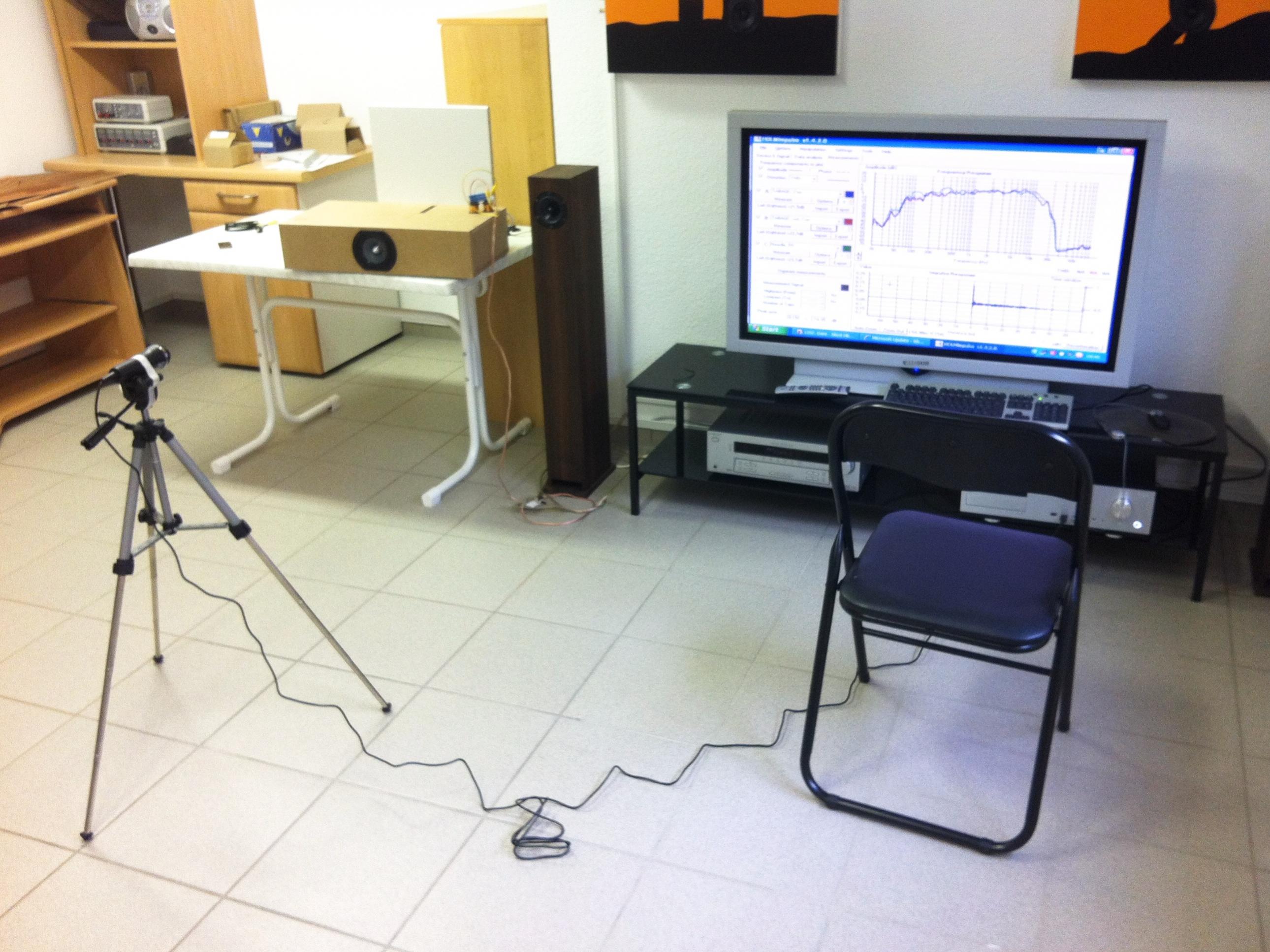

My center project is nearly finished. I moved the center from my workshop to the living room to do some measuring. I modified my micro-stand because of an 18 kHz peak but it is still there. So I am still searching the reason for this.
I attached the measures (red = original, blue = 1,1 mH parallel to 3,3 Ohm circuit, above them a near field measure <1 cm) and the pictures of the center in my living room. I need to measure a little more to "tune" the circuit right but this will come with time. I removed on piece of sonofil and it is much better in lower frequencies than before.
Im quite happy with the result. I listened to it in mono and it is quite good with different music styles. From Siris Slave Band to Nils Lofgren, from Yello to Metallica, from Mussorgsky to Oscar Peterson Trio - all are handled very good. There is enough bass for such a small loudspeaker - I think it is capable of more than being a center speaker. :D
If you're searching for a small center speaker then this one should be on your list ;).
Greets
Sven

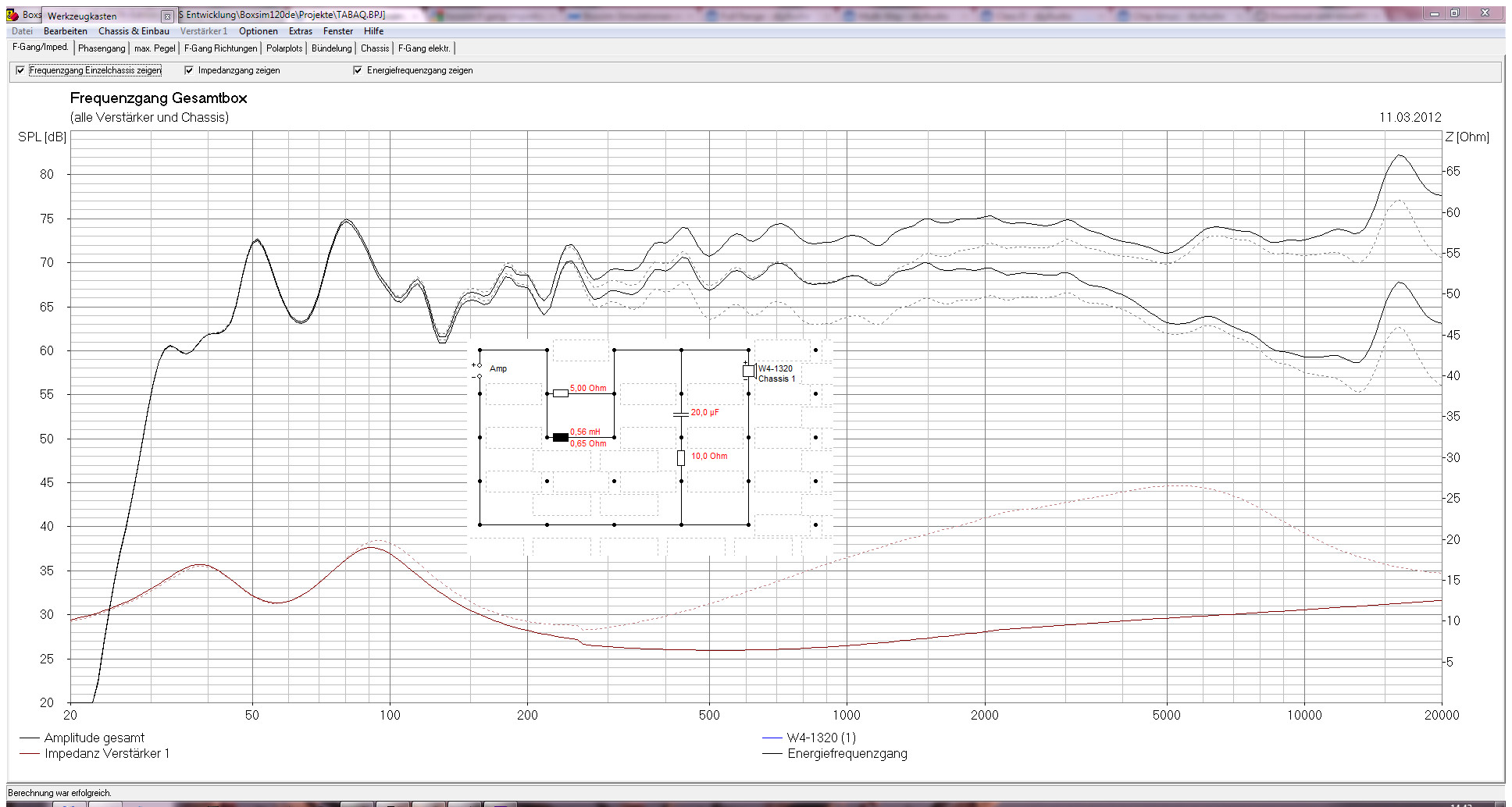

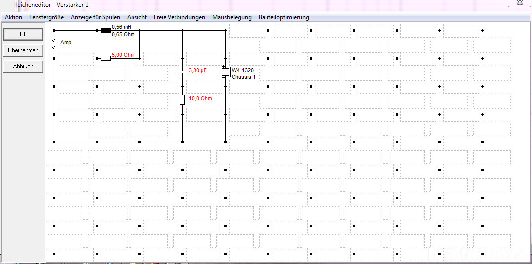

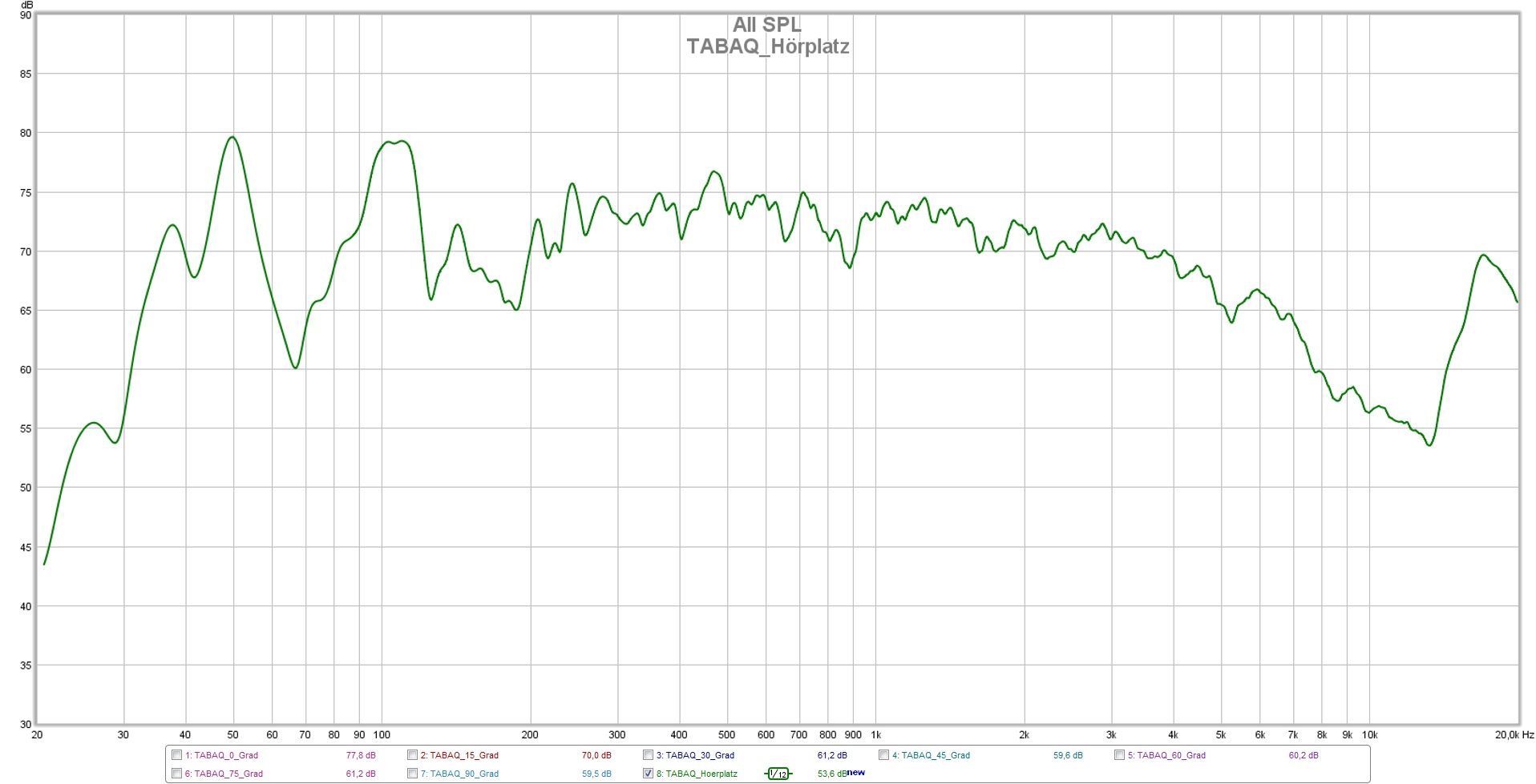

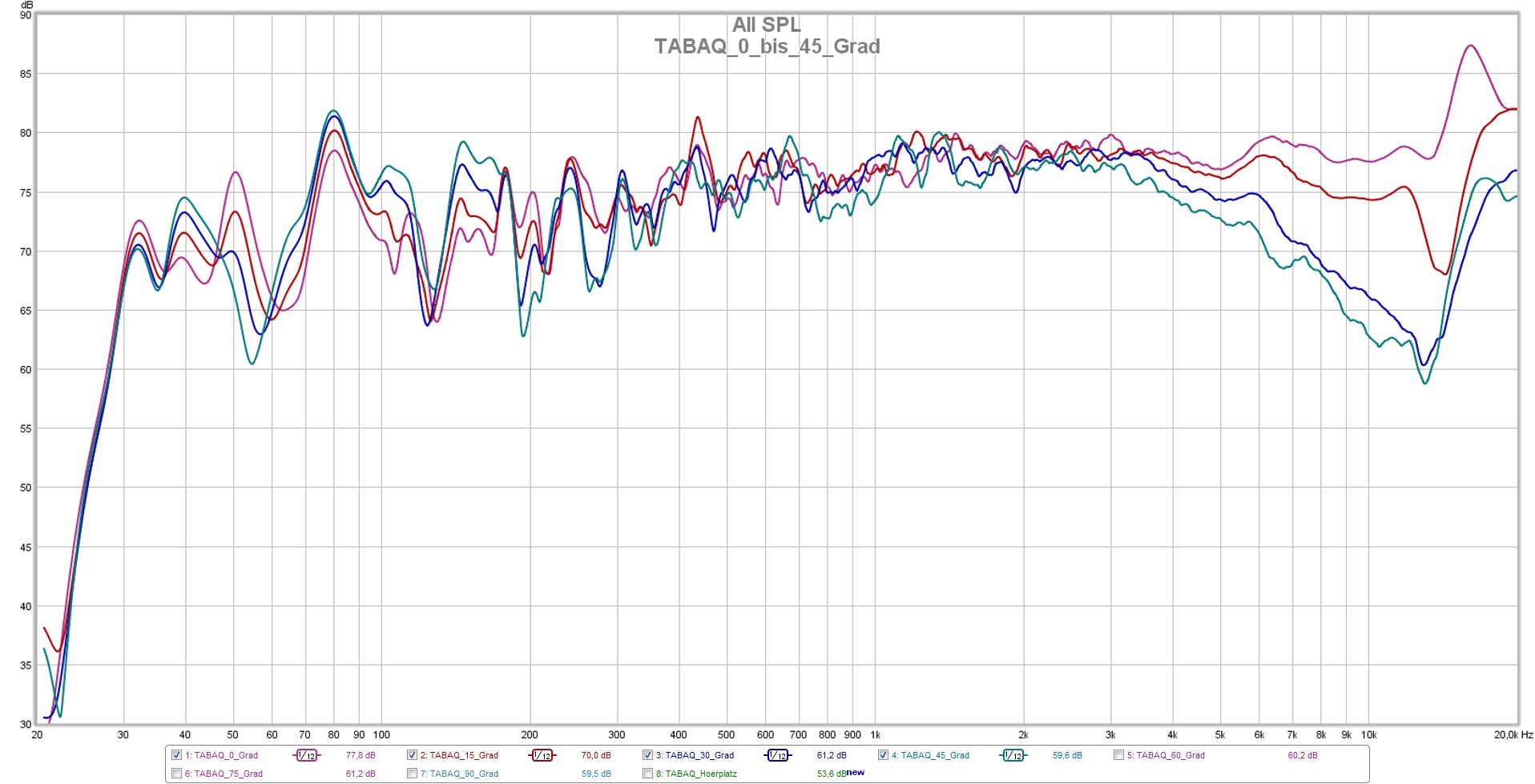

I did some more measuring and simulated some correction circuits in Boxsim.
Attached are the frequency responses under different angles (and at my preferred listening position "Hörplatz")
and the last version of the simulated correction circuit. Suggestions concerning the circuit are welcome as I'm
a rookie in this item ;) .
