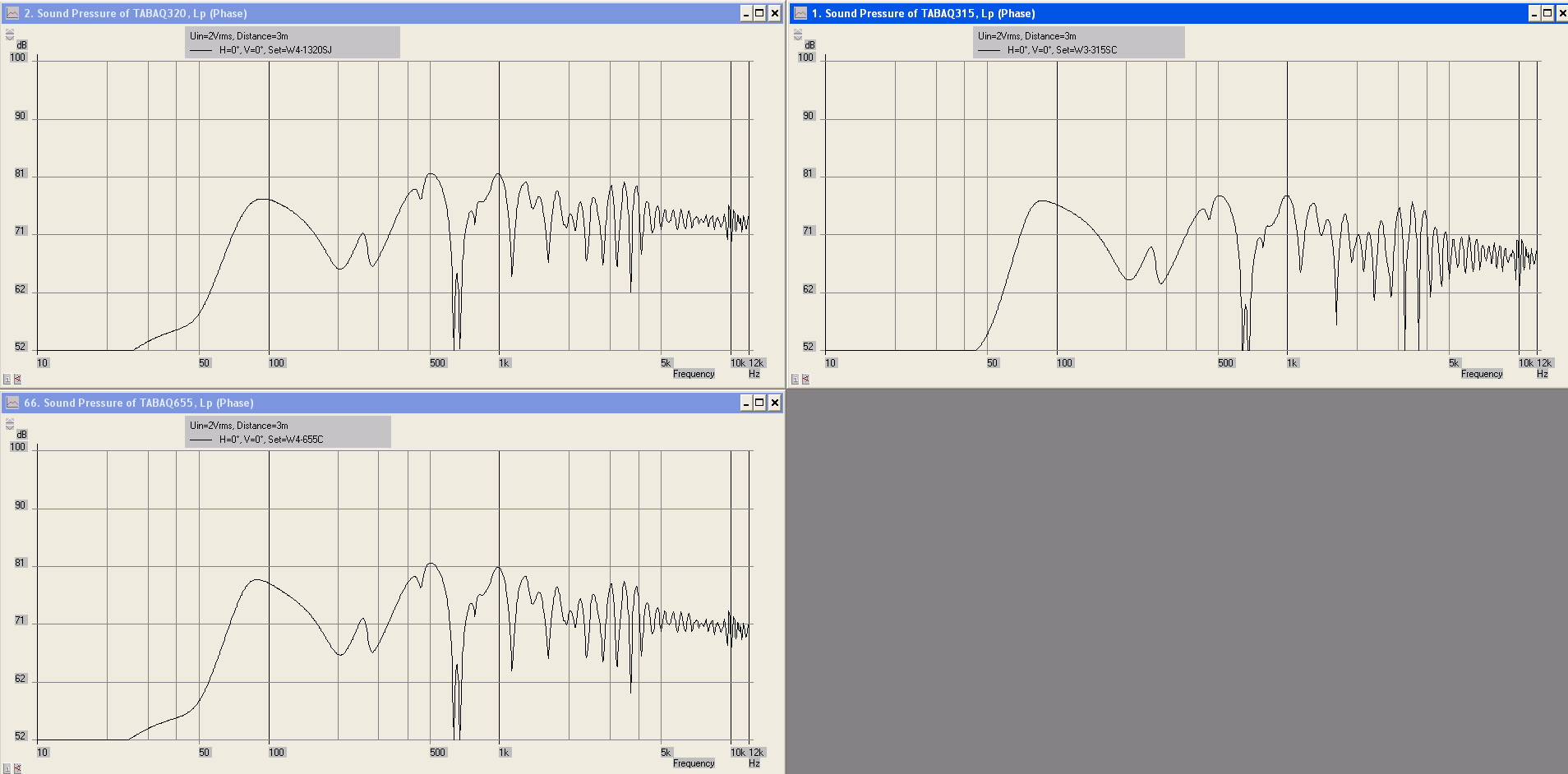

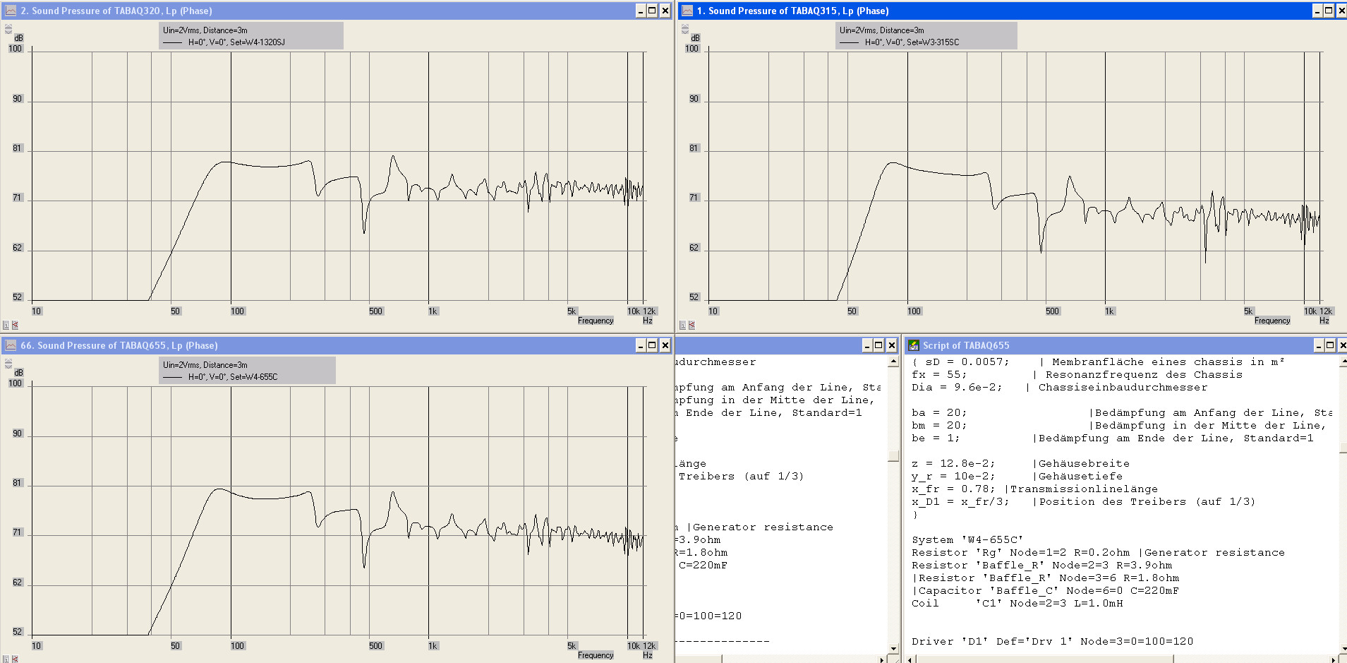

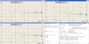

I did some calculations with the original TABAQ in Akabak but I'm lost somewhere 😕 . I attached pictures of my calculations with various drivers (W3-315SC, W4-1320SJ, W4-655C). First without baffle (looks not so bad) but then with baffle ... very bad. (Expect the unexpected 😀 ...) Seems I made some mistakes with the baffle integration in Akabak
I also attached the Skript for the W3-315SC variant as .zip-file. Maybe someone has a little time to look at it and point me to the right direction.
Why do I do this? Because I want to use the W4-655C in the TABAQ Center (I have it in Cyburgs Sticks and the center will accompany them) and I want to modify the port. So my intention was to model the original TABAQ, then add the 655C, turn the port to the rear (center) and then the port modification (to the downside and cross section). Learning step by step so to say 🙂
  • tabaq315.zip
    tabaq315.zip

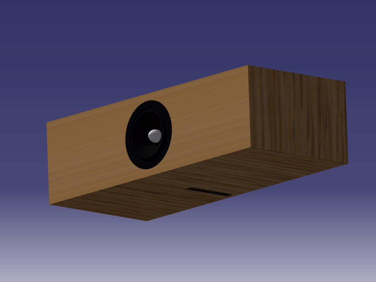

I had an idea that could help me with turning the port to the downside. I switched height and depth of the tube so it is now 128 mm high and 100 mm deep. This way I was able to keep all the measures and to turn the port to the downside 😀 .
On the other hand I'm still interested in solving the Akabak problem I posted earlier 🙂.
A picture of the Center with port down and the W4-655C is attached (simple rendering).
