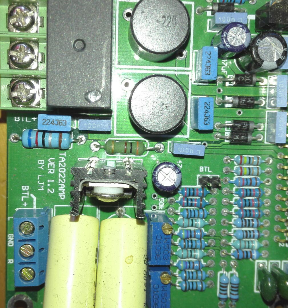

So, I've trimmed DC offset on one of the TA2022 V1.2 from LJM.
Time to trim the second, and I see very light smoke starting to come from somewhere, I turn it off.
Upon examining the board I noticed this(see pic).
It's the pre-soldered resistor. The kit comes with a diode and a resistor already soldered in.
From the color bands it's a 200R 5% resistor.
I can just swap it for a 1% 2W metalfilm, but what could cause the resistor to get swollen(and surely burn had I not been quick to turn power off)?
I would rather not just replace the resistor and have some underlaying problem cause the amp to fail later, maybe taking my dipole woofers with it.

That first band looks orange (300) on my screen rather than red (200).

You are absolutely right, I read in one thread about a 200R in that position. But it does measure 300R (in circuit).
I'll have a closer look at the PCB and see where that resistor connects.
It looks like 300 ohm from the picture. Its going to be OK then (at least at the moment
It is between pos rail and 7805 input pin.
That sounds like additional circuitry that its supplying. The TA2022 data sheet doesn't show anything beyond the chip itself. So that's no help.
I would do a basic check of the working voltages. Make sure the 7805 is out-putting a correct 5 volts. You could also measure the voltage at each end of the resistor and so calculate the current and power dissipated. Is the applied voltage to the board within limits ?
Beyond that and you probably need a circuit to see what is going on.
It looks like 300 ohm from the picture. Its going to be OK then (at least at the moment)

Swapped the 300R for 4x 1K2 in parallel.
Then I tried powering on the amp again.
Faint smoke from the same area, turned it off again and swapped the 7805 for a new one.
While at it I set both trimpots to the midpoint, something I forgot when populating the board.
Powered it on again.
I've only had the guts to keep it powered on for about 30s at a time.
DC offset is 0.00 to 0.01 mVdc.
I don't trust those numbers though, if it seems too good to be true etc...

And does it all work OK now. Sound but no smoke ?
I have not yet tested it with my woofers.
No smoke, so far atleast.
A bit nervous about testing it with my woofers.
But I don't know if I can leave it on for an hour or so (without load) to test that it is stable before I hook it up.
All a bit strange isn't it. You could try a 1ohm 0.25 watt or 0.5 watt in series with the speakers as a test. That should protect them against anything odd going on and at some point you have to try it for real.
Yes, maybe a bad 7805 from the beginning?
Don't know if that could cause the voltage drop resistor to blow through?
It didn't blow, but it would given a few more seconds.
The 4x 1K2 are 0.6W so there is now "a" 300R 2.4W there.

78 type regs do fail for sure although if it was just the reg then I would expect it to both generate heat and for the output voltage to be incorrect.
Actually, and seeing as you mention fuses, well a series speaker fuse would be as good as anything.
There's not much you can do now beside test it thoroughly.
