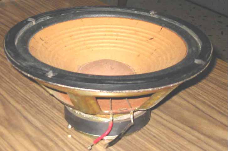

Remember that the Peerless India coating on the cone attracts insects.
My driver has its surface nibbled at by insects as it was in storage for along time. It also has a few pin holes ! Cannot use it as a TL. As a dipole it will not be visible , so its OK. Note that several other drivers kept along with this one ( different brands) did not have any problems !

T/S parameters for Indian Driver
Here are some of the T/S parameters I measured a while ago for the Bolton range.
...........10HM2........12LPM22.....16SJW21......20LPW22
Fs........92 ………........76 ……………...41………………..32
Re.......3.1...............6.4...............3.7..............6.8
Qms....4.04.............2.42.............2.8..............4.26
Qes.....0.45.............0.5...............0.59............0.87
Qts......0.4...............0.41.............0.49............0.72
Vas(L)...3.................4.3...............17...............52
I have not taken any measurements on the 10-12” Bolton drivers. I am surprised to find the Qts value of 0.39 from Ashok’s findings for the 10”Bolton driver.
