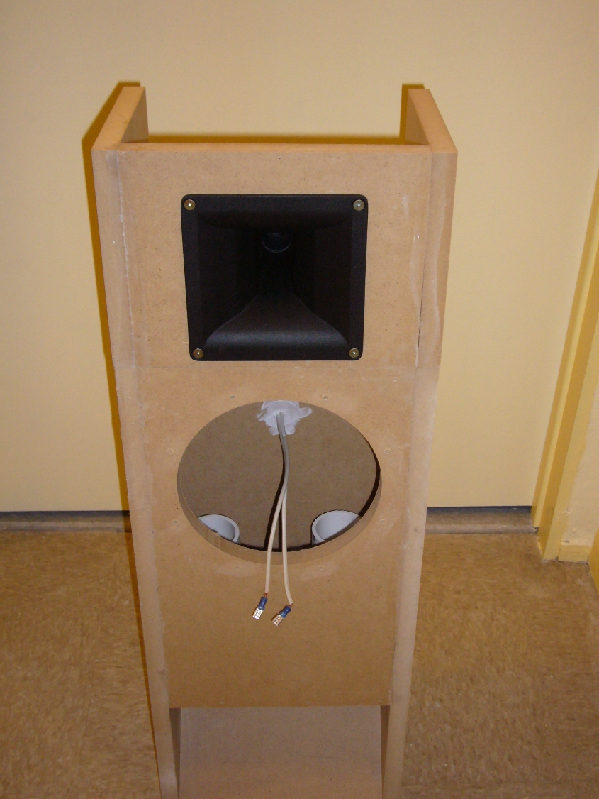

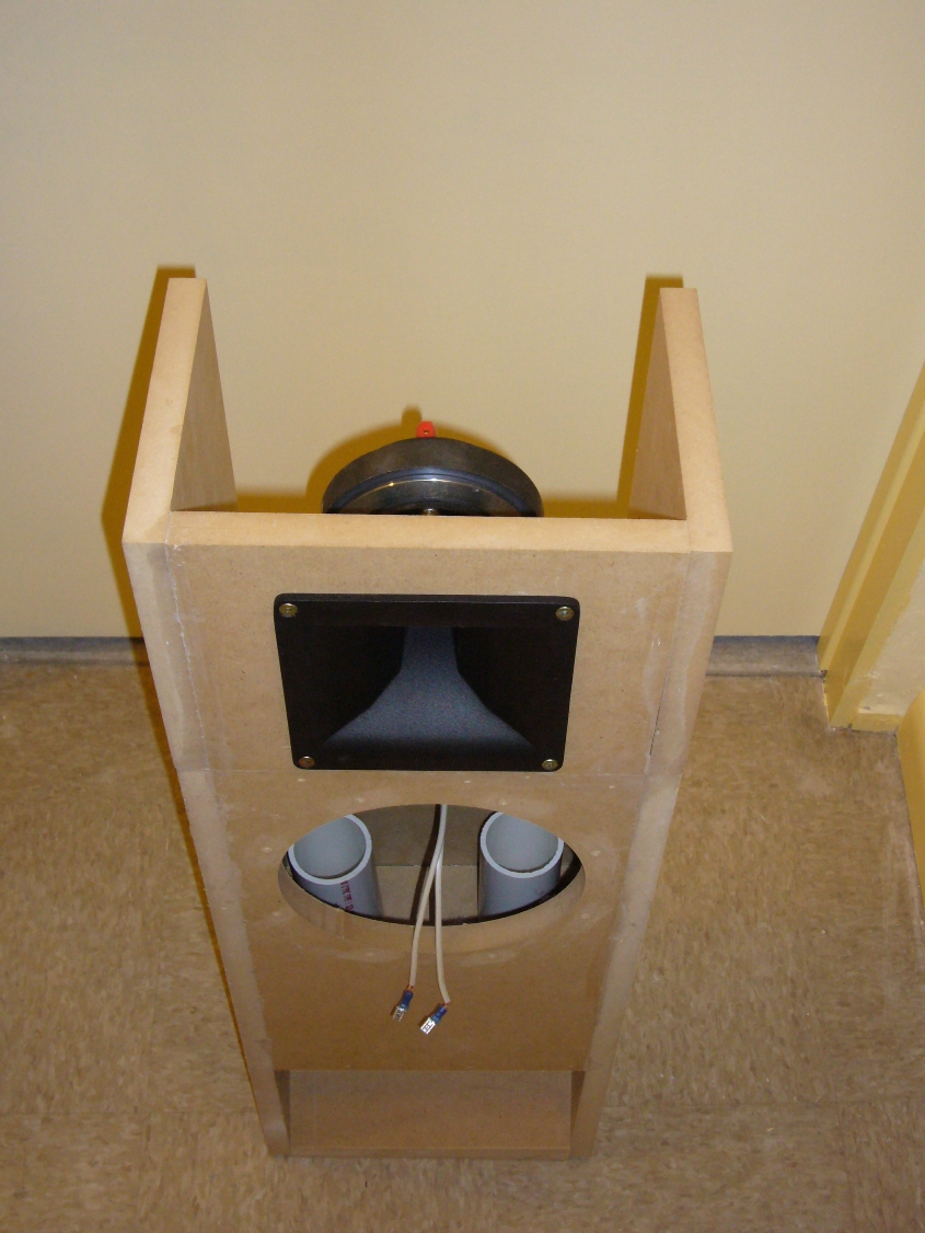

Progress... got one tweeter mounted. I need to make a top of course... woofer box is separate.

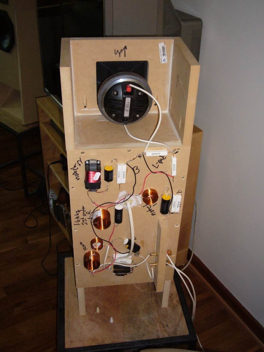

I finished installing the crossovers! The speakers sound great now. I like the way my glass vibrates in my hand when the music is playing. I haven't done any measurements yet. I don't have time right now.
