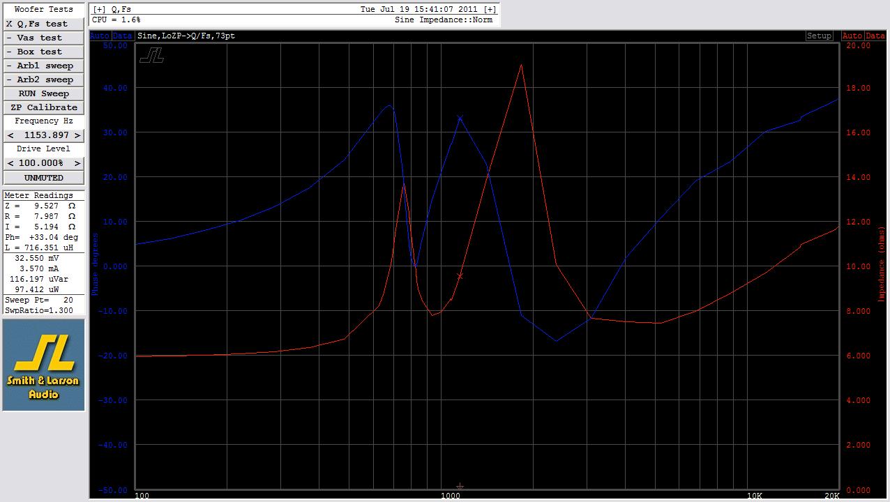

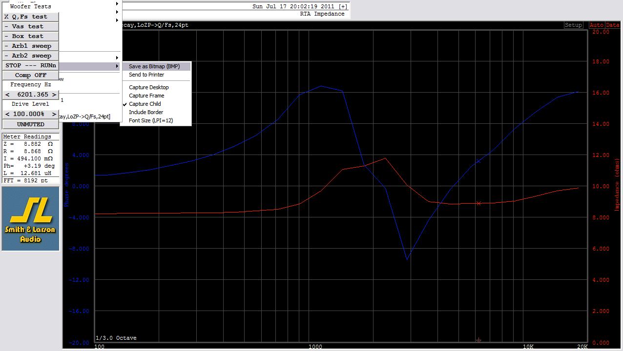

Speaking of twin peaks, I attached an 8 ohm variable L pad to my DE10/ME10 and ran WT2. What I noticed that the L pad would alter both the resonant peak and the inductive rise on the impedance curve, as well as of course changing the phase response. I assume something similar will happen with the DE250, but it has not arrived yet so I don't know for sure. How do I incorporate a notch filter in this arrangement? Do purists just not use variable L pads and stick with fixed ones? The B&C 8NDL51 woofer I'm using has a sensitivity of 94 dB and the DE250 is 108.5 dB. Obviously I need to bring the tweeter down a lot!
The attached chart is the DE10 with variable L pad set to half way. When it was at full up, the response was the same as if it wasn't there.

Sounds like what is described in this postSpeaking of twin peaks, I attached an 8 ohm variable L pad to my DE10/ME10 and ran WT2. What I noticed that the L pad would alter both the resonant peak and the inductive rise on the impedance curve,
On the subject of L-pads, assume your driver's impedance were resistive (and response, flat) for a moment. There would be a single value of series resistor that would give you your needed attenuation. Any lesser value of series resistor could be combined with a certain value of parallel resistor for the same attenuation. The end result would be the same (amp concerns aside).

What's the resolution there? Perhaps going a little finer would give you better control over the results, especially for these peaks.The attached chart is the DE10 with variable L pad set to half way.

OK, I ran WT2 on these DE250's + ME20 horns. I see two impedance peaks, one at about 1800 and another at about 750 Hz. Is there a way to calculate a notch filter using the data from this chart? Do I need other data also? I have only found calculators for either driver resonant frequency, using Re, Qes, Qms, etc, or one that used data from the frequency domain with peak frequency and -3dB points on each side as well as amplitude in dB to design a filter. My intention is to design a second order high pass filter @ 1600 Hz.
The data sheet provided by B&C does not list all of the T/S parameters for this driver. Anyone have them?
In order to cross over at the recommended frequency of 1.6kHz, I need a notch filter(s). There are two resonance peaks for this driver, according to their data sheet. So I need at least: Fs, Qes, Qts, and Re. I sent an email to them on Friday but have not heard back yet. Maybe it's holiday in Italy or something. I'm sure they'll get back to me eventually.
