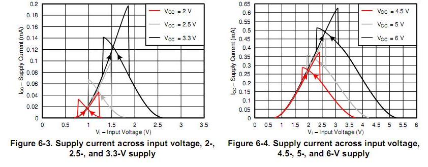

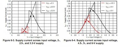

These graphs from 74HCS14 datasheet are pretty close.

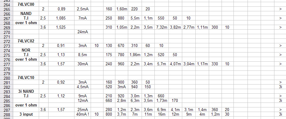

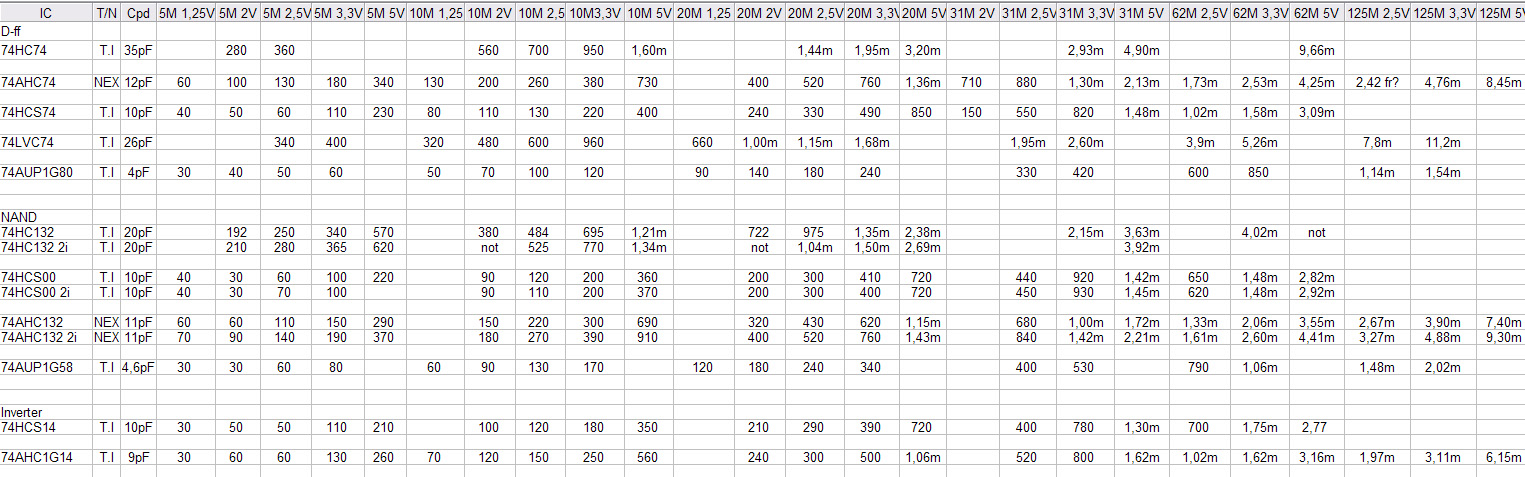

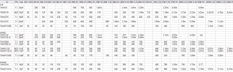

OK , HCS ! Most spectacular is a comparison with a high freq on the input of NAND ST 74HC132 , 74HCS00, 74AHC132 (nex) and 74AUP1G58 (as a NAND) , I don't have the LVC132 , and the D-FF's : 74HC74 , 74HCS74 , 74AHC74 , 74LVC74 and 74AUP1G80.
Frequencies of 10Mhz and up came from LVC1G17 or LVC74 , so very fast rise and fall times.
NAND's : HCS up to 6 times less current than HC , even AHC beats HC with higher speed , only AUP -designed for low power- beats HCS but can only take 3,6 V max and only in 1/2 gates little logic, no SOIC14 .
D-FF : The same ! Why D-FF AUP1G80 draws less current than an AUP gate like 1G57/58 or even 1G00/02 (nex) is beyond me !

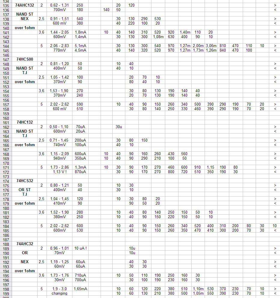

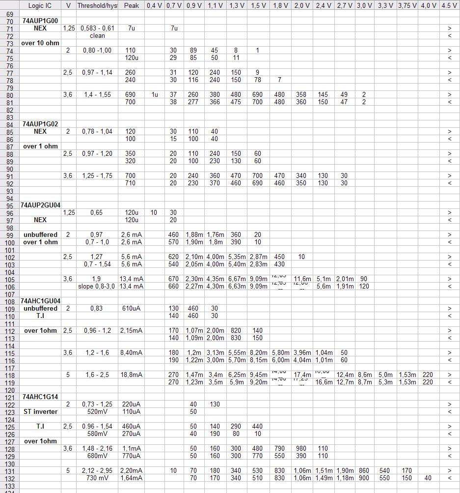

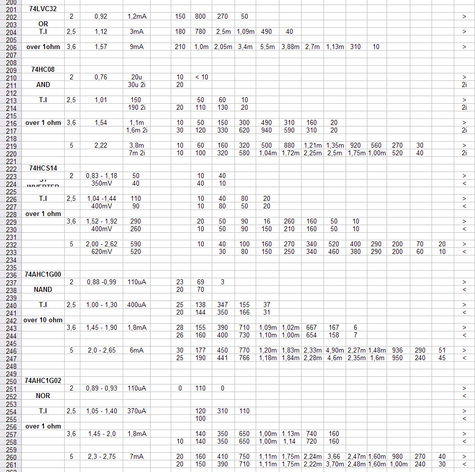

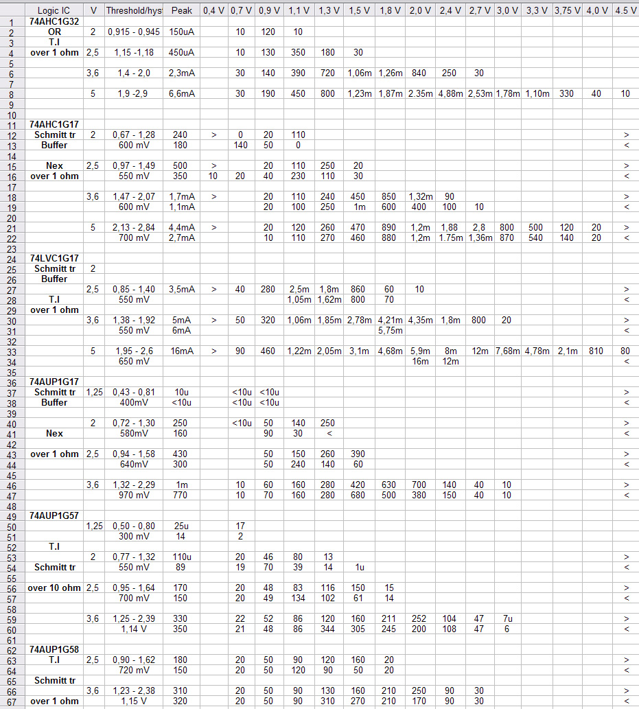

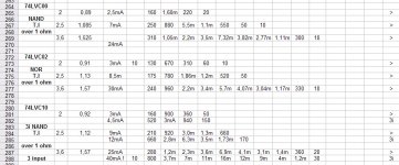

Then there is the current peak between the thresholds , HCS max 590u 5V , 270u 3,6V , HC 1,3m 5 V , 600 3,6V , AHC 5,1m 5V 1,8m 3,6V , 350u 3,6 V for AUP.... HCS is even better than the low power AUP !
Threshold for AHC : 600 - 770mV ( and yes at 2 V larger than 2,5 and 3,6V)
HCS : 370 - 600mV small but enough
AUP : 300 - 1,14V , which could explain why as an RC-ST oscillator , the freq goes up with lowering the supply voltage , but then again not with HC : 600 - 1,03V but this isn't so wide as 300 to 1,14 V.

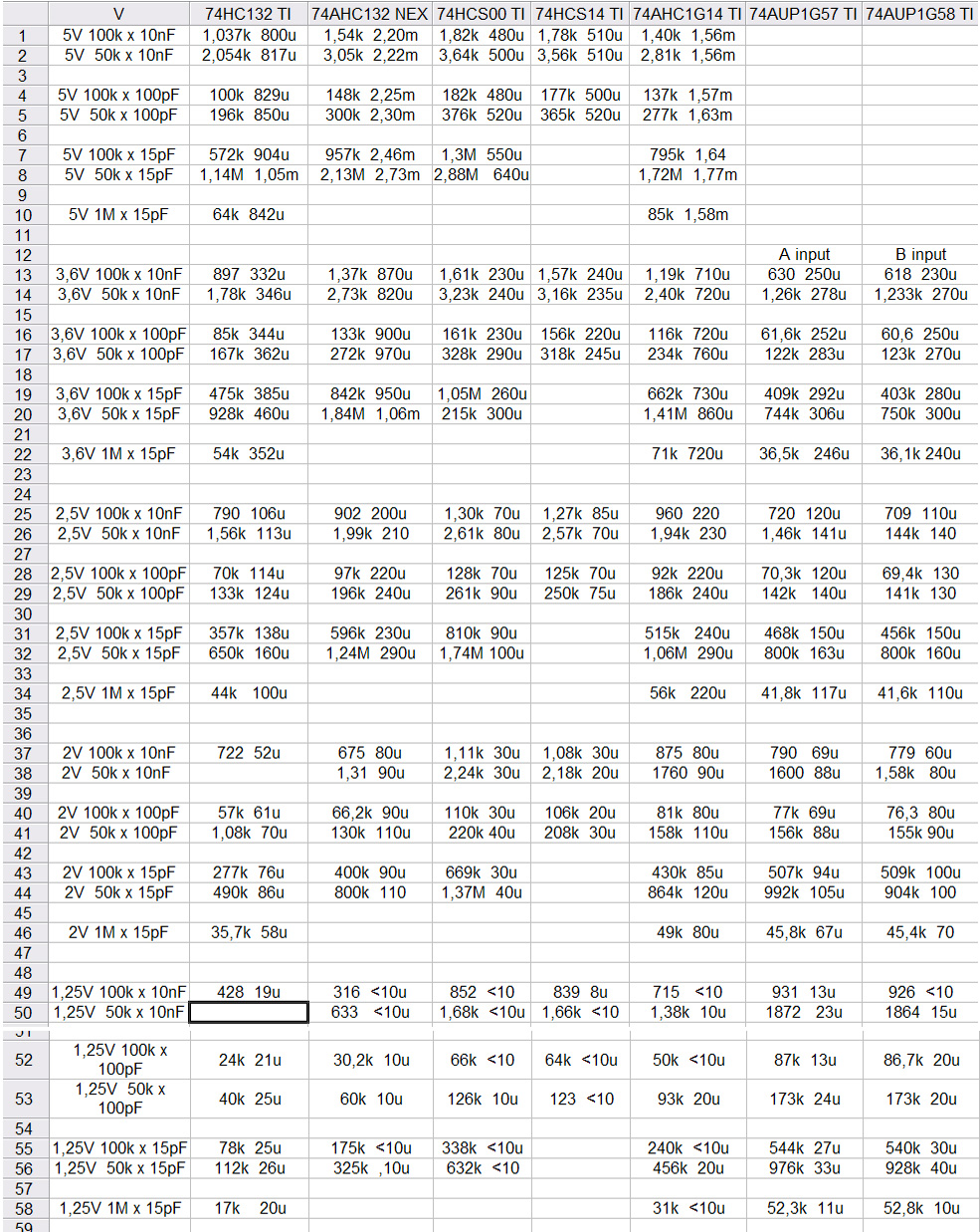

As RC-ST oscillators , no surprise that the AHC needs more current , but the differences are not that big compared to the peak current between thresholds. HCS is the same or slightly better than even AUP.
With RC-ST oscillators the size of cap and resistor or the frequency don't matter that much , within reason of course.
HCS is all in all pretty much the overall winner. Only for raw speed , AUP , AHC and LVC will be faster.

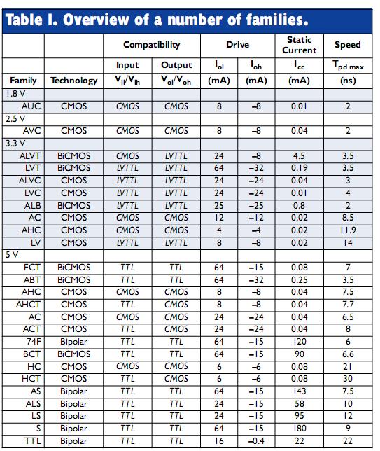

Or, maybe our applications have different requirements. In my case, I make music synthesizers, some of which are battery powered. Blazing speed, or fast rise times are not important. I am using 74LV or 74LVC series logic whenever possible. The CMOS multiplexers in this series have the lowest on resistance when used in 3.3 volt or lower applications.
Yes LVC has one of the best current drives in CMOS.
BiCMOS and some bipolar even more.
I don't know what the consensus nowadays is . Truth is for what we (I) use them , the faster ones are overkill . The 4000 series used to be my favorite , but the trend is lower voltages and lower power. 4000 gets slow below 5 V , HC and like T.I says drop in replacement HCS , are fast enough , although at 2-3 V they are not that fast anymore. I like these little logic 1/2 Gate ones and funny T.I says one shouldn't choose faster than necessary, because if you want 1G 's in HC , only ON and Nexperia have some . You have to go AHC1G , or LVC1G , AUP1G (and others) if you buy from T.I.
The older types like 74AC suffer more from groundbounce and noise , the younger ones not so much , but like all high speed , keep connections short , so PCB layout and EMC won't be much of a problem. HCS , AHC and AUP have the same or lower drive than HC and draw less current so I don't see a problem using them to replace HC. Now this is my opinion , other may say that I'm wrong.
