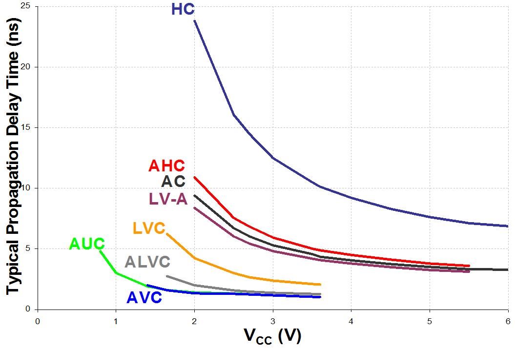

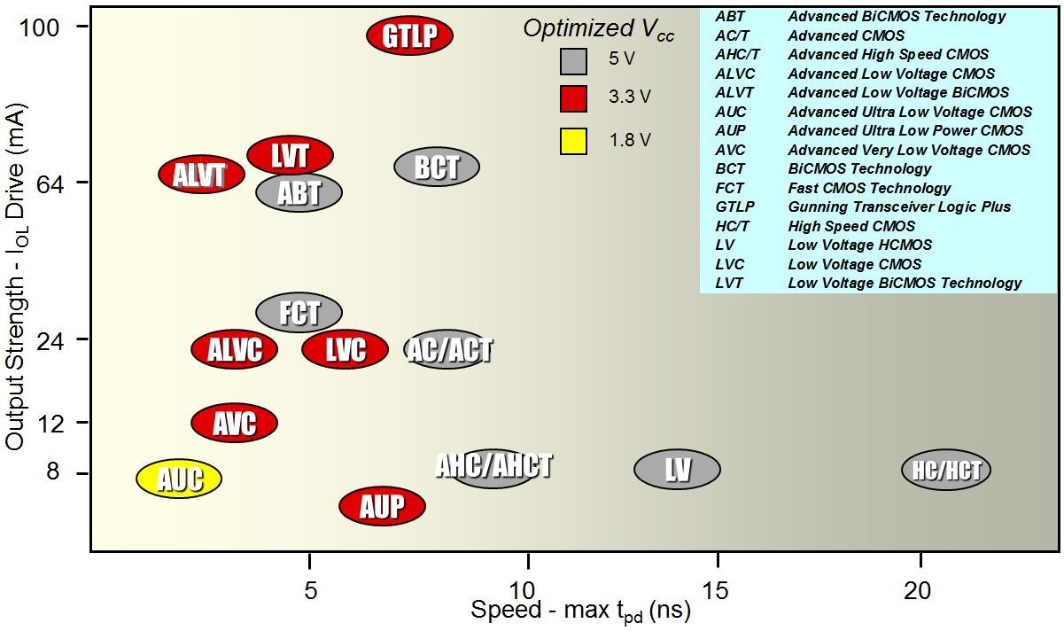

Here's T.I.'s logic families :
Since the end of the eighties , I've been using Cmos 4000 & HCmos logic and Eproms and I love designing circuits with them even if one uP can replace them all .
Now there is more choice than ever , but HC is still my favorite.
Of course in SMD , no DIL ... for logic DIL is so seventies or eighties.
I even tried TSSOP , still doable but best is SOP /SOIC.
The all schmitt trigger inputs are more important , to tackle low input voltages.
I meant : slow input voltages.

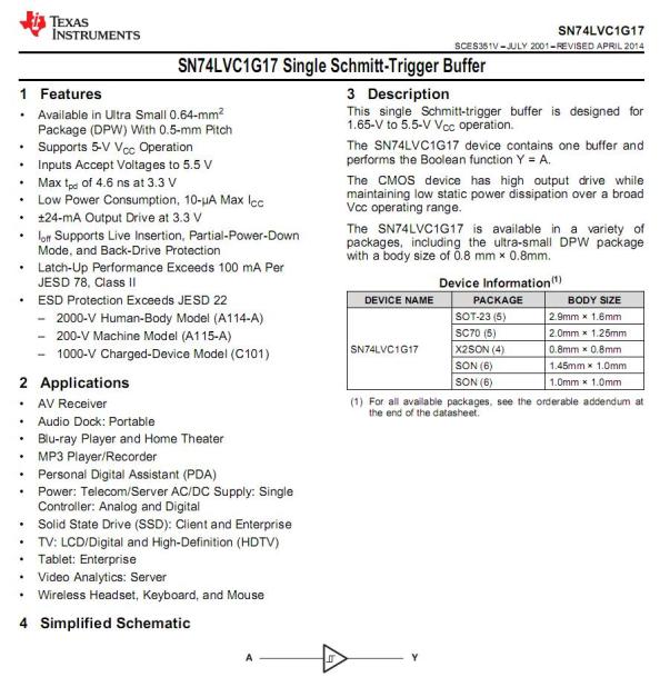

^ I thought you meant with : linear" using it as amplifier .
If you want more than 4 mA output of HC/HCS , check out these babies: SN74LVC1G17.
Buffer with ST input and up to 38mA output at 5,5 V and faster too, around 1 ns ! 4 ns max.
Usually 74LVC is max 3,6 V , this one 5,5 V.
Very tiny package with 5 legs. Smaller than making a buffer with 2 mosfets like 2N7002 and a P channel, for the same price if you can buy them cheap. I did .
Ideal for after a RC timing to power a relay.
