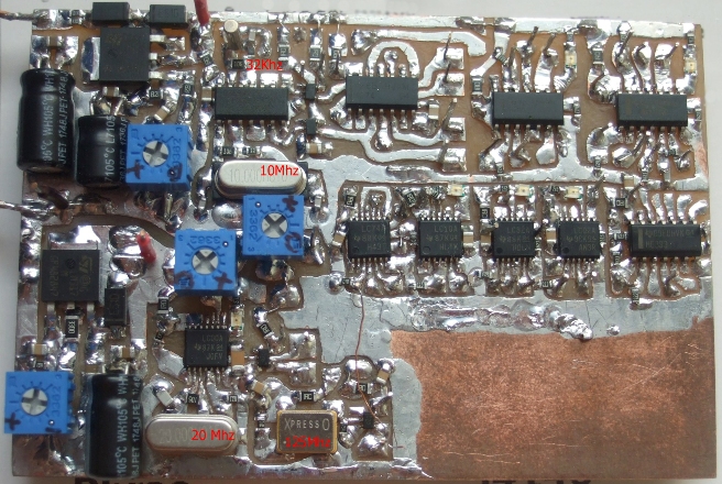

Forgot to post the test PCB I made for testing . The TSSOP's are TI's 74LVC's , the SOIC's are 74HC's and the 4069UB. The 4 little black ones are the 74LVC1G17 buffers.
Right under : still some place for testing AHC/HCS and the AUP1G's .

Thanks AIM65 . It's just a milled test PCB so it didn't matter that much but I had fun making it.
Simple set up : 4 oscillators with LVC17 buffers for nice rise and fall slopes . HC and LVC D-FF to divide the higher freq because my DMM could only go to 10 Mhz according to its specs , but it could measure 20 Mhz. :) A HC393 for further division .
Then the HC an LVC gates to measure current draw at different frequencies and at different Vcc's , with signal in 1 or the 2 inputs ( or 3 for LVC10) . Threshold voltage & max current draw at the thresholds , that is why 2 of the trimmer are for. 2 regulators with trimmers for 1,25 to 3,6V for the LVC's and 125 Mhz oscillator. 2,5 to 5,6 V for HC and the LVC1G17's . Current measurement over a 1 ohm R , DMM measures down to 10uV , so 1mV = 1 mA , easy.
Testing takes a lot of time and I didn't want to keep my old computer powered on , so I wrote it all on paper.
I tried to measure the HC's and LVC's the same way to directly compare , but like you read above with Cpd's (that don't make sense) , there are differences between simple gates of course and for the same freq / supply voltage , Texas Instr 's LVC gates comsume a little less than TI's HC gates despite LVC's much higher speed and output current (lower Rdson of the output FET's).
If you mean 74LS04 ... and read the above , you will know I have no interest in TTL logic . LS = low power schottky TTL. I have only 1 TTL IC I bought more than 30 years ago : 74F74 to compare to 74AC11074 , the 74AC won ...:p :)
Fun fact , or not : The old 4069UB with 32,768 Khz X-tal <10 uA op 5 V.
10 Mhz X-tal : 1,12 mA with 2 of it's brothers as buffer on 5 V , quits at about 4,35 V . Pretty good for the old CMOS4000.
20Mhz x-tal LVC00 without buffer on output : 2,16 mA on 3,3V.
I like the 1 gate Schmitt-trigger oscillators , but with TI's 74HC132 : 1 khz with 10nF x 100K = 800uA at 5V. Same but 1K x 10nF = about 100Khz at 2,02 mA , 5V. So the 32Khz cheap X-tal with the 4069UB at 10 uA , clearly wins. For ST oscillators Nexperia's consume more . One thing NXP is not better at.

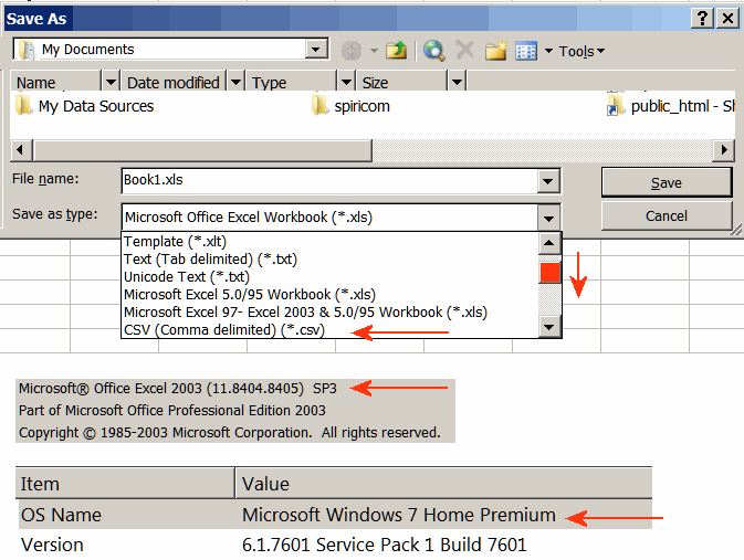

...wonderful XP :), with office 2003 ...Excel probably isn't compatible with the new ones
Save, As... CSV is pretty nearly universal. Won't preserve multiple pages or graphs but real sheet-whackers don't do such things. eXcel warns you about lost features but it is just bragging.
This forum won't attach a CSV, but tack a .TXT on the end, and tell downloaders to strip it off.
..., I know I can't open the new ones with excel 2003.....
There is a whole pile of Service Packs, labeled MSO 2007 but applicable to 2003, which lets old programs open/save most new MS formats.
There is also Open/Libre/Free-Office.

^I made a test excel but there is no CSV option to ''save as" .
Your attached file only shows 4 numbers in a text doc.
I had to take a course in windows office around 2003 and it was boring as hell. Computers should be fun . Office software isn't . (of course trouble shooting isn't fun , but a necessity)
It's going to be tough to change all my Works Databases into something new when I have to buy a new computer hopefully with linux.
