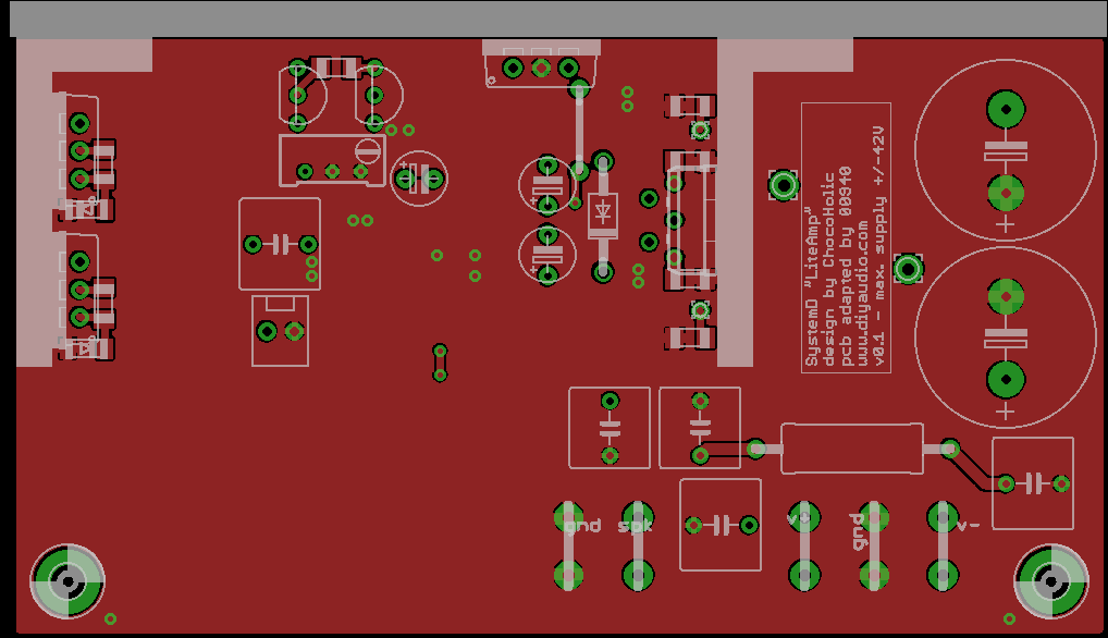

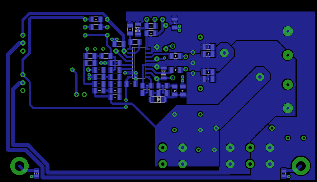

Had some fun with the soic package... Plenty of room left on a 100*55mm board for an input stage and its supply (with only one mosfet package obviously). That's work for tomorrow.
No smd parts under 1206... should be easy to solder. All caps but the output filter's ones are smd NP0.

...(with only one mosfet package obviously)...
I see you also skipped D7, D8, R30, R31.
Basically that is possible, however you might have to readjust R32 and R33.
Or alternatively you might need to enlarge the dead time. For dead time adjustment you will need R26, so better keep this in the layout.
No need to be afraid of immediate defects, but if you notice that during idle the MosFet is generating unpleasant heat, then will have to readjust.
And of course you can spend some months on retweaking the last 0.000000000% THD. 😛
If you also intend to use the layout for +/-80V then you should increase various distances between tracks with rail voltage or halfbridge levels.
Once again, thanks for the warnings/comments/suggestions.
Without much thinking, I indeed remove those resistors to ease routing. I intended to simply add 6r8+15 and use a 22r resistor. A bit naive maybe... D7 and D8 were skipped according to your suggestions (post 223).
I'll find a way to fit r26 back in.
Btw, since we're speaking layout do you think I need another pair of 1uF caps near the mosfet under the board ? I've got a pair next to the mosfets pins on the groundplane side.
With one mosfet package, I'm doing this as a strictly home-hifi affair. I wouldn't feel at ease without the second pair of mosfets at those voltages.
Thus clearances are just like we discussed a few months back :
- the ground plane has an isolate rule set to 12mil,
- the power planes have isolate rules set to 16mil (I corrected the two tracks going to the left of the board, they were too close as there is 80v between them),
- the drc check is set at 12mil for the rest.
I think keeping the 15R resistors unchanged would fit better, also fitting to post 223. (Higher drive impedance leads to shorter effective dead time.)
But in fact I did not go for a real life optimization of the single
MosFet version. With respect to this it is good that you will 'find a way to fit R26 in'.

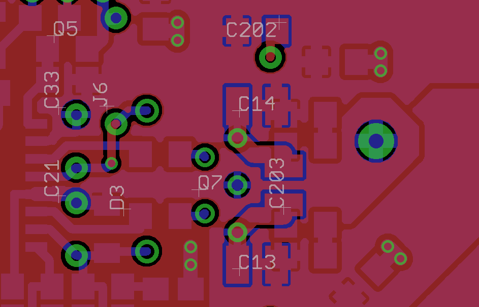

To start with, I wanted to say how impressed I am by Chocoholic's willingness not only to share his project but also to answer questions about it, often beyond what was originally asked. I've been browsing through the class-D forum and there are very few open designs and even fewer with published measurements. A thousand thanks.
On the other hand, Eva's post made me realize two things:
- the app notes from IR insist quite a bit on this rail-to-rail cap close to the mosfets. I've no doubt the plethora of caps around the mosfet pins on the liteamp pcb do the job. On my layout, maybe less so. It's quite easy to add it at this stage so why not ?
- the bigger the package, the better the capacitance change vs DC bias of ceramic caps (for a given value/working voltage). K-sim on Kemet's website is quite enlightening about that. So I'll shift a few caps from 1206 to 1210.
This brings me to the attached layout for the output stage. Does it look better ?

00940: Good, but populating both C13 and C14 can result in additional resonance and more ripple between -V and GND. My recommendation is populating only C13. You got the right layout to compare. You are right about the capacitance drop towards rated voltage, it happens mostly on small sizes in X5R/X7R-like dielectrics, and on all sizes for Y5V-like. But, there is another difference between 1206 and 1210, inductance increases for longer size in the "12" direction, but is reduced for longer size in the "10" direction.

00940:
Back to the ceramic caps. It is of key importance to provide a low Z and preferably slightly lossy path for high frequency currents between the drain of the MosFet and source of lower MosFet. Placement should be in a way that the inductance of the loop from upper rail => upper Mos => lower Mos => cap(s) => upper rail has lowest possible inductance. You gain nothing by using a smaller package and then adding inductance by the tracks towards the cap. However making such tracks wide helps to reduce the loop inductance.
Looking at the cap(s) - typically 100V X7R types are available in sizes were two of them in series will show mostly the same inductance like one 250V type+more tracks.
However if you have two in series you have to define their DC operating point, which easily can be achieved by connecting their center tap to GND. If you use the GND plane for this you get a very low inductive track for free. Downside is as said Eva that you inject more noise to GND.
If these caps increase or reduce the noise on the rails will depend on the very specific layout and also will depend very much were on the rail tracks you will measure.
Overall EMI in the frequency range 10MHz - 1GHz is not always acting like one would expect at first glance. Statements on this only turn reliable for a specific design by measuring this design in the EMI chamber.
My posting about paralleling two pairs was not focussing on resonances, but component stress. X7R or even more lossy ceramics cannot handle unlimited HF-currents continuously.
