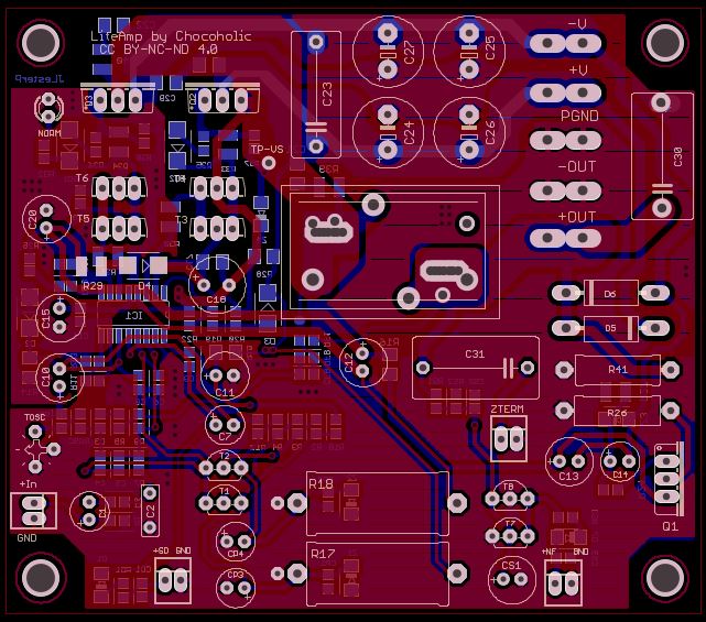

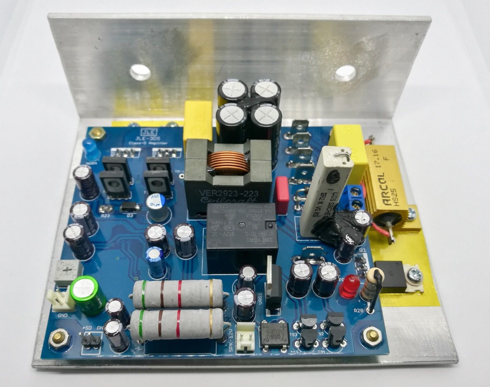

I updated freebie gerber for liteamp.
Compatible inductors:
AGP2923 / VER2923
1D31A
1D23A
T157-2 (vertical mount DIY)
Can use IPP120N20NFD
Chassis mount resistor for zobel
Heatsink mounting should look like the one attached (see prototype)
Attached schem (just don't mind the component values)
If anyone wants the gerber, please message me

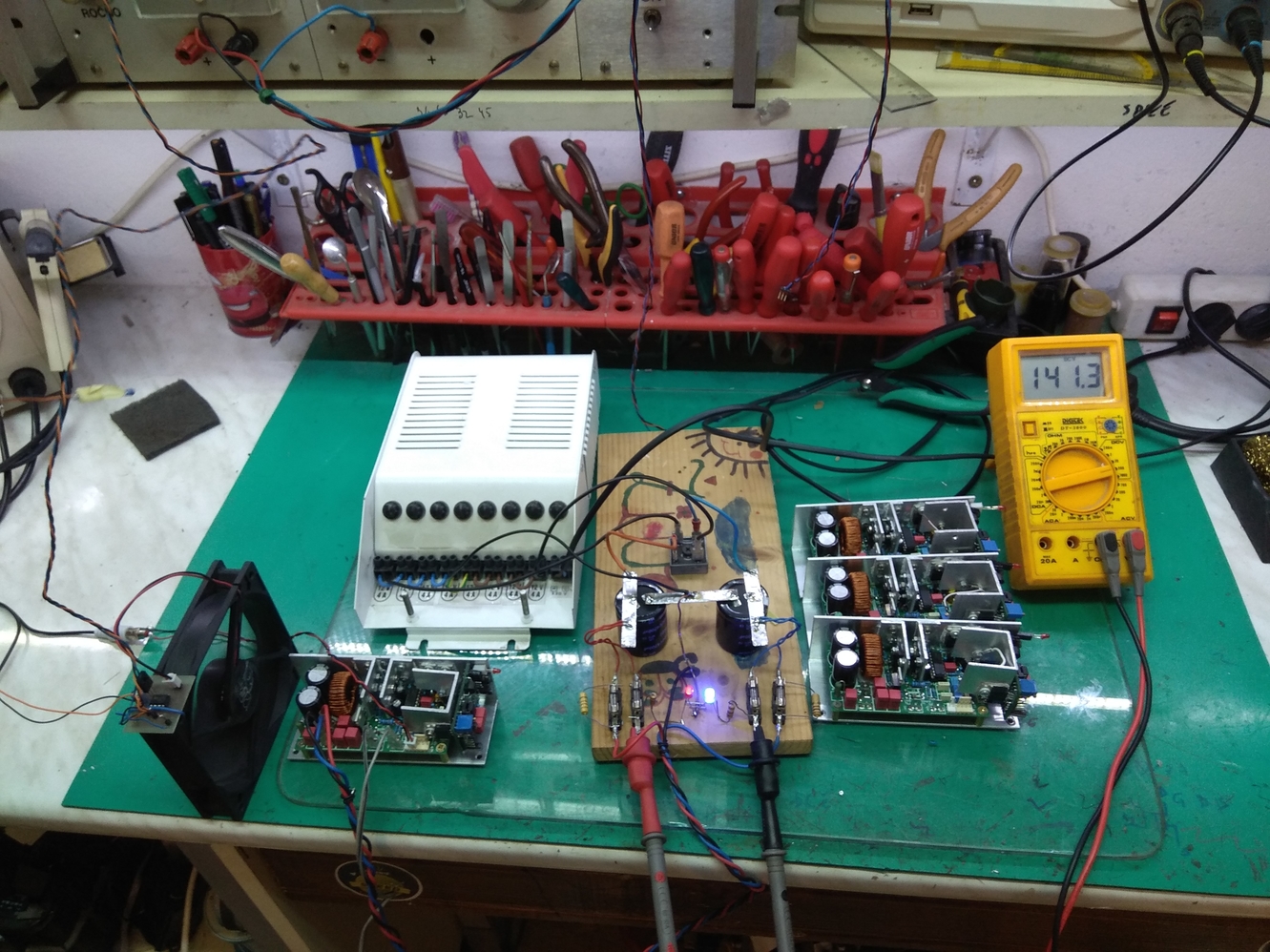

First board tested with +-70V DC power supply, sound is very good ,no hum or noise .3 more boards ready for testing with higher supply,for now they were tested only with +-40Vdc.
Not the easiest amp to assembly but it is worth to try.
Thanks ChocoHolic for sharing your amp .
It always makes me happy to see new builds. My congratulation.
One general remark. From theory it is not mandatory:
But after touching Q1 of my 2x80V version, my bio sensor convinced
me to put a small heat sink for Q1 as well.
Note: You must not touch it anyhow, because of dangerous voltage!
The gap between theory and bio sensor feedback is clear:
Bio sensors send alarm above 65 C, while such BJTs can easily run reliably for long term above 100C. Likely the heat sink for Q1 is just cosmetic, but I felt better after putting it.

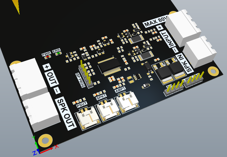

I managed to destroy my module with excessive bus pumping. dc almost took out my peerless XXLS-P835017.
It seems this project is due for an upgrade. I need something for a subwoofer application.
- IRS2452AM full bridge.
- ZXGD3005E6TA mosfet drive.
- IRFB4615PBF or keep IRFI4020H.
- Assembly + maintenance friendly PCB layout. (4 layer)
- Microcontroller supervision.
I'm game for the upgrade.
Lockdown allowed for time.

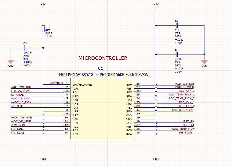

I experimented with a dedicated supervisor circuit.
I have managed to complete 70% supervisor layout and 90% of the firmware is done as well.
Here is what it can do.
- x2 dc monitor voltage +/- up to 100V (programmable 1V steps).
- x1 dc offset +/- (programmable 1V steps).
- x2 +/- current rail monitor 20A (programmable)
- x3 temperature sensors each programmable.
- x1 signal shutdown command output.
- x1 switching frequency monitor.
- x1 4-wire fan output + Fan RPM monitor.
- x1 solid state relay. (will upgrade to x2 for full bridge application)
- x1 SPI control and communication. (I2C "master mode" is a dog to get right on a PIC16F18857)
The cost of doing this is no more than $20 parts, but the firmware took a while to get right. I have a breadboard of it working on the desk.
