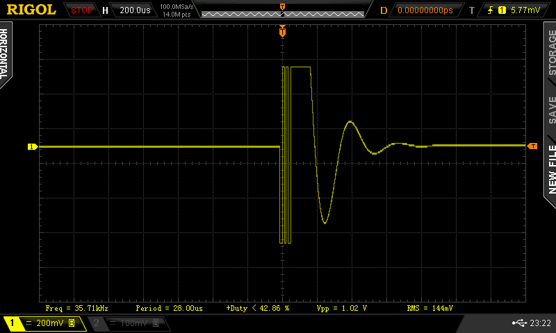

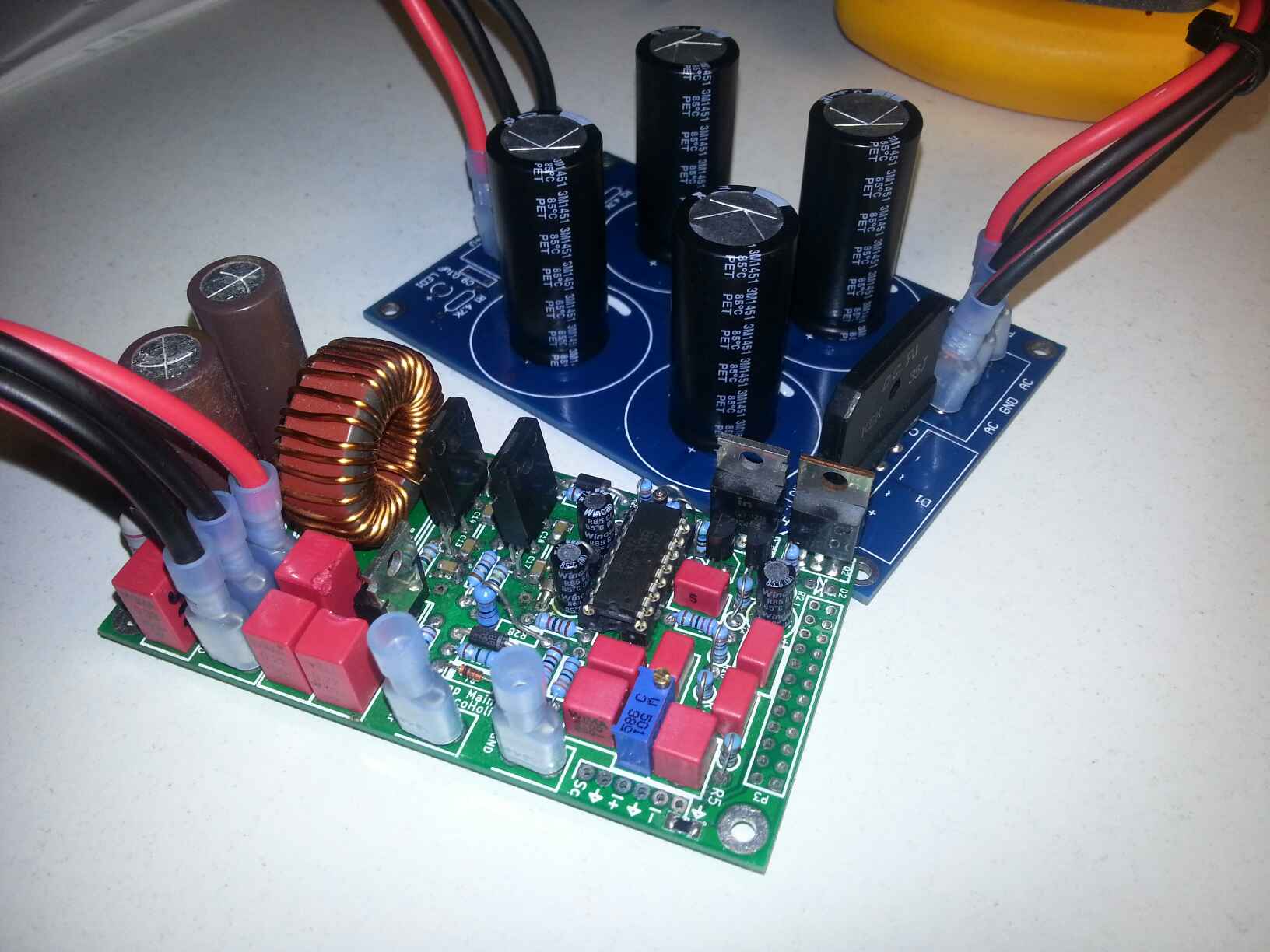

I think I goofed up some where, my amplifier blew a FET and took out the driver.
I followed the getting started guide and determined all the voltages. (with +/- 37V as my supply bus)

Connected my scope up, no continuous oscillation, just a few bursts of oscillation, I removed the current limiters and one fet heated up and took out the driver. I know I should never have done that.
Well I fixed up the issue as I have fets for my other board, use one of them and replaced the driver IC, with the 100R current limiters, with the new parts fitted, I went over the voltage check list it passed, still no oscillation, nothing at all this time. its probably something very simple im missing but what can it be.

Before destroying all power devices:
1: You can run the amp with one halfbridge. No need to have both Q6 and Q7 in place. One of them will already be fine for loads of 4R and higher.
2: Check if the first burn out really killed Q6 and Q7 or just one of them.
Let's start with the first situation. Amp in burst mode.
If all voltages are fine as described, then the remaining typical reasons for this would be:
- Forgotten to remove one of the shorting wires
- A short in the power stage, filter section or output
- Error in the feedback and loop gain network
- Wrong resistor values at OCset or OCset shorted to -40V rail
- Wrong resistor vaules at CSH
In order to understand what happened after you removed the current limitation - please tell what exactly you mean with

I also set-up the scope to trigger in single shot mode at the output, this is what I got, a short burst, the burst events are frequent every 4 seconds, not sure what this means.

Thanks for this description. It is pointing to an error which either makes the protection of the IRS2092 ineffective or is generally not caught by its protection mechanisms.
...have to think about this, it is an error which did not happen to me during my design phase.
Like all of us, I am trying to keep my amount of building errors low.
So everybody who builds the amp has good chances to make different errors than I did and searching them is more difficult than errors that I already made.
A new search has begun...
Good to see burst mode again.
The switching frequency of the first few periods seems to be pretty low.
More or less close to the filter resonance which will cause high currents and
trigger shut down, however this shut down mechanism also should reliably work without 100R in the rails and with the implemented 4s restart delay it should be save until slow overheating of the MosFets may happen.
The low oscilation frequency is pointing to errors in the feedback and loop gain network (all the components connected between the amp output and pins 3&4 of the IRS2092).

Thanks for the help thus far, burst was there, I had to enable persistence mode on the scope.
Anyway, I will have now turn to the feedback loop and re-check all the components again, it might just be something very simple like a small solder blob.
