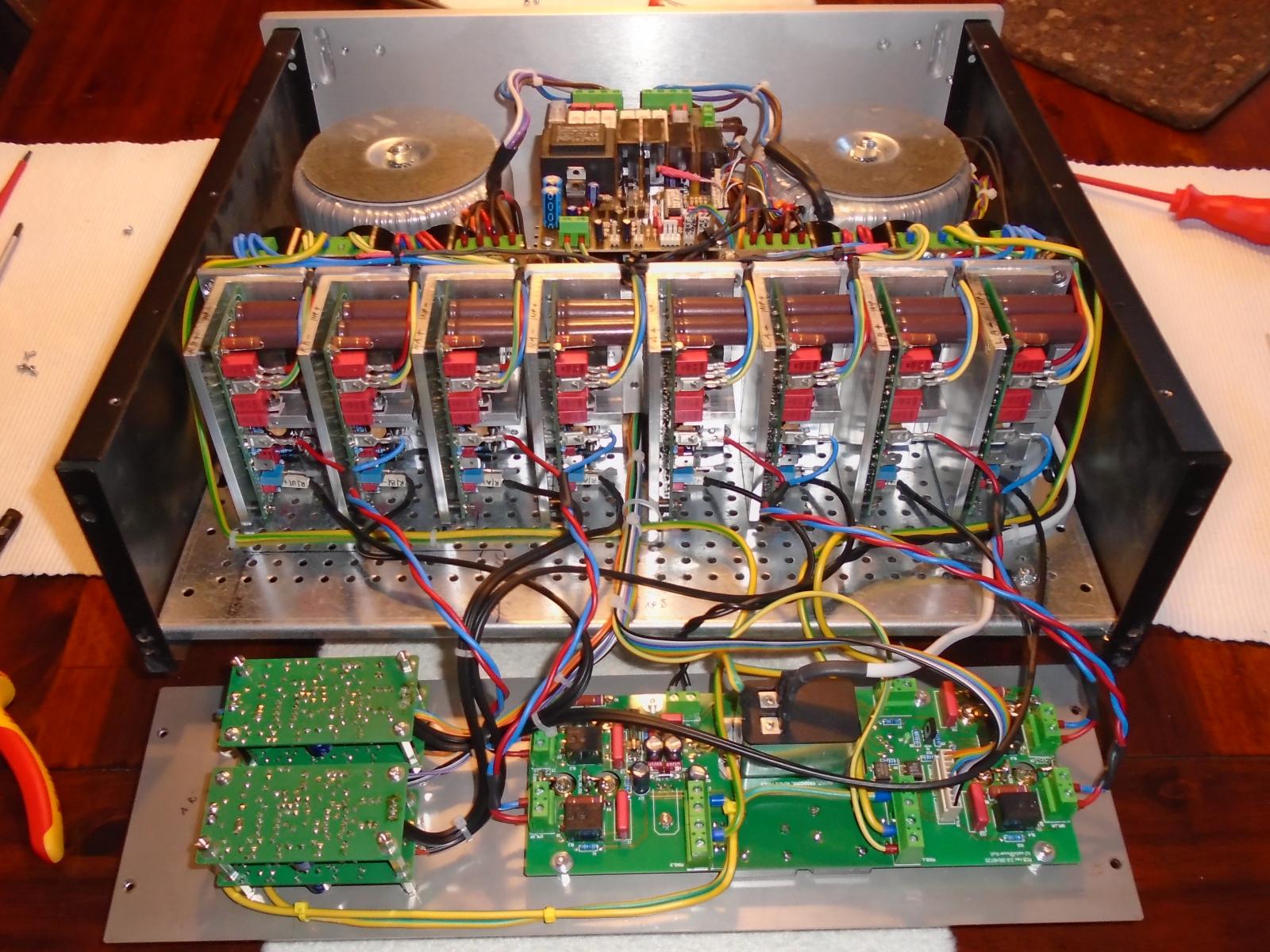

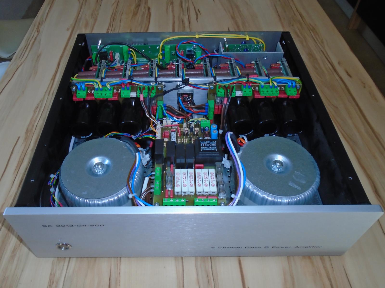

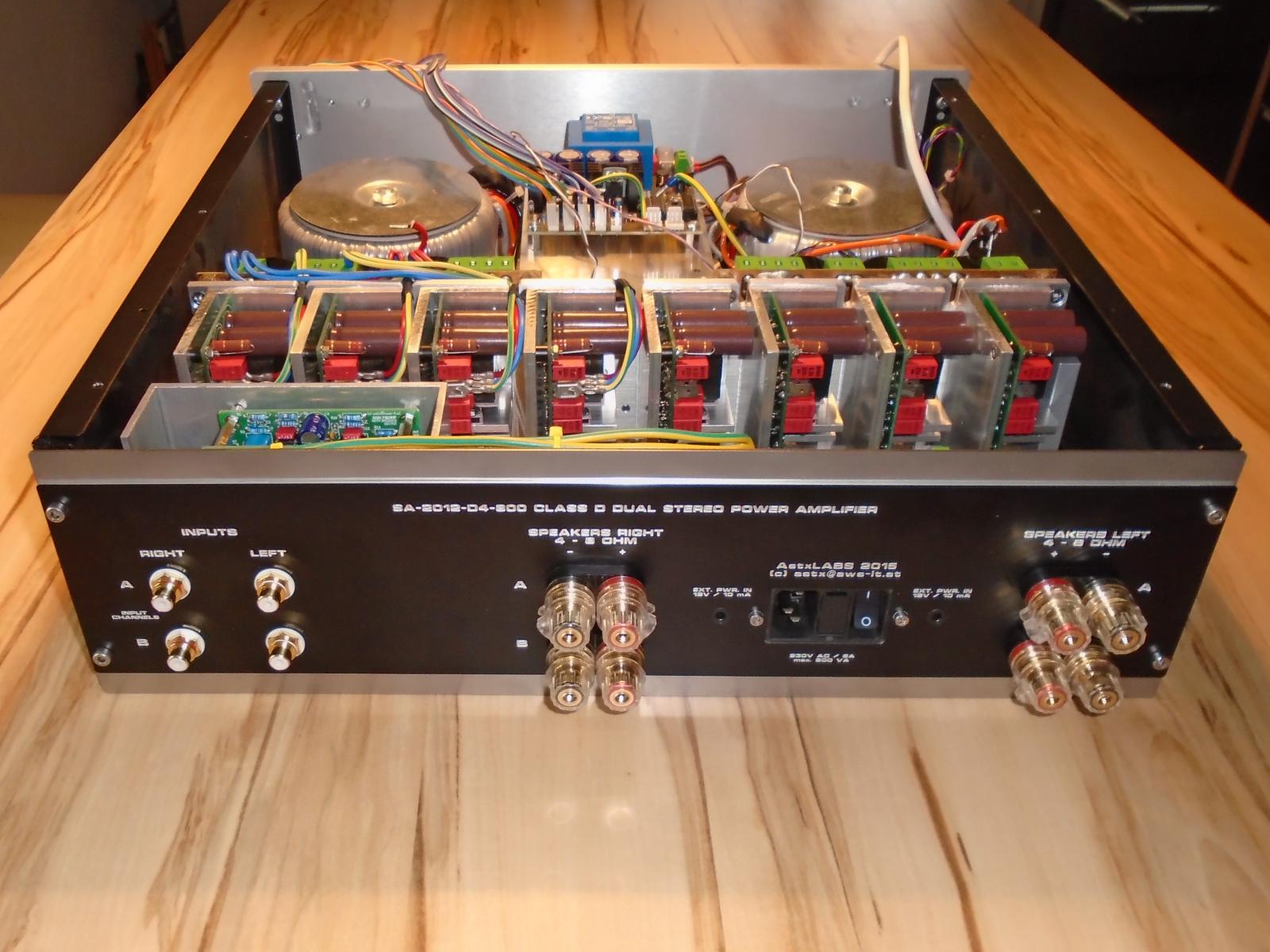

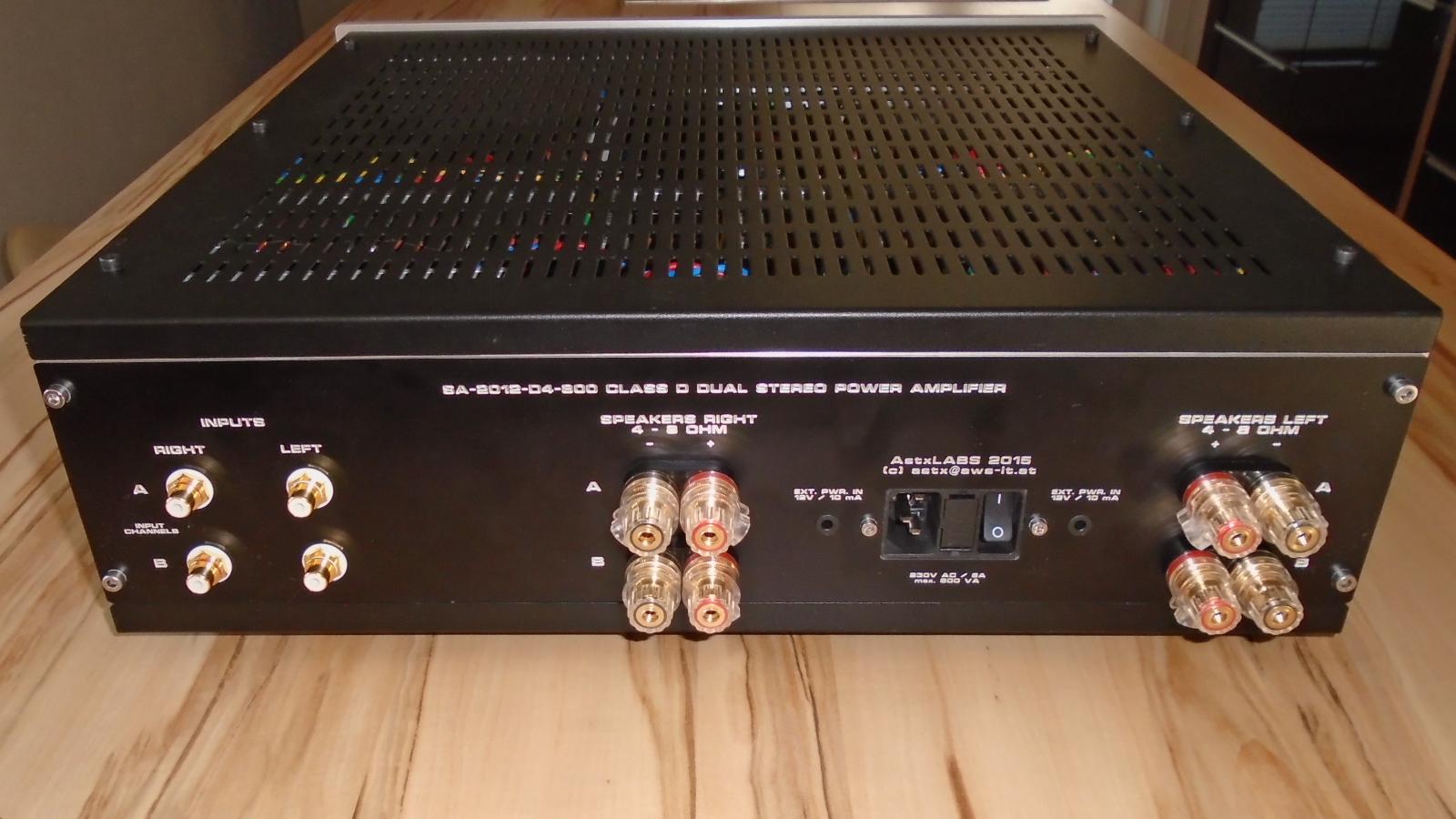

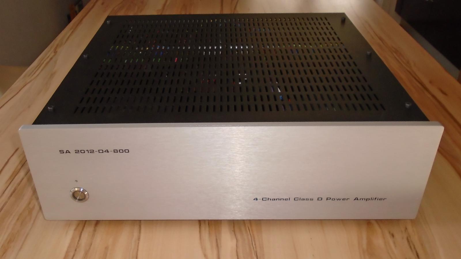

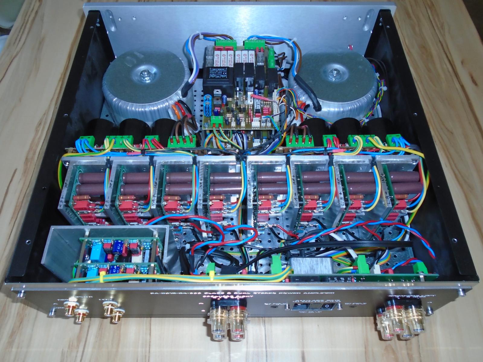

2 more pictures answering the question: "Does it fit?" 😉
BR, Toni
SystemD LiteAmp running bridged:
Listening tests successfully completed.
A comment of an audiophile listener: very analytic
IMHO: Very clear and exact sound reproduction.

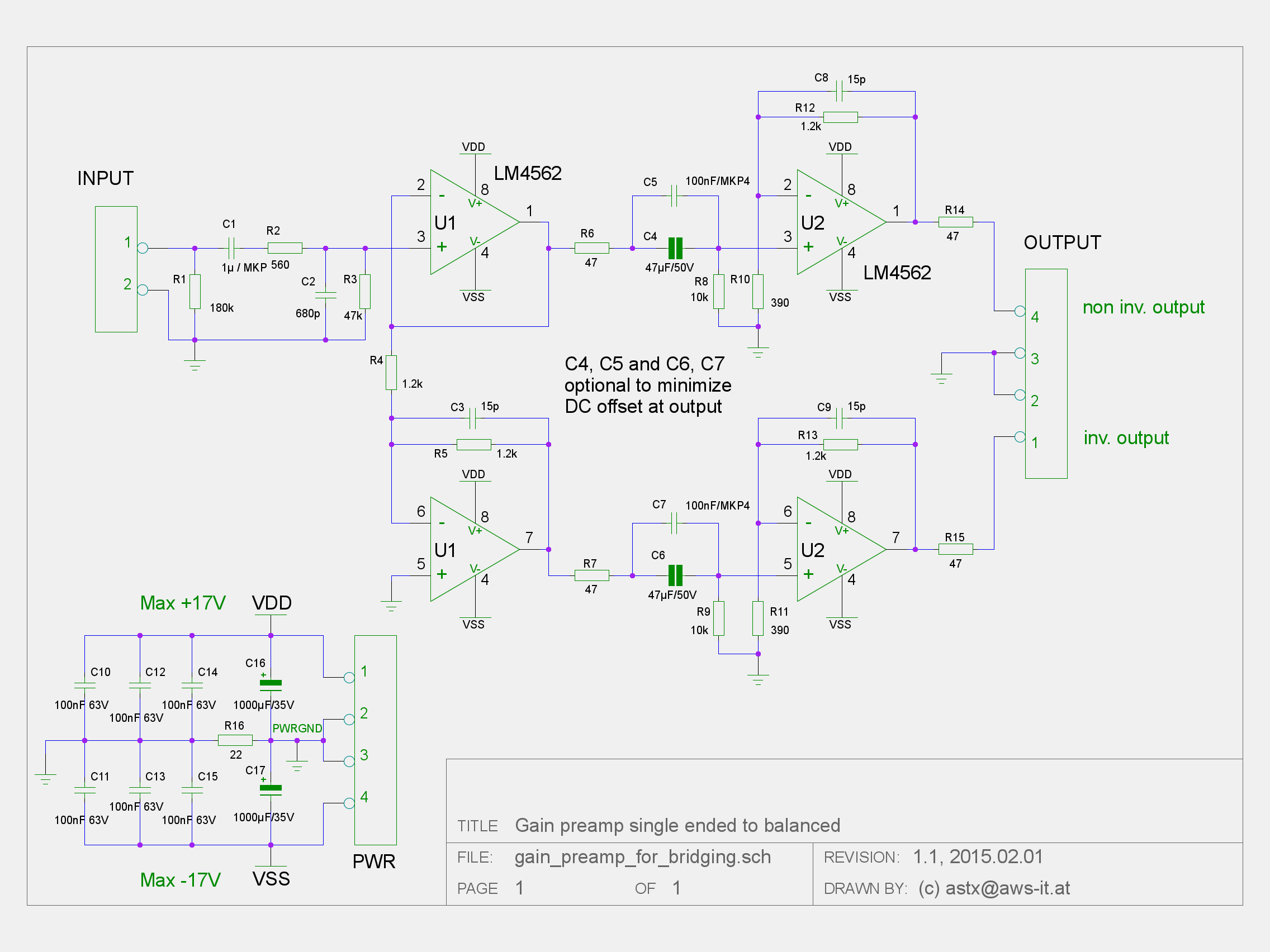

I have used my own designed gain amplifier. Attached the simple circuit to get the liteAmp running in bridged mode. The bridged amplifiers have an output zobel 47nF/4.7R connected between the speaker outputs to short circuit/reduce HF from outside.
Setup for bridging mode to get best SNR was:
THX Markus aka Chocoholic for this good sounding amplifier. 🙂
BR, Toni
- short circuit inputs to signal ground at gain amplifier
- remove extra output zobel 47nF/4.7R between speaker outputs
- pre-tune all amplifier modules to a switching frequency of about 380kHz.
- add extra output zobel 47nF/4.7R between speaker outputs and add 8R dummy load
- retune one amplifier in small steps to get lowest SNR.
- re-check switching frequency to be around 380kHz

Hi Toni,
that's an impressive build! My congratulations !
Also I am glad that you are enjoying the sound.
... the audiophile listener - this wasn't you, right?
Are you not an audiophile listener?
Personally I heard the description analytic already for amps
which liked very much:
Giving you the perception of nothing messed, but vital presentation of details.
On the other hand I also heard the description analytic for amps which I disliked:
Cold and dead. Like something had sucked out all the live from the music.
Hope the audiophile listener's impression of the LiteAmp was more of the first type.
Markus

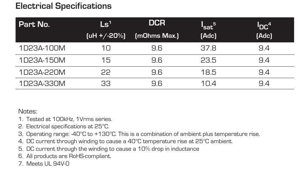

Hello guys, will the ICE power inductor 1D23A-100M (it says 37A saturation current) hold 1300W RMS in a class D amp without blowing or melting?
See datasheet: 9.4 A RMS (continuous!) will rise the temperature 40 degrees above ambient. Audio has a crest factor of about 10% compared to a sine wave. So don't think this inductor will "melt down".
