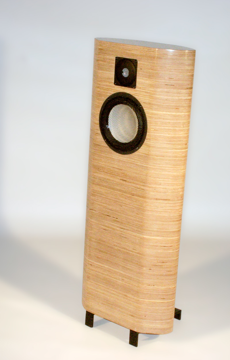

Hi all
I got this speaker system done few weeks ago but have tested it only few times. So far the impressions have been quite promising although measurings I´ve made havent´t been too professionally executed. Much of the equalizing and adjusting is done with just listening. Bass region is maybe lacking the final punch but above those frequencies there is exceptional precision and imaging. Tweeter is really smooth and realistic without any hint of hardness or risk of listening fatique.
The 7" woofer and 1" tweeter are ceramic Accutons. The setup is active and done with Hypex AS2.100. Internal volume is roughly 16 litres and tuned to 45 hz. Enclosure design is my own making and done with 21 mm sheets of Finnish birch plywood.

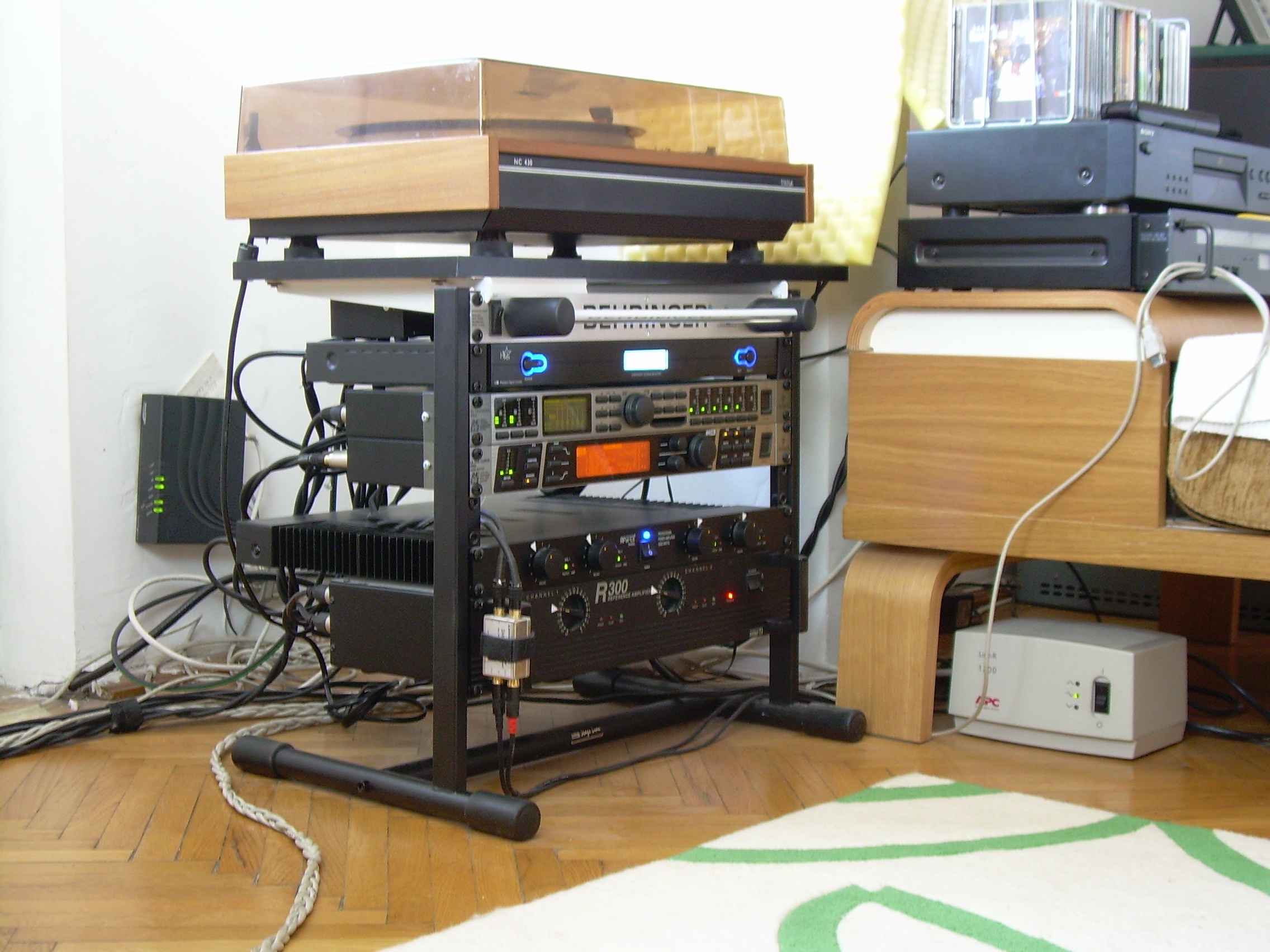

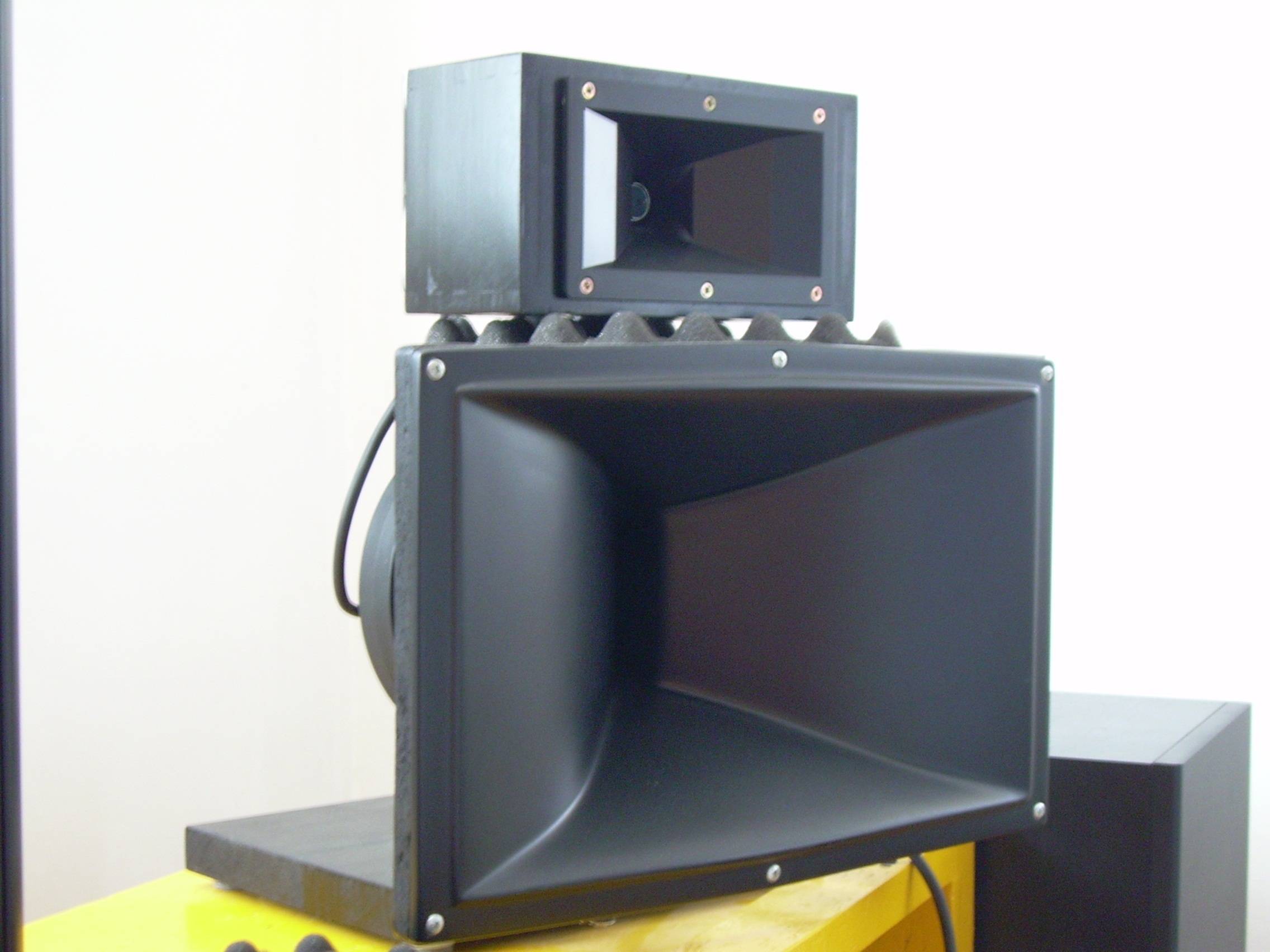

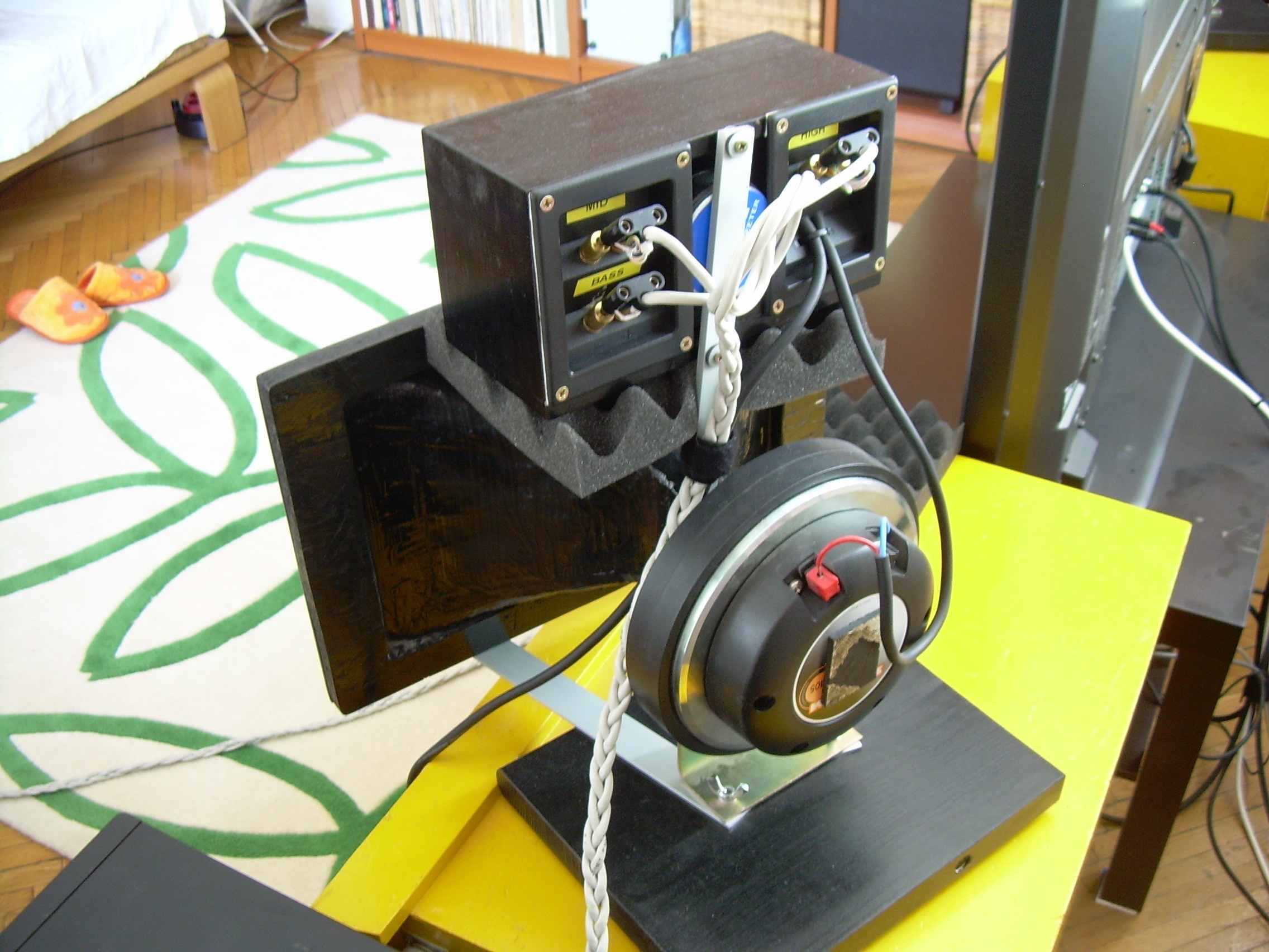

Hello Dorin,
I remember seeing your system on a local forum a couple of years ago. I bet it sounds well!
By the way, I remember Dr. Geddes and Mr. LeCleach advising to mount horns and waveguides on baffles (even ones with proper roundovers). It seems it helps with diffraction effects.
Good luck with the future developments of the system!

@ Tuakko, that is a very, very nice layered enclosure. I bet it's stiff. I think that is one of the best techniques to build an enclosure.

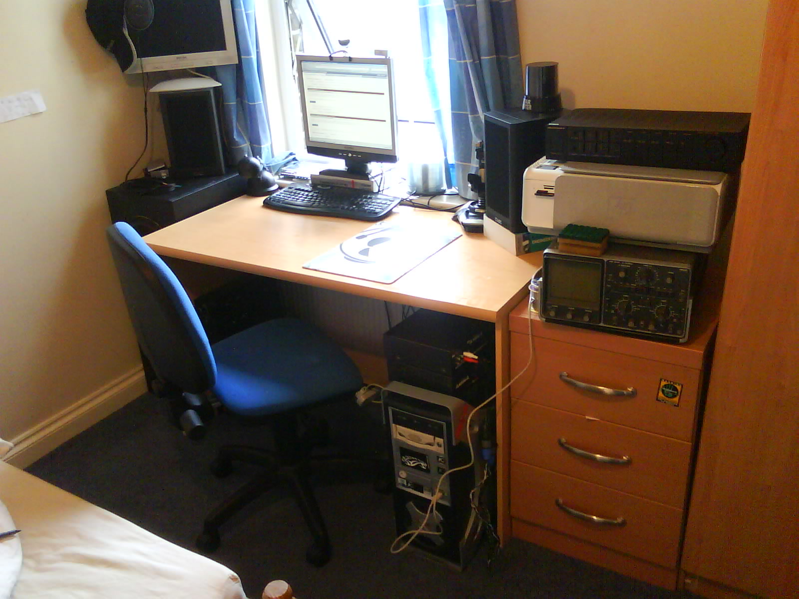

The EEE students setup: not enough space for big speakers so utalising their bass cabs as subs and some mission 760i as mid/high.
Crossover is done using foobar plugin atlhough I would idealy use an external spdif fed unit for crossover to simplify software. Amps are a marantz 40+40W cheap off ebay and a 50W Aiwa reciver systems power amp I gave improved grounding and bypassed the need for the rest of its stack.
Future plans are homemade digital crossover unit/dac and a "Real" subwoofer amp using the 0.3F of 100V capacitance I have in the cupboard. Overall a vey cheap setup with great bass exstension although the crossover in the 760i's is not great and results in a 3.5Khz notch filter which makes the midrange mushy.

I've found that the midrange of the 760i speakers isn't bad. I found that the treble suffers most, if they've seen years of use.
I think the crossover caps are to blame, but I'm not sure.
An idea to try with the Missions - reverse the phase of the tweeters. The notch at 3.5kHz would be down to phasing issues, so perhaps this would help.
