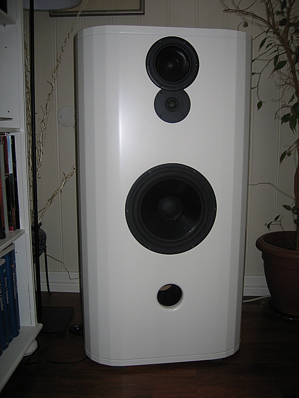

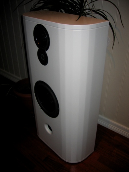

Well it comes in every shape and size!
Her are mine, and I havent seen any speakers thats look the same :)
Its a 3-way with Seas drivers; CA26RNX, MCA15RCY and 27TFFC.
They have gone through several stages with different drivers; L26, CA18RNX & 27TDFC, and with different crossovers; passive/DIY-active hybrid, all passive and lately all active with DCX2496.

I think that people were wondering if it was a ported cabinet design with the back removed, and with the latest picture, it appears as if you can block the port for a full OB, giving an option for both.
To be honest, I thought we were seeing the first ported OB in history, quite an accomplishment!:eek:
I like wide baffles myself, and with the large radius roundover at the sides it must sound very nice with a smooth transition from 2pi to 4pi.

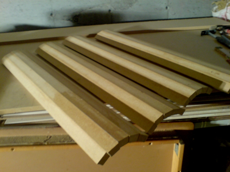

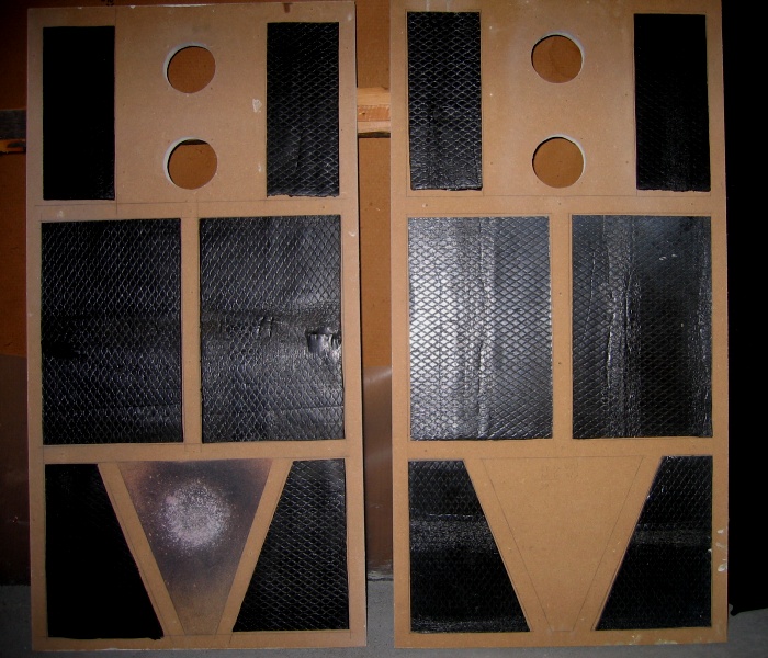

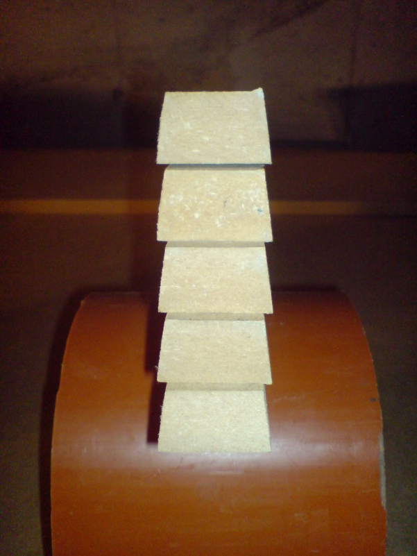

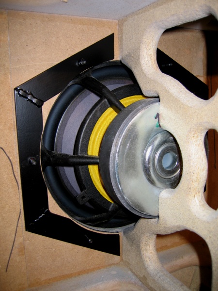

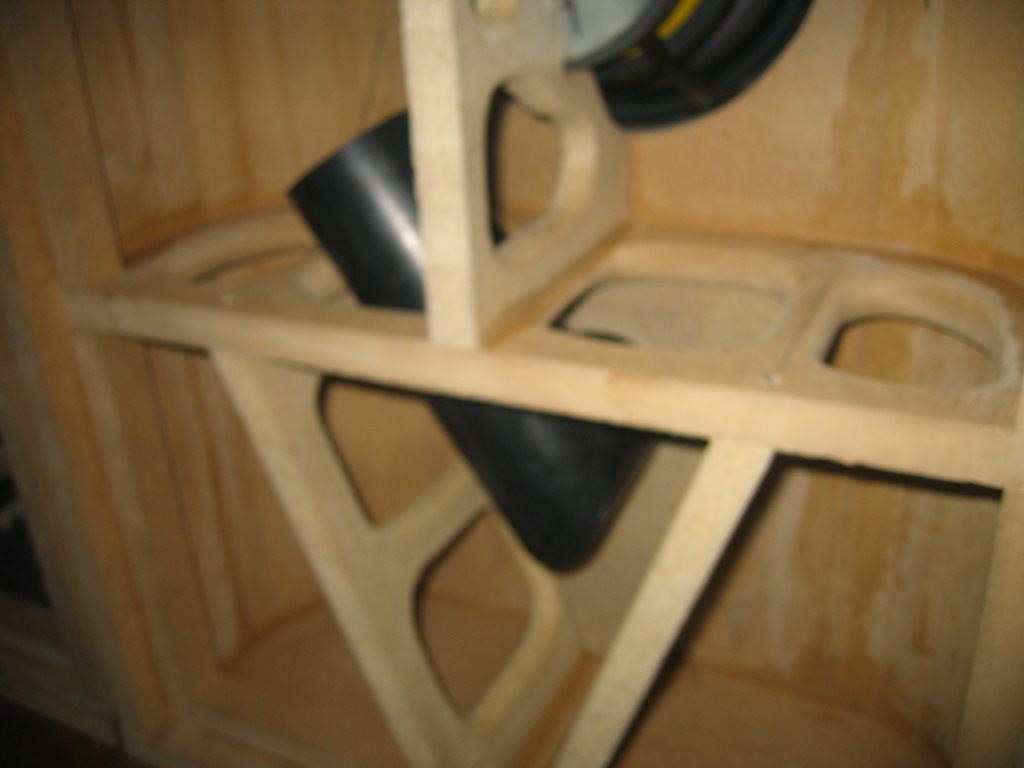

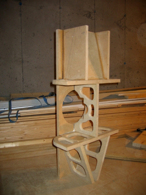

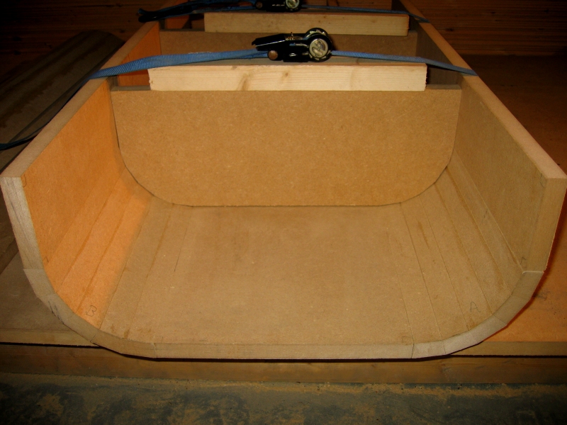

I'm sorry if my speakers make you confused! :)
They are just some regular BR, the picture without the backplate was just so you could see how they are constructed.
The hole idea was to make the baffle wide enough so that I didnt need BSC on the mid, and round enough to minimize diffraction.
Then I coukl use a simple passive filter for the mid/tweet, active xo for the woofer, and then of course biamping.
The active xo for the woofer "meets" the baffle step, and is BSC is easily adjusted with gain on the amps.
Here are som more pictures, of the inside construction, with a longer pipe for the L26 woofer, and the woofer support,

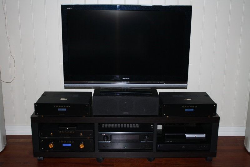

Well this thread says "system pictures and description" so I just want to show you the electronics, that maybe isnt something you are familiar with.
Like the Seas drivers, the dac, preamp and poweramps are Norwegian also, from the brand Abrahamsen. Mr Per Abrahamsen was the man behind "Elektrocompaniet" that I suppose is something some of you have heard of.
If you look at the picture below, you can see the HT stuff in the middle and lower right. On the left side and upper right si my "hifi-gear".
Its a Logitech Duet as my main music source, then Abrahamsen DAC (V6), Abrahamsen Preamp (V3), and two Abrahamsen Poweramps (v4). Actually I have three poweramps but only two of them are in use in this setup.
If you are cuorius, you can look for info here: V Series by Abrahamsen

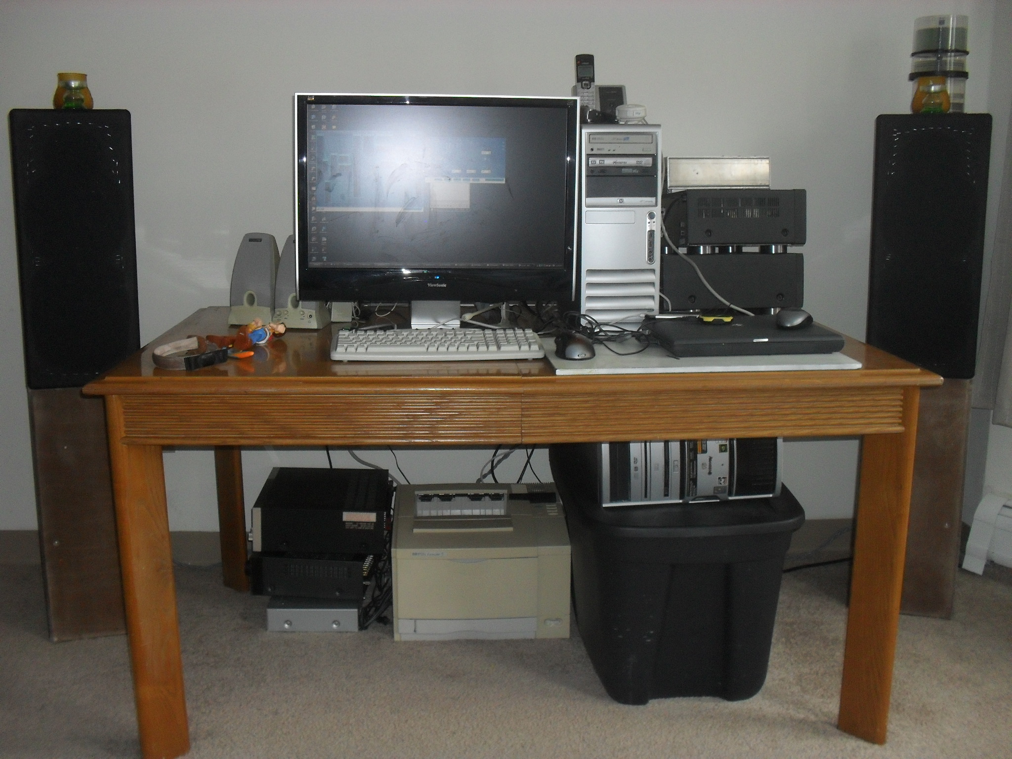

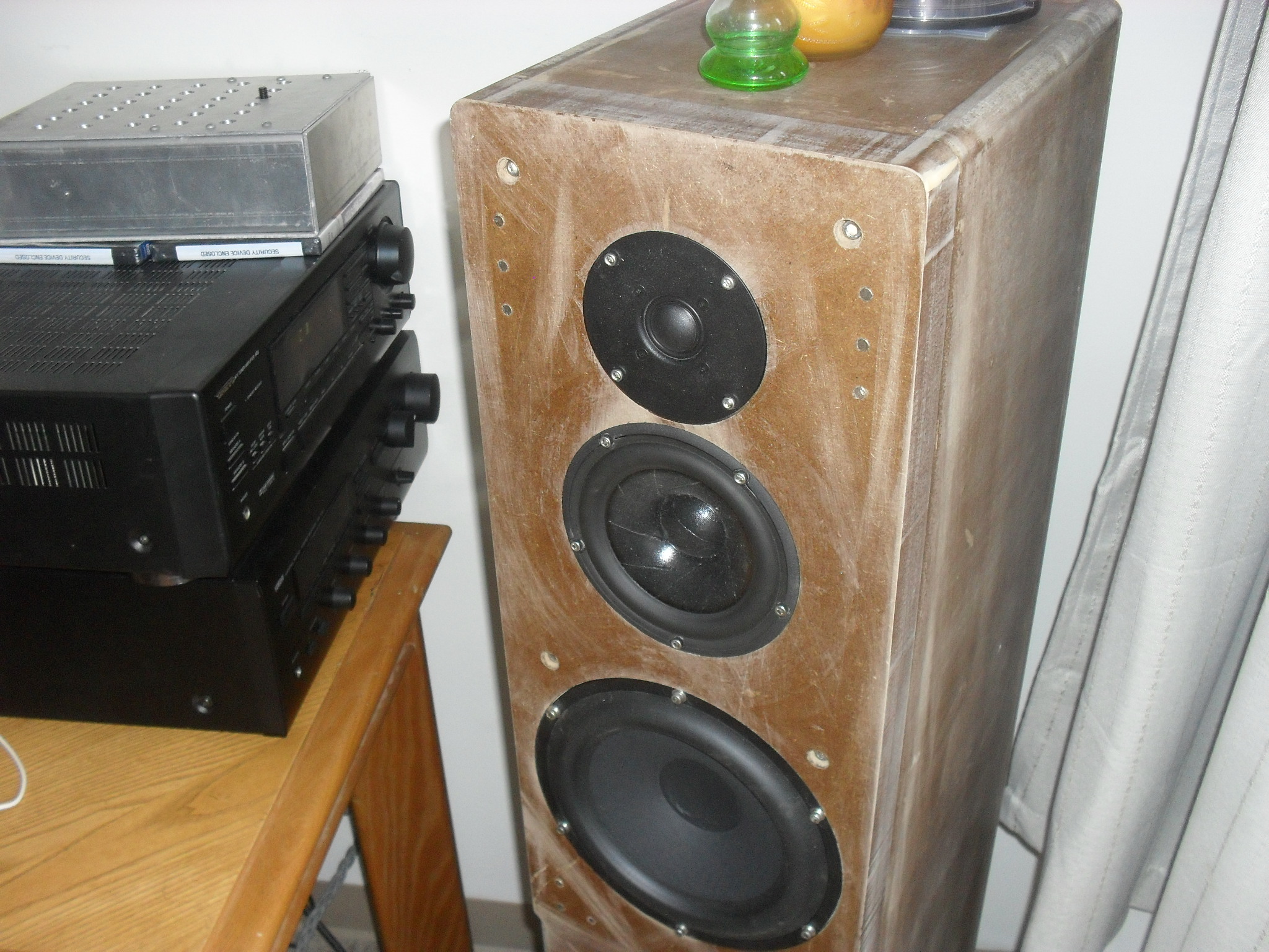

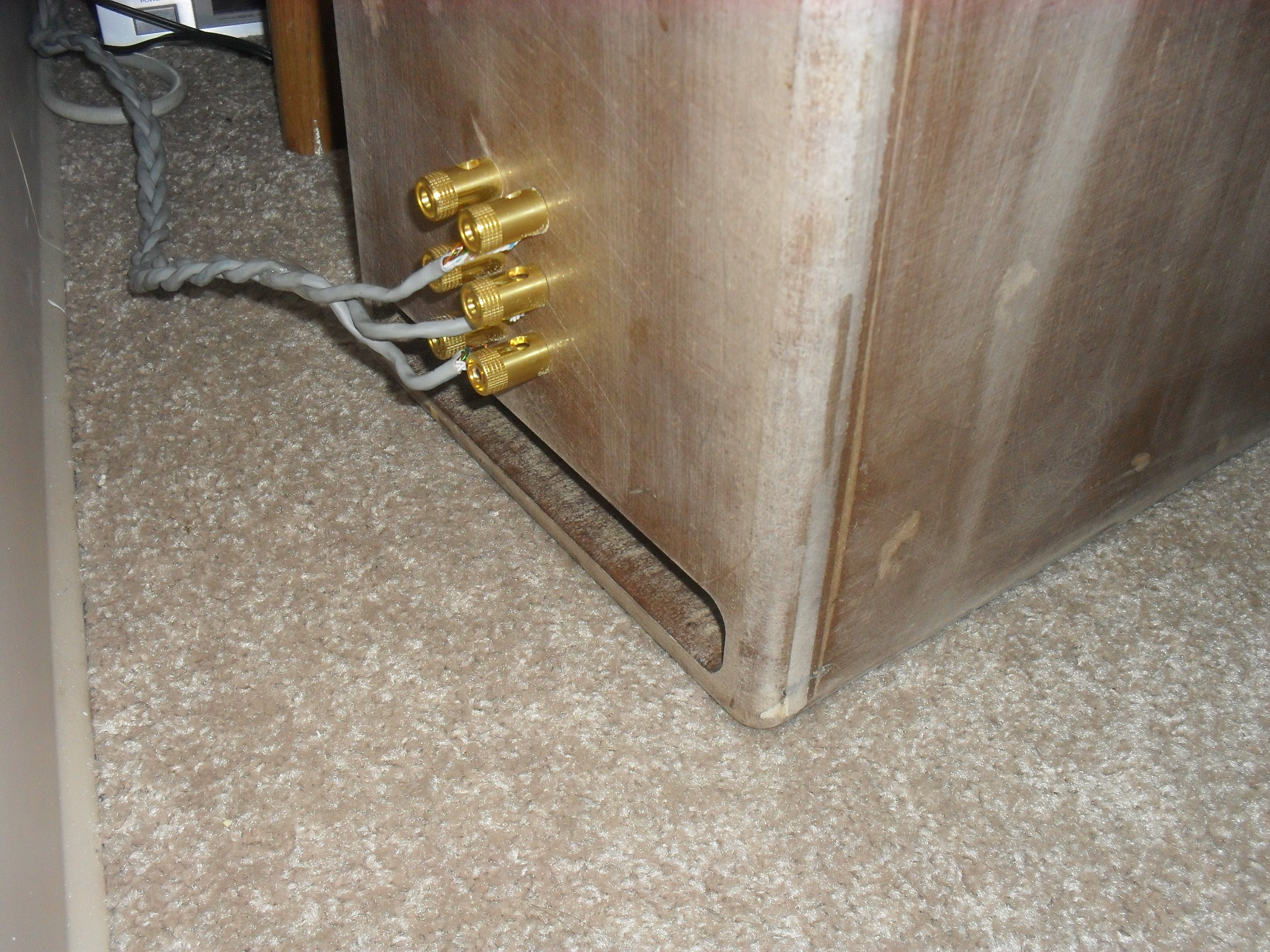

Speakers are active 3-way: seas 27TDFC, ScanSpeak 15S/8530K01, ScanSpeak 21W/8555-01, via kx project drivers.
Enclosure is Tasmanian blackwood bird's-eye figure veneered in beautiful MDF :clown: Grills need to be redone because they are two layers with the staples showing through one of them.

Staples---what staples? :D
Love what you're up to, they're going to look great!
What's up with the braided cable? This is new to me. Looks professional, sensational.
Tell me about those drivers. They look like they produce a smooth tone--probably get loud too...
I build some child proof grills: http://www.diyaudio.com/forums/multi-way/152358-child-proof-grills.html
But they are not done yet. I need to redo them. You can see staples that attach the screen door screen under the fabric.
I think they look great now lol :D I'm not much for paint or veneer :) But I think I will paint them.
I go for cheapness. But I don't want value-engineered drivers. So all my drivers were bought second hand, so I could build something relatively cheap. The cable is an essentially cheap or free DIY cable: DIY audio cables
They are too loud for my apartment. They sound good. Does any one notice a difference between flac and mp3's (even 320)? Vifa XT25 might have been a better choice, but I couldn't find them for $50 a pair shipped like the Seas. Also a 15W with a big magnet or 15M might have been a better choice for a 3-way, but I got the 15S's for $160 shipped for both. And the 21W's were $180 a pair bought locally.
I could have gotten some Seas Excel W15CY-001 instead of the ScanSpeak 15S/8530-K01's, but I feared the harmonic distortion between 1-3 KHz. Just didn't make sense to use a driver like that for midrange to me. Also the ScanSpeak looks much better to me, even though I rarely look at them.
Nice. Does the slot in ther rear mean the woofer is bass-reflex? Or is it the termination of a tapered TL?
