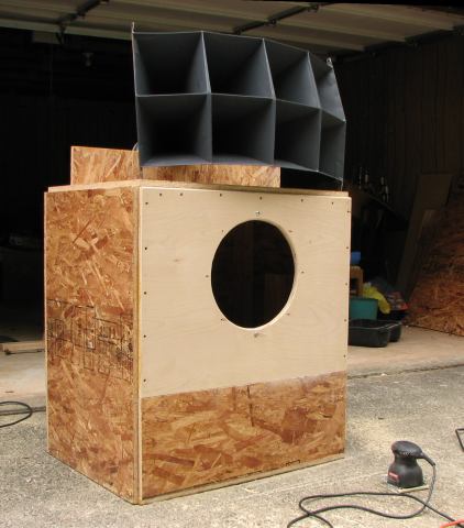

Lonely Oris 150
Seems I'm alone here in playing with Oris horn. Read a lot of 'new things' on the web, especially here, I've learned more and more about horns, OB, speaker designs... etc. That big, hard-to-integrate, once being expensive Oris horn became my burden. Now I know there're so many faults in it and there're so many good stuff out there, but, reluctant to let go, I just keep using it. Fortunately, I still enjoy listening to it.

Days ago, I added a small in action but big in effect mod to it. Now the whole thing look like this:
It's the best sounding speaker I've built up to now. I'm very happy with it 🙂

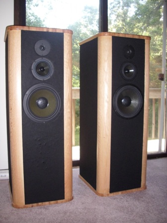

I guess I'll throw my babies in...

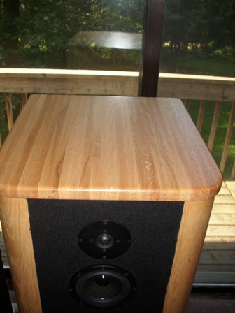

These are basic 3 ways using all Eton drivers; 11-581, 5-880, 25SD1.
The boxes are 2 inch high density MDF with white oak corners. The corners are radiused to 3 inches. The tops and bottoms are 1 inch oak done like a butcher block. The fronts and sides are covered in felt. Port in the rear.
These will be tri-amp'd using SKA amps. The crossovers are switchable 2nd to 3rd order and each set point is switchable to 10 different freqs, my own design; Nothing fancy, fet source followers.
They are far from finished yet and I'm months behind. The drivers are not countersunk yet I wanted to get music and test tones through them to get a better idea what to do.
Mike

Is that box sealed? I don't see any port.
Nice look! Can you post a photo of the sides, please?

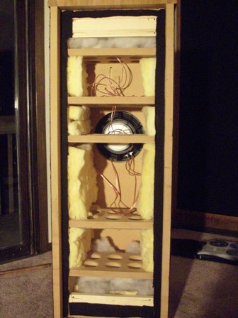

Ports are on the sides at the back. And an internal baffle that doesn't show here. It's a Mass Loaded Transmission Line (MLTL) design by forum member GM.CLS said:Is that box sealed? I don't see any port.
The corners are oak with the MDF attached to the sides and front. The MDF is glued and pocket screwed. The panels are 2 1" thick pieces glued together.
The corners were made on a table saw by angling the blade 15 degrees and cutting, angle 15 more degrees and cut. Then sand with an orbital to finish the radius.
The M and T drivers also each have their own internal box.
The boxes are 50" tall x 16" wide x 18" deep. The boxes are made to handle 2 woofers (when I can purchase 2 more) and at the moment some of the volume is blocked off. The internal picture doesn't show this.
Port in the rear.
The WAF is no longer an issue as of a couple years ago... So build 'em BIG!
