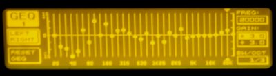

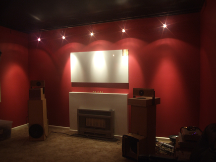

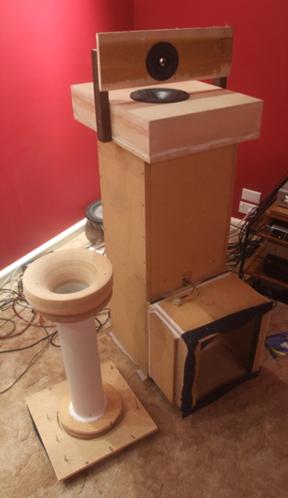

Here is my current HT/Music system. Speakers are omni with vifa drivers (P17 + D25) passive crossover 2nd order @ 3.5k. Subs are 12" Rythmik sealed servo crossed at 80 Hz 4th order.
I use ultracurve for eq full range. This is a snapshot of typical settings to get it flat (see first snapshot)

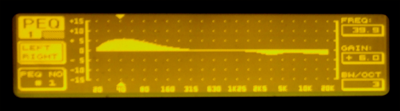

then my "house curve" added to that: (second snapshot)

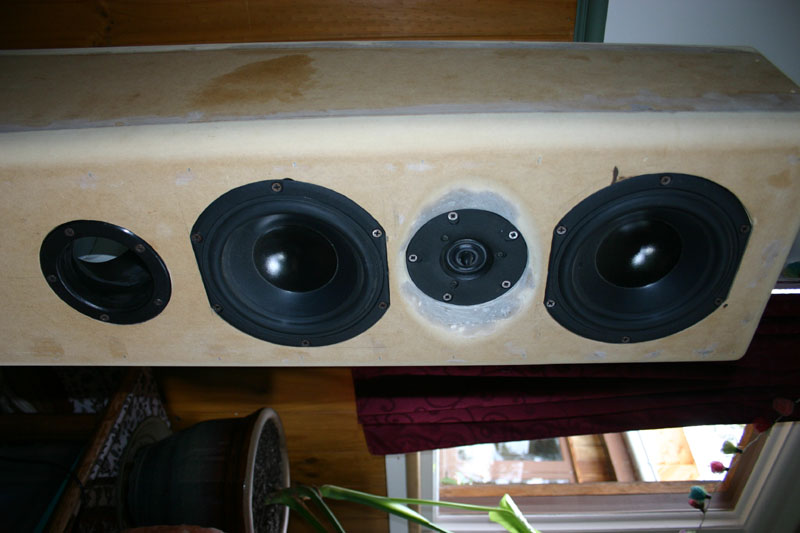

The current omnis are in prototype form, and I'll replace them with serious boxes later.
You can also see my current bandpass experiment with the vent removed.
About the omnis. Most of the vocal range is omni - below 1k. Above 1k they are omni in the horizontal plane only, so between 1k and xo @ 3.5k there is more sound directed at the ceiling. Above the crossover point it's probably not really omni due to the baffle. Subjectively I find as moving around the room, the midrange retains a very consistent character. I get the big sweet spot and sound stage of open baffles.
These speakers are an experiment, but I've decied to leave them in my system for a while. Normally I have OB prototypes.

Nice!
I tried to post some comments on your site and they didn't quite make it.. 😱
Basic thoughts on design alterations are:
1. Use an eff. midrange in a moderate volume with a low tuning freq.. and no stuffing or wall lining. That should give you the clarity you are looking for. The B&C 6MD38 should work out well with it's rising response on axis up to 1.7 kHz, its overall smaller diameter (for an eff. midrange), and its eff. which will be "cut" on the listening axis by about -7 to -8 db (85 deg.s off-axis).
2. Consider the BG Neo 3PDR as a DIPOLE for the tweeter. (GR Resarch still has these with an open back). Use stuffing/padding on the tweeter baffle to absorb baffle effects.
3. Use a good eff. mid-bass driver (regardless of open baffle or enclosure). It still makes a substantial difference.
Anyway, nice write-up! 😉
Thanks Scott! I didn't know there was a problem with adding comments to my blog. Was there an error message?
The system as shown is experimental and temporary. I've looked at some efficient drivers along similar lines as an upgrade, although at this stage I'm looking at a Geddes Abbey approach, mains then becoming surrounds. AE drivers also have my attention.
I don't remember exactly what happened, though I do remember that drop down list and it quickly "barfing" after that with no way to retrieve the post by hitting the "back" button. (..I know, should have copied it to clip board before trying to post.)
If you are primarily interested in L&R HT loudspeakers then I think that Earl's approach is excellent. If you are more interested in music, then I'd suggest continuing "down" the radial "path". 😉

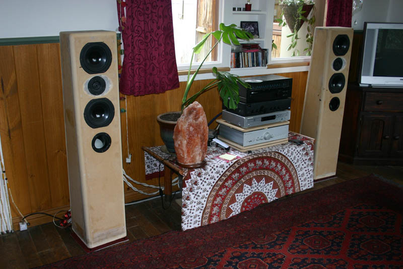

My first DIY system
Hey all.
These are my first DIY speakers, using 2 x XT25TG30-04 & 4 x 850439 MTM
The boxed are built using 30mm MDF with 22mm internal bracing and around 30L approx. The speakers just need a few coats of something/sanding and there finished.
My gear is...
CD = Marantz CD6002
AMP = Cambridge Audio Azure 640A
TUNER = Sansui T60
INTERCONNECT = Chord Cobra 3
PWR LEADS = Home made
Platforms = 18mm MDF with Ball Bearing spacers
Current XO is 12db LR @ 2500hz but i am currently designing a new one.
The sound so far is OK but I am looking forward to much better results with a new XO that has baffle step comp and impedance smoothing 🙂
Cheers Dean

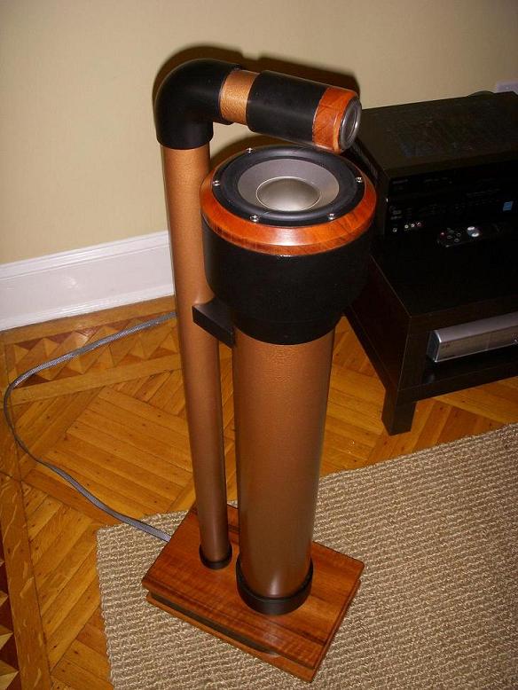

Kierownik -
Your Pluto's are amongst the nicest I've seen. Excellent work.
Thanks a lot Bluto
