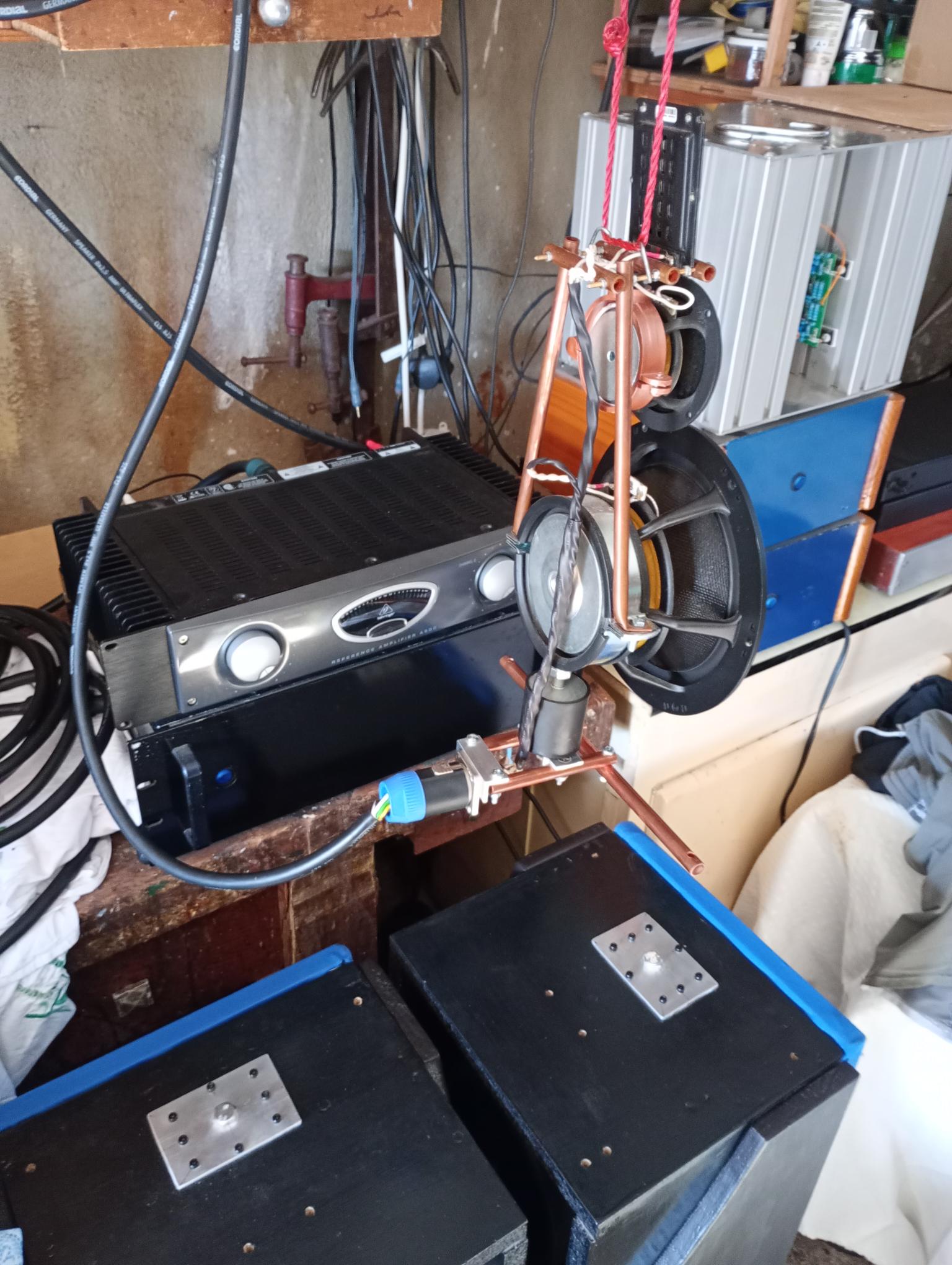

I did tidy up the wiring of the 3 top LX521.4 drivers, which I now suspend from the ceiling above the H-Frame boxes for improved isolation. ps the A500 amplifier is just for its heatsink case, actually inside are 4xLM4780 2 channel chip amps which each parellel drive its own 4ohm bass unit. Enclosure below them is their 1000VA 24-0-24V trafo.

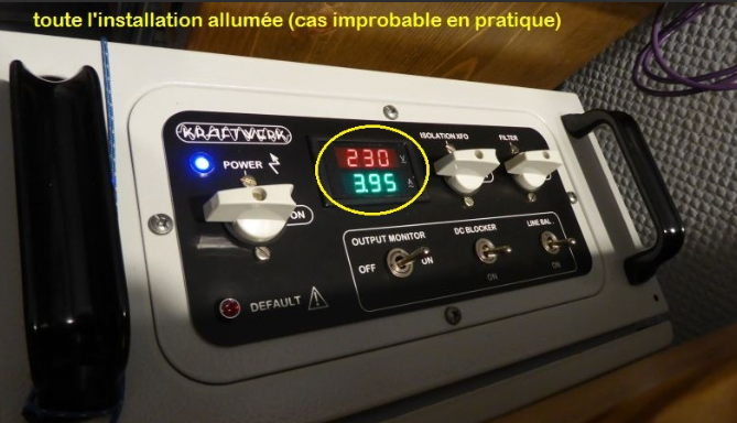

Well, I'd say that it stays reasonable : below, ALL instruments powered ON, including lamps - the conditioner reads 230VAC / 3.95A, that is to say circa 910W. That case is rather improbable in practice, because the items are barely all powered at the same time... 😉

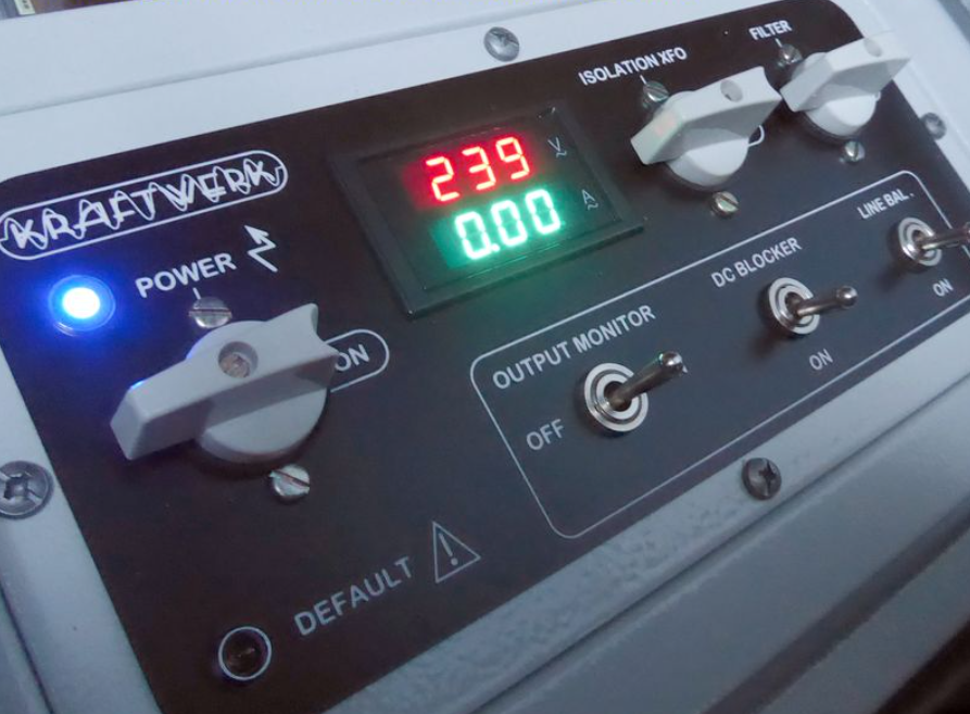

And when ALL is powered OFF, you read 0.00A, meaning that there's not more than 2-3W of standbying units that can remain.

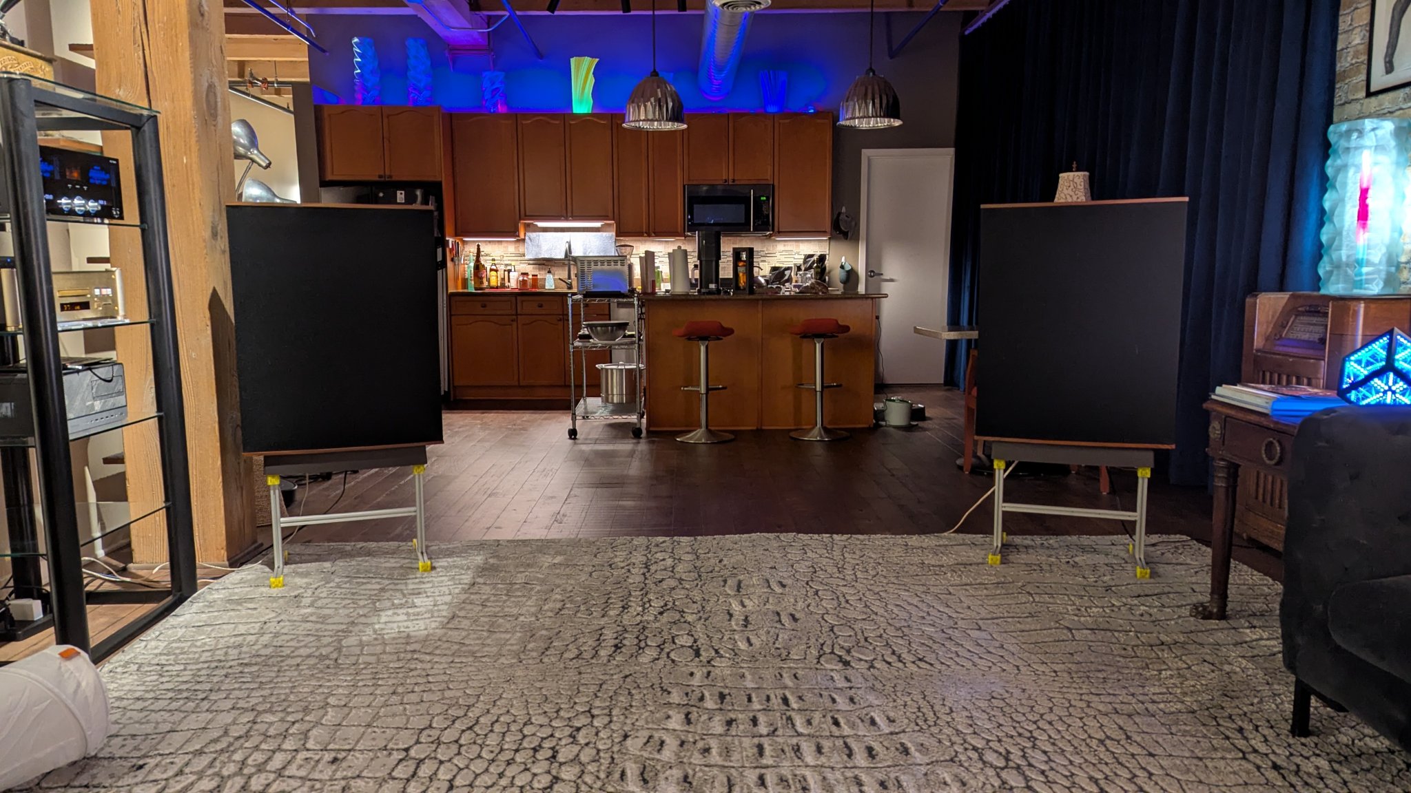

I have an Advance Paris A12 integrated amp, TEAC VRDS-20 CDP, Wiim Pro Plus streamer, B&W 703 S3 speakers, recently rebuilt Quad ESL-63 speakers, and an SVS 3000 Micro sub. My LG 77" C2 OLED TV is driven by an Nvidia Shield TV Pro, is also hooked into the system, and I use a Sofa Baton to control things. Finally, there's a PC connected to the audio system and the TV to generate visuals that sync with the music playing on the system.
The listening chair for the Quads- I'd rather have the Quads at this end of the room so I can see the view while I'm listening to them. The room is 16' wide, and it's 28' to the island in the kitchen. The ceiling is 11 ft high with big HVAC duct, big wood rafters, huge wood beams and posts, and plenty of sprinkler pipes, track lights, and electrical conduit. It's a real mess up there!
I just got the rack in the photo, and there's a new chair coming next week, so I'm still figuring out where to put everything. I'll hide the cables better once things are finalized. The rack is definitely oversized for my small collection of gear. I may look for or build something smaller. My favorite analog playback device, on top of the rack, is an Edison Model B cylinder record player.
The computer runs MilkDrop 3.26 to generate visuals synced to music
I just finished rebuilding the Quads a few weeks ago, and made the stands for them. They sound fantastic!

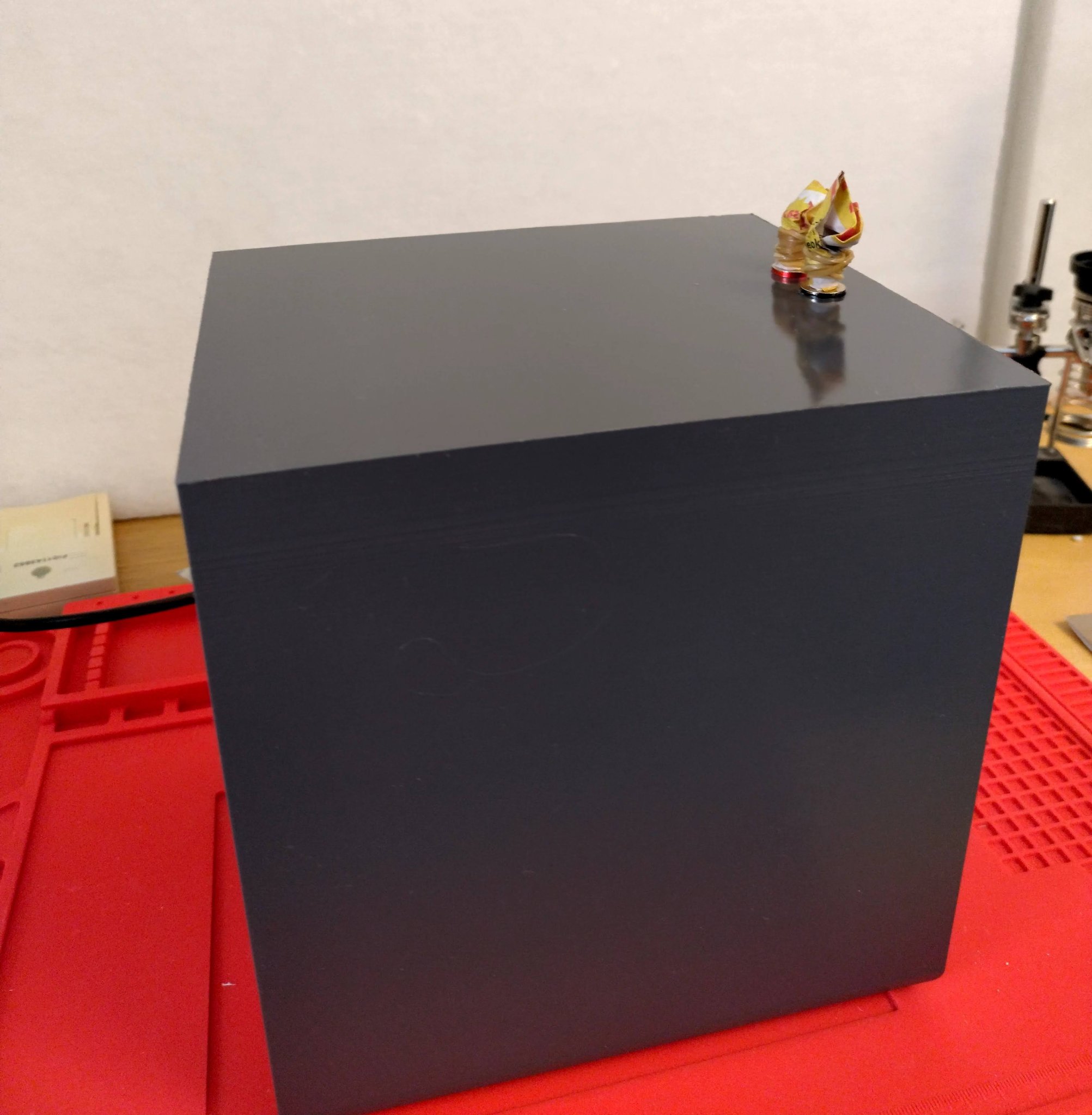

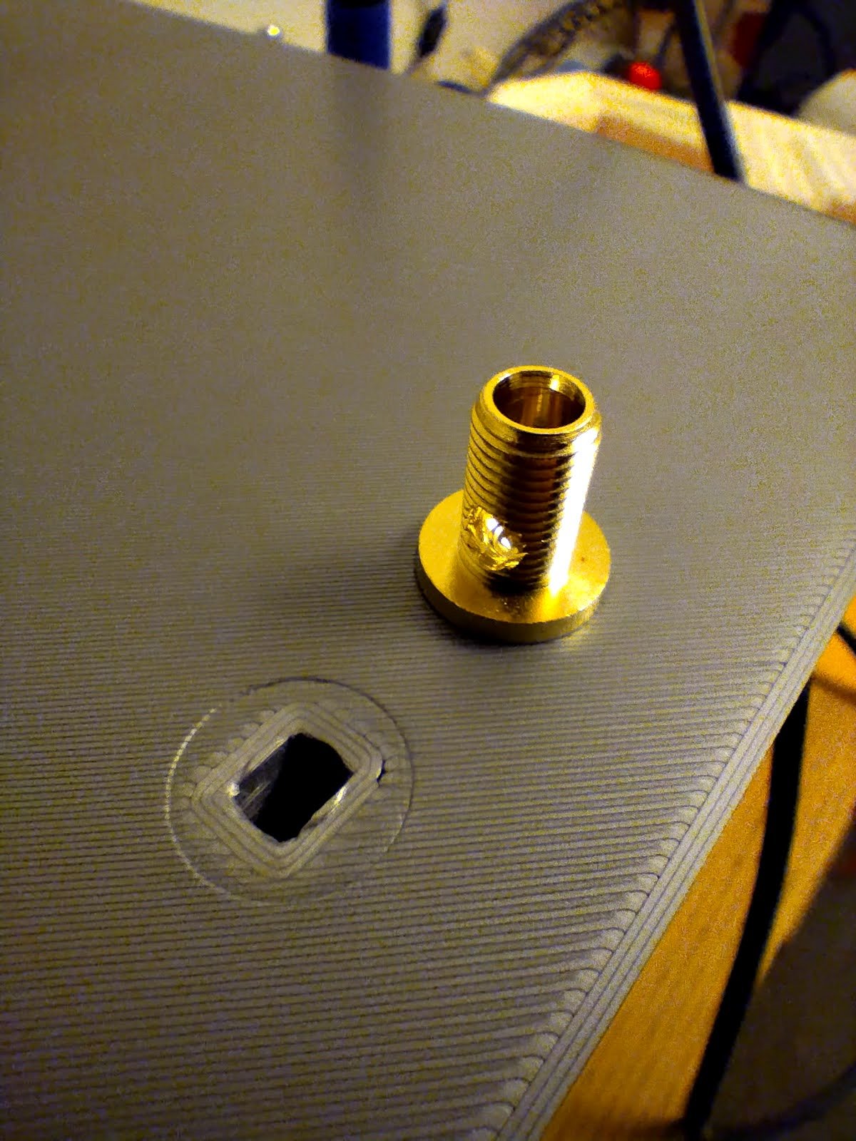

I built small full range speakers into 3D printed case. TB W4-1320SIF.
Painted and lacquered:

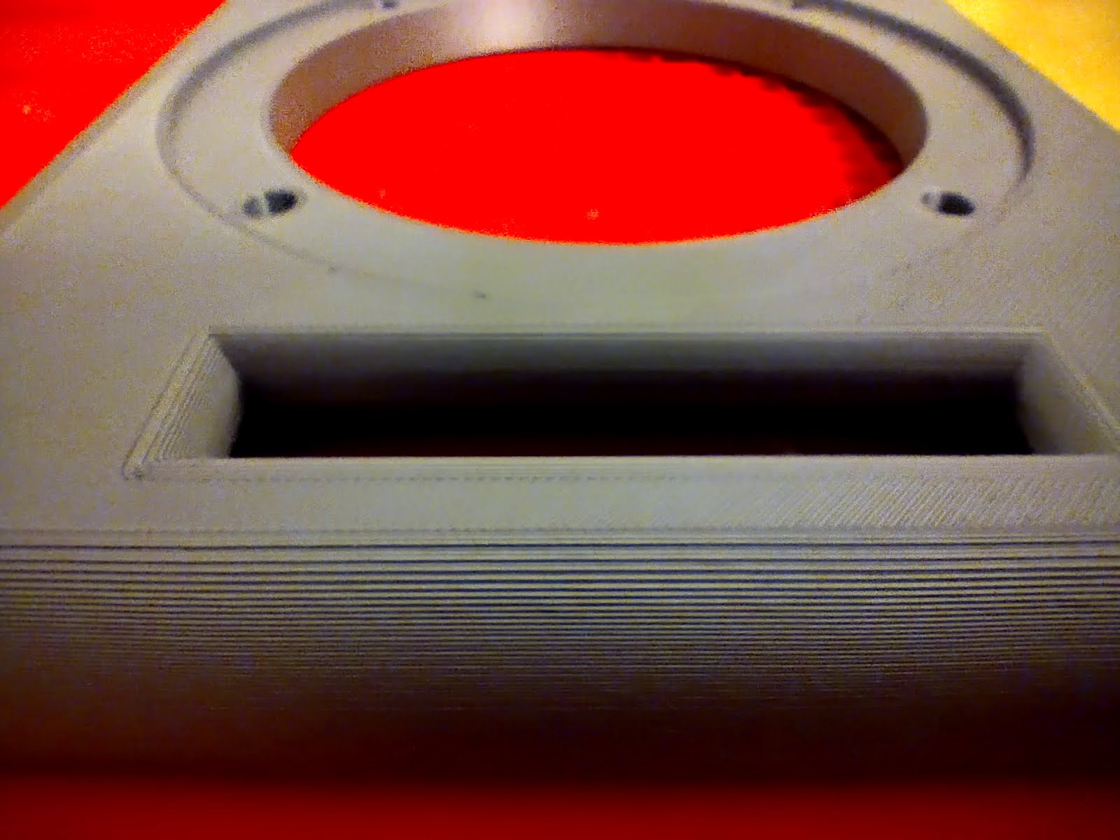

Print layers are left untouched on purpose:
Diffusor in the cabinet:
Working with prints is a lot more difficult than wood. Each detail must be in the model. And plastic is soft and doesn't take heat or solvent based paint very well.

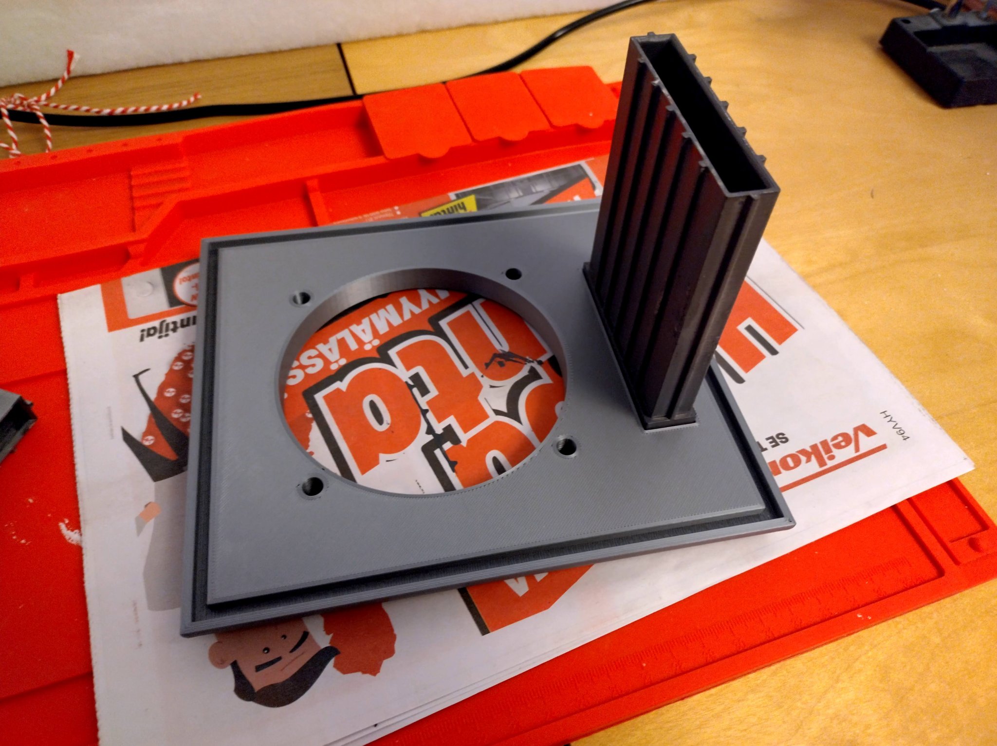

Printed in three pieces: faceplate, reflex slot and hull. Glued together.
The material is PLA and printed 10 mm think with 1 mm wall thickness and 10% infill. This is my first and probably last printed speaker.
-- Oops I forgot these are full range and this is multi-way forum, sorry.
Correct, just printed with regular infill pattern. This was intentional decision because these were my first printjob and using filling material would have been a lot more work, so this time just that. If I seriously tried to make printed cabinets that compete with MDF, it would take serious effort also in model design.

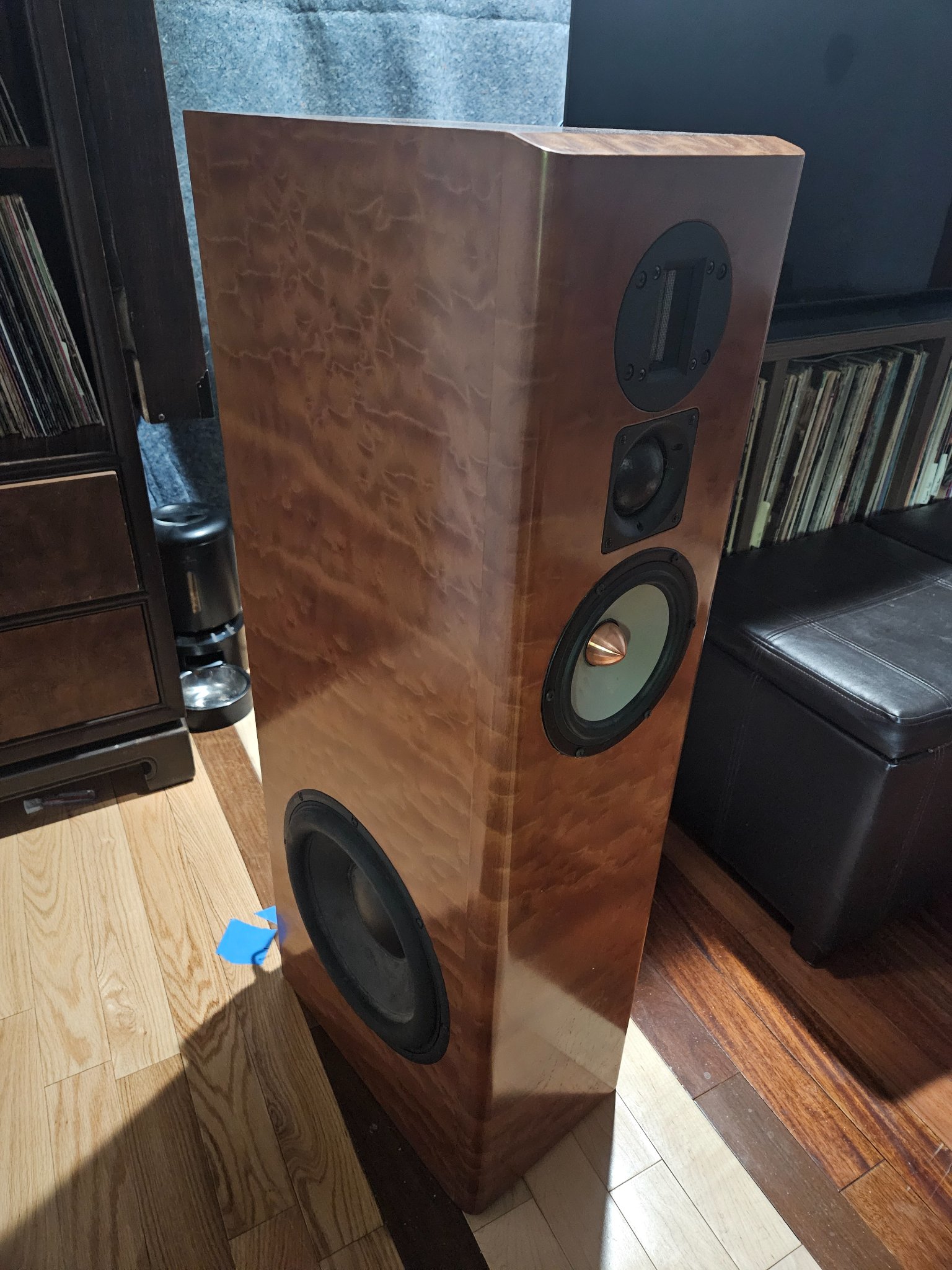

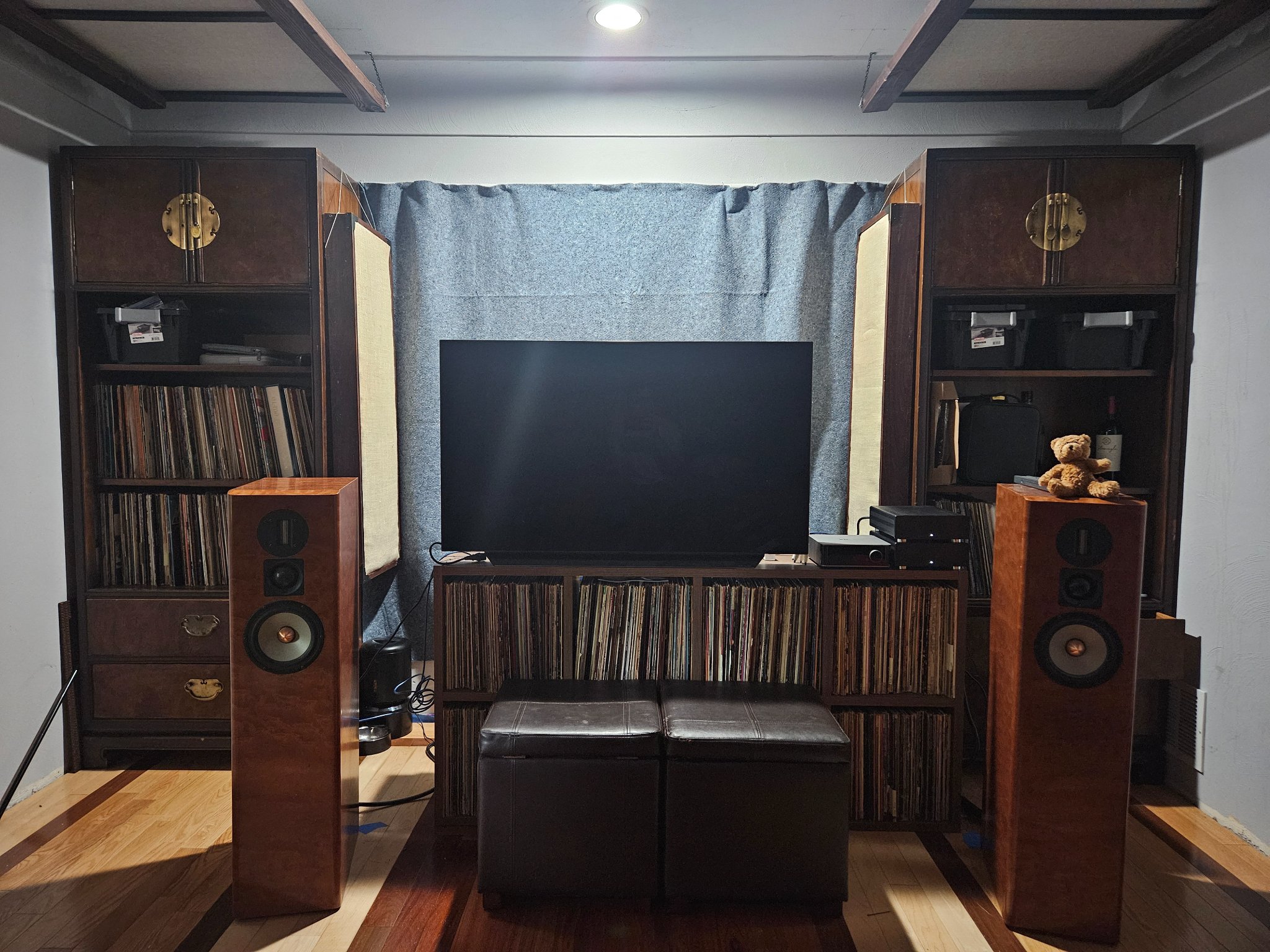

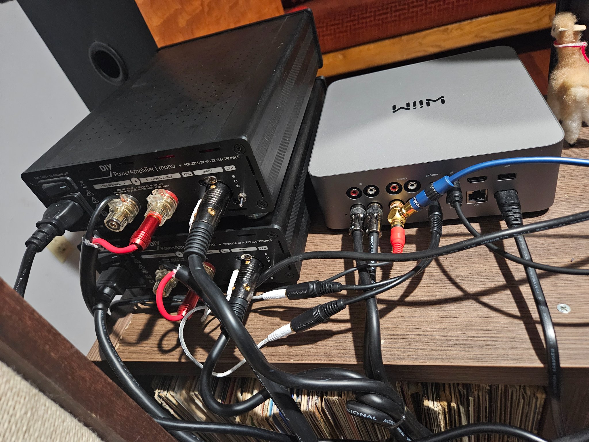

Wiim Ultra > Hypex Nilai monoblocks > Selah Tanzanite (Rick Craig)
TV is a 49" LG OLED. Looks awesome, though it's neglected most of the time. Previous owner used it as a monitor so it has a little bit of bleed on the bottom, but it's not offensive. Once I get a PC connected to it, I'm sure it will begin to see more use
TV is pulled from back wall so I can see it better, and having a little nook behind makes cable management a breeze. I don't imagine the speakers appreciate the close boundary, but oh well
The Tanzanites were designed as a bookshelf speaker, but these are towers with powered 12" peerless subs on the bottom half
The Wiim feels like a weak link, but it sounds good to me and I make use of most of its features making it indispensable. It has parametric EQ, subwoofer integration tools, streaming and plenty of inputs. Being able to control it all from my phone rocks. I like the 12v trigger too. There is a standby feature to turn off my nilais after a period of disuse. The Wiim measures well so I'm not too bothered. If they come out with a version with XLR outputs I'll probably get one. Also wish the subwoofer out could be stereo
Sounding quite good lately. I need to add some room treatment to my sidewalls, and I'll probably be changing speakers pretty soon too.
The arrangement of furniture in my room kinda demands that the speakers not be centered in the room, which I'm sure doesn't help things. Sounds great though nonetheless. Room reflections make the top end a little brash and hazy, though EQ helped. I'm thinking some sidewall treatment will help a lot
