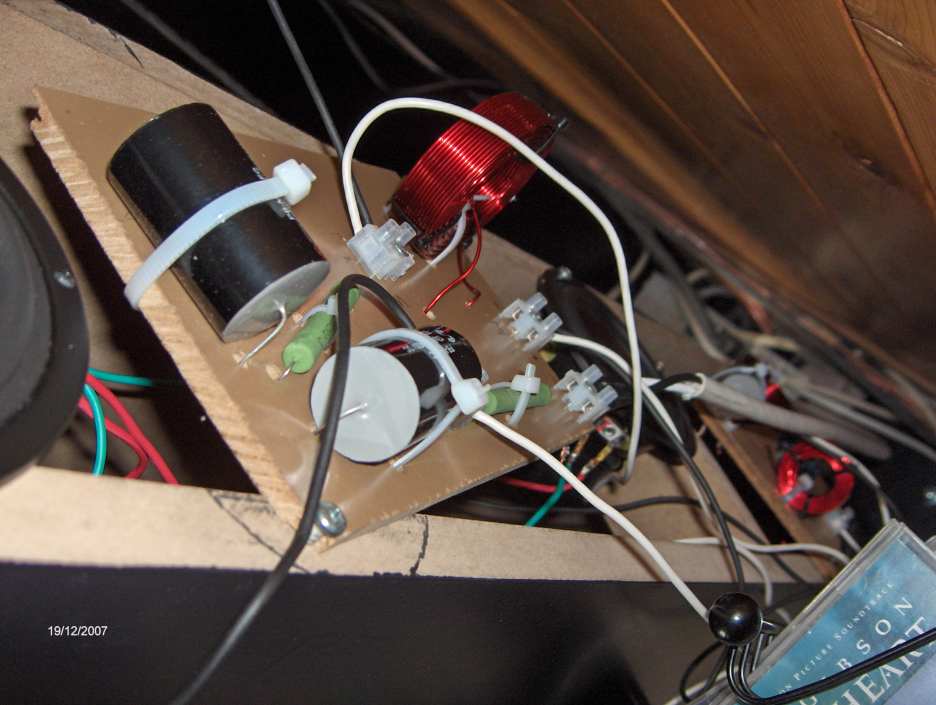

I am from Romania.
I used for finish the enclosures a kind of moquette. There are bass reflex type.The woofer is a russian AMFITON 75w/4ohm,the tweeter is an AVD-505, super dome tweeter pure titanium diaphragm 200w/8ohm and the mid is from Poland, 60w/ohm.

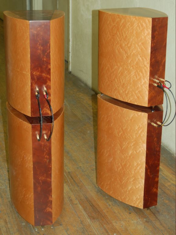

DciBel-very interesting finish, i like this one!
Thanks. I was using these speakers for a long time with bare MDF and was getting tired of it so I had to do something. They didn't turn out exactly as planned, but it still looks rather nice, and matches the colours of the room quite well.
Details of the project is here.

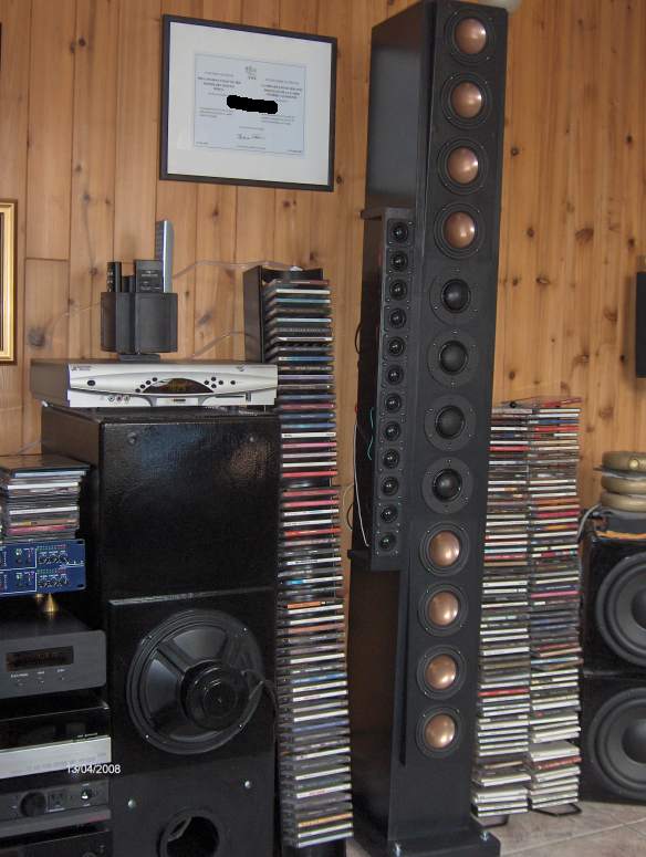

Mains using hi-Vi drivers
This is my latest, main speakers, open baffle usipng 12 4 inch bass drivers (4 out of phase in the back) crossed at 1200 hz, 4 3 inch mids crossed at 1300hz and no x-over for the highs (to about 9000hz) and 12 tweeters crossed at 6000hz.
the sound is out of this world. High efficency 96db/watt.
Mid is clear and soudstage is really wide.
One drawback is a narrow sweet spot.
For now finishing paint is not up to standards, this is my next step.
I"m driving these with a YBA 2 HC amp (70 wpc) and the dynamics are stunning.
The subs are also DIY, these are driven by a Crown K-1 amp.
