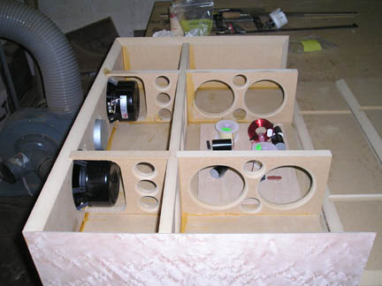

I made new enclosures for my speakers (Supravox 215SB). They're 125L and leaky.

This is an aproximation of a large open baffle close to a room corner. It works better than sealed and I don't like the sound of resonating waves (i.e. bass reflex), so this is a good way of creating extra body through the pressure chamber, but it allows the speaker to 'breathe' without focussing the pressure too much (i.e. standing waves).
Also, I use a digital equalizer always so that works out well with this (just as it did with a huge open baffle).

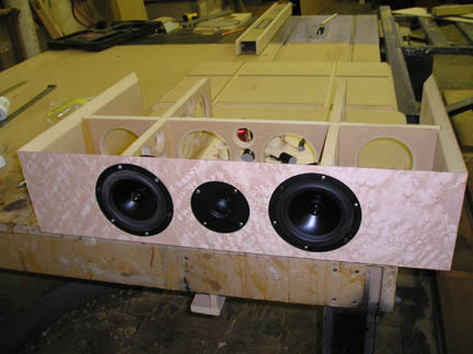

All outer joints are 45 miters. Panels are veneered in the vacuum press prior to the assembly. All internal joints between braces and the cabinet are dado joints. Braces are also interlocked with a dado joint. This makes an extremely stiff box. Having a good table saw (Powermatic 66) makes this work relatively easy, however this speaker took over 2o hours of work including finishing.
R-Carpenter said:All outer joints are 45 miters. Panels are veneered in the vacuum press prior to the assembly. All internal joints between braces and the cabinet are dado joints. Braces are also interlocked with a dado joint. This makes an extremely stiff box. Having a good table saw (Powermatic 66) makes this work relatively easy, however this speaker took over 2o hours of work including finishing.
I noticed the dado joints, but failed to mention them. What brand Dado are you using? I also have a Powermatic 66...great saw

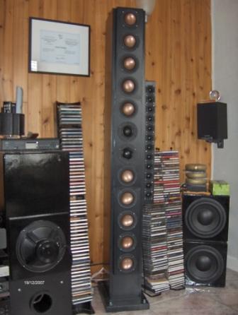

Home made ESLs

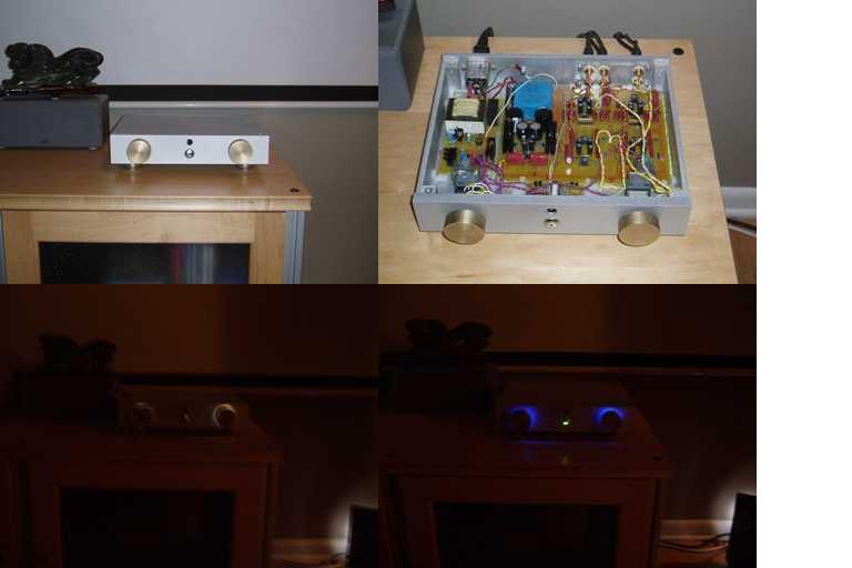

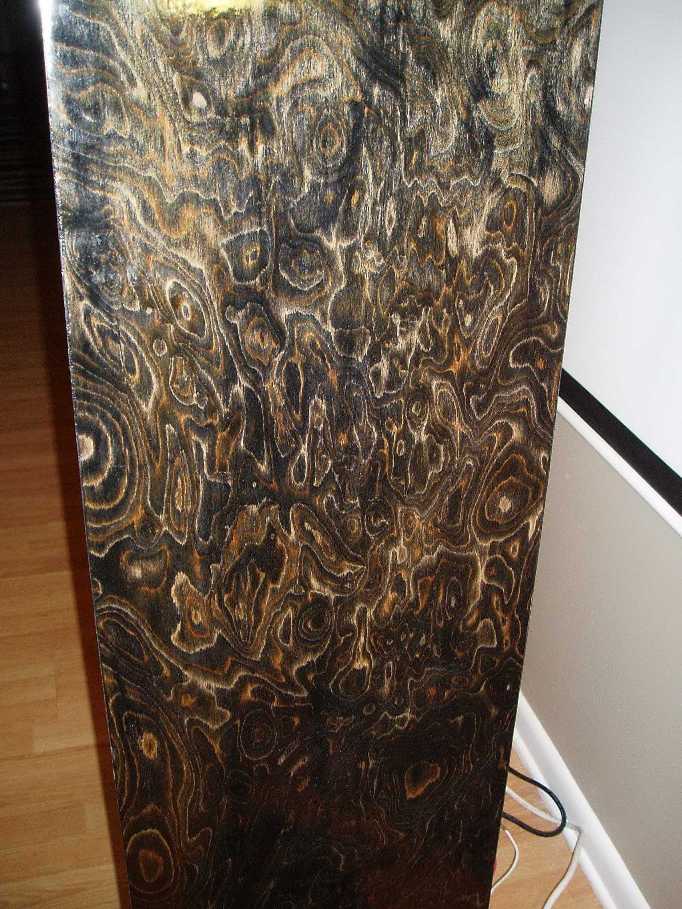

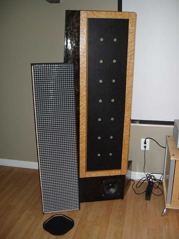

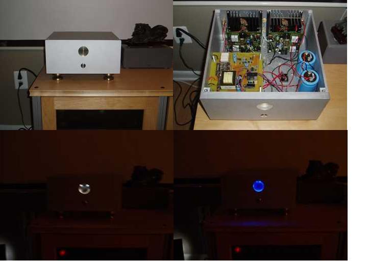

So I finally am satisfied (at least for now) with the system and I decided I'd share since it was only possible with the help of this forum... Comments are welcome. Its a slight modification of the Roger Sanders design...
(sorry, its going to have to be a series of attachments because I can't figure out how else to do it)
and finally, one of the speakers without the frou frou grill cloths...
The subs are audax carbon fiber 8 inch woofers in TL enclosures.
Rounding out the rest of the system is a rebuilt hafler DH200 (powering the panels), the fancy looking leach is actually powering the woofers. And a Denon DVD-2200.
wrl said:Rounding out the rest of the system is a rebuilt hafler DH200 (powering the panels), the fancy looking leach is actually powering the woofers. And a Denon DVD-2200.
More details on this ESL would be fantastic. Your room looks quite large, are 2 8" woofers adequate?
