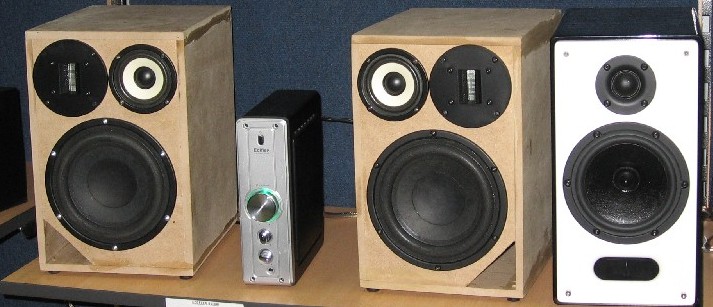

hi! some people prefer small system. someones - looking for loudspeaker for near-field region.
i made one already. 3 way, active phase linear crossover, LM 4766 and LM4780. triangular port - just my idea 🙂. woofer and mid - from Edifer, ribbon - from Fountek. now i've to find another woofer. i need it Qts and Fs less. but it's prety good for now.

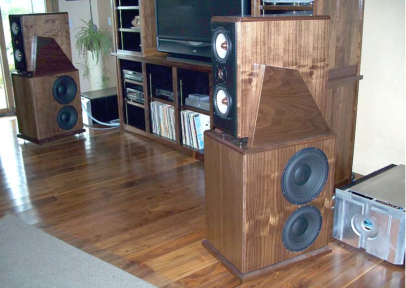

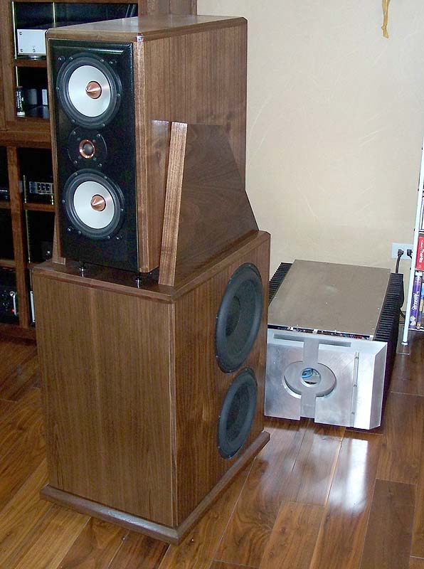

First attempt at building loudspeakers
I just completed my first and probably last attempt at building a pair of loudspeakers. The results are simply remarkable from a stand point of sound quality. I had been listening to for several years a beautiful pair of Legacy Focus, but just got the ictch to build a set. I was lucky and found Phil Bamberg at bamberglab.com and with his help built this beautiful set of Sereis 5 MTM and the matching Dual XLS Subwoofers. I'm not a reviewer so I won't attempt that here, all I can say is that they blow away every speaker I had in my system, Their that good! I'm driving them with a pair of Pass Lab Aleph 1.2 clones that I built about two years ago. Well I can't attach the picture it say it's to big?

nice work !!!
are there sub on each side of the box?and which is a passif one (if there is one) the small or the big one? peerless subs?
can you tell me what xover you used for the subs?
nice finish what wood is this?
Hi Newfinish,
Thank you.
Yes there are drives on each side. There is a 10'' XLS Peerless subs on the bottom of each side and a 12" Peerless passives on the top on each side. Phil Bamberg weights them to give them the correct response.
For the crossover I'm using a Behringer DCX2496 which Phil also programs before he sent it to me.
The wood is Walnut. Actually some of it is out of three Walnut trees that I cut down and milled into what you see here.
Phil sells the plans and all the components right down to the nuts and bolts.
