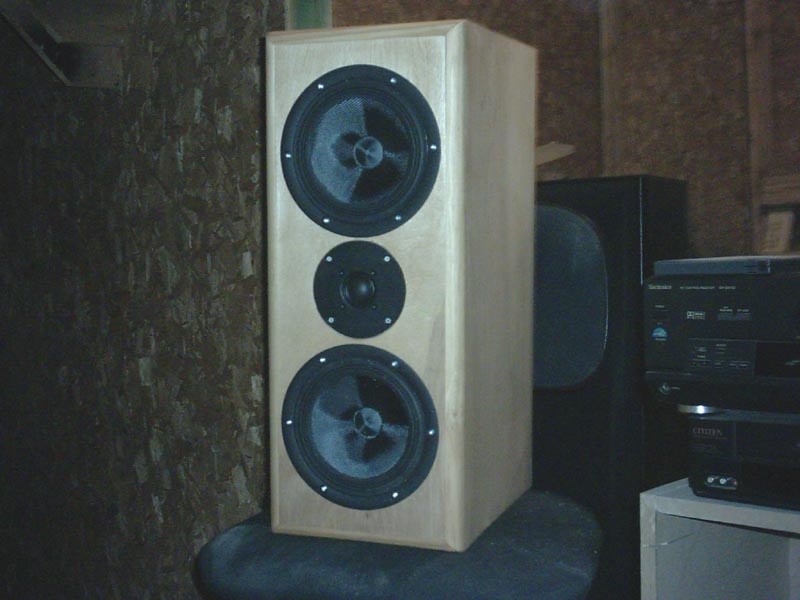

okay, here they are, not as fancy as your stuff, but still, made by me.
the right speaker

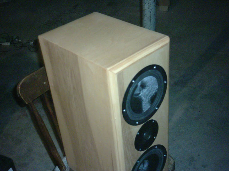

the left speaker
my chair

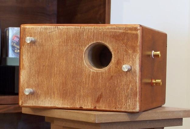

back of one speaker

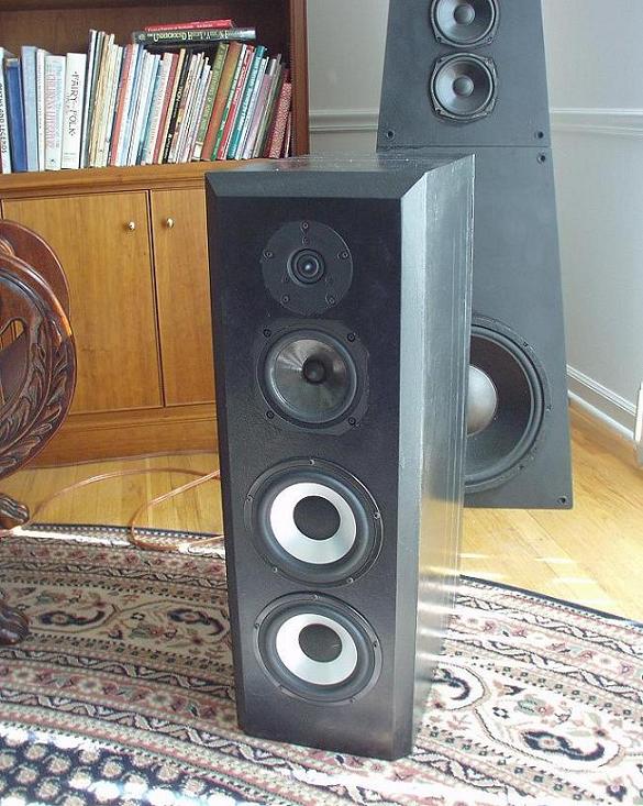

This is my first DIY home audio project.
The design is by John Krutke, the drivers are Vifa XG18's and Seas 27TDFC. The boxes I can proudly say were built by me and turned out better than I could have hoped considering the only experience I have is with making plane-Jane MDF sub enclosures.
I am quite happy with the results and I must add the Seas 27TDFC is really much better than I expected for the price.

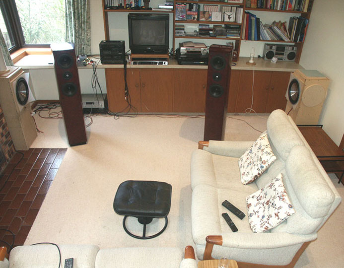

Last time I posted renderings which included things I've built and things I have planned. This is an actual photo this time.
The most finished part is my mains - curved TL speakers with Vifa P17 midbass drivers and D25AG tweeter finished with real wood veneer and rosewood stained. Subs on the side in prototype boxes (AE speakers AV12) powered by a beefy PA amp (Behringer EP2500).
Ultracurve DEQ2496 to calibrate it flat (under TV)
DIY active xo (not happy with it yet)
DIY chip amp (still working on hum) ... not shown
Akai integrated amp (next to the sub amp)
Old mini system with chip amp to run the tweeters temporarily ...
There is a LOT of work needed here to get it all going at the level I'm aiming, both visually and sonically. I also have a diy mic in the works.

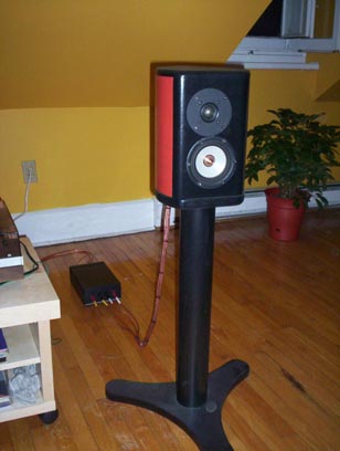

Small two way with Seas excel W12 and ScanSpeak 9300 tweeter.
The enclosure is made with thin sheets of wood and lead in between. Epoxy glue everywhere. These are heavy and real dead. Stands are made with PVC pipe filled with sand and MDF base. External crossover.
The sound is real nice, with good bass for a small woofer. However, the resonances of the woofer are not perfectly tamed yet so I still have to fine tune the crossover. Clean sound.

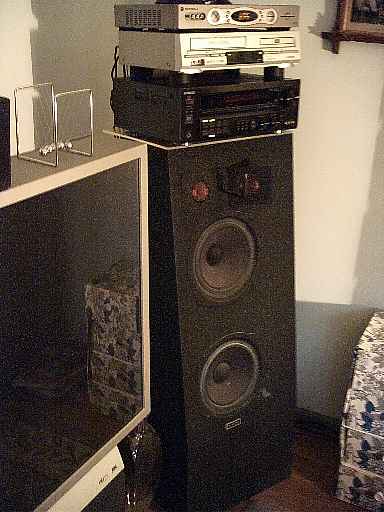

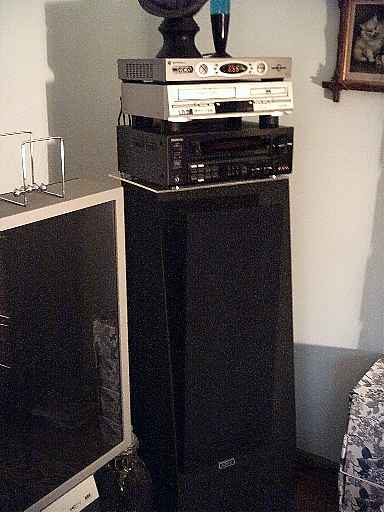

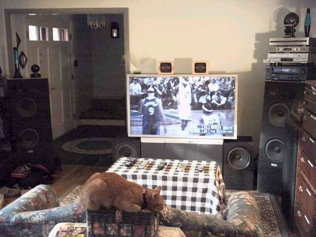

these are somewhat DIY. i took apart my '77 advents last year (bought new!), added duplicate parts from ebay, and built me some doubles. the L/R boxes have a sloping front, with an interior partition that divides the internal space between the woofers. the partition is also sloped, so only the sides are parallel. the enclosed volumes are not equal. trying to spread out any mid-bass humps. the tweeters are mounted side-by-side (i know, bad idea, etc), and the outboard tweeters are aimed at the center of the room. very wide sweet spot!
the center channel is also a double advent. each bass module is the same volume as the original large advent, and the tweeters are mounted in maple blocks on top of the tv.
all bass enclosures are stuffed with original foam: 5 each 2" thick 1 foot squares.
all boxs are painted flat black, and then sprayed with black granite paint. the L/R speakers have "floating" grilles. basically a light frame, with grille cloth, and hung from a bracket sticking out between the tweeters. i still have to make grilles for the center channel boxes.
they sound wonderful!!!
