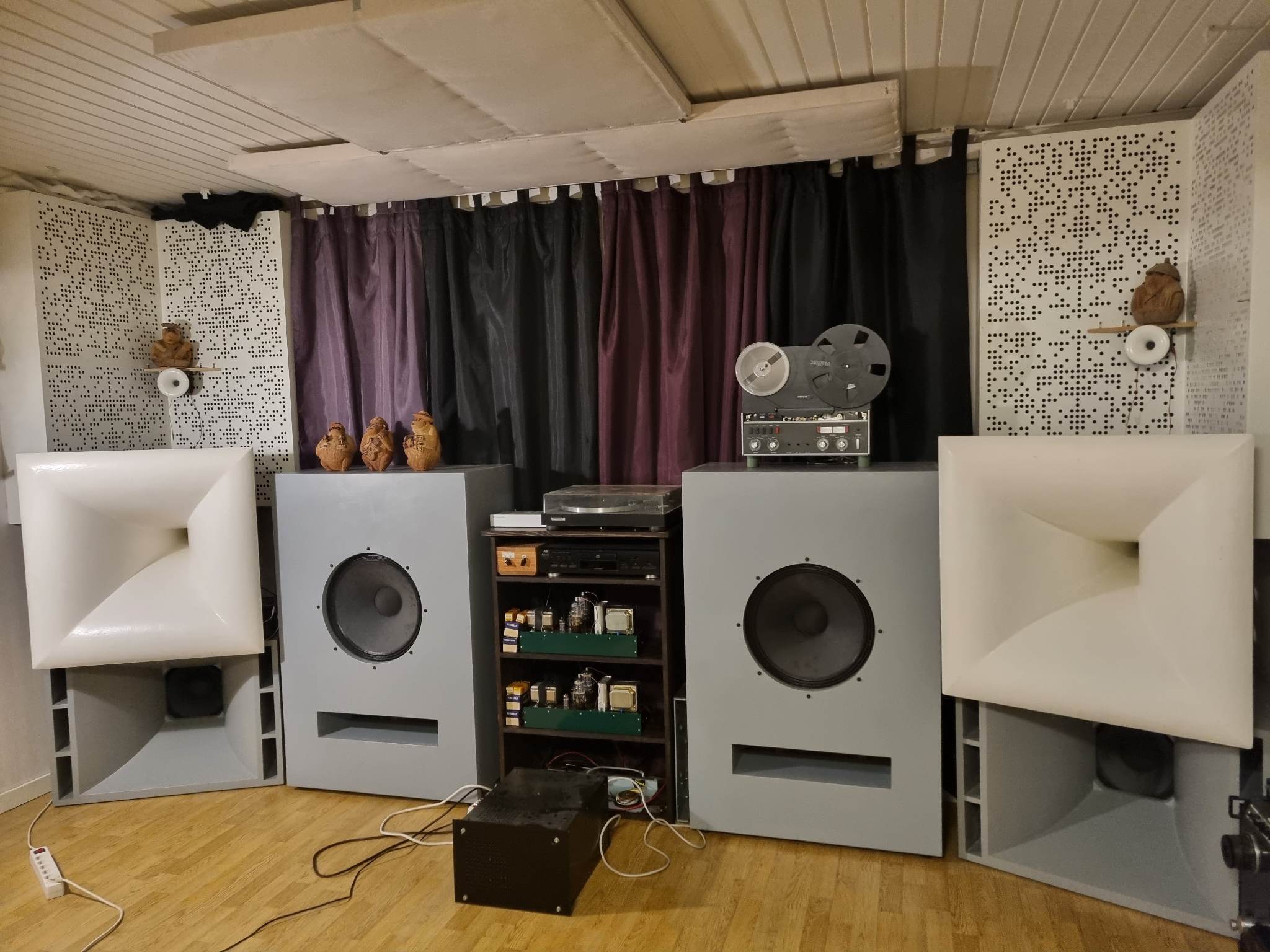

A better picture of my system, taken with a functional camera this time and with a less messy room.

Thanks! It does indeed sound good, especially considering the low-ish budget for the whole system. The speakers are pretty much just chipboard and MDF with low to medium price drivers and the tube mono blocks are made of parts from old Philips EL6400 PA amplifiers.

Nice system btw.
for those type of setupA better picture of my system, taken with a functional camera this time and with a less messy room.
what is the minimal recommended listening distance?

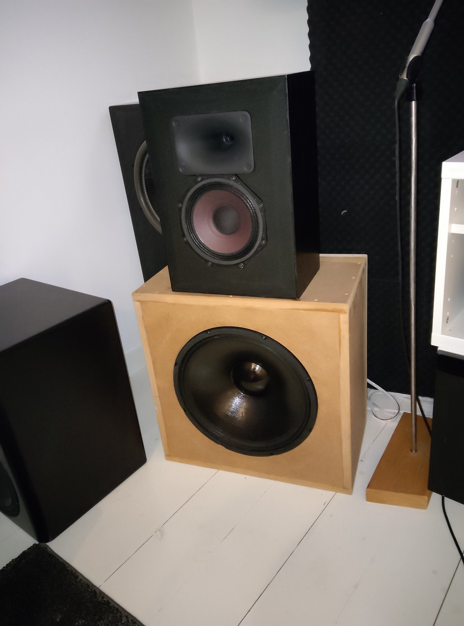

Nice build 👍 You happy with the sound? What are you driving them with?This is my latest build ,
4 way Mini dsp 4x10 hd , x-over points at the moment 70/350/1900 hz
Sth100 / B&C de360
B&C 8PE21
SB Audience 15w400
15" sealed car subs
Thanks , yes I am satisfied, I will do some more back and forth comparisons with my econowaves later (12pr300 / LTH102 + HF108R) and even try the HF108 on the sth100 horn . from bottom to top i drive them with: lab1000 , crown xti 4002, Rotel rb991, Rotel ra870bx .

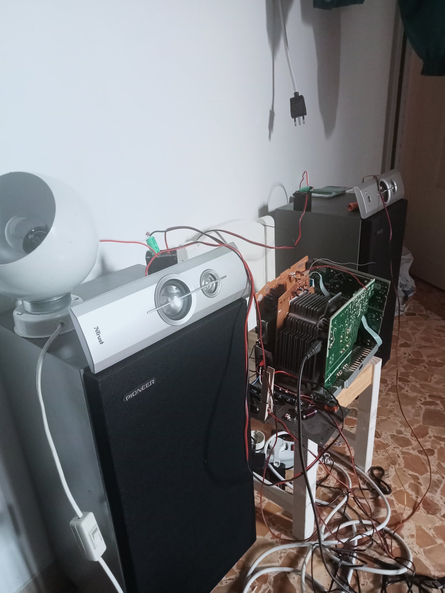

Following from post # 3600 ...
Yeah, found some precious midrange & tweeter combo. I wasn't satisfied from the other 'creation'
Yes indeed, it sucked ! 🤣
So now, Trust me 😆 , now it sounds good ( tweeter still disconnected, sort of WAW now...)

Great looking system!!! I run the big *** Heil tweeters and behind the I have bass traps. They kill the highs coming off the back side of the Heils and when I put plywood over the traps it’s way too bright. I’ve been looking at The type of diffusers you have in the corners.A better picture of my system, taken with a functional camera this time and with a less messy room.
Do you think they would be a good compromise?

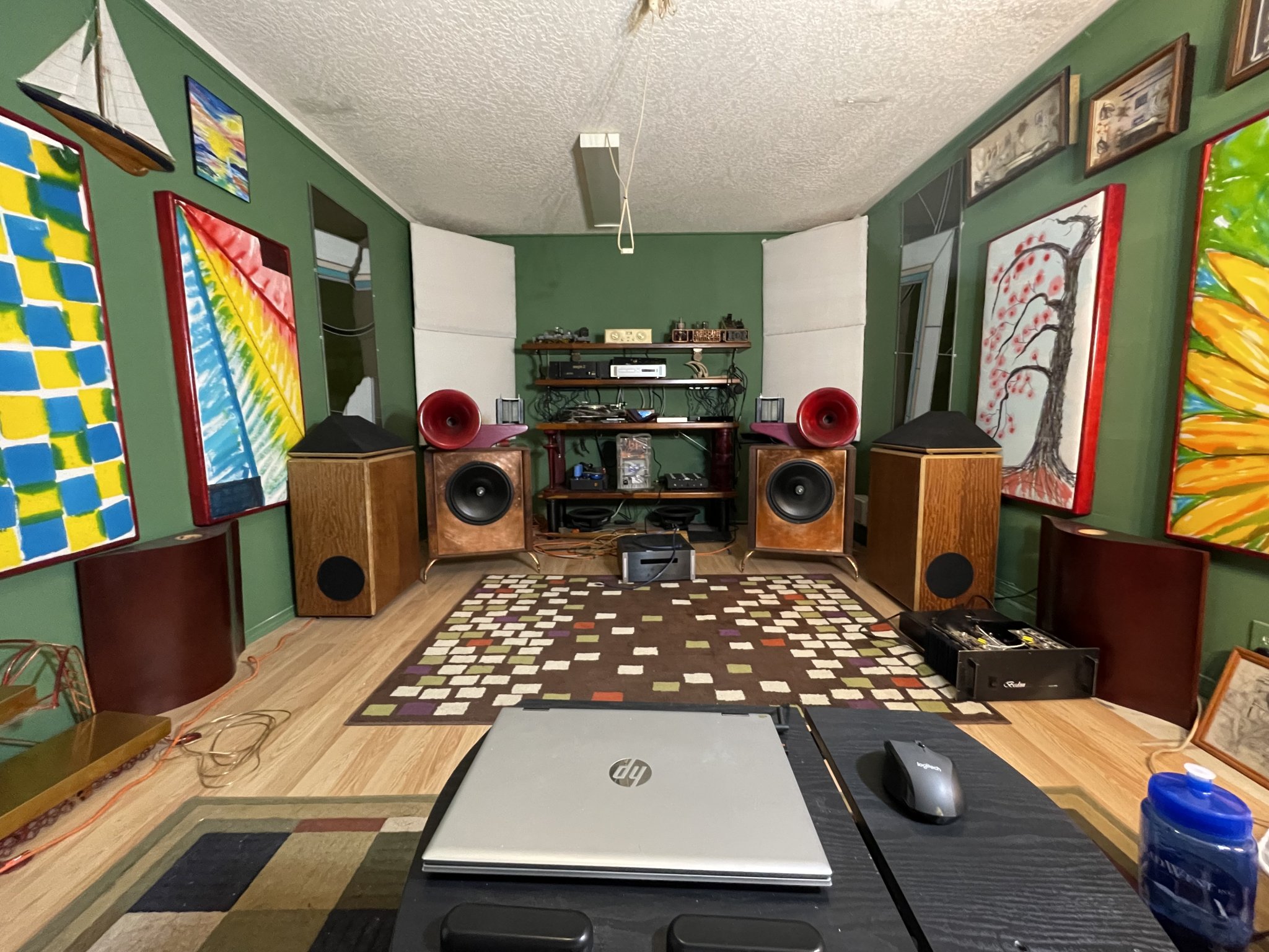

That has got to be the most colorful listening room I've ever seen. I love it!Great

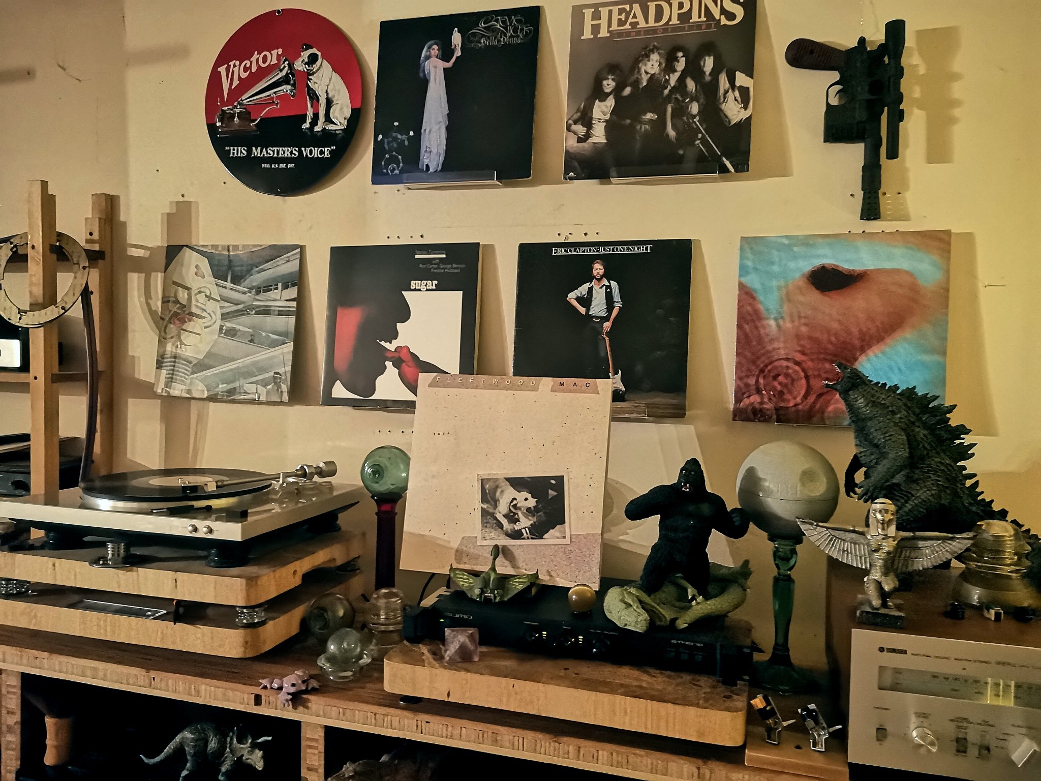

Nice setup. I saw a picture of the "His Master's Voice" image where that hound is raising his leg on the horn.Decluttered and recluttered front end of my system.
Out with a class A power amplifier, and in with a much more powerful class D amp.
It's highpassed first order at line level with a single cap, 0.039uf, for about the same effect as 0.047uf on the class A. Bass for the full ranges is picked up again by a sealed sub and plate amp for it. The full ranges don't reach up to the frequencies I find bothersome with my class D amp, and it seems much improved by highpassing the deep bass out of its budget self this way.View attachment 1102941
Looks great. I'm still enjoying shrinking down from an all separates system. A new used receiver helps a lot. It replaces a preamplifier, phonostage, tuner, DAC, and three power amplifiers. Somehow it still looks cluttered though.
