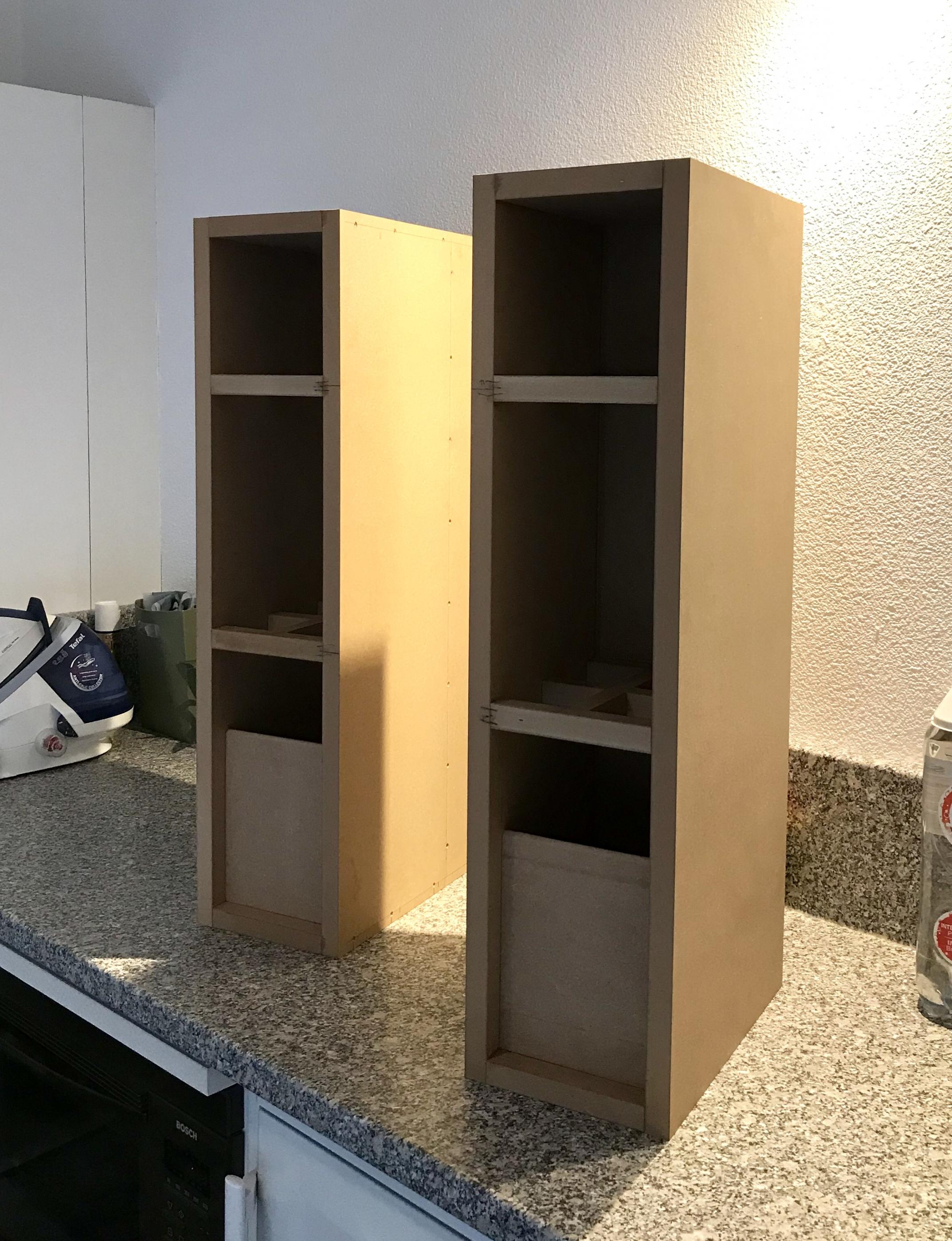

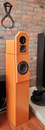

Hello, this is a 3-way speaker. Wavecor WF15 woofer, Faital 3FE25 midrange, Airbrone RT-4001 ribbon tweeter (AMT). Load the woofer in transmission line. Cutoff frequency: 900hz, 8000hz.

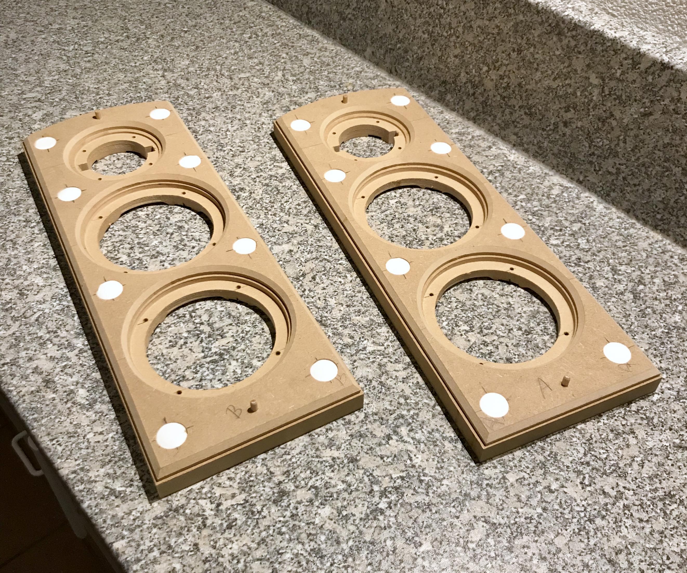

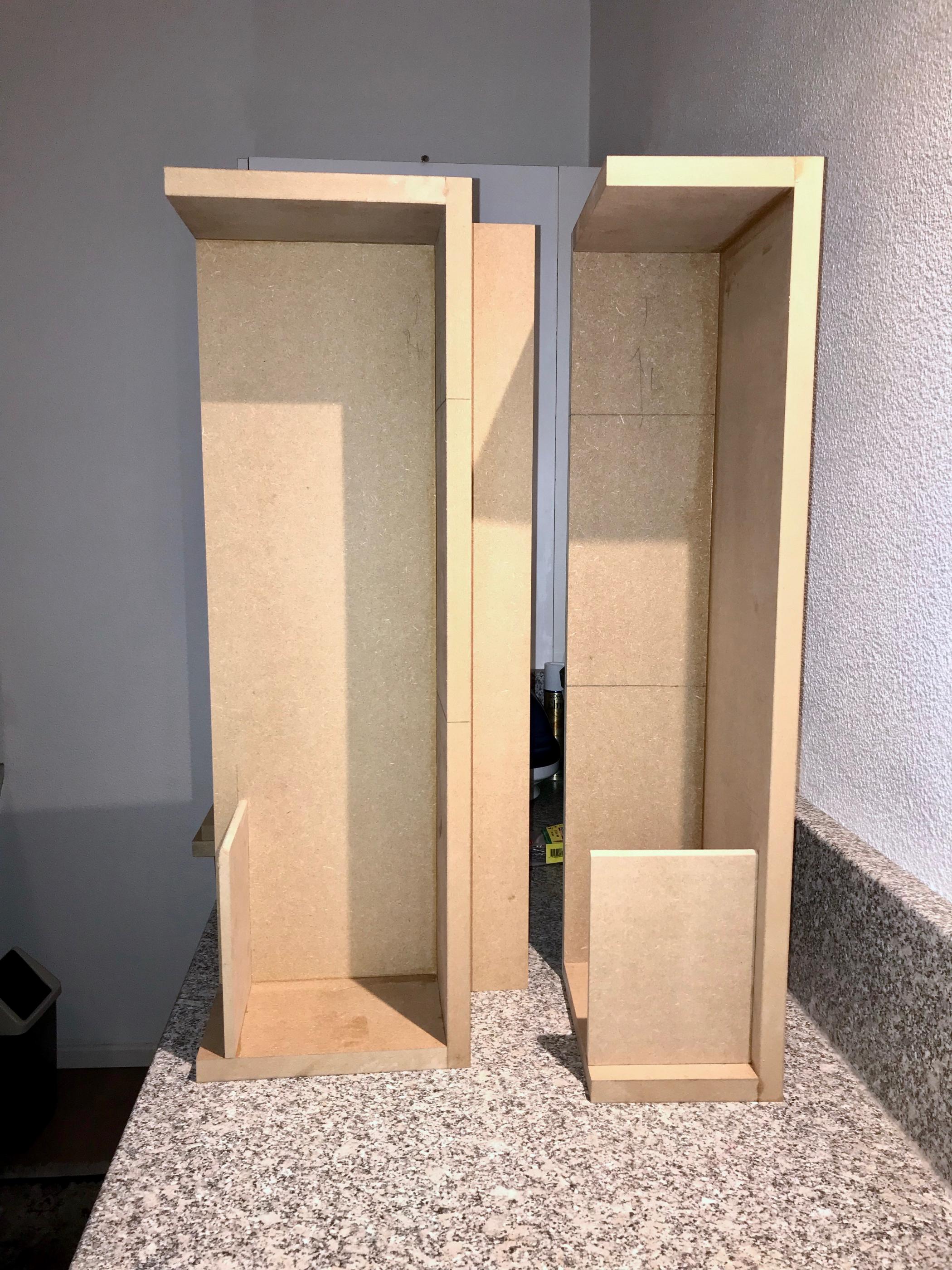

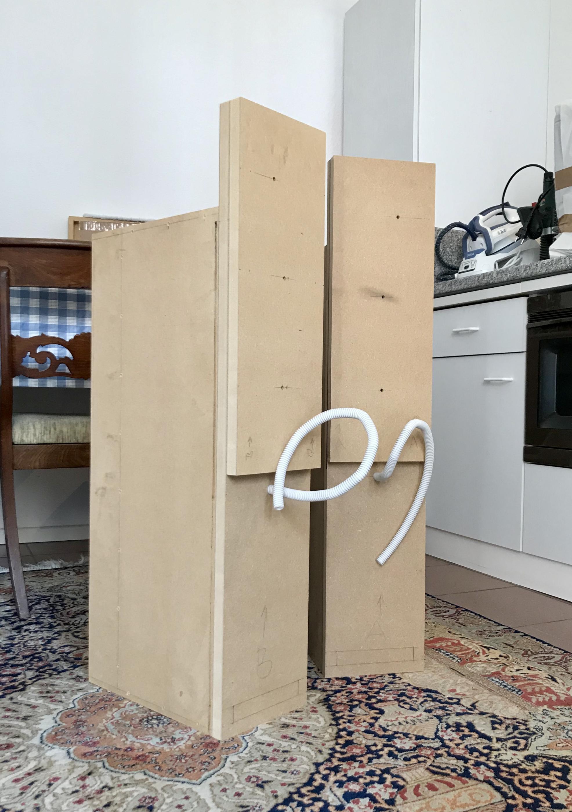

The case is made of 19mm thick MDF, cutted on a CNC machine by a professional carpenter. The design was made using Unibox and other two speaker design software, in order to verify the result.
The internal edges are finished with liquid rubber.
The speaker is damped on each wall except the front one. There are three different damping materials: wedge moulded foam for the side walls and the rear wall (two different tickness), glass wool on top and bottom.
The external finish is made with 4mm plywood on top rear and side walls, black painting for the front baffle, and varnish for wood for the plywood.
Attached are two images of the speaker before the finish, one at the middle of the building process, the other during a listening session with the first prototype of the crossover.
Danilo
solid and straight forward build, im sure this is very enjoyable sounding 🙂
why do you have the terminal on the side?

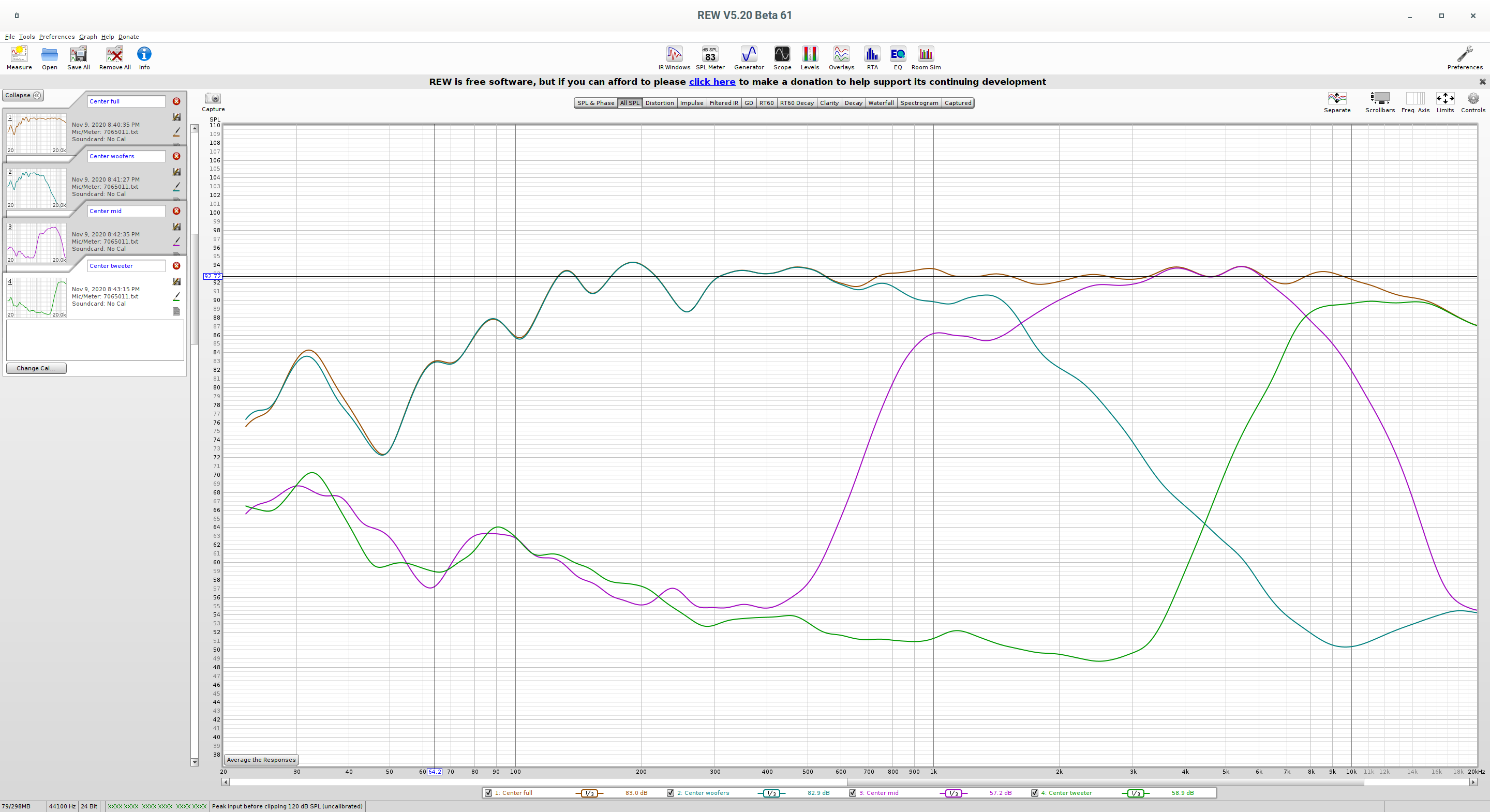

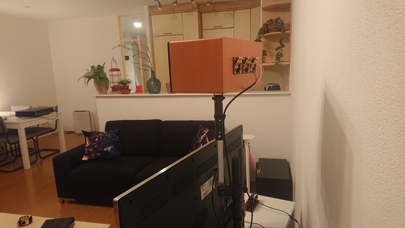

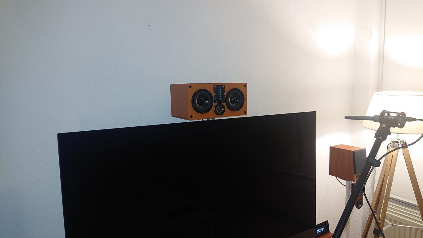

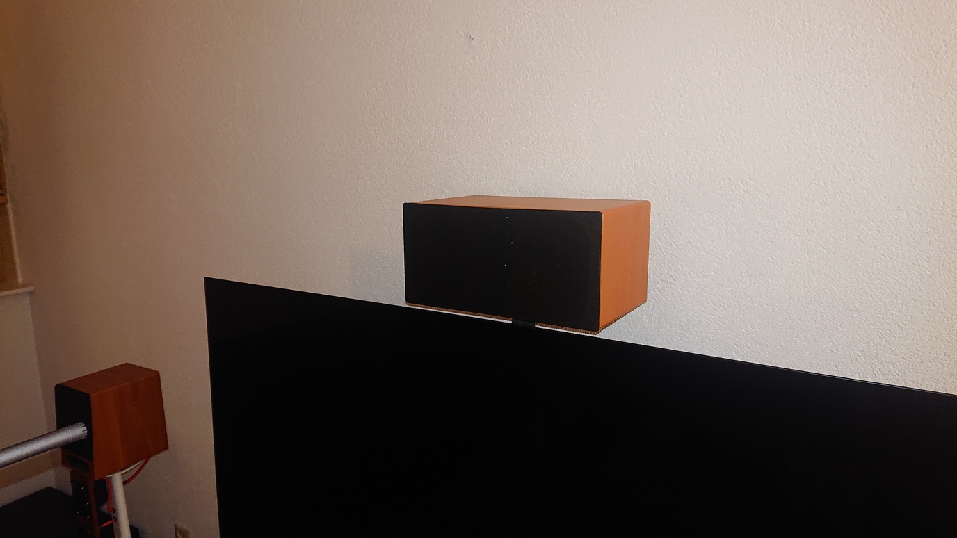

Built a center speaker for my home theatre, using 2 Visaton W100S woofers, a Sounderlink Neo3 PDR clone, and an AMT tweeter.
The crossover is done on a linux pc, using 2 Asus D2X sound cards, my own written ladspa host, and ladspa plugins from: ladspa-t5-plugins :: T5! DIY Audio Software & Hardware
The crossover between the mid and tweeter could be a little better, but I'm not sure how to do that yet. Once I figure that out though, it's just a matter of moving some sliders in a webinterface to change it.
Also the Neo3 PDR clone has a very large peak at 1 kHz, but luckily that doesn't show up in the overall frequency response.
The stand is a vesa monitor mount, modified to hold up a speaker instead.

Yes. I'm assuming you tried the Neo 3 and found it inadequate. Just guessing. I find the little AMT very smooth and detailed, but not reaching down low enough. I've been considering trying them as satellites with some 6.5" Dynavox, and 4" Dayton carbon fiber woofers, as satellite speakers.
The BG speakers I have, don't quite blend with dynamic drivers, so far in my best efforts.
My route was the other way around, I like the little AMT a lot, and wanted something matching for the lower frequencies. However I find the Neo 3 difficult to use, possibly because of its peaky frequency response. My crossover is a DSP so it can be fixed, but it will take me some time to get it right.
Using the Neo 3 with just a woofer and a passive crossover would be very difficult to get right I think.

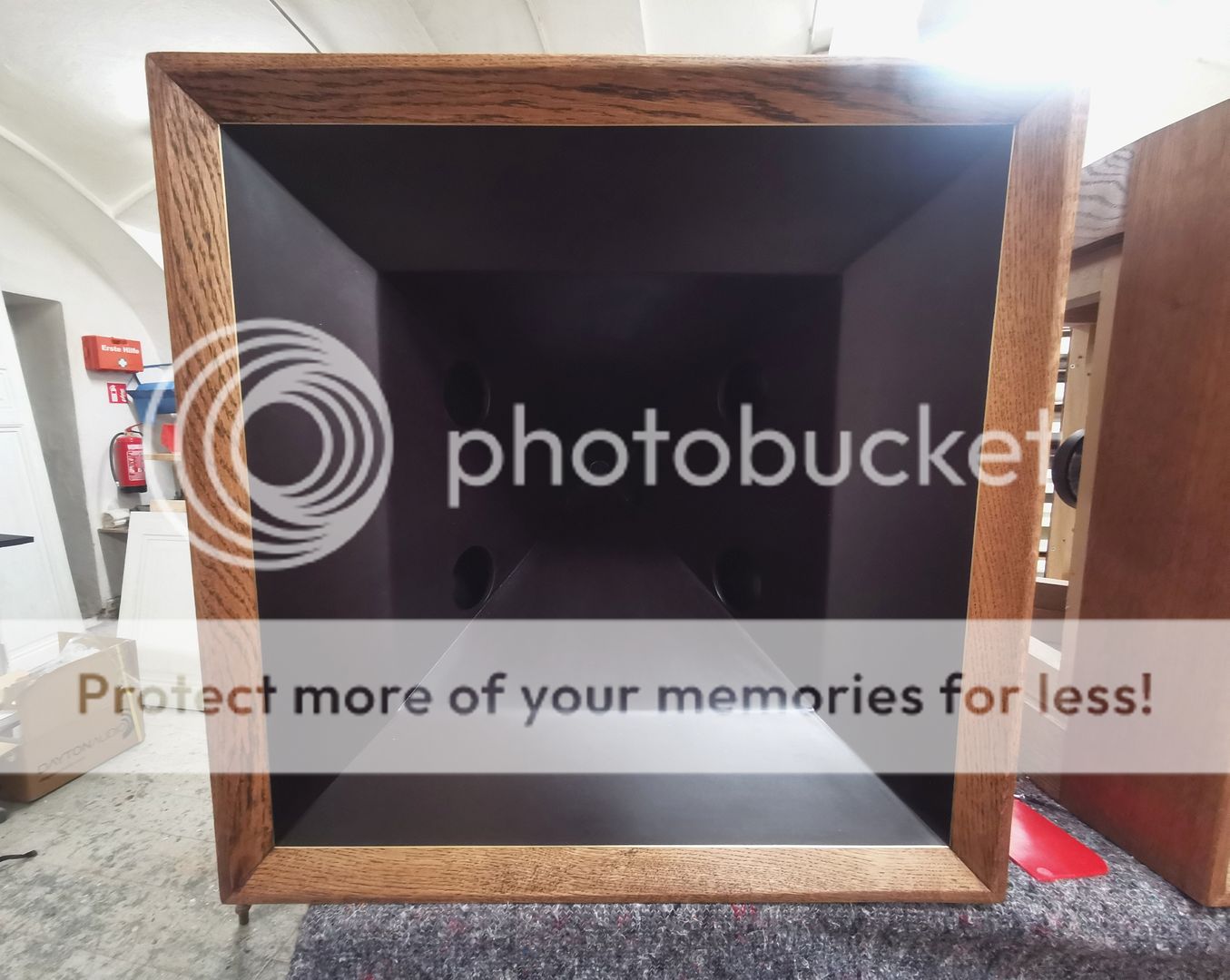

My Synergy Horns
Here are my wonderfull sounding Synergy Horns. The original design is by SpeakerScott, and i redesigned the enclosure to my needs.
I don´t have the words and intention to wrtite a colourful sound description.
Trust Scott and my words: "They really are THAT good!"
The inner horn, top, side and bottom are black mdf boards. The rest is solid oak, with a little brass inlay at the horn mouth and removable side panels.
In case anybody wants to see more build pics and vids you can go over in to my instagram and look in the synergy-build- stories.
Login • Instagram
They are driven with DIRAC room correction, which imho does great things, especially in the sub region in my tiny room. They have surprising bass, but the last octave is taken care of by a big 15" BR Sub.

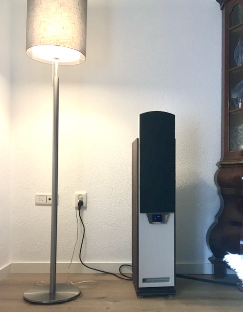

Active speaker using SB-Acoustics drivers, Hypex AS2.100 and a RPI with Hifiberry Digi running Picoreplayer.
