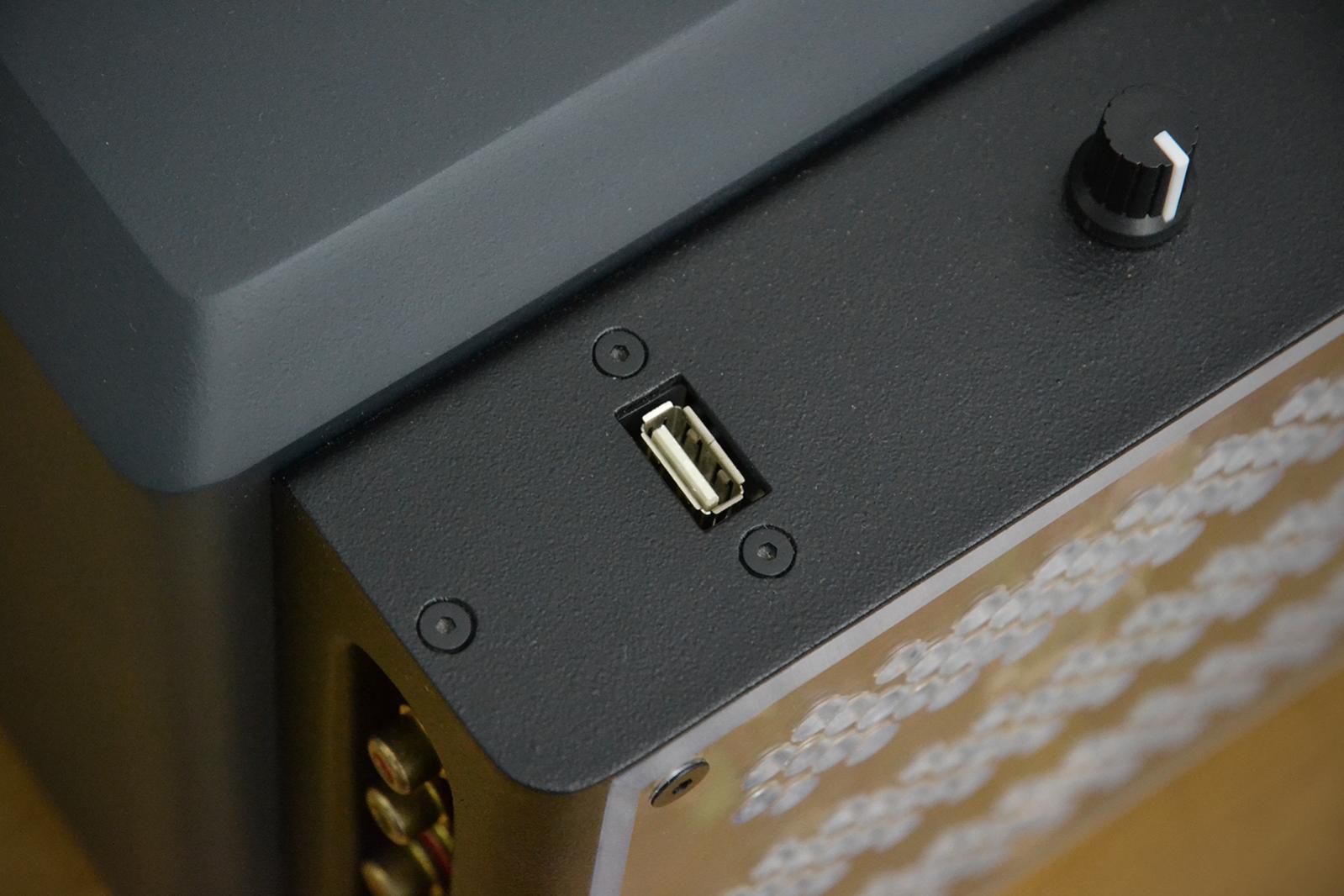

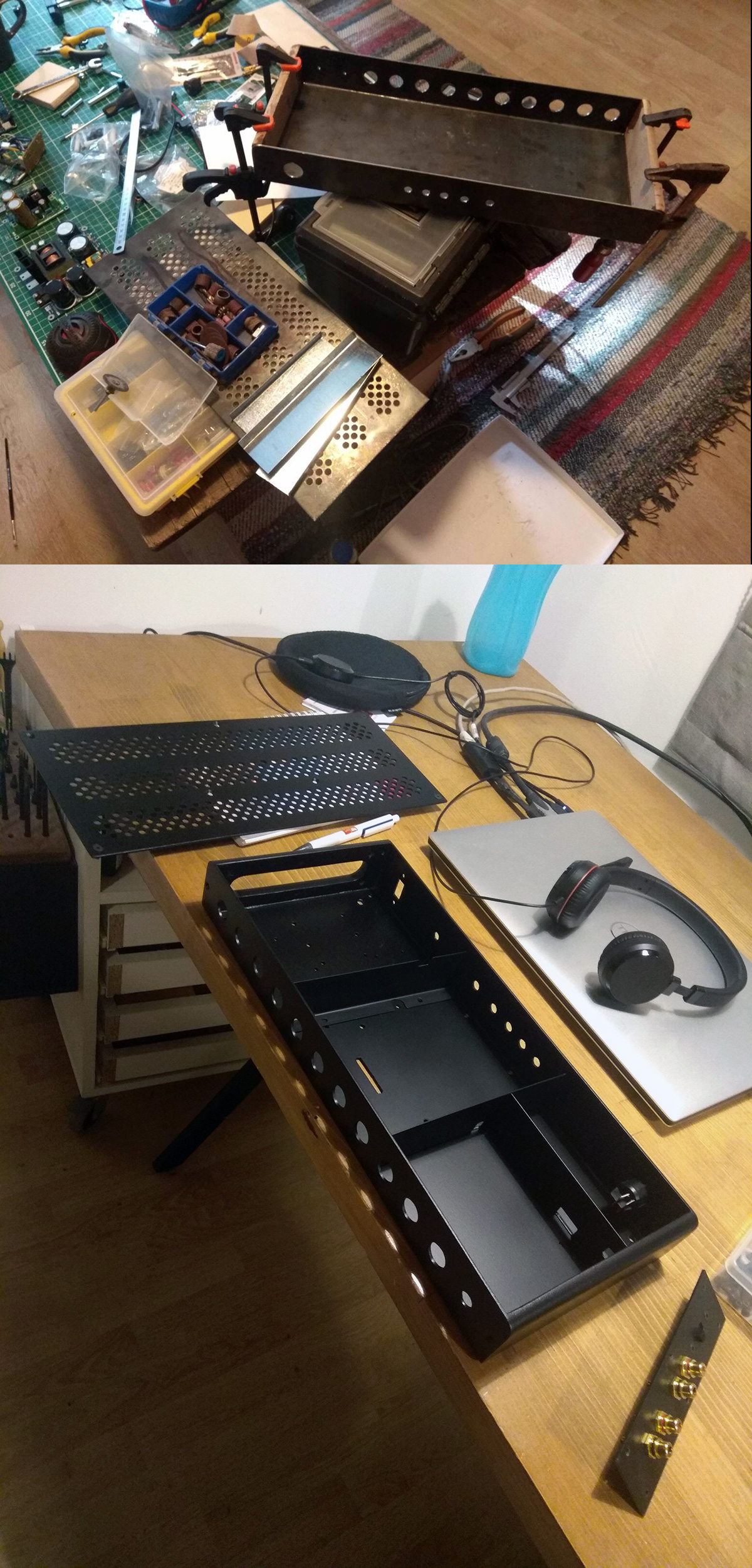

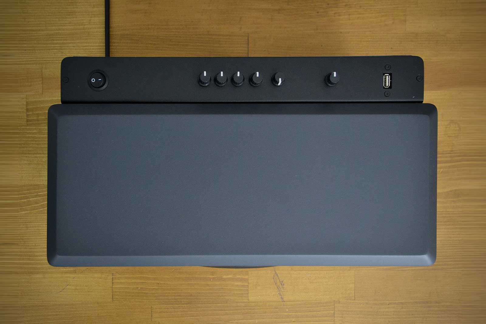

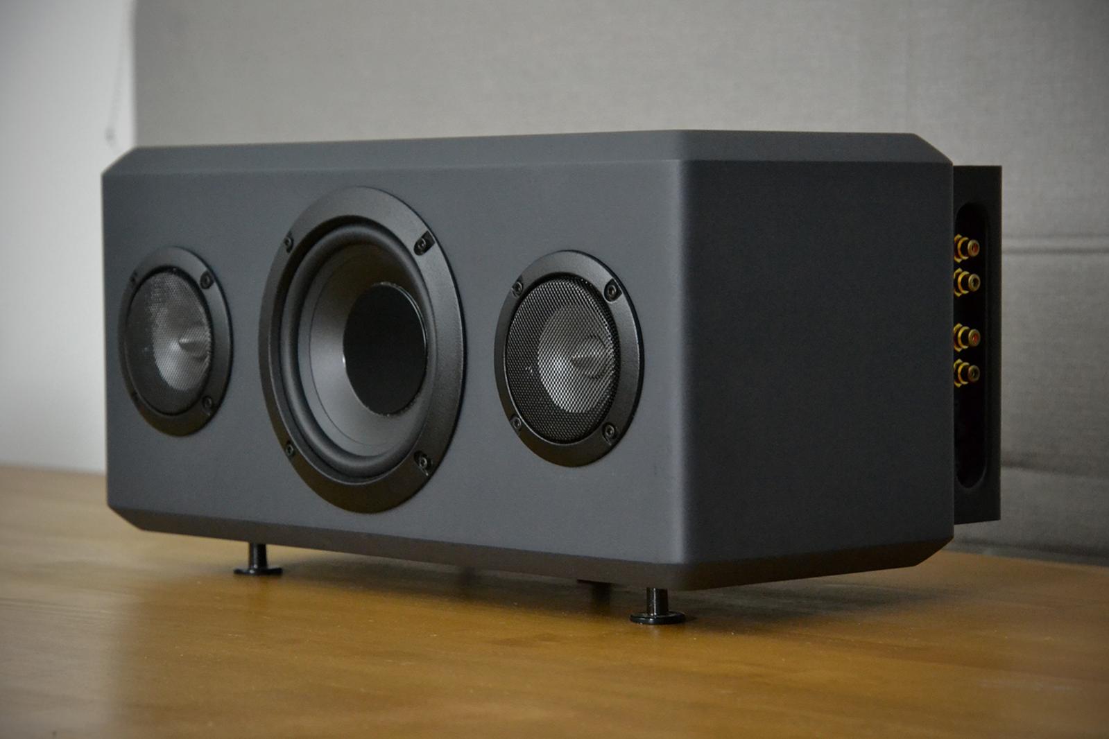

2.1 speaker (boombox) with Raspberry Pi
Hi, I'm not sure that this is the right topic, but because the speaker is some kind a multiway I decided to show it here :)
I finished the speaker few months ago but manage to make photos before few days.
Used drivers are Visaton W 130 X and Tandband W3-871 (with notch filters). Amplifier is based on a TPA3116 with some mods. PSU is from Connexelectronic on 24V. Main source is linear powered Raspberry Pi Zero W with cheap ES9023 dac with TCXO (twice as expensive as the dac:)). There is a separate bluetooth module with a little poor signal level :)
Input selector is passive little ALPS switcher.
Enclosure is made from 15mm plywood (subwoofer panel is 30mm). The back enclosure is from 2mm steel.
There were some problems with wi-fi on the Pi with steel back. Because of this I made the transparend back panel.
I drilled the holes through the metal back quickly and slightly distorted them, but probably will make a new back panel of thinner material and with straight holes :)
The sound is very nice :)

Try sharpening your drill like this ( takes a bit of practice ). How did you get that finish?
I have such drills for wood. If you mean for the holes on the back, I used the original back as a template to drill them second time on the new transparent back (about 800 and more holes in total :whacko:) and because of this used drill for steel. Thanks for the information!
For the finish I used car bumper spray paint.
The exterior surfaces on the back section (for the electronics) is coated with black texture paint and the plywood enclosure is coated with anthracite matte paint (RAL7016), also for car bumpers.
Here is the "original" steel back.

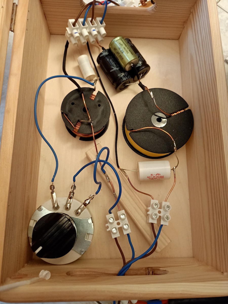

Coaxial bass reflex with Eminence speakers
Hi all, this is my first loudpeaker project. Coaxial bass reflex with Beta10CX and ASD1001. 68 litres cabinet tuned at 40 Hz, 94 - 96 dB efficiency.
The crossover is the standard Eminence 2500 CX with an LPAD on the compression driver and 1450 uF before the low pass section.
The ASD1001 will be probably substituted by a Beyma CD-11Fe/S.

When I use those terminal blocks I twist the wires together and stick them in the same hole then tighten the screw, so the terminal block is used to keep them twisted together and stops them from touching each other. I don't know if it really makes a difference, twisting wires together seems to make a good contact. Nice speaker and a good finish on the front baffle.

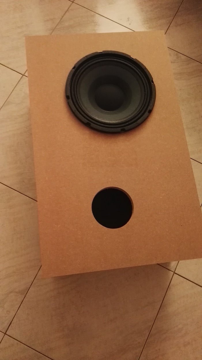

Nice one. Do you have a separate thread for the build process maybe? I’m in the process of testing the same drivers in a smaller cabinet and also other HF drivers.
I share your view that the sound is very clear and enjoyable.
The case is made of 19mm thick MDF, cutted on a CNC machine by a professional carpenter. The design was made using Unibox and other two speaker design software, in order to verify the result.
The internal edges are finished with liquid rubber.
The speaker is damped on each wall except the front one. There are three different damping materials: wedge moulded foam for the side walls and the rear wall (two different tickness), glass wool on top and bottom.
The external finish is made with 4mm plywood on top rear and side walls, black painting for the front baffle, and varnish for wood for the plywood.
Attached are two images of the speaker before the finish, one at the middle of the building process, the other during a listening session with the first prototype of the crossover.
Danilo
