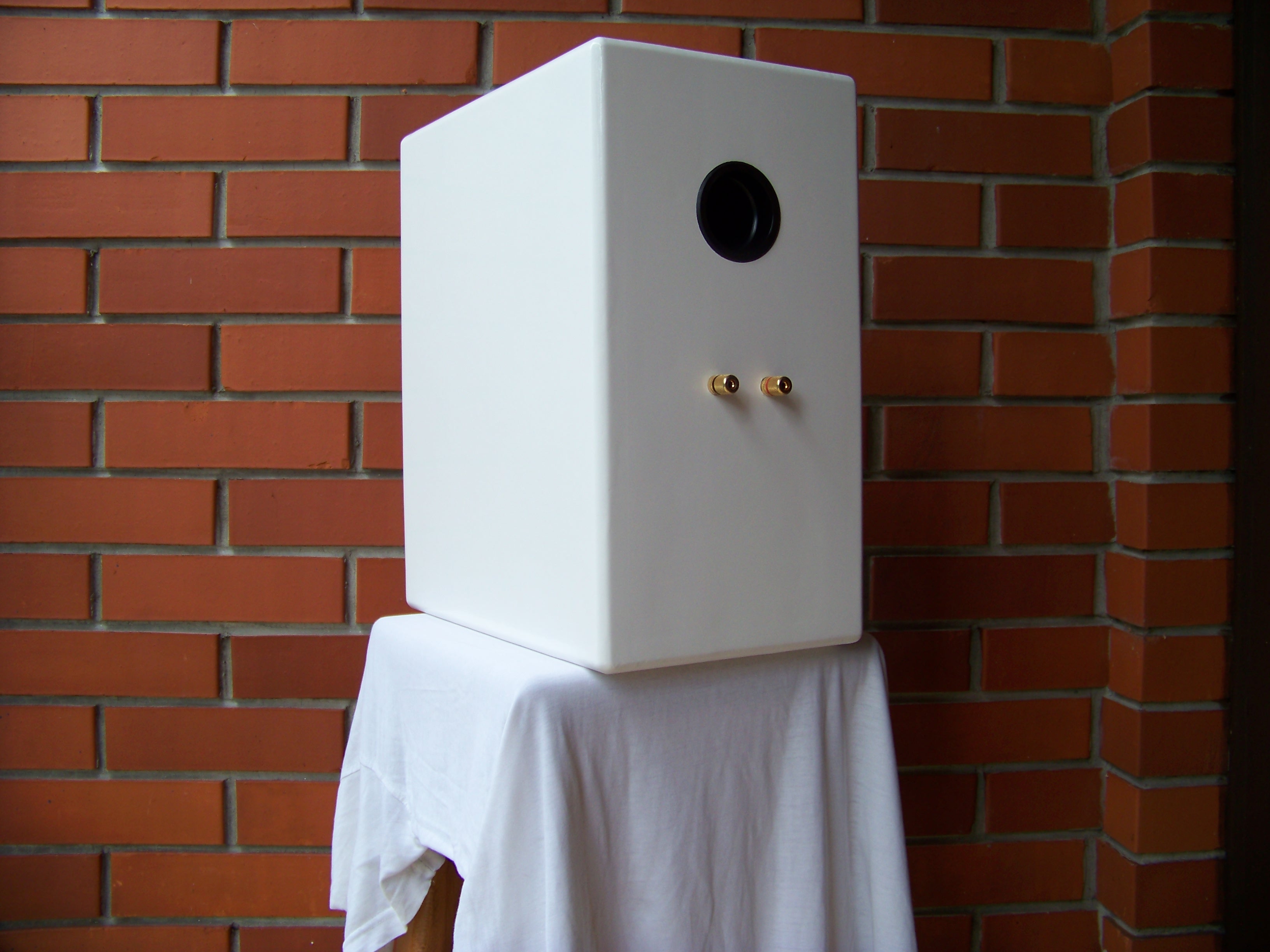

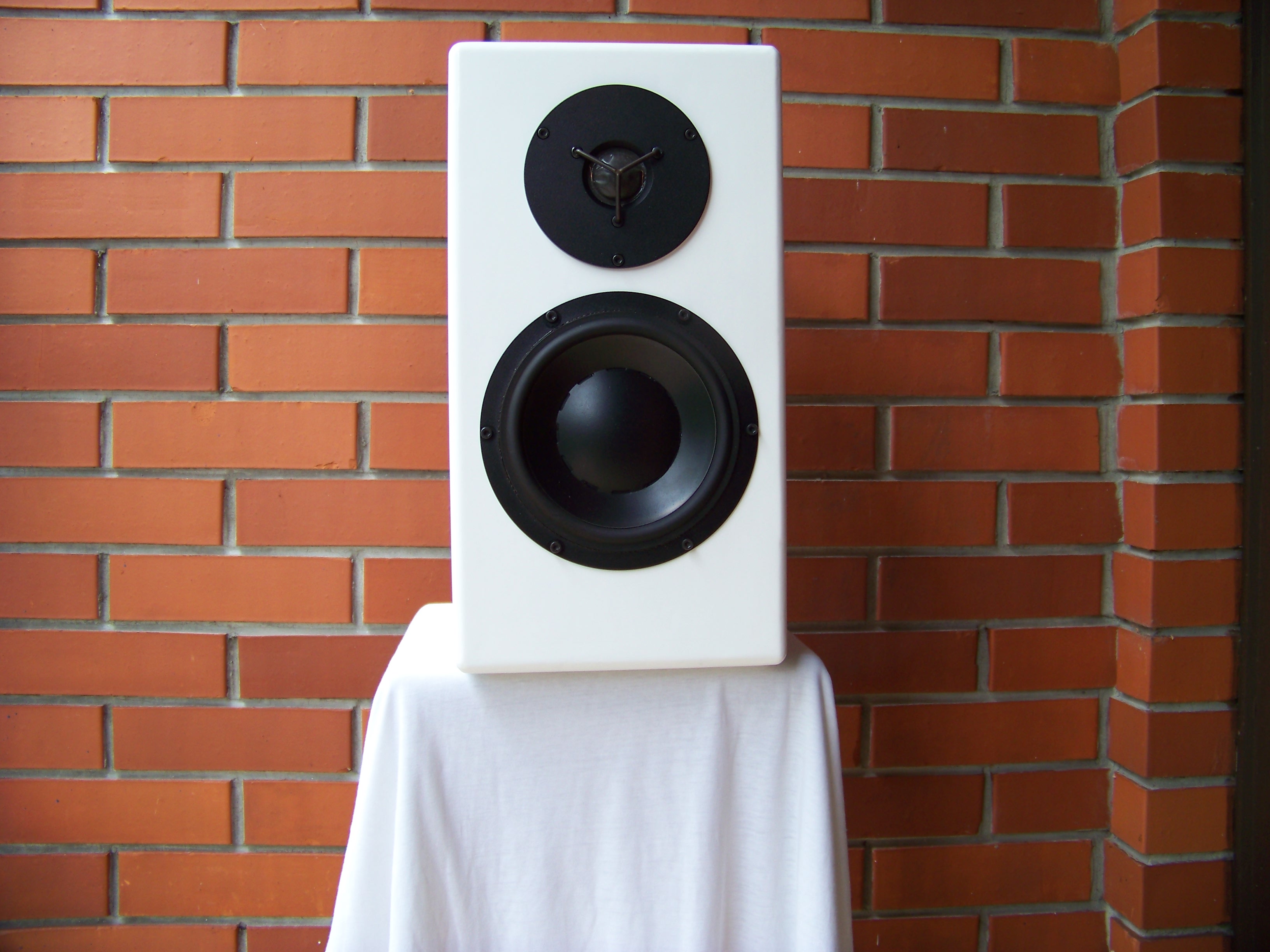

Dynaudio 2 way DIY with automotive genes
Hi folks,
So I have been wanting for more than a decade to build a regular
2 way speaker for a secondary audio setup in a smaller room and
after many years of search, finally spotted a chance to buy tweeters
with pushed in domes( kids🙂) and a pair of MW 160 GT for a good
price. The box used to be a floorstander initially made for some
other drivers by another individual, sawed to a measure I felt right
about.
I was so curious to do the paint job myself and not having the proper
spray gun equipment, decided to apply the paints by brush. For priming
the raw mdf I had a 1k auto primer and as a finishing coat I chose the white
marine enamel. My plan was to apply at least three very thick layers
of enamel and then sand it down wet with 1000 grit paper.
I can tell you, now I appreciate much more this kind of work because
it is so much time consuming and a drag to do. Could only do one
side at a time so it dries over night. Those primer and enamel were
such bad smelling chemicals, I had to use a face filter mask.
With each layer of paint the surface looked much more even.
After the sanding process, glossiness was gone which I partially
managed to get back by polishing. The end result is a semi gloss
appearence. For the money invested, which was not much, I am
satisfied.
The speakers are playing very openly with enough of bass extension
considering bassmid is an auto speaker unit with a higher Fs and
lower Vas parameter than 8 ohm versions. Especially the vocals
and high frequencies appear unstrained and natural.
Vb:16,5 litres BR
Fb:52 Hz
Sensitivity: 84 dB/2,83V/1m
XO frequency: 2,2 kHz
Filter: LR4 acoustic
Bassmid: Dynaudio MW 160 GT
Tweeter: Dynaudio D260 Esotec
Thanks!

Those are smooth! The white paint gives a nice, clean look. Bummer about the domes on the tweets.
Thanks 6th, I had used up 2 cans of 750 ml enamel so I could sand
them without worrying of breaking through. Tweeters were damaged
and on account of it cheap, just what I was hoping for. I did everything
to set them right but unfortunalety the silky material with its coating
just jumps right back. The impedance and FR measurements were ok
so I chose to be at peace.
Your speakers are work of art compared to my cuboids🙂.
If the diaphragms are removable and you can access the backside, put something in the back to form fit the shape (like a broom handle or cotton wadding) and warm it with a hairdryer. Wait till it cools before removing the form.

a great idea! I actually did remove the self centering dome voice coil assembly
and gave it a hairdryer treatment but without putting anything for support,
just used a finger to set right without success. I will reflect on your suggestion.
Cheers!
Cheers!
No guarantees. I wonder if there's something you can 'moisten' the dome with to try and reset it. Some sort of solvent or something like acts like water when used in ironing clothes?
