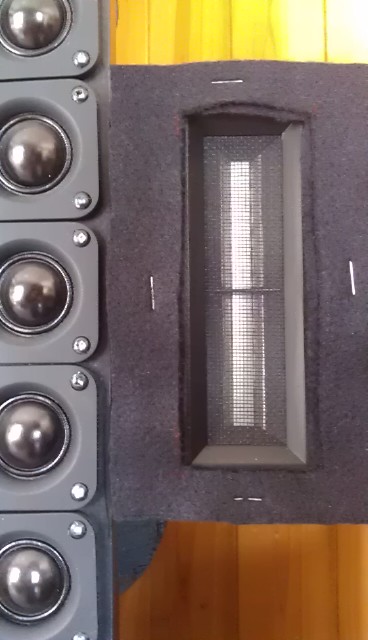

I picked up a pair of Wharfedale Valus 500s for USD$20 One of the (originally titanium dome) tweeters had been replaced with a paper tweeter roughly nailed (!) into place.Rather than try to match the original (no longer available) or try to find a new pair that matched specs (specs not available either) I went looking for something different. On eBay I found a pair of air
Heil air-motion transformers? I saw a pair on clist recently, the large ones and I am sort of intrigued.
Sorry, no. Ran across a problem with allowed time for editing posts and got cut off.
They were asking USD$49 a pair, I got their less then prepared for installation for $40 shipped.
I've be wanting the ESS drivers since they came out circa 1972. Although these aren't dipole, they do a fine job projecting, and complimentingn the Wharefdales.
Both ways, Valdus 500s, and discount Chinese AMT's, I made out> USD$60 and I had a neighbor from 3 houses down standing in my yard to listen.
Oh, and the wife came out of the bedroom to ask why I'd installed speakers in there. Through 2 rooms and a hallway into the bedroom -- now that is what I'd call some accurate projection.
As for bass, most other things that make me FEEL it are bass guitar four by's or folder horns. These things freaking KICK.

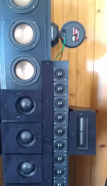

Hi, here is the final version of my line arrays.
4 inc Hi-Vi B4N x-over to 1.2 Khz
3 inch Hi-Vi DMA
1 inch Hi-Vi TN25 from 5 khz up
Pyramid ambiance bullet TW28 rear firing
Peavey ribbon used as super tweeter from 18 khz and up.
Final sound??
Extreme open sound, silky highs and very efficient design at more than 97 bd efficiency.
Set up:
Teac CD PD-H600 for drive
Logitech Squeezebox
Bryston BDA-1 D/A converter
Holand HP-100 pre-amp
Mark Levinson No 436 Monos
Crown K1 for (4) subs

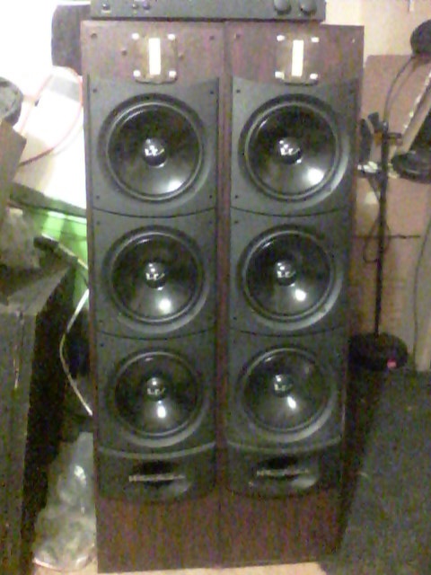

My first DIY speakers build over months xD
The drivers are: http://www.scan-speak.dk/datasheet/pdf/r2604-833000.pdf
and: http://www.scan-speak.dk/datasheet/pdf/18w-8531g00.pdf
The front grill hangs by magnets inspired from B&W
And some pics:
And some pics:

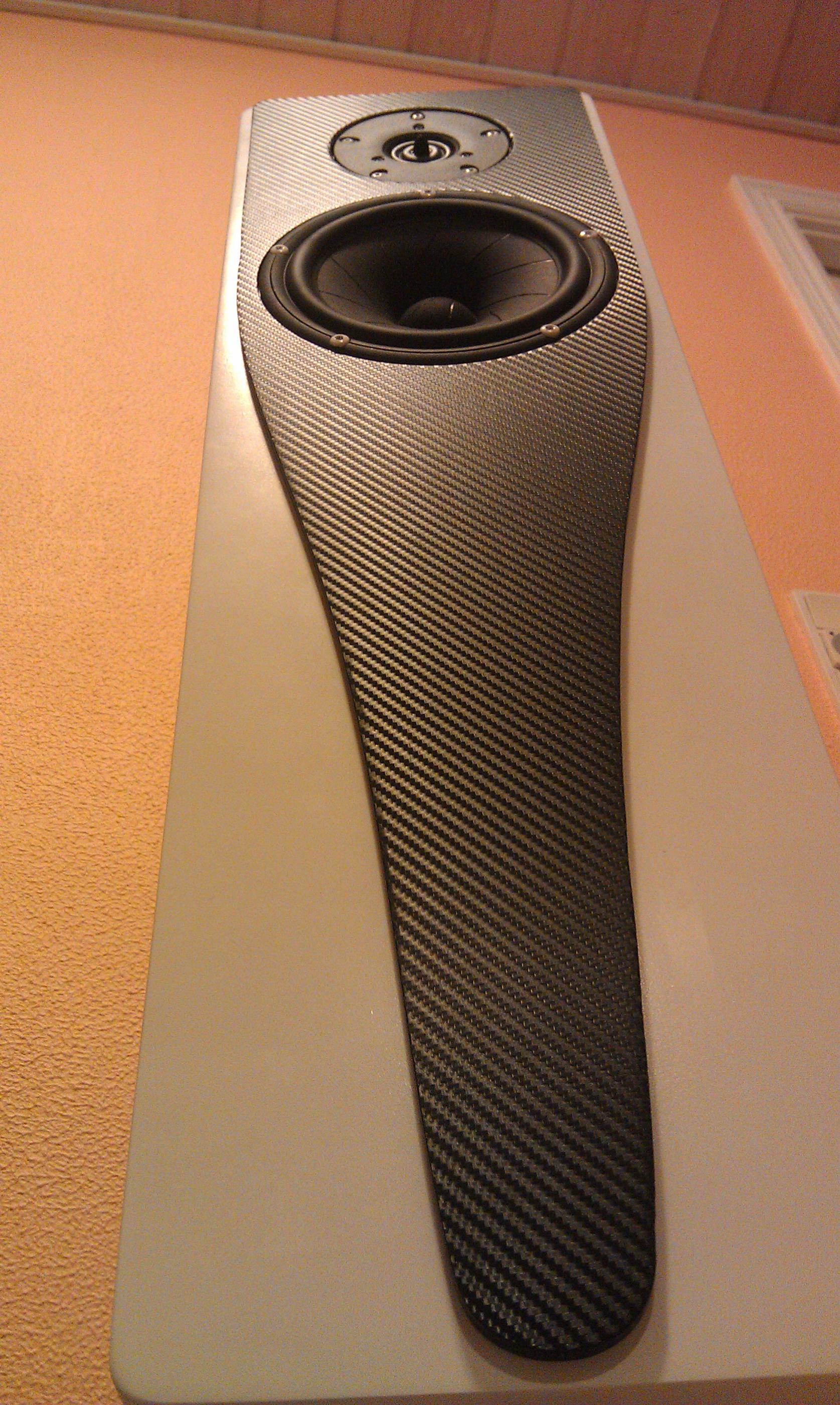

My speaker project on 'Homebuilt Hi-Fi' (3 way horn)
A 3-way high-efficiency system with horn-loaded Mid and Tweeter: Project | Homebuilt Hi-Fi - A user submitted image showcase of high quality home built hi-fi components.
Marco
Marco
@ DannerD3H, great design! They look fantastic! Interested in the carbon fibre 'look', is it the stuff you can get from car stores? Black screws would look better IMO, curious about them being rear firing bass reflex and so close to rear walls, don't they sound better further forward?
Thx
Yes it is just regular vinyl with carbon look
Yeah I considered it but I just liked the contrast of white screws
As they are accompanied by that sub I don't really hear much difference. The reason they are that close is that it gave the most deep bas before I build the sub
Fair enough, you know what looks and sounds best for you
I've always found loudspeakers bass/imagining is better further away from rear wall but all scenarios are different
I considered carbon look vinyl and must say it looks great on your loudspeakers, will have to consider it again I think
Thx for sharing!
