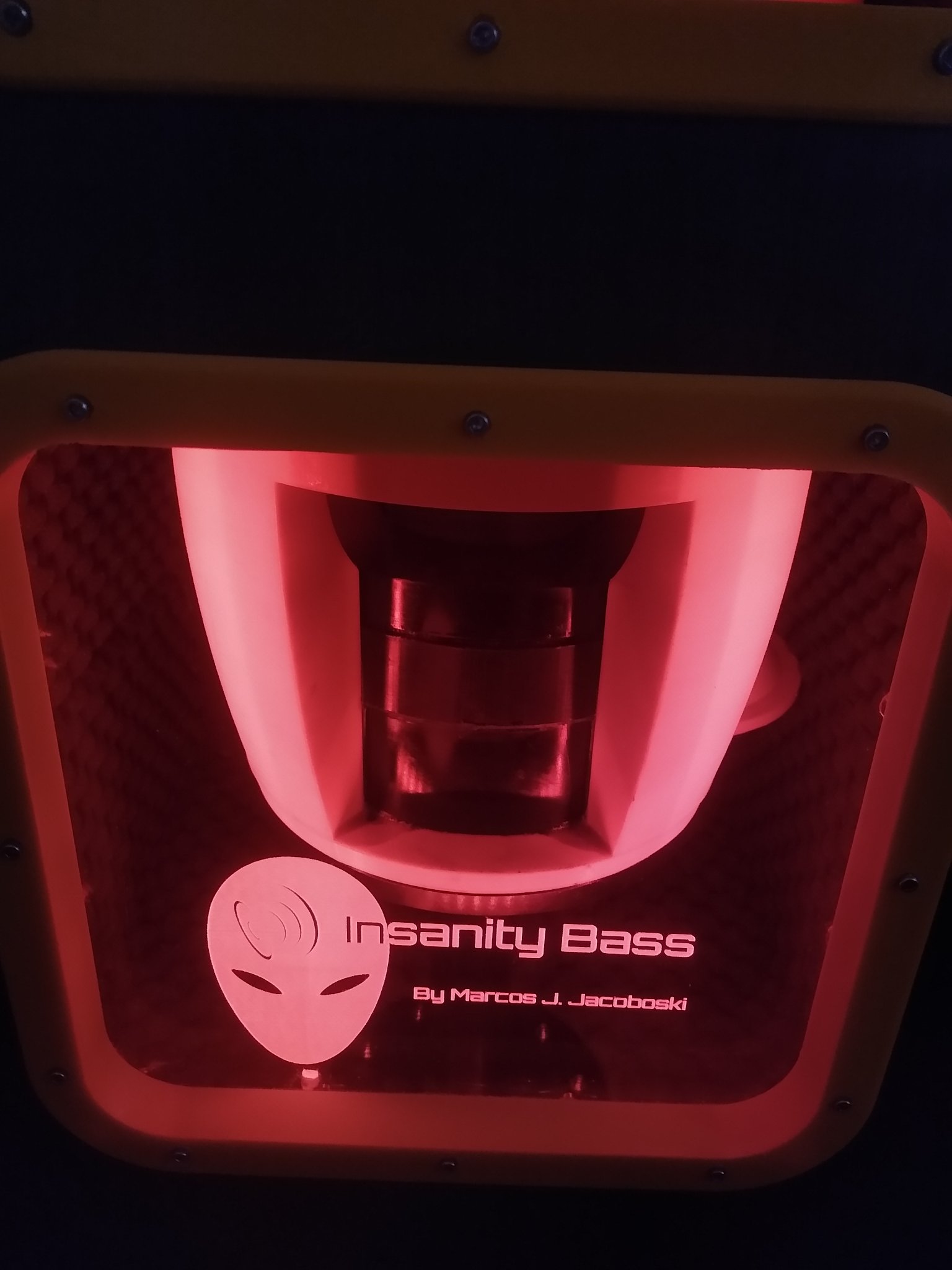

Hi. This is my NdFeB 3D printed subwoofer.
I have a post here in the subwoofer section showing more details.

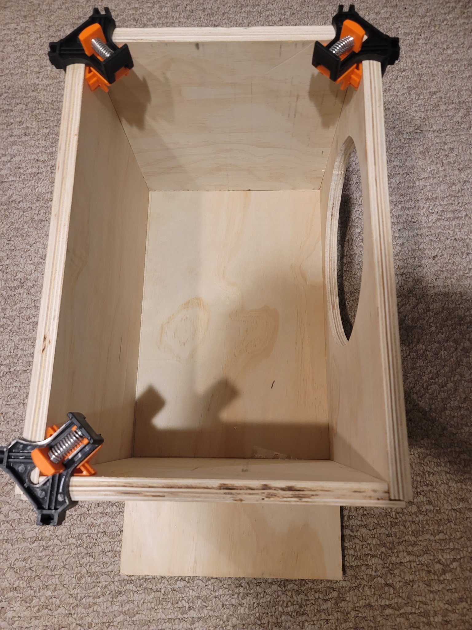

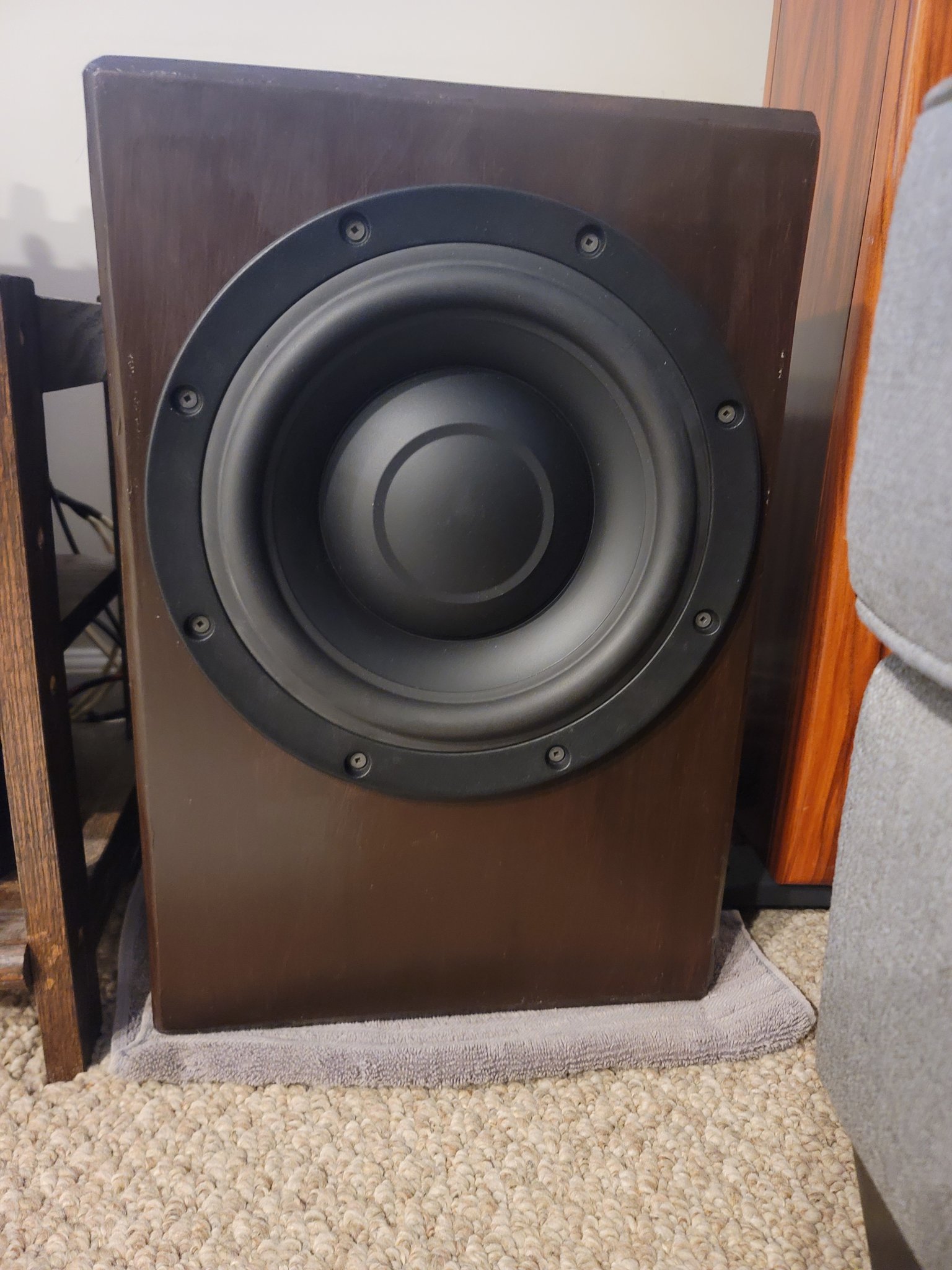

My 18"H x 12"W x 12"D sealed box out of 3/4" baltic birch. Using the SB Acoustics 10" shallow driver, aluminum cone. I modeled the enclosure on SpeakerBoxLite, -3dB at 25HZ without any bass boost. This driver modeled better than the Dayton Ultimax 10. Sounds tight and fast. This driver is made for tight spaces, but sounds really good in a more normal box as well.
Stain is a mix of Black gel stain and Old Masters Crimson Fire gel. Came out a bit darker than I wanted initially, but I love it.

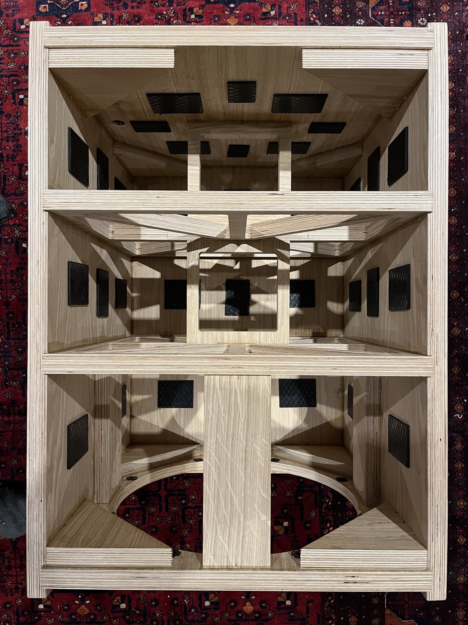

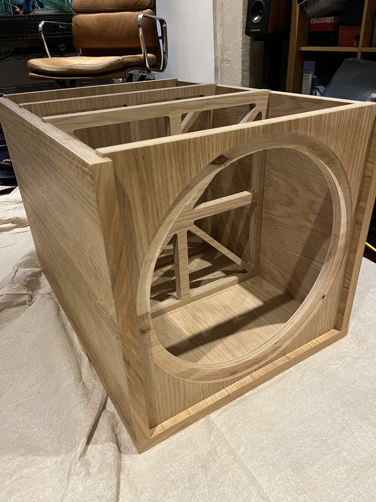

Correct. 18" drivers mounted with the magnets outside the enclosure - this is the 'baffle'! The rear panel is 2" ply, walls are 1". First significant panel resonance above 500Hz.
Somehow doubt those are the "backs".
Yeah, the driver can be reverse mounted.
The drivers chose me - six Brand new old stock B&C 18PZB100 at £125GBP each! Not the perfect driver for sealed enclosures, but I'll accept lower sensitivity at that price! Each powered by its own bridged Behringer EP2500.

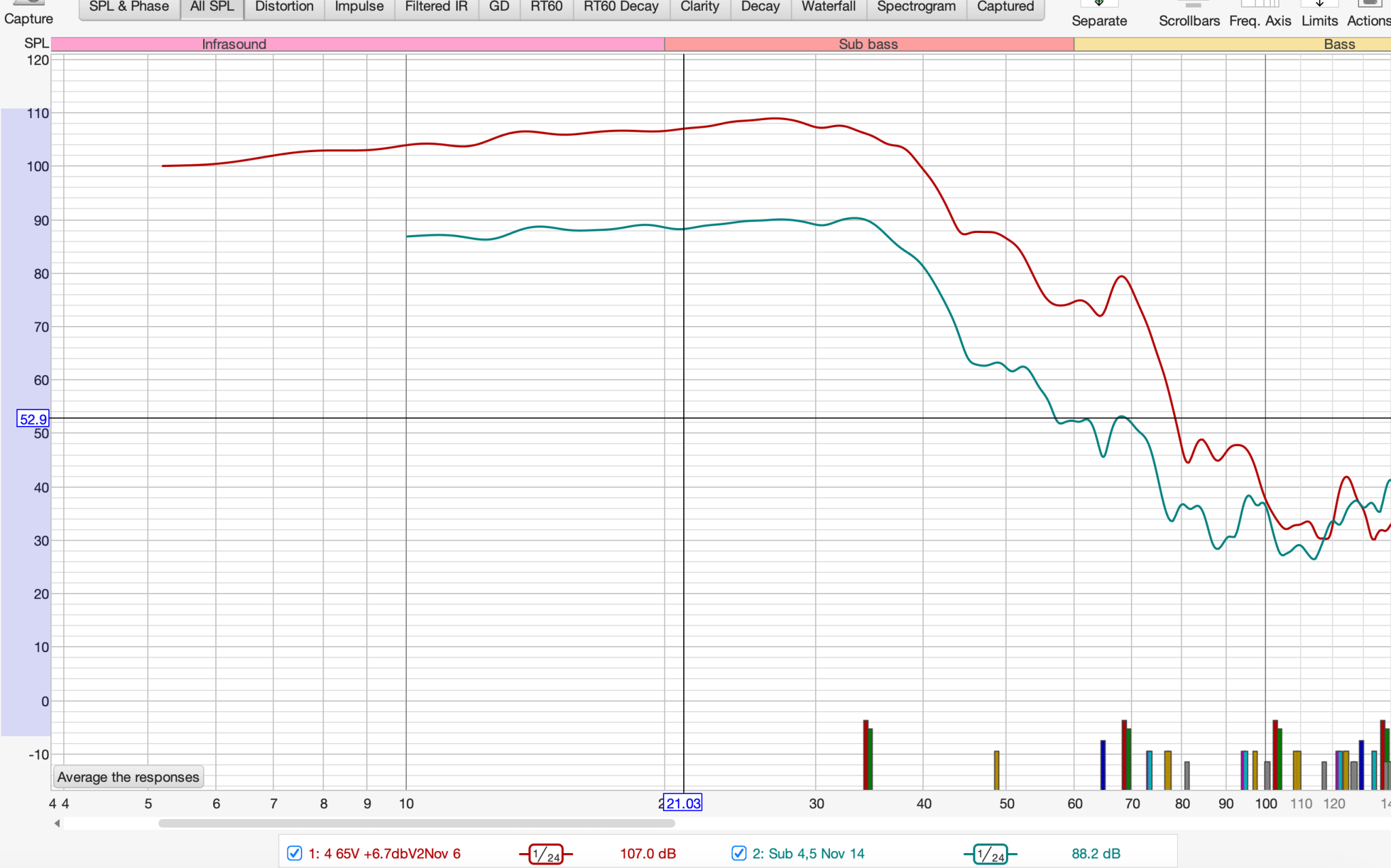

These are BMS 18" subs and they cover 10-38 Hz, with minimal EQ
The red trace is one sub at the point compression starts to come in at the low end, the trace for the two 18's used. I pass over to 12" subs to 70Hz and these all blend with mains and surrounds which run full range.

If you do the maths you realise that low frequency is very displacement hungry, 30Hz is easy to get high SPL but 1/2 that to 15Hz and you will need nearly an order of magnitude more displacement. The BMS 18N862 subs are a very good choice at these frequencies for an 18. They are not heavy, high BL and 19mm of displacement and good efficiency.

The design was to inset the braces into the sides to improve rigidity further
