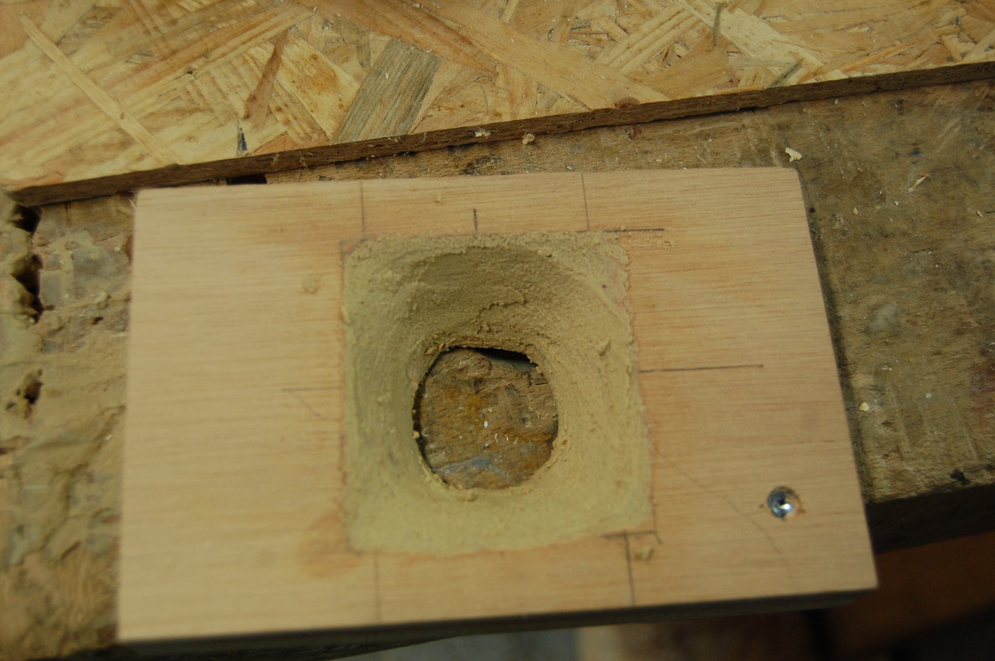

Art,The original SynTripP throat adapters were filed by hand to avoid any sharp edge discontinuity at the junction of the driver.
Your CNC routing should be adjusted to the particular driver you use.
thank you for clarifying!

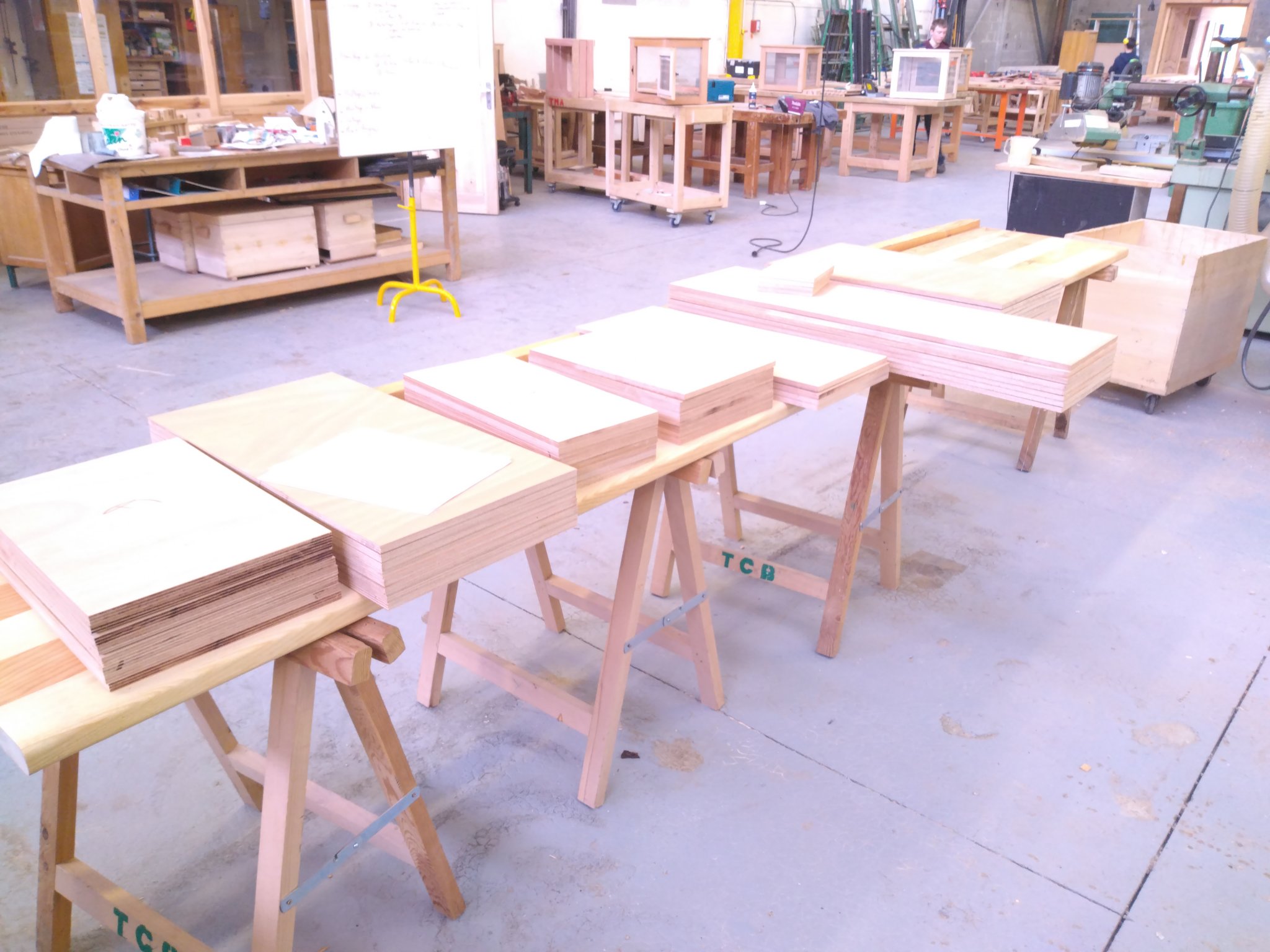

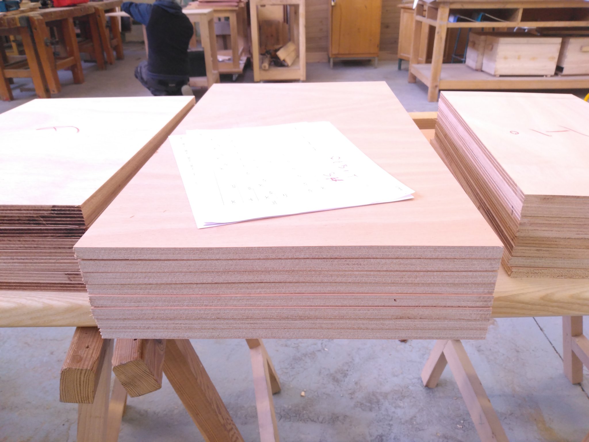

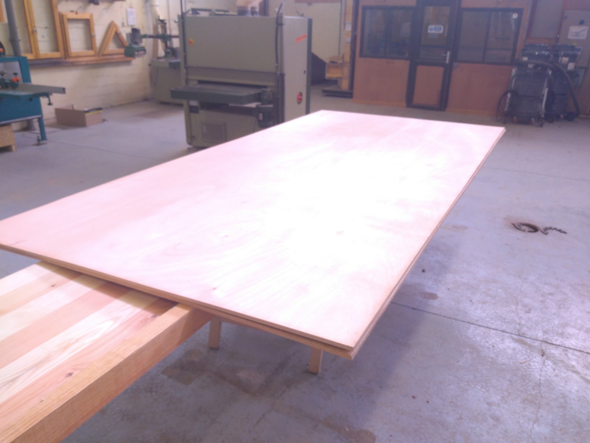

Hi all! I have made a cutsheet in metric for those who need it :
https://drive.google.com/drive/folders/1Uc8v5Qk3jz8snis_ovhLCcN1j12PVRWf?usp=sharing
There's an extra 5cm to all widths and lengths. This is for 4 syntriPs. I can make one for 2 if I'm asked.

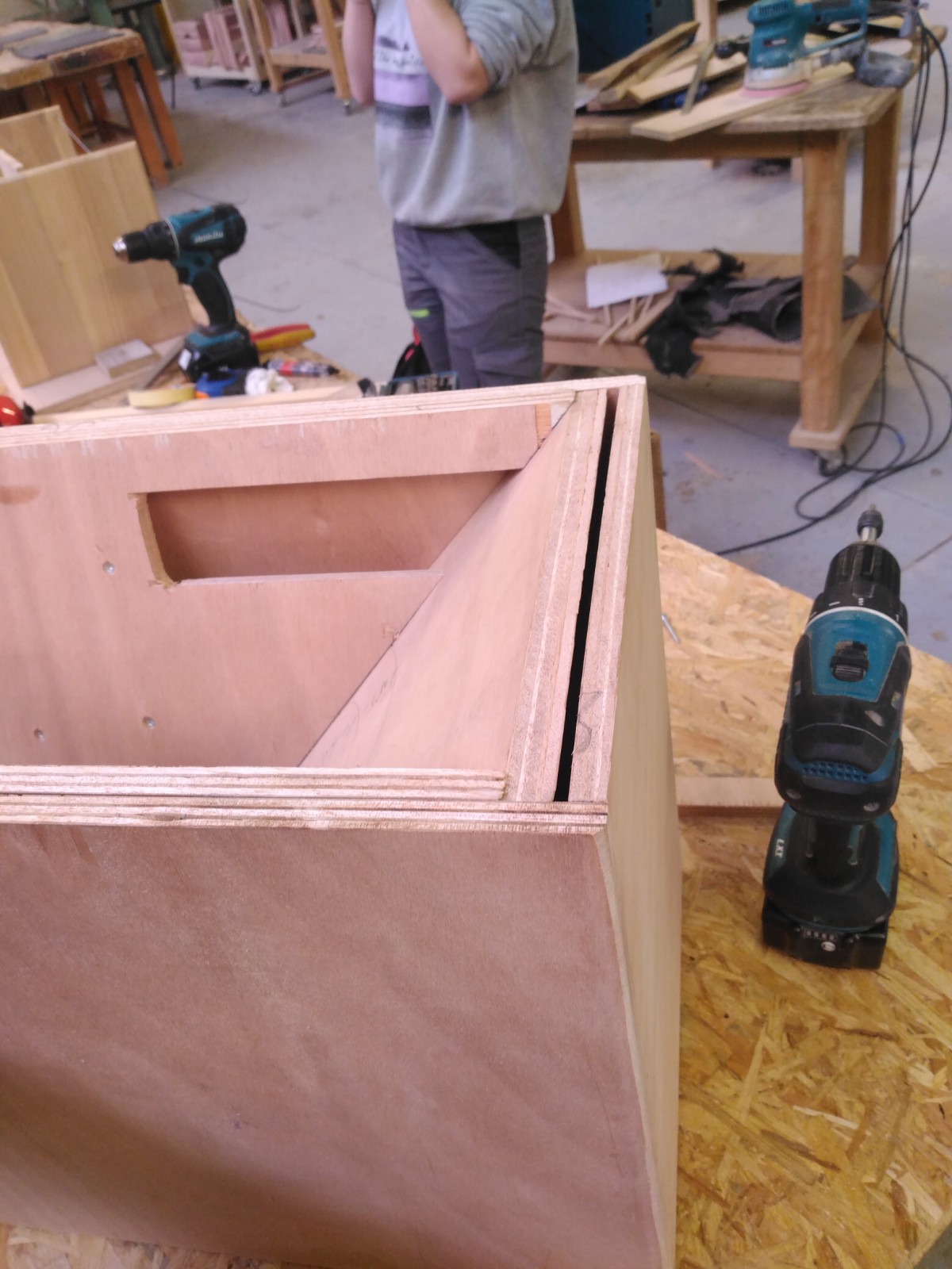

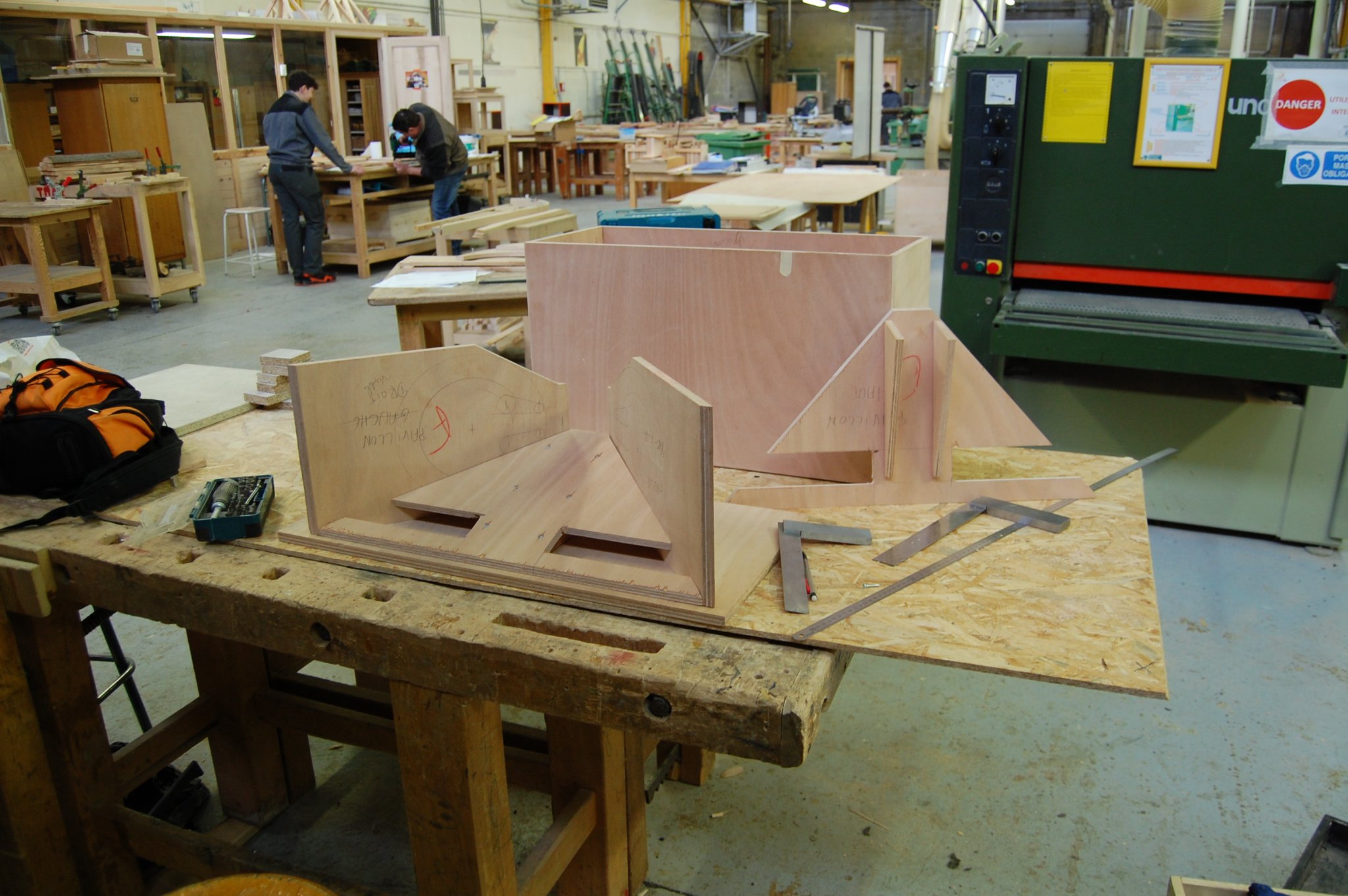

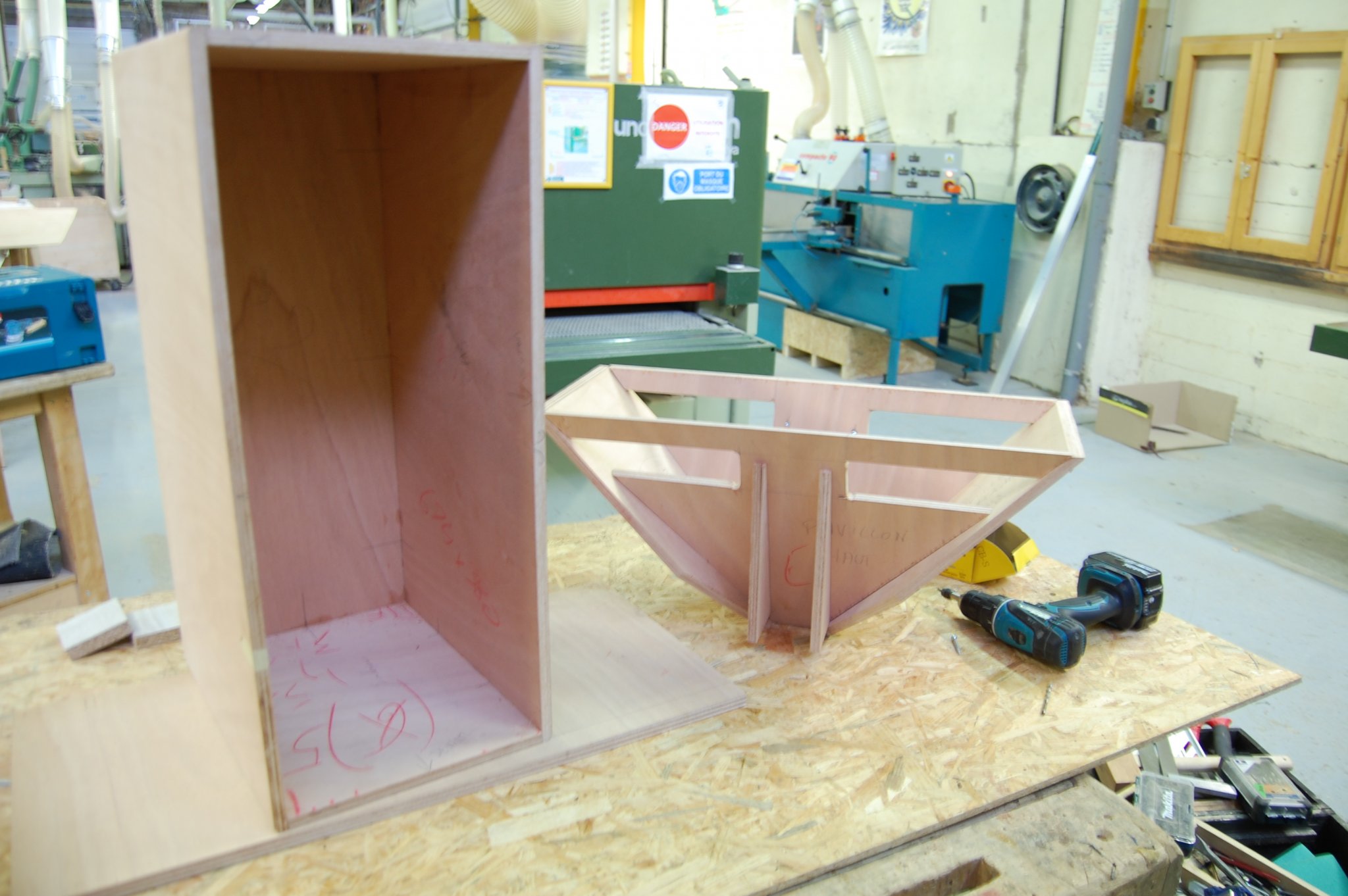

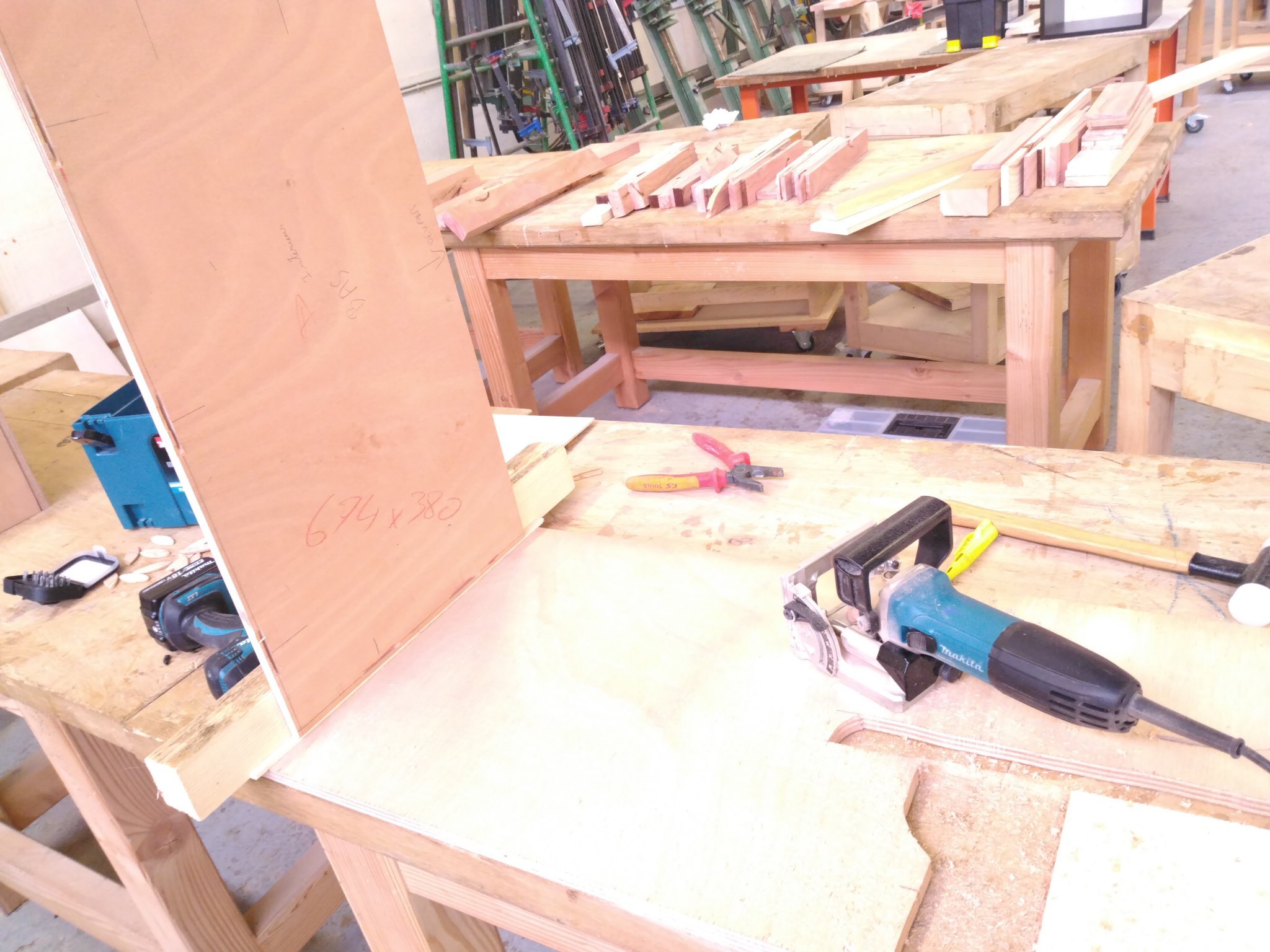

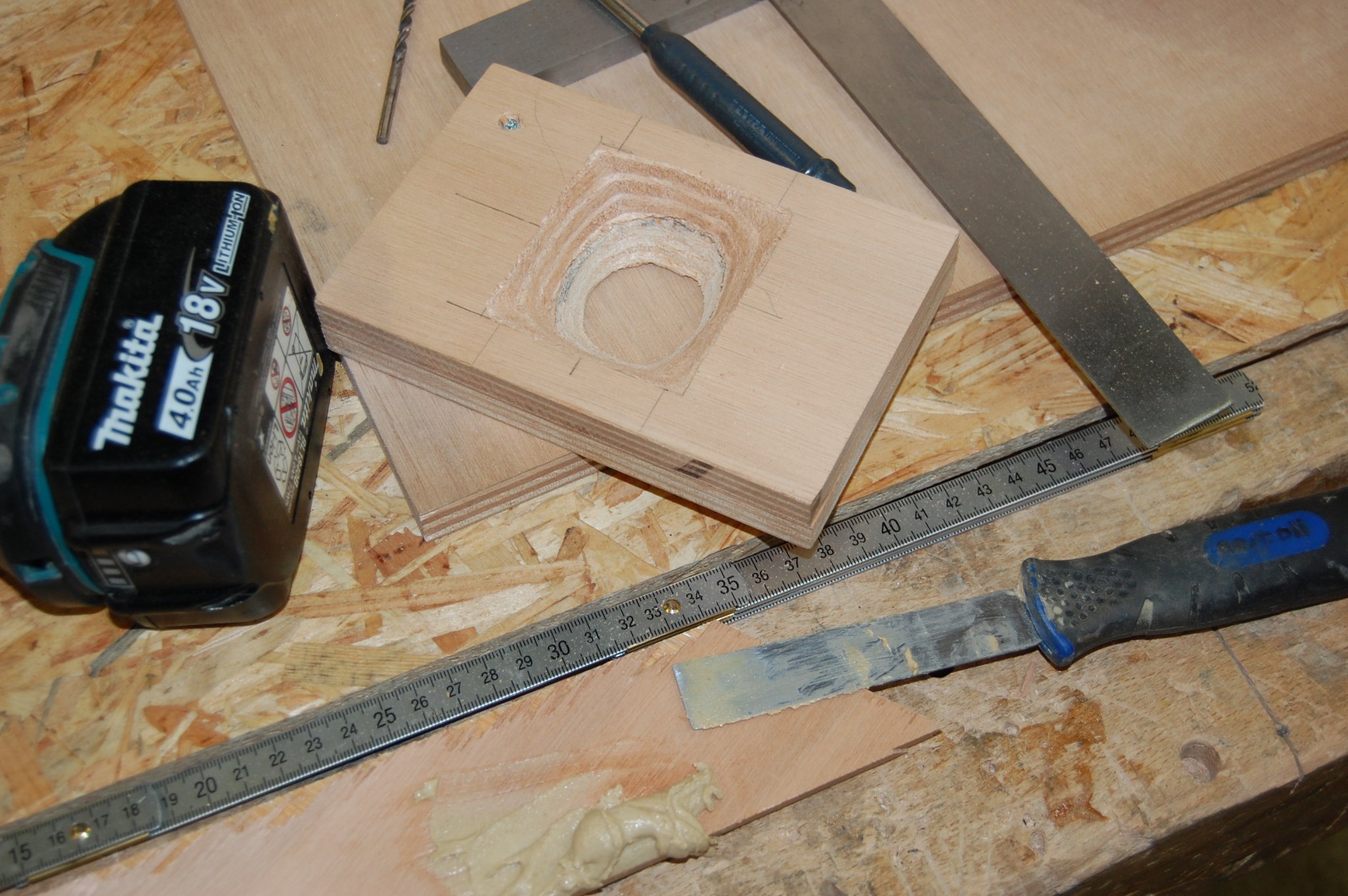

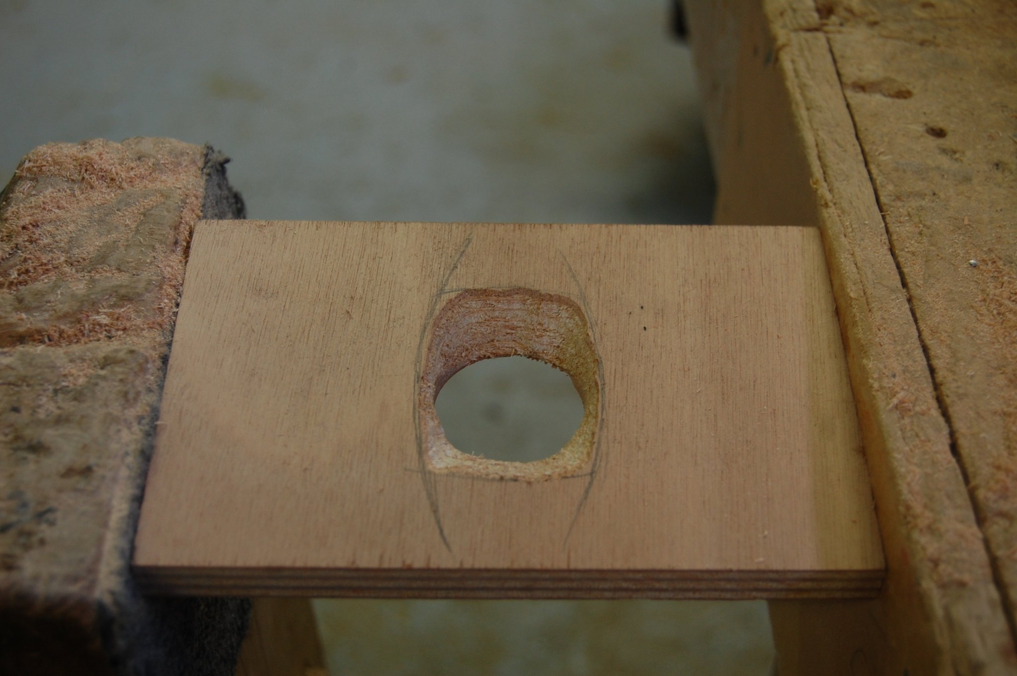

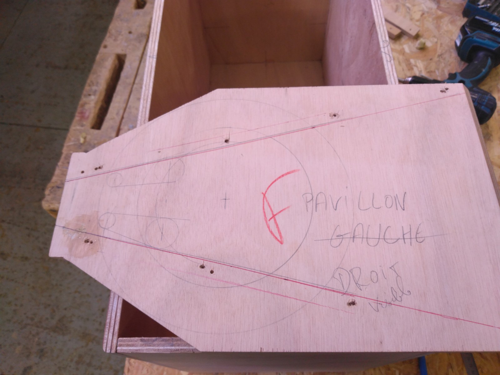

I've started making my first syntriP in the shop here. I Don't know whose plans I am using. They are labeled as "plans recommended by art" in the drive. I think they might be @ab01ns ' plans.
I went the oldschool route for the throat adapter.
My horn is about 5mm too short in width compared to the enclosure... So I'm going to add some thin strips to hide my mistake on this first one, won't be a problem on the next 🙂
Next step will be going to the fablab for the routing of the horn sides .

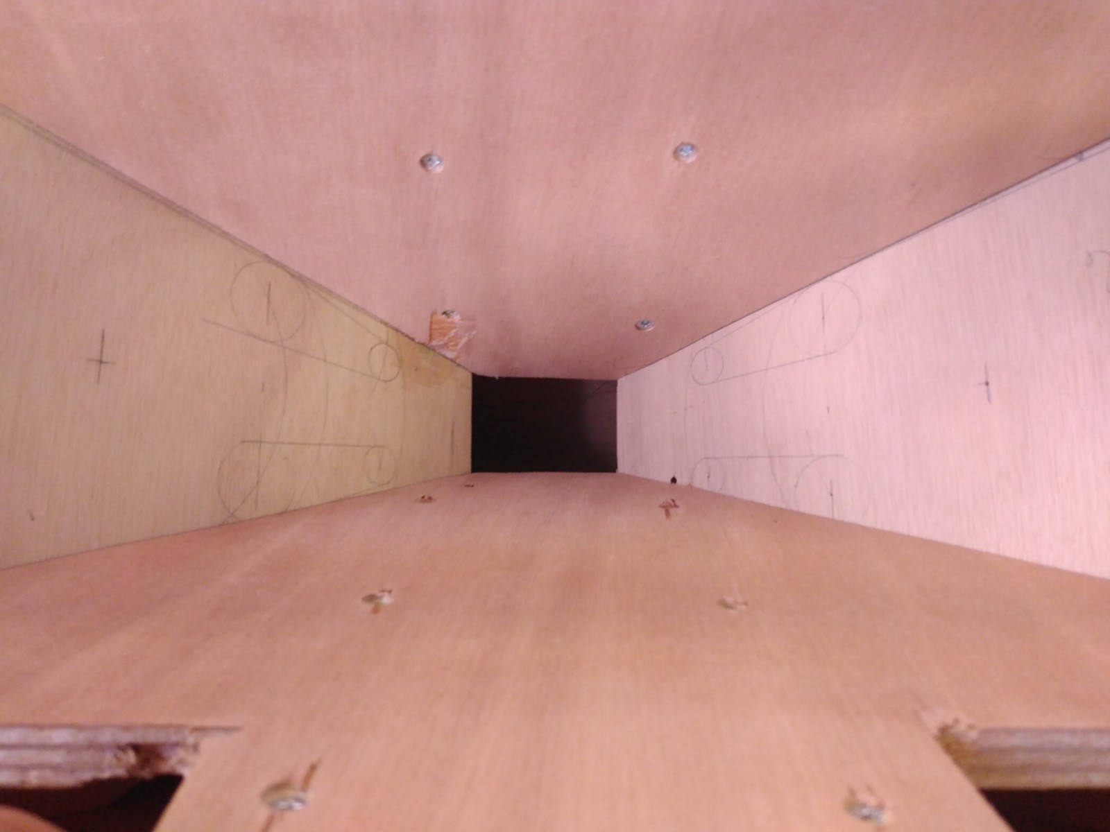

I've noticed there is a misalignment between the ports in the side panels and the top and bottom panels, I will correct that so they're aligned. No idea what caused that, although I was unsure of certain angles on the side panels. (the ones coming out of the throat adapter)
I didn't get the best plywood unfortunately. And I've learned that 4mm thick screws cause significant splitting.
Speaking of the side panels. As I noticed in ab01ns' build pics, the routing for the speaker comes really close to the edge of the sides of the horn, but it doesn't on the PDF. Son there's an incoherence there somewhere. Probably those uncertain angles I was talking about. I'm guessing it should be wider there.
Anyway lots of fun!!
No Tone,
Glad you are having fun!
As you found, pre-drilling pilot holes and countersinking them prior to screwing is required to avoid splitting thin plywood, - probably should have included that in the assembly instructions...
The plans you are using eliminate the grill frame, which I definitely never recommended.
Art
Art

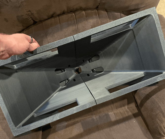

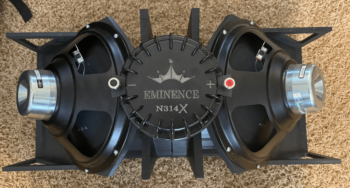

Hey! Just got the drivers and tweeters assembled with Mr. Speakers' 3d-printed chassis. Curious about wiring and power for 2x 10CL51-8 and Eminence N314X-8. Not sure whether to run the tweeter and midrange separately or if we wire them together. Do we use a passive crossover built into the cabinet or do we run a rack pa crossover such as the Behringer Super-X Pro CX3400 V2.
We printed in Black ASA (we think, asked for white and our printer service messed up) and assembled using the best guesstimate of hardware from home depot. Very happy with how they came out so far!

The woofers and compression driver are powered separately using an active crossover and various EQ settings, the Eminence N314X-8 will require different DSP settings than the HF driver I used in the original SynTripP cabinets.Curious about wiring and power for 2x 10CL51-8 and Eminence N314X-8. Not sure whether to run the tweeter and midrange separately or if we wire them together. Do we use a passive crossover built into the cabinet or do we run a rack pa crossover such as the Behringer Super-X Pro CX3400 V2.
Post #9 lists the tests undertaken between 10/14/14 and 11/5/14, and basic DSP settings used with the horn extender.
4" Fiberglass was stapled to the sides, bottom and back of the cabinet interior.
The 10CL51-8 can be wired in parallel, around 600-1200 watts peak at 4 ohms. The Eminence N314X-8 can use around 150-300 watts peak at 8 ohms.

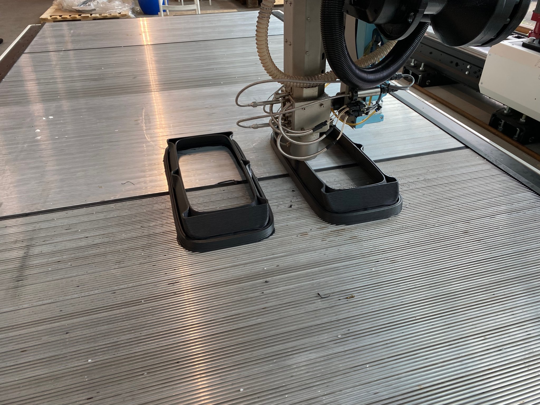

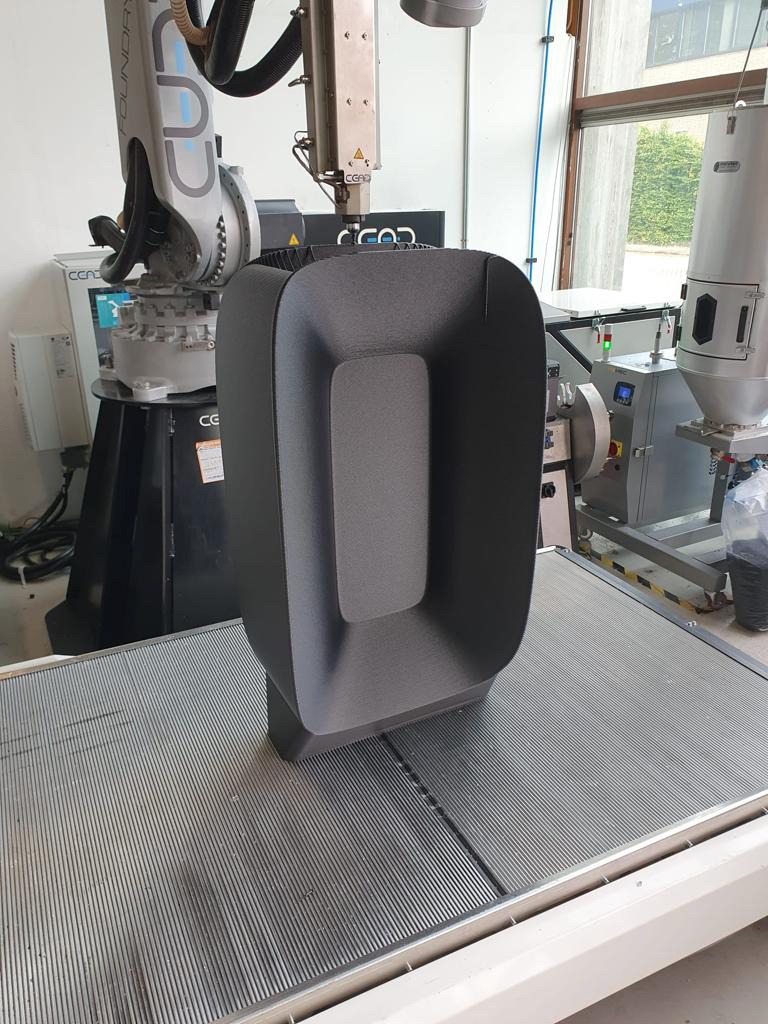

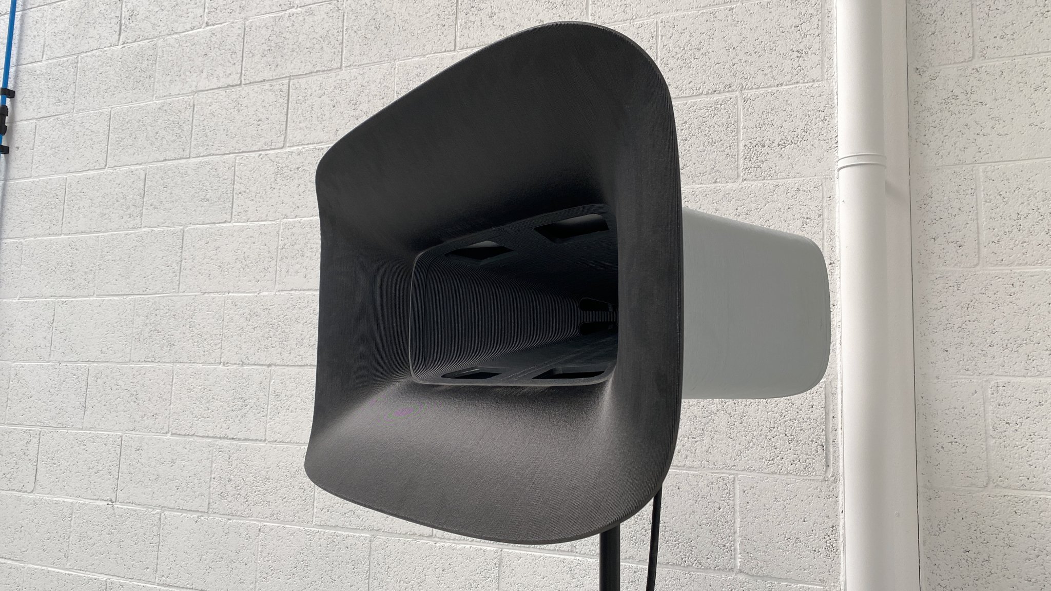

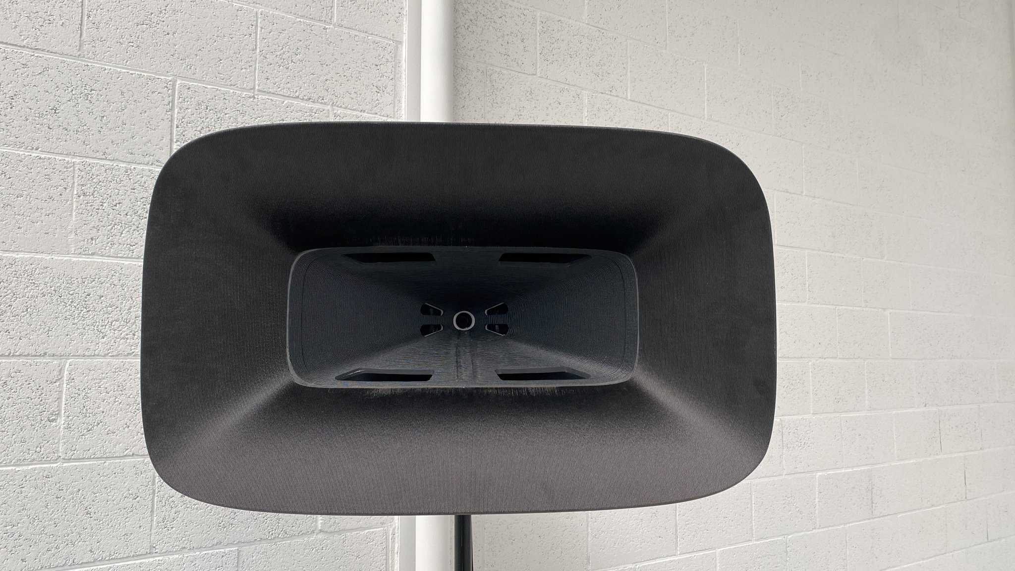

We’d like to share some of our experiments with additive manufacturing methods, i.e. large scale 3d printing with pellets instead of filament. We have made a keystone subwoofer quite some time ago, you can find it in the keystone thread.
We have adapted the SynTripp design to make it printable. Also we’ve adjusted the throat horn curve a tiny bit, as well as the extension. We've increased the extension length by a bit to increase directivity to lower frequencies. Here are some photos of the build process. We nickname it the "SynTripPp" with the last p for printed.
It feels really dead and stiff. It's made of a composite which has a substantially higher tensile strength than baltic birch. The downside, the way we designed it, it is also heavier than made off wood. You can't have it all 😉
What are your thoughts?
The SynTripPp looks very nice, but still not a fan of leaving all those holes unprotected by a grill.We’d like to share some of our experiments with additive manufacturing methods, i.e. large scale 3d printing with pellets instead of filament. We have made a keystone subwoofer quite some time ago, you can find it in the keystone thread.
We have adapted the SynTripp design to make it printable. Also we’ve adjusted the throat horn curve a tiny bit, as well as the extension. We've increased the extension length by a bit to increase directivity to lower frequencies. . We nickname it the "SynTripPp" with the last p for printed.
The printed Keystone response was quite different than the original, have you done any measurements of the SynTripPp polar response?
Art
Thanks for the compliments all.
Yes indeed, the results for the Keystone were quite different. We made some design choices that resulted in (1) air leaks (2) a lot of cabinet resonances. The poor thing was vibrating so much. It was a good prototype, because of what we learned, not how it performed.
We have made some larger double 18" compound horn subs (paraflex like), where we eliminated that. Also by leveraging geometrical bracing and a composite sandwich construction. So stiff! It is surreal to not feel any vibrations on the enclosure while feeding it ~89 volts delivering ~2kW over 4 ohms continuously.
We made an effort of getting some polars, but that failed. The room was too small to do it properly. Now waiting for some good weather to take them outside. We will share the results in this space.any measurements of the SynTripPp polar response?
