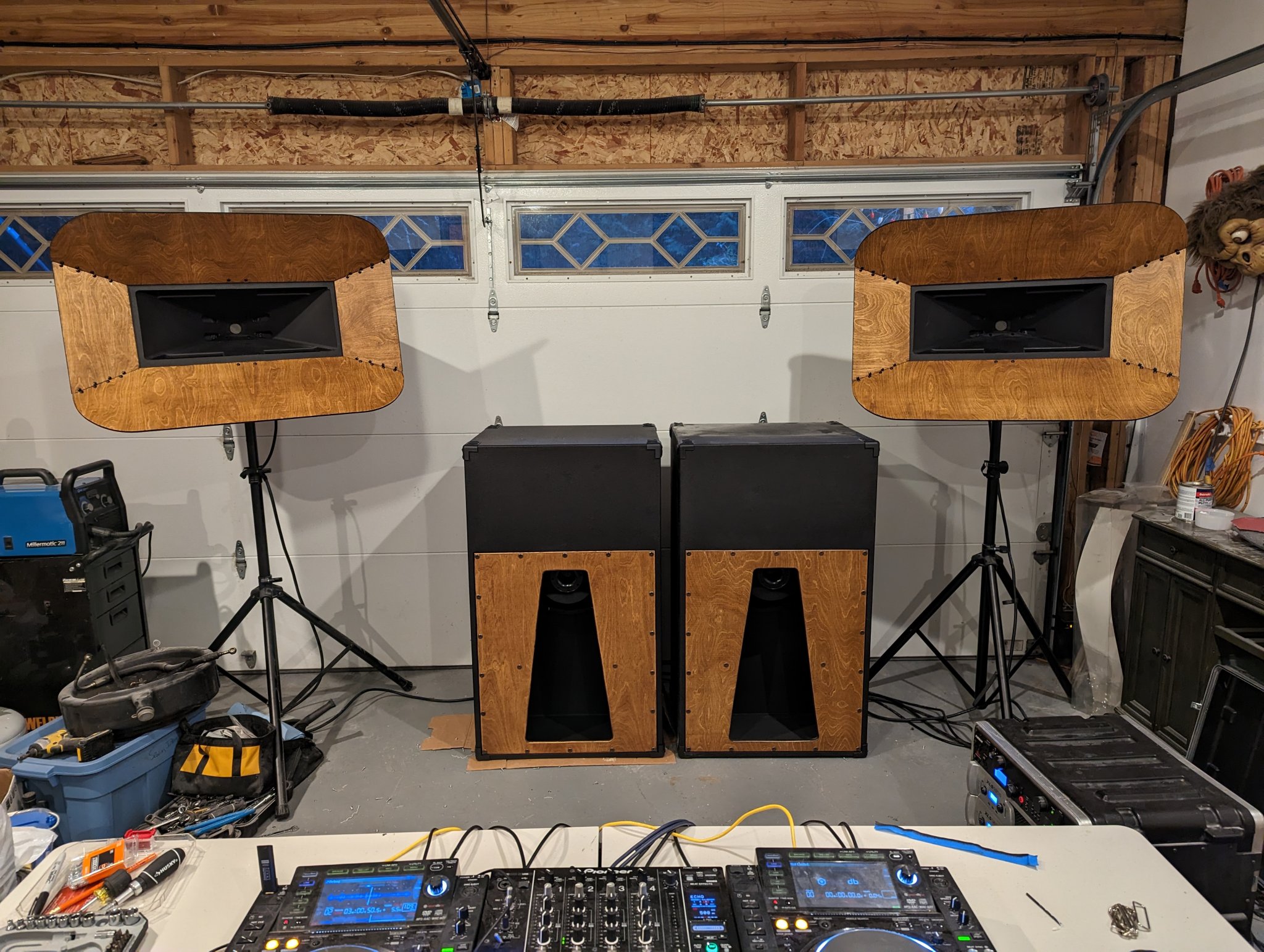

Thats what i´m working on.
and the rack with amps and RME interface for measurements is allrey ready for the test.

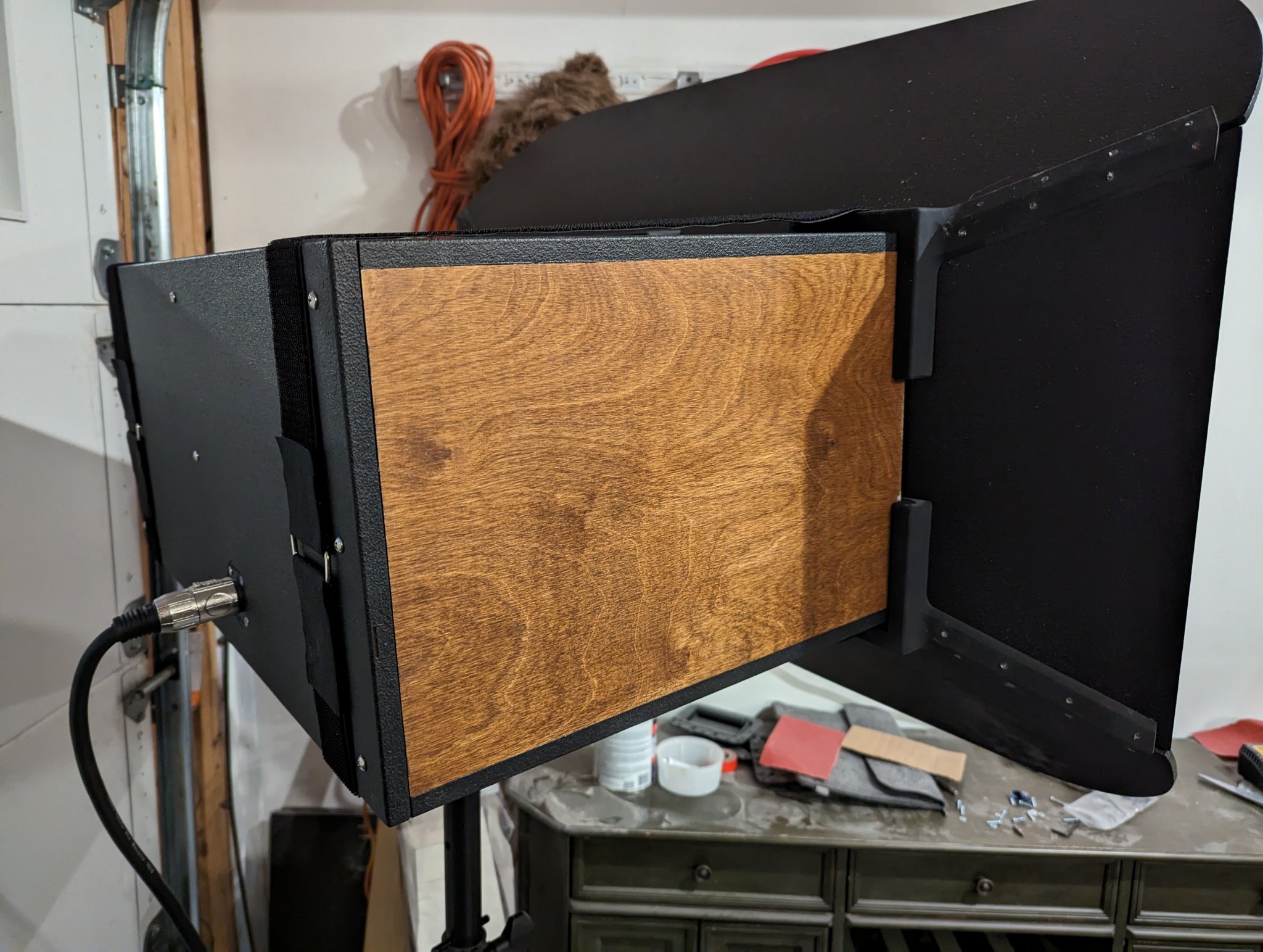

Finally finished up the horn extensions. Only grills left to make for the keystones and SyntripPs.
