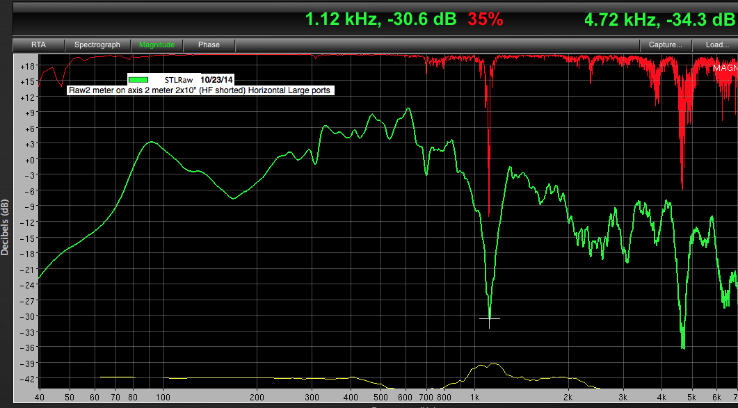

Right, but as the driver gets larger in diameter and the "far end" of the driver gets further away from the entry holes, you start getting a notch due to the driver's output going out of phase with itself (I hope I have that correct). So is that an immutable phenomenon that just has to be worked around?
Without a phase plug to make all path lengths from the cone output near and far from the port, cancellation notches will occur. A proper phase plug and mounting for an offset driver would be difficult to construct.
You are correct that the first cancellation notch is at a lower frequency (1.12kHz) with the entry ports further offset from the center of the driver. VTC should not affect that distance related phenomenon.
The port position is a compromise, if placed more towards the center of the cone, (raising the cancellation notch frequency) the center to center distance between left and right cone and horn apex is increased, lowering the cancellation notch frequency, and causing different frequency on and off axis out of phase nulls.
The SynTripP compromise is a "work around" that could be avoided going three way, though that is more work ;^).

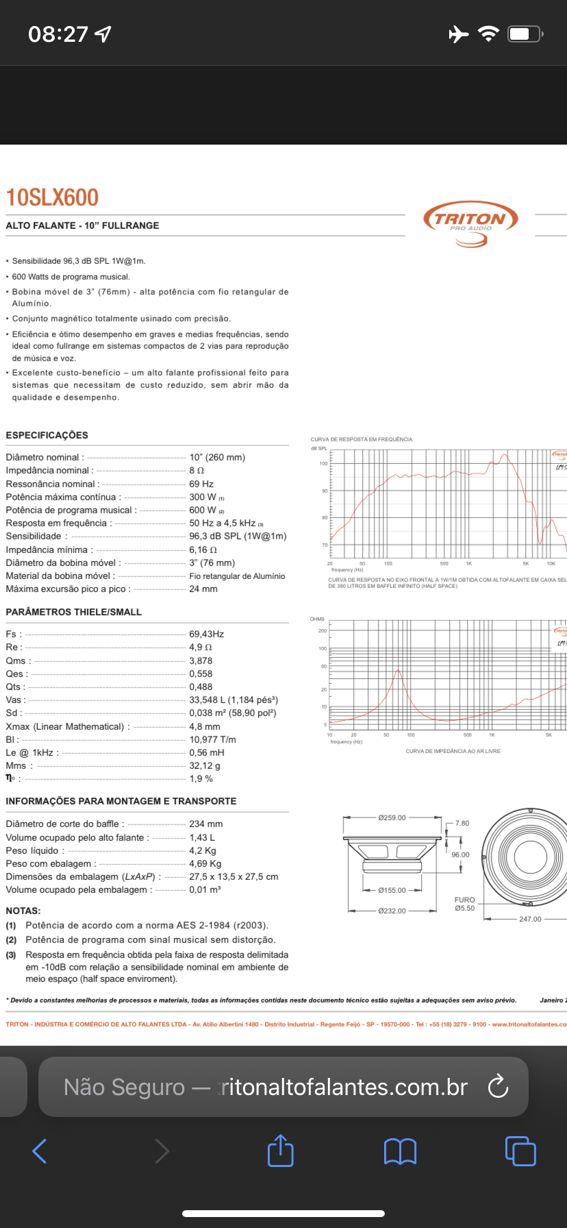

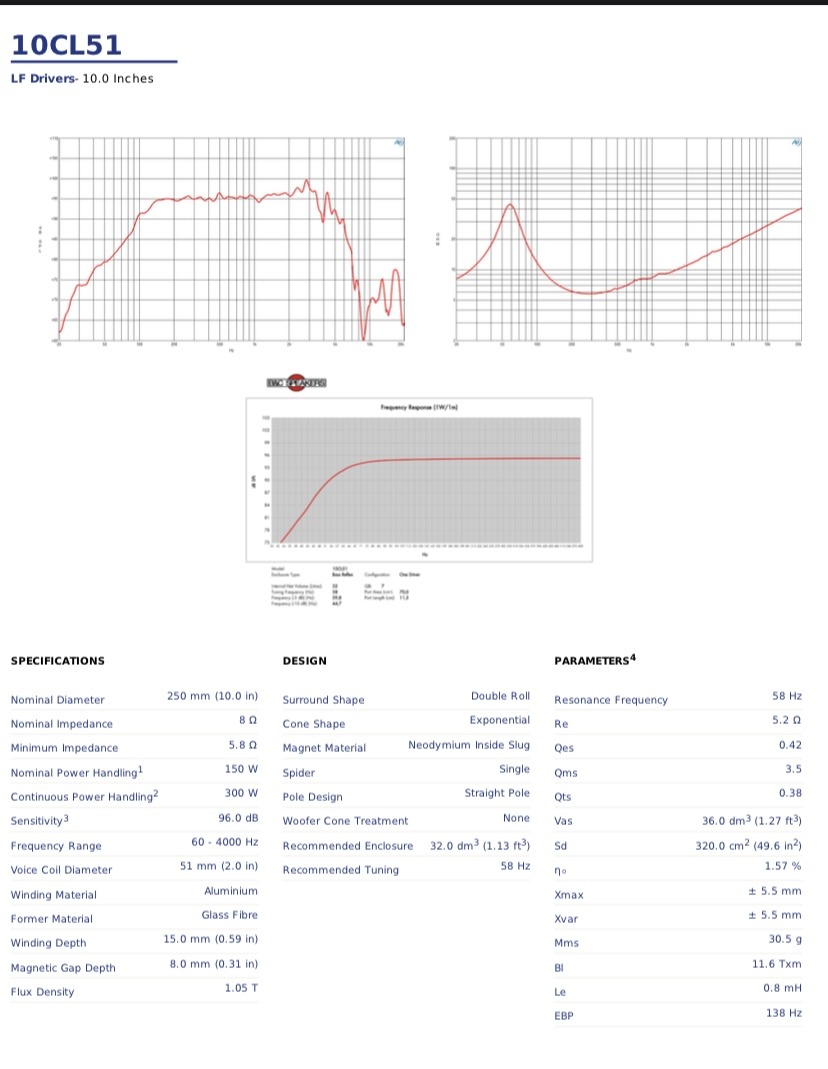

Hi folks, do you think these 10” Triton drivers can kind of replace the B&C one for this project?
It seems they can’t get as low and are not as strong, but they are way cheaper here in Brazil, and since the CD is starting it’s response so low, I thought it would probably be maxed out before these Triton 10” drivers, even though they are not perfect for the horn.
I know the best way to find out is to get them and test it, but maybe someone can find an obvious reason why they wouldn’t work…
I’m attaching both the Triton and the B&C datasheets.

Gotcha, thanks for the insight.

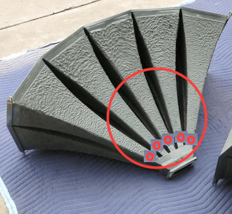

Your Altec 1003B multicell horns could be turned into MEH (multiple entry horns) by adding a speaker baffle (and box) top and bottom, then drilling entry holes in a radial arc. Those 300Hz cutoff horns could be crossed over low enough to use 10", 12" or 15" drivers that reach lower than the drivers used in the SynTripP.

Multi cell multiple entry horn. A thrilling idea for a project. In my opinion, it is not really worth it to modify the multicells - a) 300 Hz-ish crossover is low enough in my book, b) resale value would lower considerably. For home use I would personally follow one of mark100's designs - these would fit the corners as well.

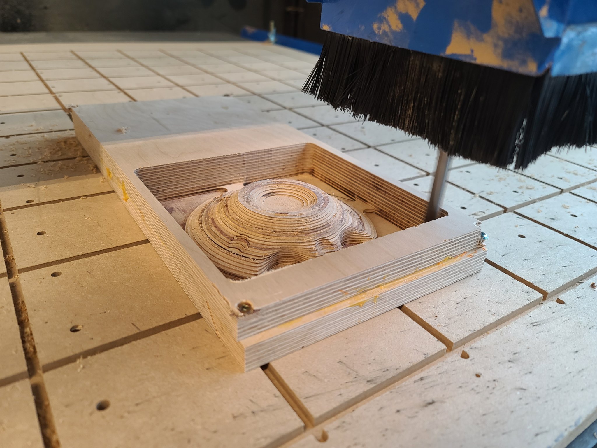

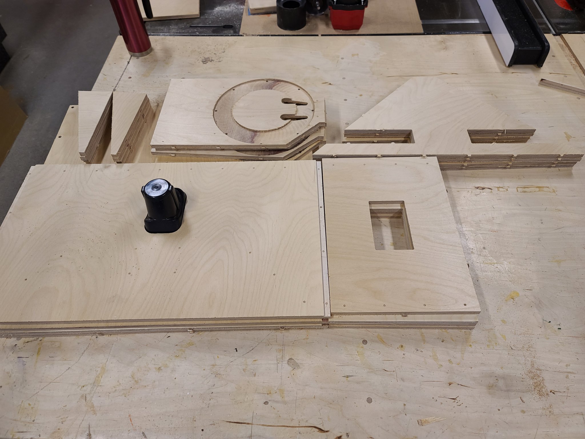

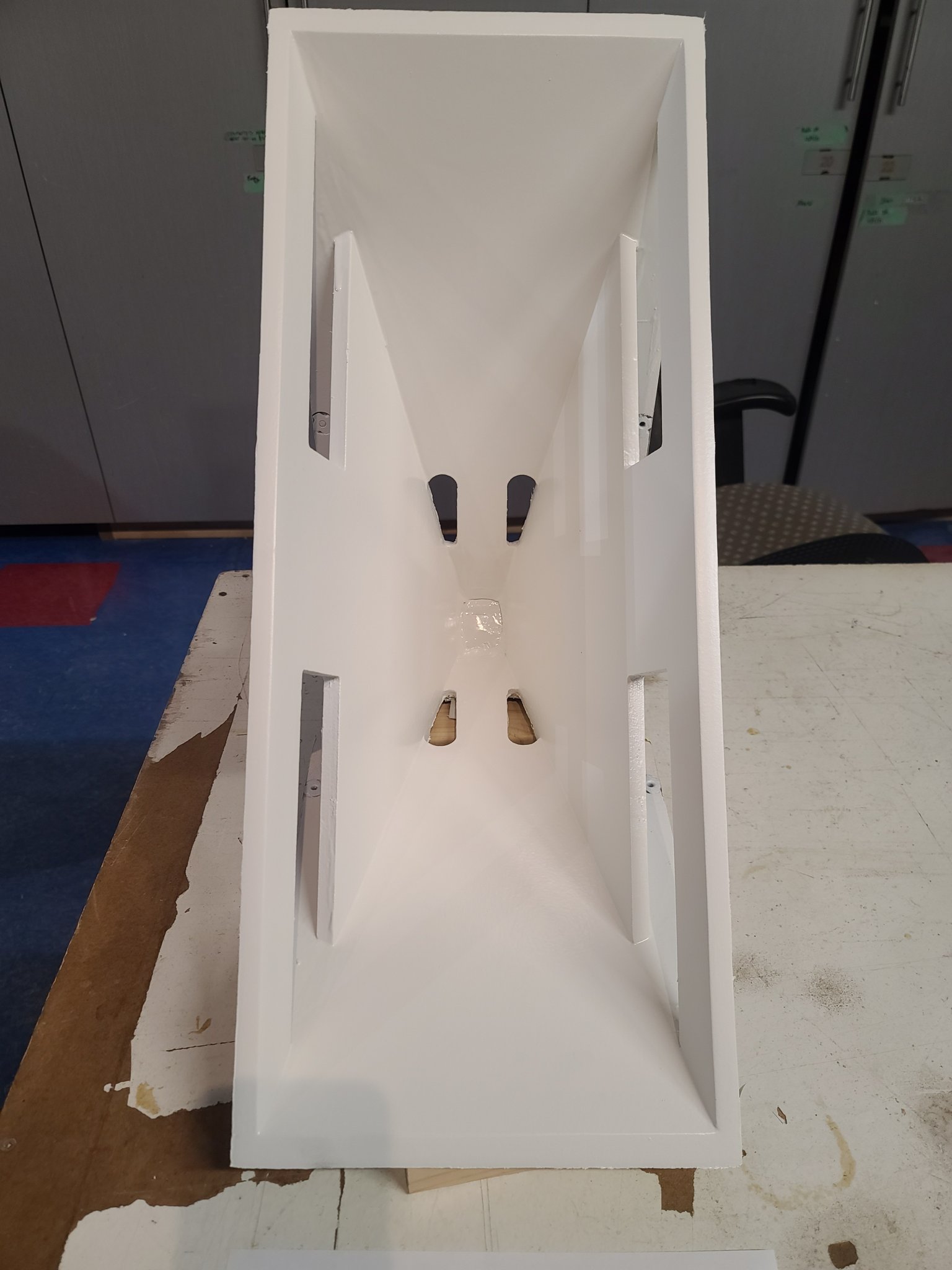

I remade the sides panels with the proper channel for woofer clearance, glued them up and got the alloy TAP that I made mounted up. Tomorrow is bondo and sanding day! It's starting to look pretty damn decent I think

That’s certainly a creative solution I hadn’t imagined but I see your logic. However the OP was right that it would devalue the horns multi cells. That might not be a concern if I pick them up cheap, but I didn’t, and as they are going to be my endgame - which will be MEHs - I need to preserve their resale.
Thank you, Pelanj
Especially your second point nailed it

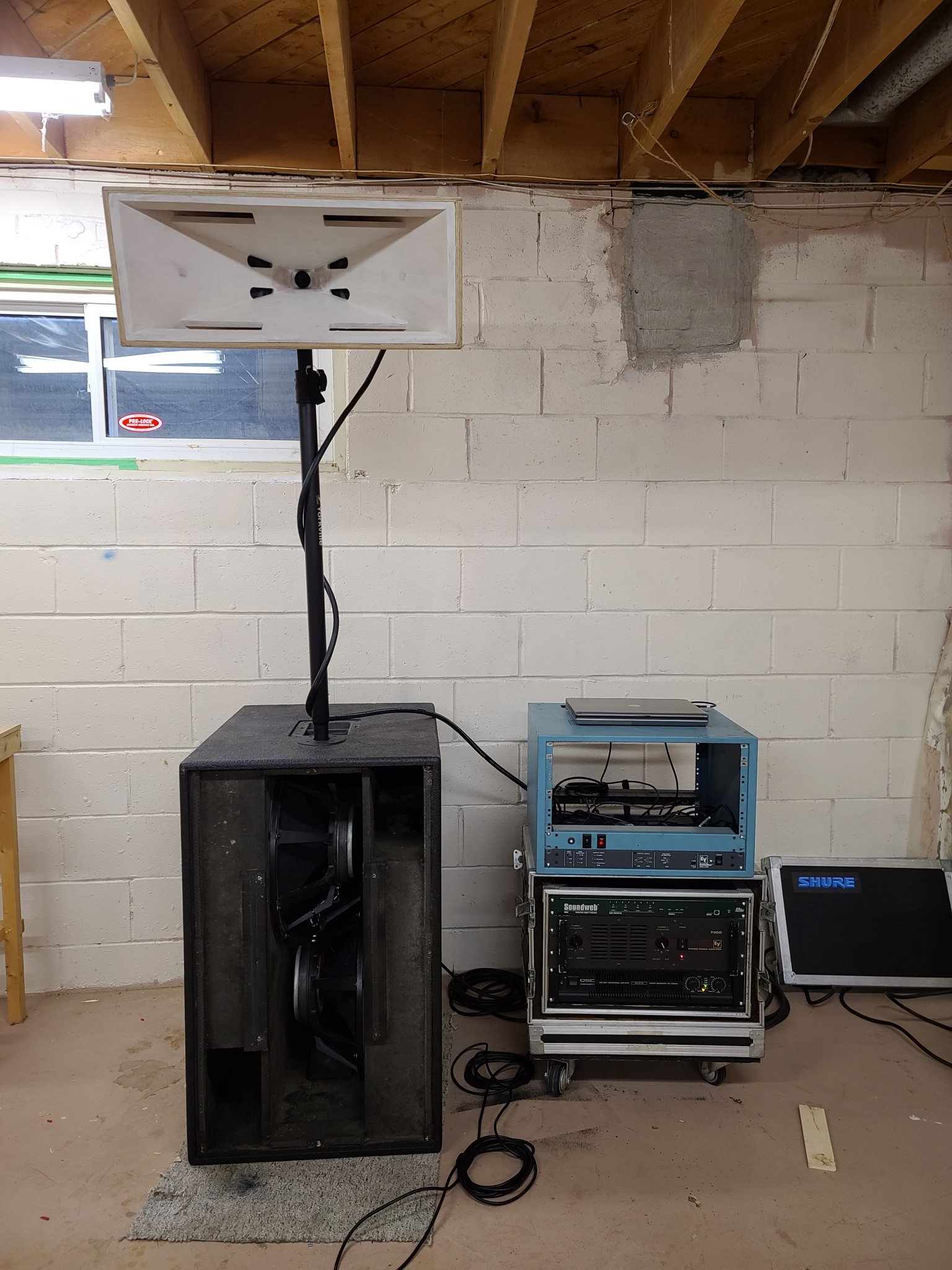

I know someone has to have asked this already but what would be the best driver/speaker option for the most spl? I'm planning on using a pair of SyntripP with 4 keystone subs and I'm hoping to be able to still do heavy metal concerts at large clubs if possible.
A member called Finbot used 4 Syntripp and 2 tapped horns for bass to provide sound for 3000 people outdoor. It raised alot of concern, but he was adamant it was 3000 people. Its the bass he complained about. You should find his comments if you search for his comments under his username. I will post the video link and description for you.
Footage from hosting 3000 people on our mobile artcar. Two main SynTripPs running somewhere near RMS, and two for filling in front at -10db.
Bass provided by two XOC1 TH118 with B&C 18SW115.
4 Syntripp + 2 TH for 3000 outdoor

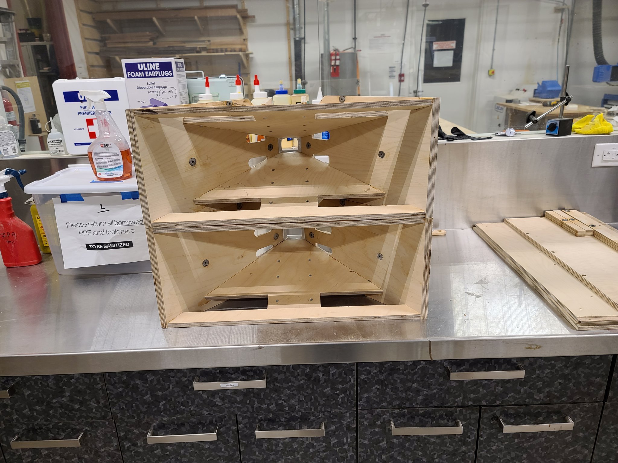

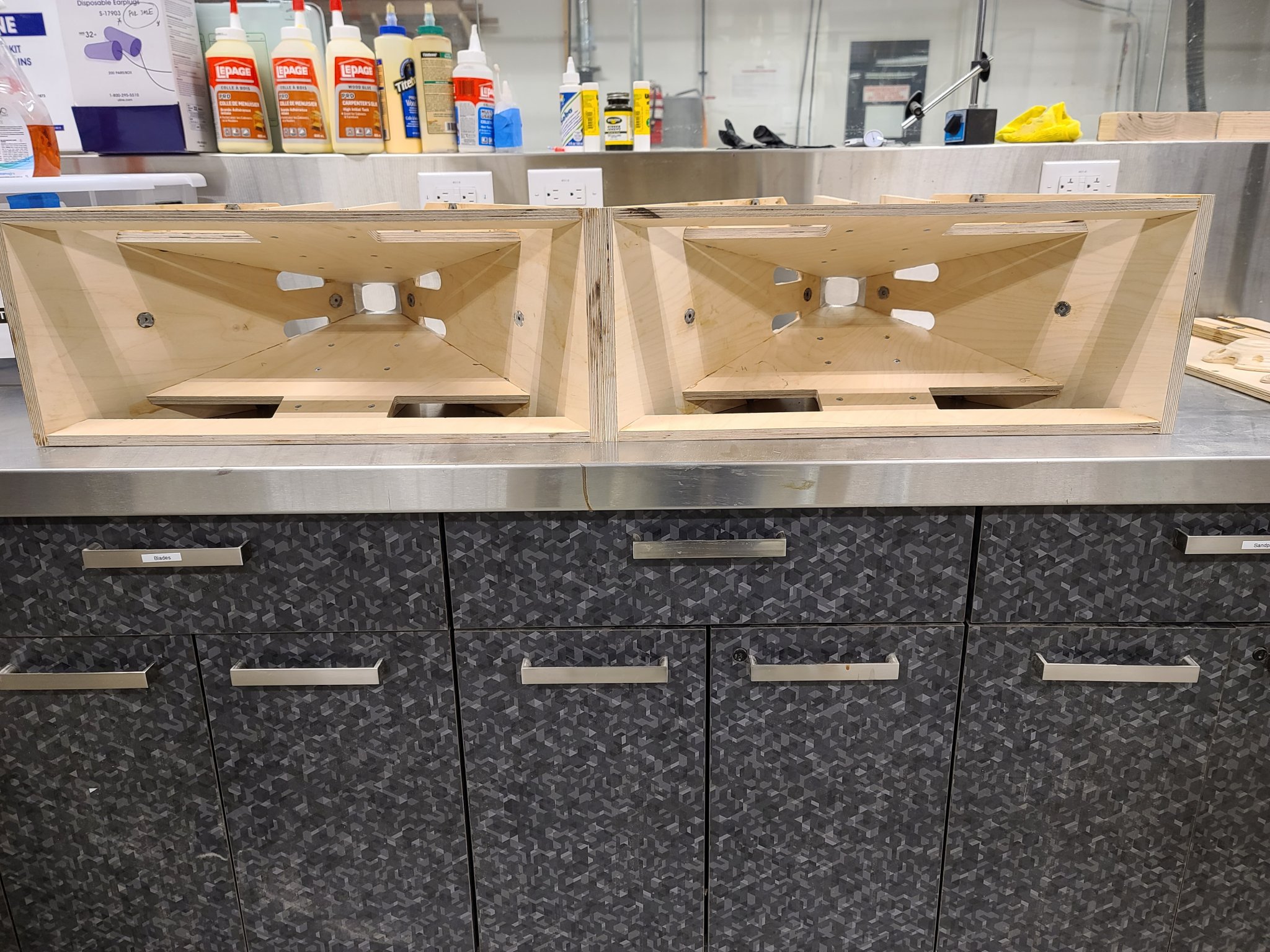

A few more progress pics. It's starting to come together.

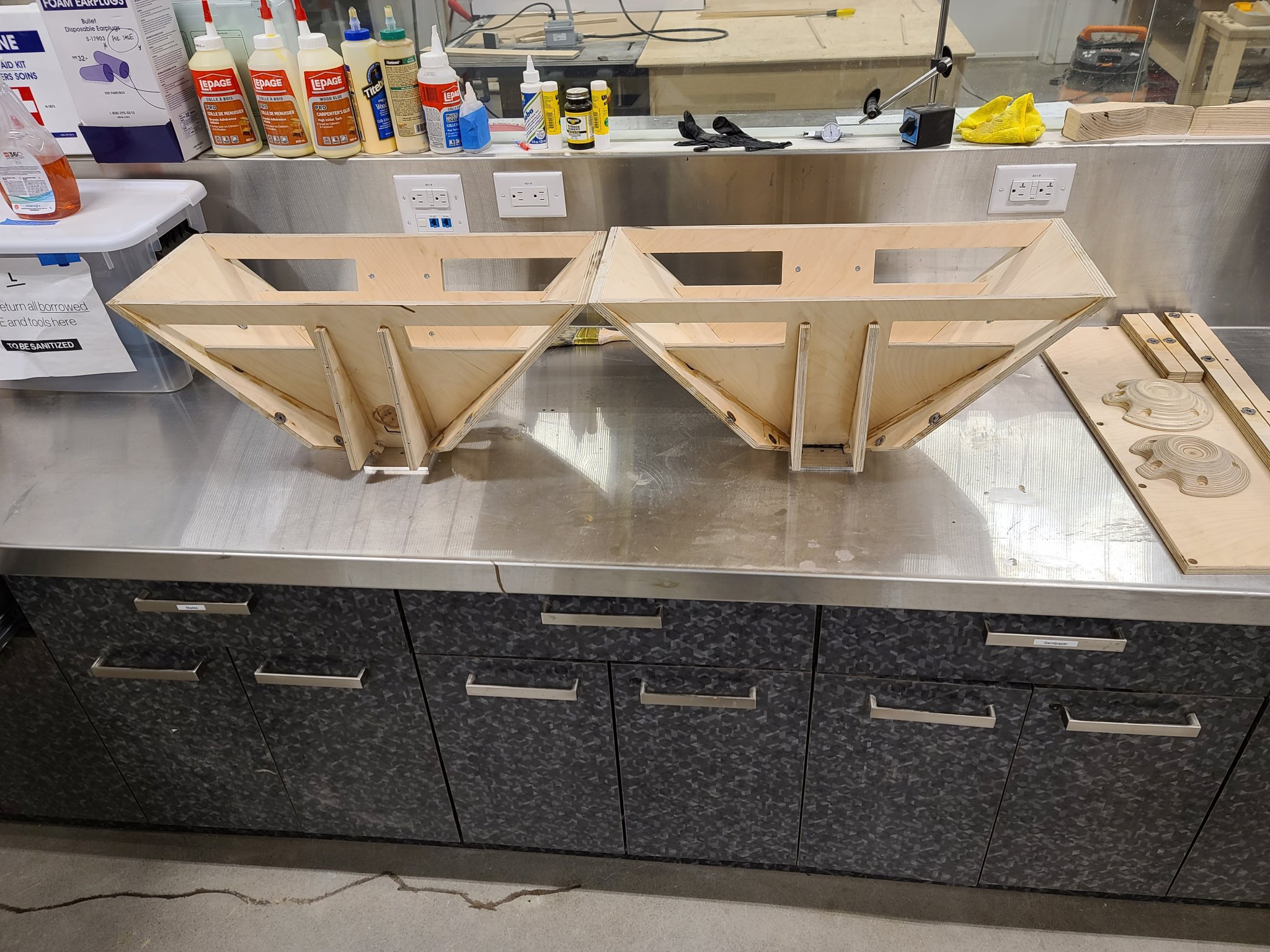

Today I dry fit the primary horn and thankfully it all snapped together nicely. I think if I build a second one, I will add a bit more clearance in the dado slots for the pole box. The wood glue adds enough thickness that my .005" clearance is a bit tight in that area.
I'm thankful I took the time to add the dado slots and pre-tap the pilot holes on the CNC. It really makes getting all the horn angles lined up much easier. I don't know that I have the necessary skill to assemble this without the assistance of those features. This is my first DIY speaker build and it is not exactly a beginner-level project. I have gained a lot of respect for Art and the others who have built this before me.

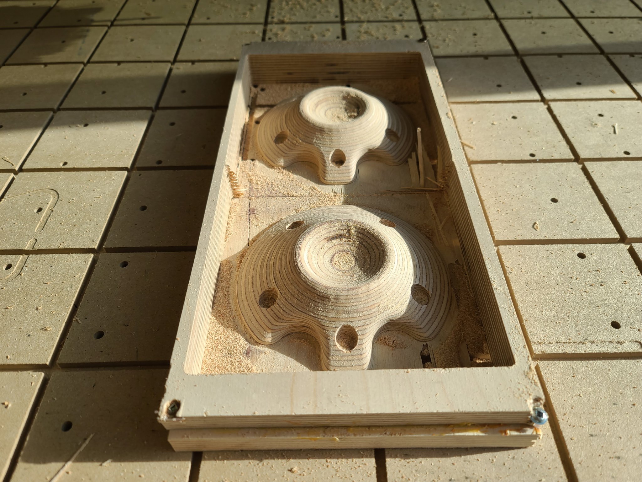

Next up is the throat adapter plate. The plan is to mill it from two pieces of 1/4" aluminum plate. We'll see how that goes - I've never tried doing any curved-surface milling in aluminum.
Patrick

Small updates: made more CNC Baltic phase plugs for some syntripP friends across the globe and prototyped out the secondary horn. Primary horns and primed and waiting wet sanding and finish coats. Unfortunately, I am waiting for woofers to become available again in Canada so I can continue on building and start measuring and calibrating. I did however get one assembled with just primer on it to give it a little test. The entire house shakes with -25db headroom to spare so I think I am doing something right here
